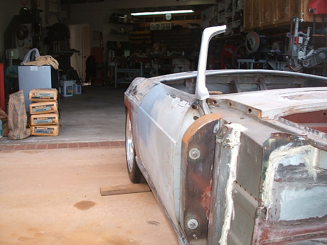

    Rear fenders for my MGB project
    Built tubs for 315-35-17 clearance then added material on the outside to define the wheel opening

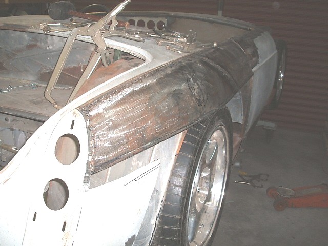

    The top section is 3 pieces formed in the English wheel and welded together. The belt line was marked using a laser line (like you use to hang pictures with) off the line in the door and front fender. The bend was done with a tipping wheel rather than a bead roller so that the width could be tapered to nothing at the back

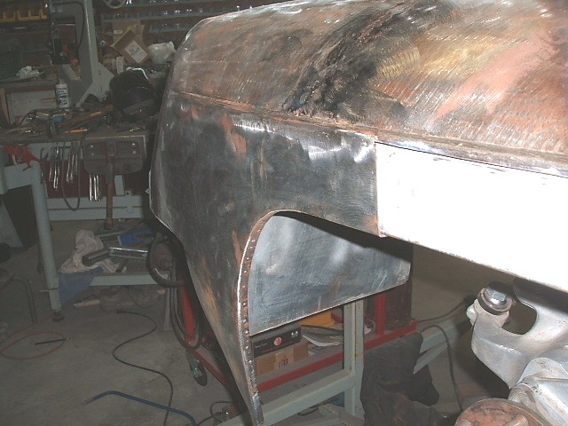

    The lower rear section was formed and welded in. The wheel opening was tipped and spot welded to the inner fender panel.
    The lower front section was done the same way and welded to the inner
    It didn't look right so I extended the flare into the door by slitting the end and flaring out the outer skin.
    Here's the finished product

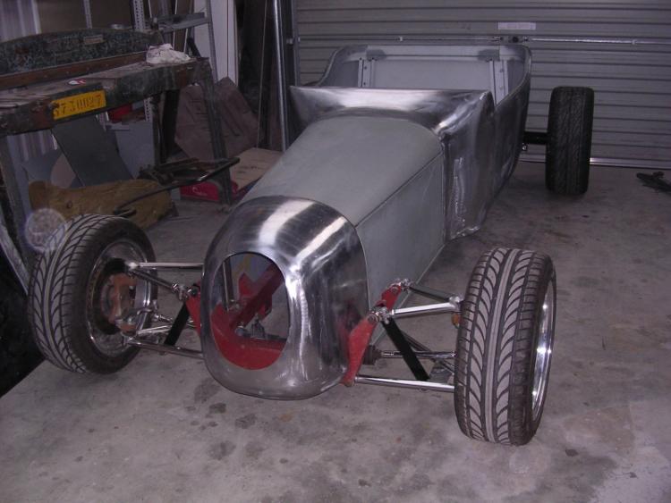

    my roadster body..pretty straight forward compared to some of the awesome stuff on this thread i know :D

    Nothing staight forward about that.
    Nice job!

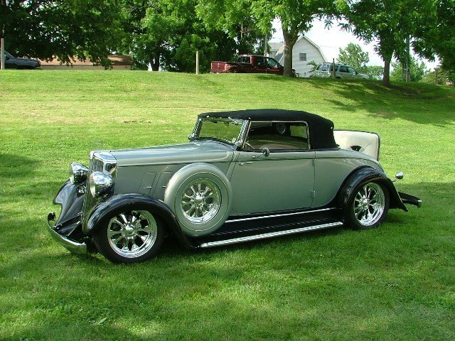

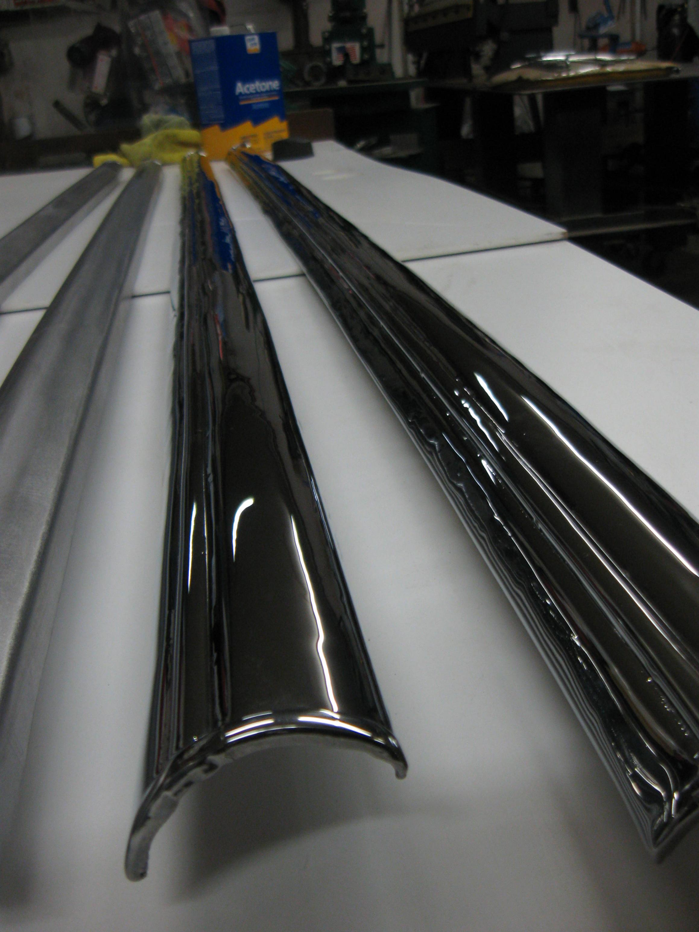

    I have a customer with a 34 Hupmobile Cabriolet that needed the running board trim replaced. The originals were made out of Zinc, and the chrome was having major problems.
    I made them in one piece. 20Gage steel. They were 69 inches long, and needed to be laser straight.
    Put a hem in, put the beading in, and used an 8' press break to get the profile right. Then they were metal finished for chrome, which is not an easy task. Blocking/****m/repeat.
    The car should be at the Detroit Autorama, and World of Wheels in Chicago. It did pretty well at Columbus Goodguys this year.
    Nice car, and it gets driven lots of miles.
