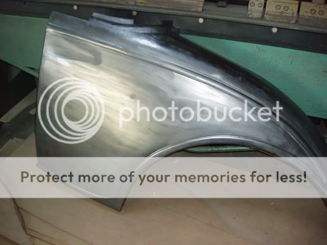

    New fenders for my old daily:
    Starting to rust now......... I must find the time to get back to them & add some paint:rolleyes:
    Some of the first shrinks:
    A bit of ruff shape:
    The 4 ruffed out:
    Trimmed to size & shape. Throw the flange ready for the wire edge:
    Wire edge going in:
    One done:
    Forgot to take pics of the brackets, but though bending steel, they aren't really metalshaping ;) I also added a little reverse curve at the bottom a bit like Harley fenders.

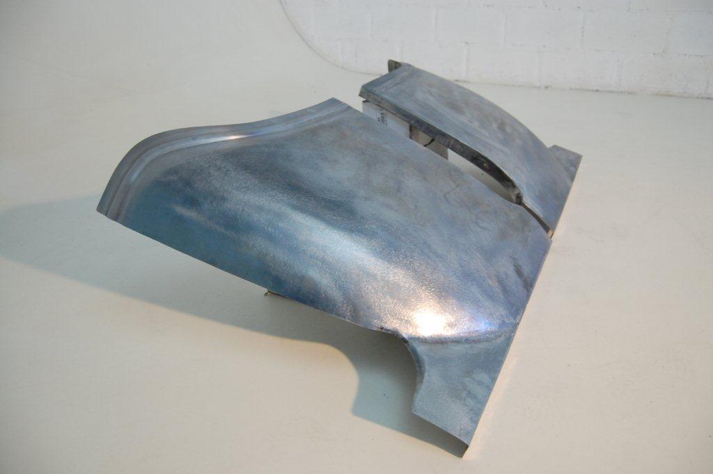

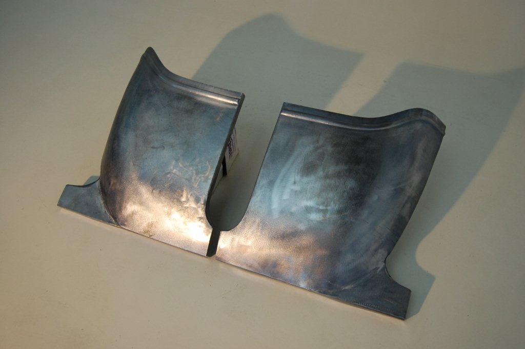

    Had to make a couple of pairs of these for some restorers recently. Turned out pretty good, and I was ahead on hours for a change!

    I set the stroke higher to do deep shrinks with my dies. Rods and Relics nice job on that panel. Lots of shape there!!

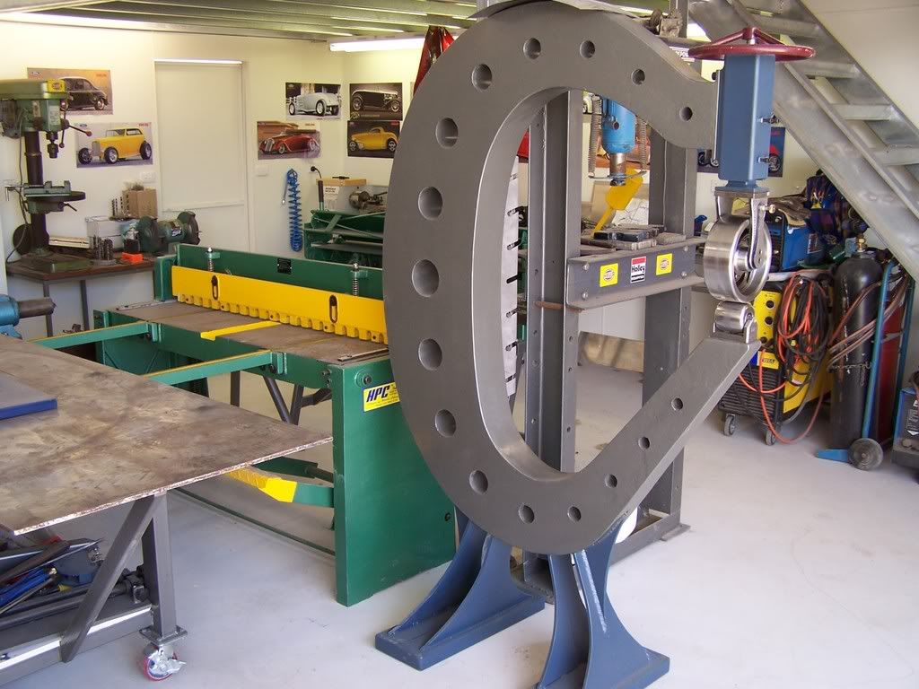

  28. gwarren007
    Joined: Apr 3, 2010
    Posts: 379
    gwarren007
    That is an impressive english wheel - whats the make of it?
  29. Rods & Relics
    Joined: Oct 7, 2007
    Posts: 280
    Rods & Relics
    I built it my self ;)
