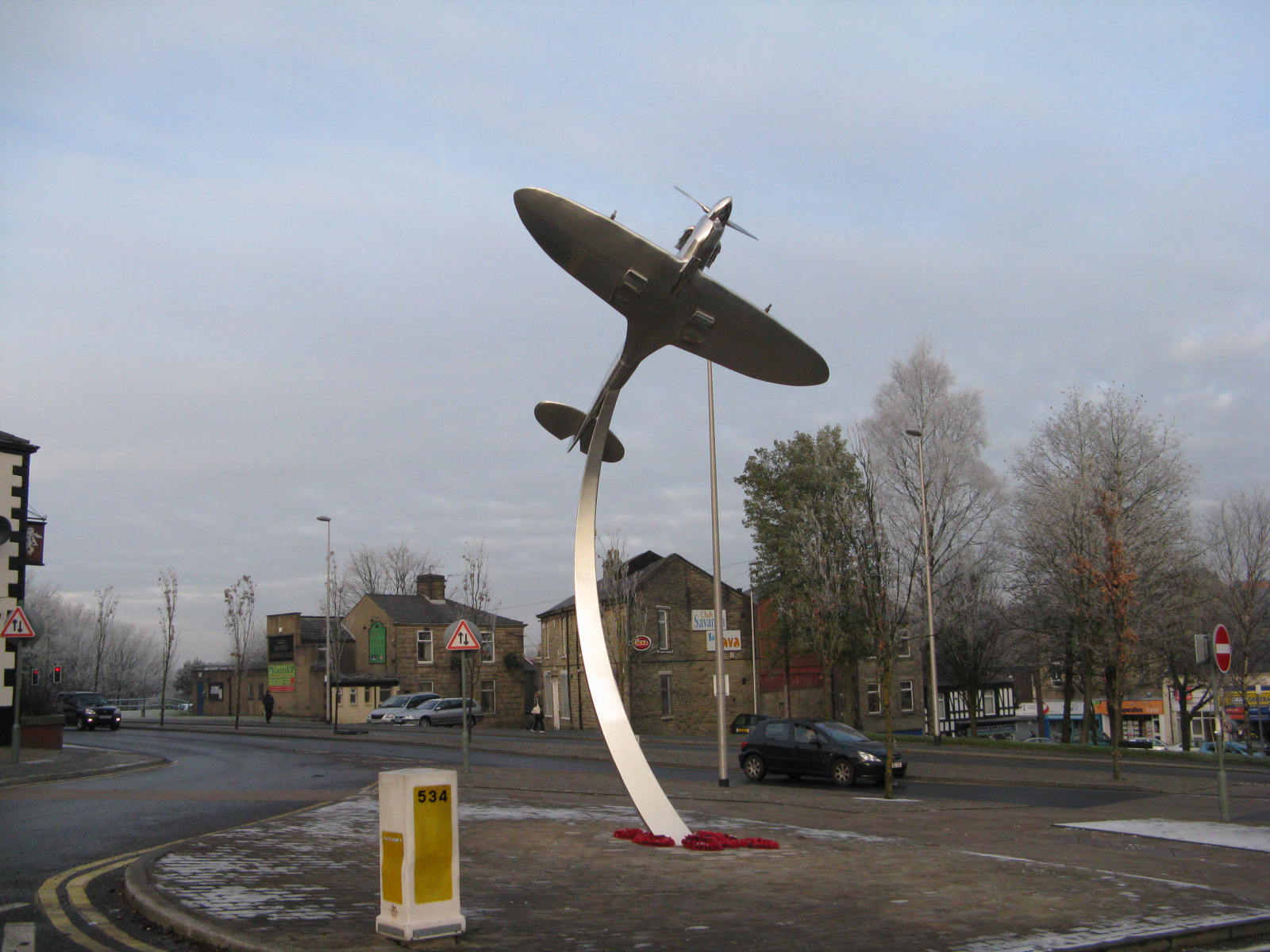

  24. CDXXVII
    Joined: Nov 5, 2010
    Posts: 149
    CDXXVII
    from Vermont
    I was in Darwen UK and I was pleased to see this Spitfire memorial that was built by apprentices in the local trade school:
