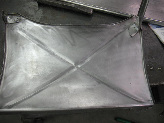

    41GASSER
    This is a heat shield for the fender well headers on my 40 Willys. Fasteners will be centered where the dimples were pressed in.
