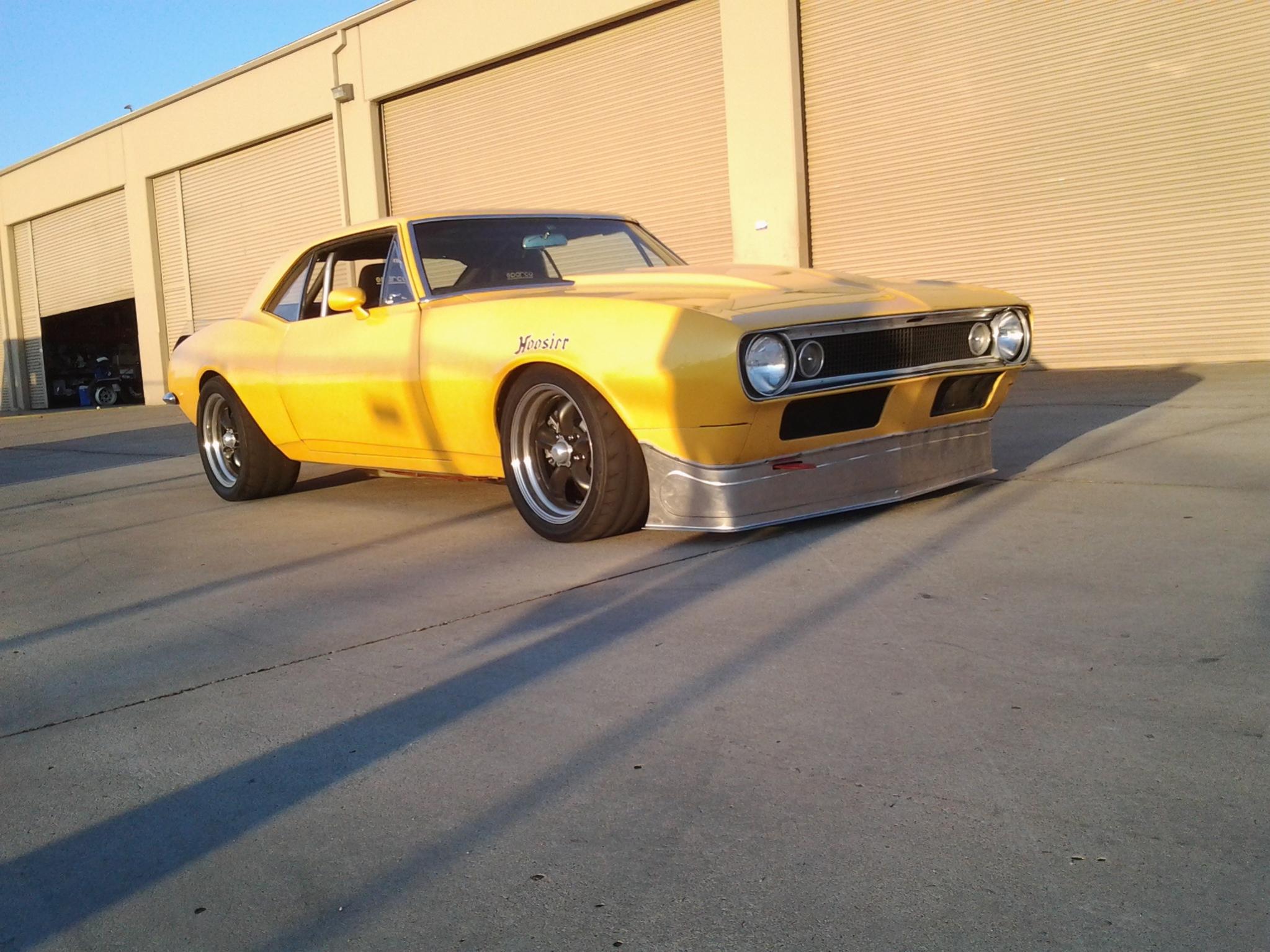

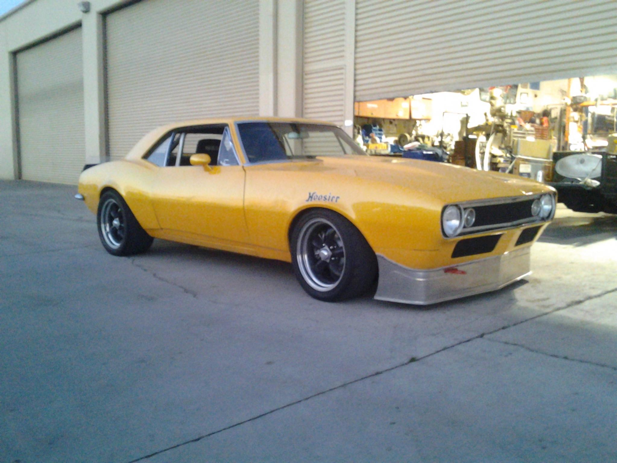

    Here's an air dam we made for a 67 Camaro. It'll be used only on the track, as it's removable with 1/4 turn fasteners

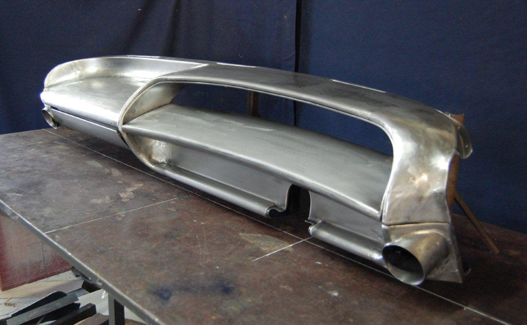

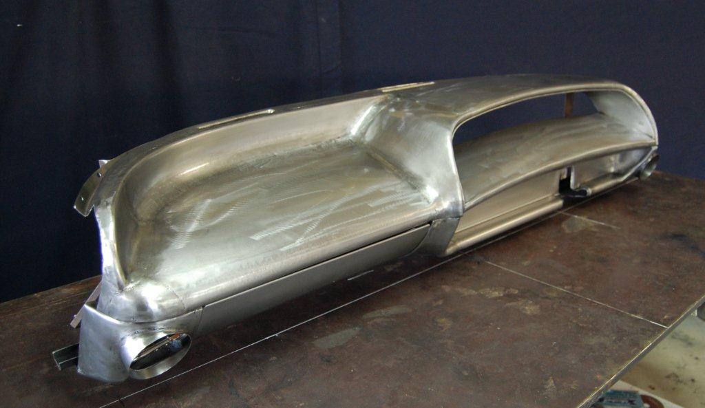

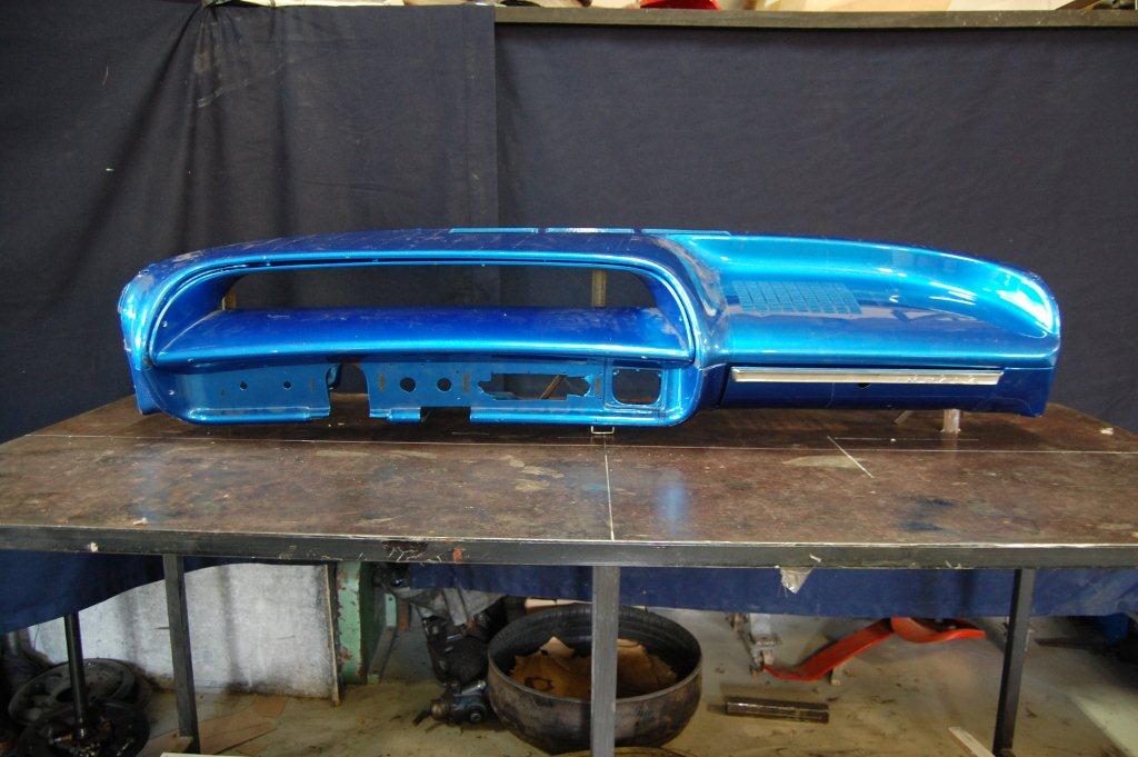

    RHD '64 Impala's apparently used a Pontiac dashboard - we were asked to scratchbuild a RHD version of an SS dashboard (with some mods)......kicked my *** for a while but got it done eventually. Budget constraints meant I didn't take this to a full metal finished state....

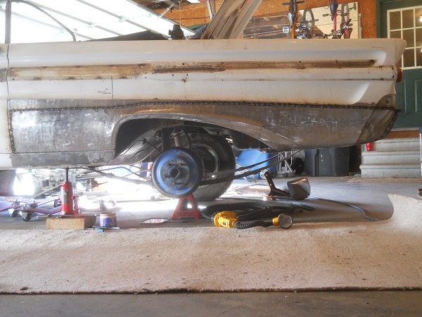

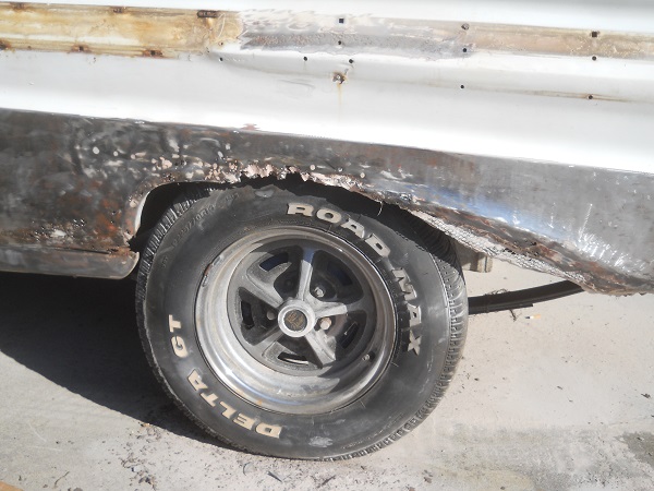

    Might as well throw my hat in the ring so here goes. Here's a hand made 64 Comet lower quarter I did a year or so ago - before:eek: and after:D. No pro but pleased with the results.
    Dan

    Cool Dan :D
    It's all about having a go ;)
