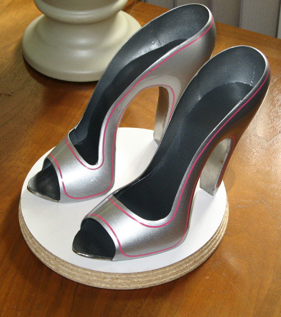

    I finished the "hood ornaments" for my '46 Ford pickup race car tow vehicle - a pair of heels ***led "Built for Speed". They will adorn the bed cover and serve as a handle to lift the cover, whilst at the same time showcasing my metal art capabilities. Let's face it - most women can look at a chopped top pickup cab and not appreciate the work involved but when they see these shoes the typical response is, "Where did you get those shoes?", and then, "Can I get them in my size?"

    I think you've found the easiest way to get all the females at the shows to crowd around your truck. Awesome, beautiful work! :D

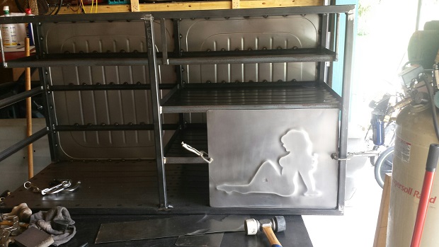

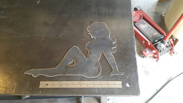

    Here's one for critique. Not up to par with most of this work posted here, but a neat little trick I'm sure some can use. I have a little side work here and there building dog boxes, tool boxes, truck tool boxes, etc for guys that just want a little something different. Generally just simple bead rolled panels, etc, but I've fooled around with flames rolled in, etc, until this last request. Decided to play with the trucker girl logo and try to stamp panels if I could, so sketched up a silhouette, cut it out of plate, then a little heat, little hammering, etc and success. Just a pic of the first test panel, but I'm fairly stoked with the result, so thought I would share.
    oldgoaly likes this.

    Big_dan are you hammering around the edge with a soft hammer or corking tool? I have done embossing with male and female dies like the running boards a few posts above yours but i have not done it with just a male die.
  27. big_dan
    Joined: Apr 21, 2013
    Posts: 56
    big_dan
    from Tennessee
    wingedexpress - I used a soft mallet (rubber) with a little heat applied. Take it really slow at first; I tack the "die" to my shop table then scribe marks to keep myself aligned and prevent doubling any areas. Hope this helps.
