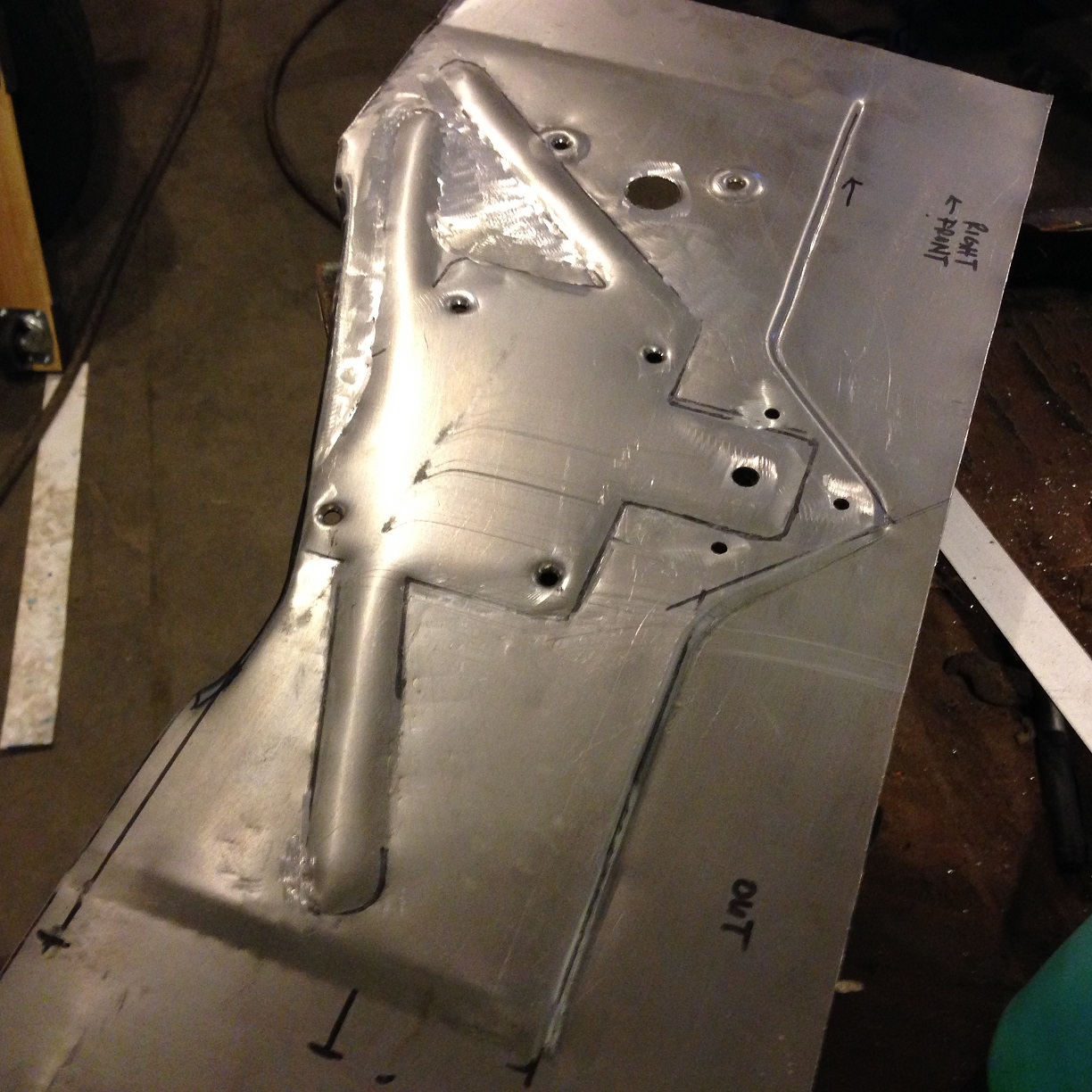

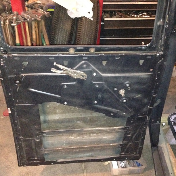

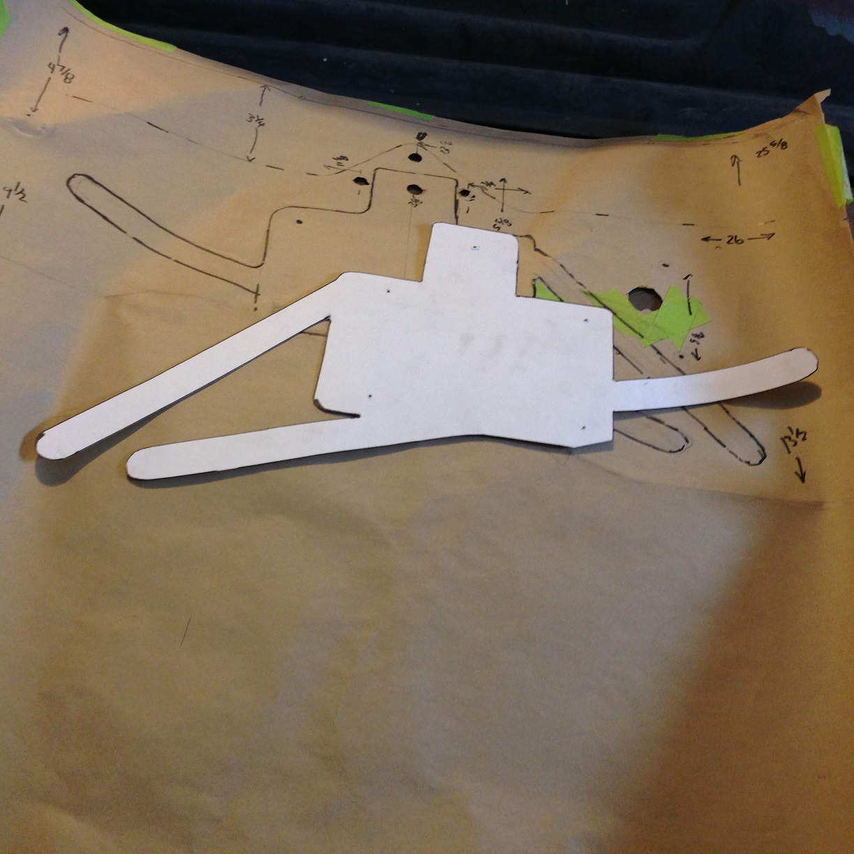

    Spent the afternoon making inner door panels s for my 32
    Someone decide these were not needed- torched em out
    started with a pattern
  3. rcnut223
    Joined: Oct 12, 2006
    Posts: 1,282
    rcnut223
    from wisconsin

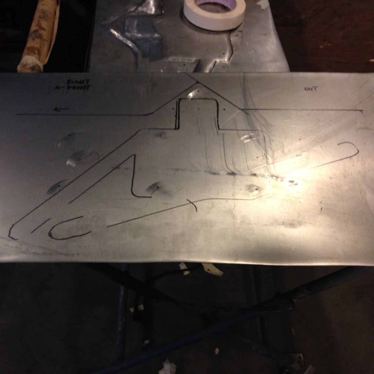

    Next I transfer the patterns to sheet metal. Marked and drilled the regulator holes and door remote with 1/8 bit.
    Also made a wood pattern of the raised area on the panel. Taped that to the back side
    Used a rivet set and chisel to trace and chase the pattern into the metal
    Bead roll to make the top relief .
    Next week repair install the panels

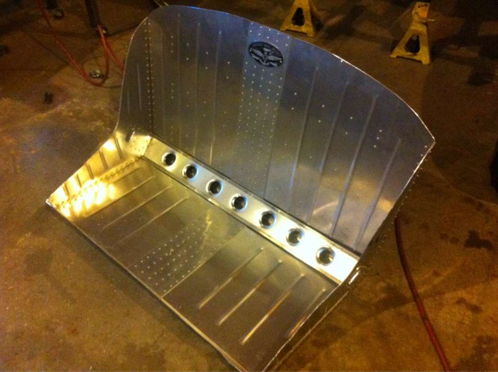

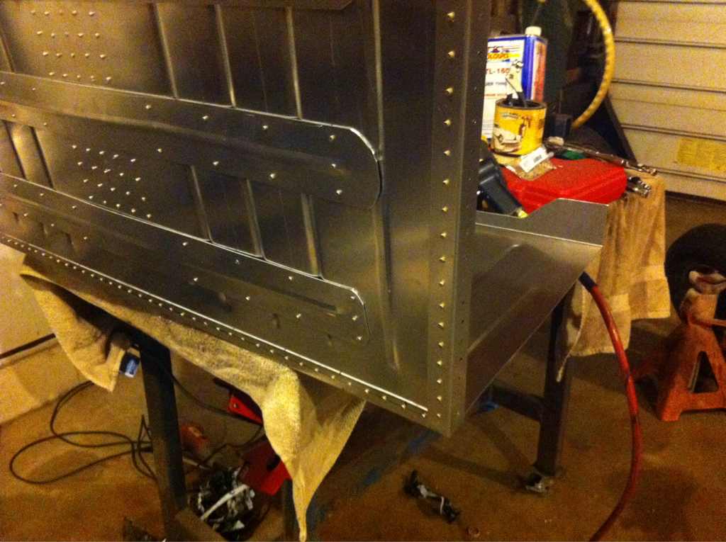

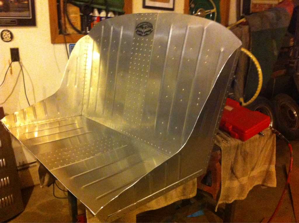

    In the process of making a bomber bench seat with custom etched tag for my roadster project. Still in the process, but almost done
    stealthcruiser likes this.
  6. HomemadeHardtop57
    Joined: Nov 15, 2007
    Posts: 4,340
    HomemadeHardtop57

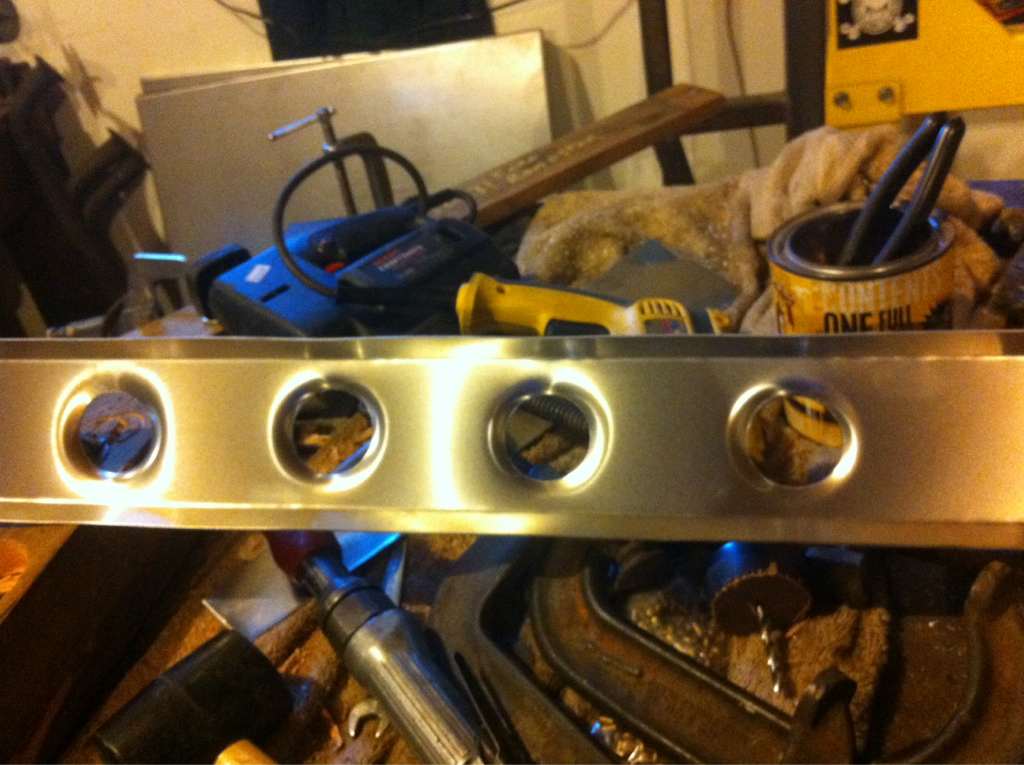

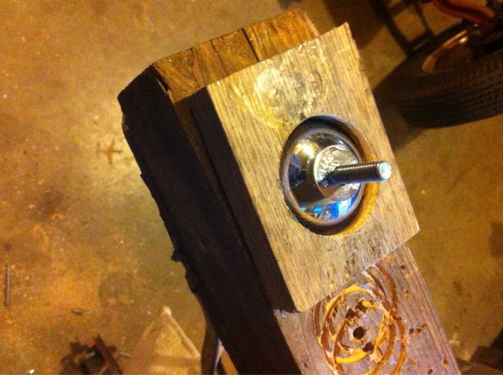

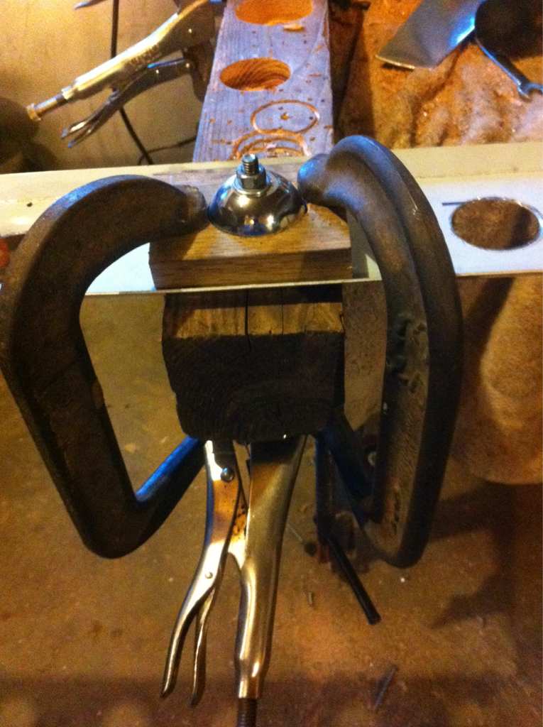

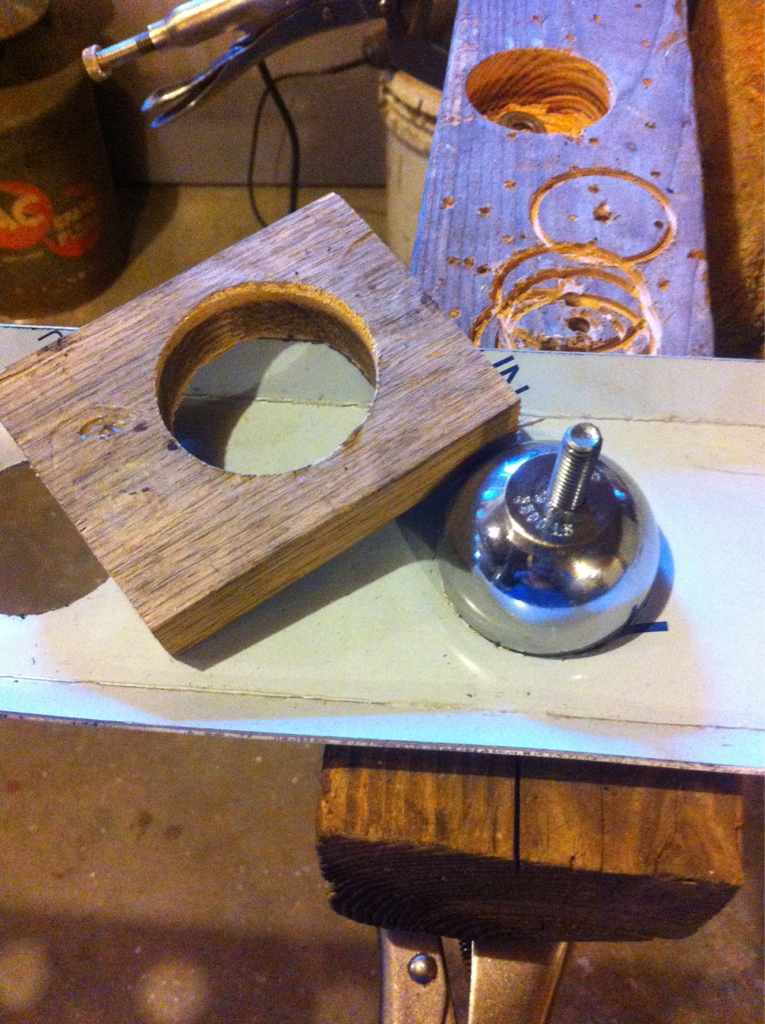

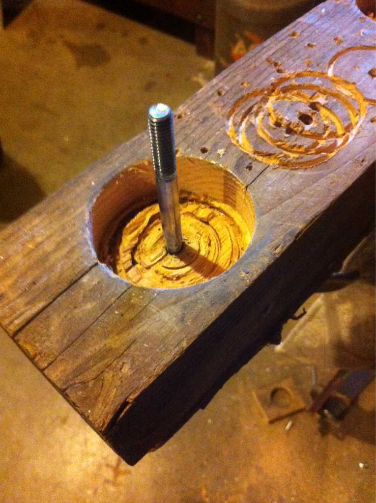

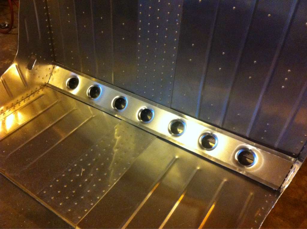

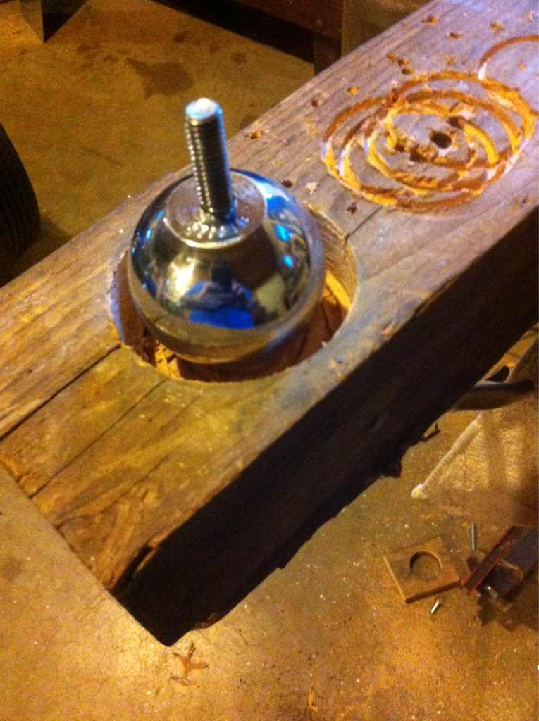

    Made a hole flare die out of some wood and a cut down trailer hitch ball for the seat pieces
    ImageUploadedByH.A.M.B.1418005443.386757.jpg ImageUploadedByH.A.M.B.1418005458.102427.jpg
    ImageUploadedByH.A.M.B.1418005514.563823.jpg ImageUploadedByH.A.M.B.1418005526.613834.jpg

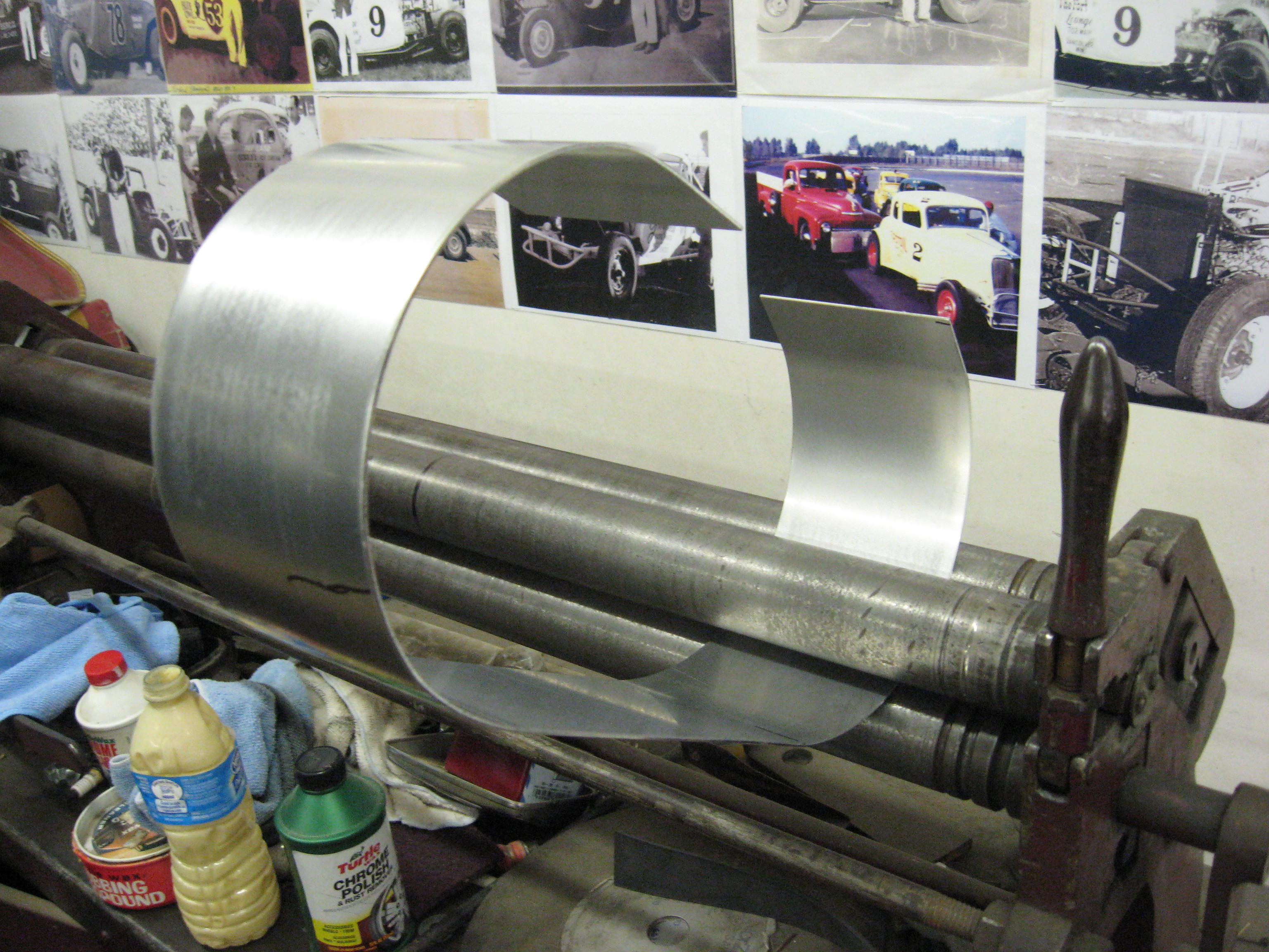

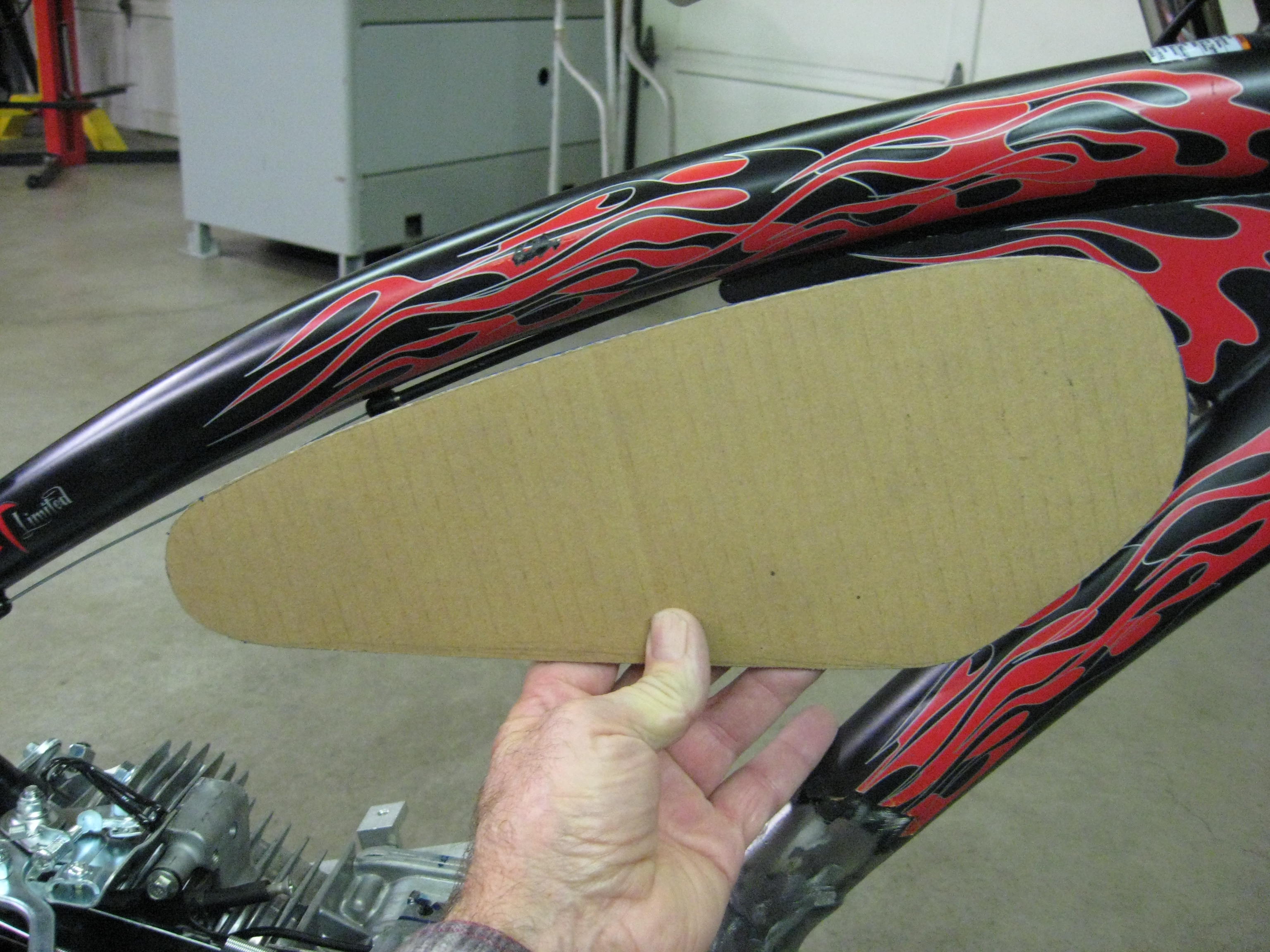

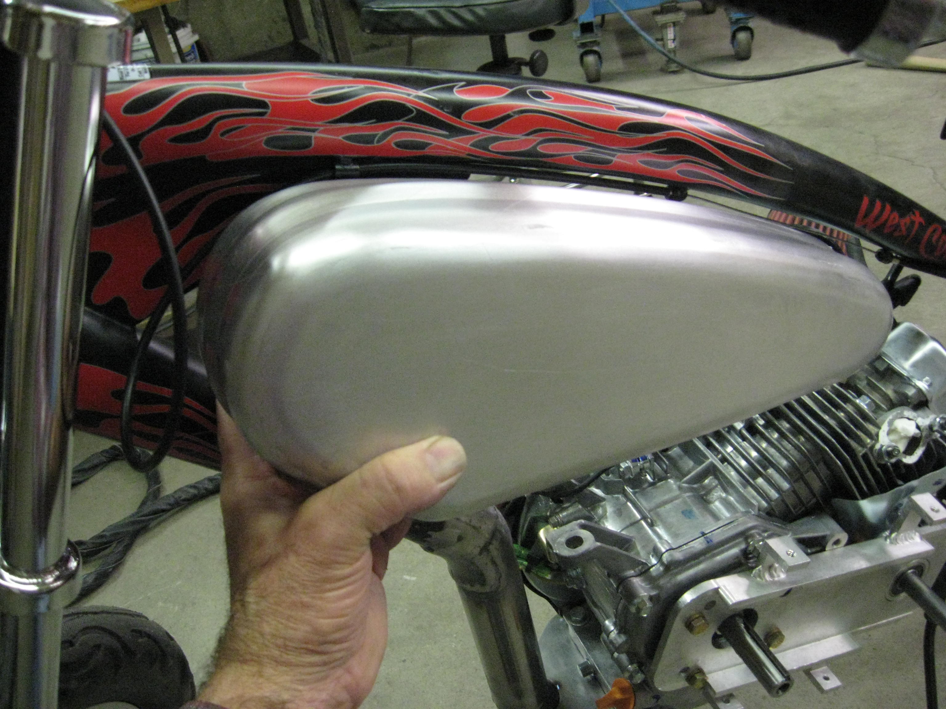

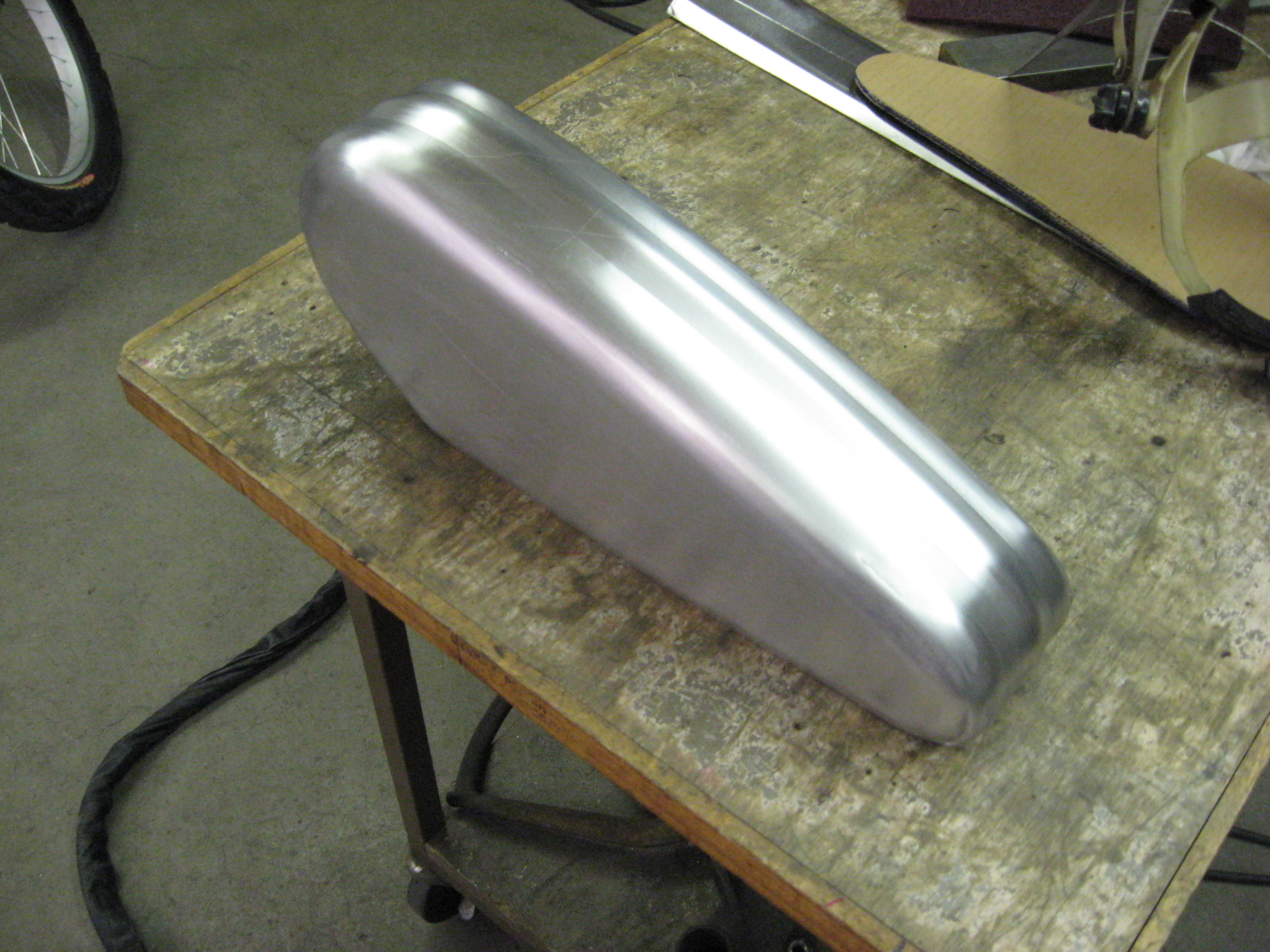

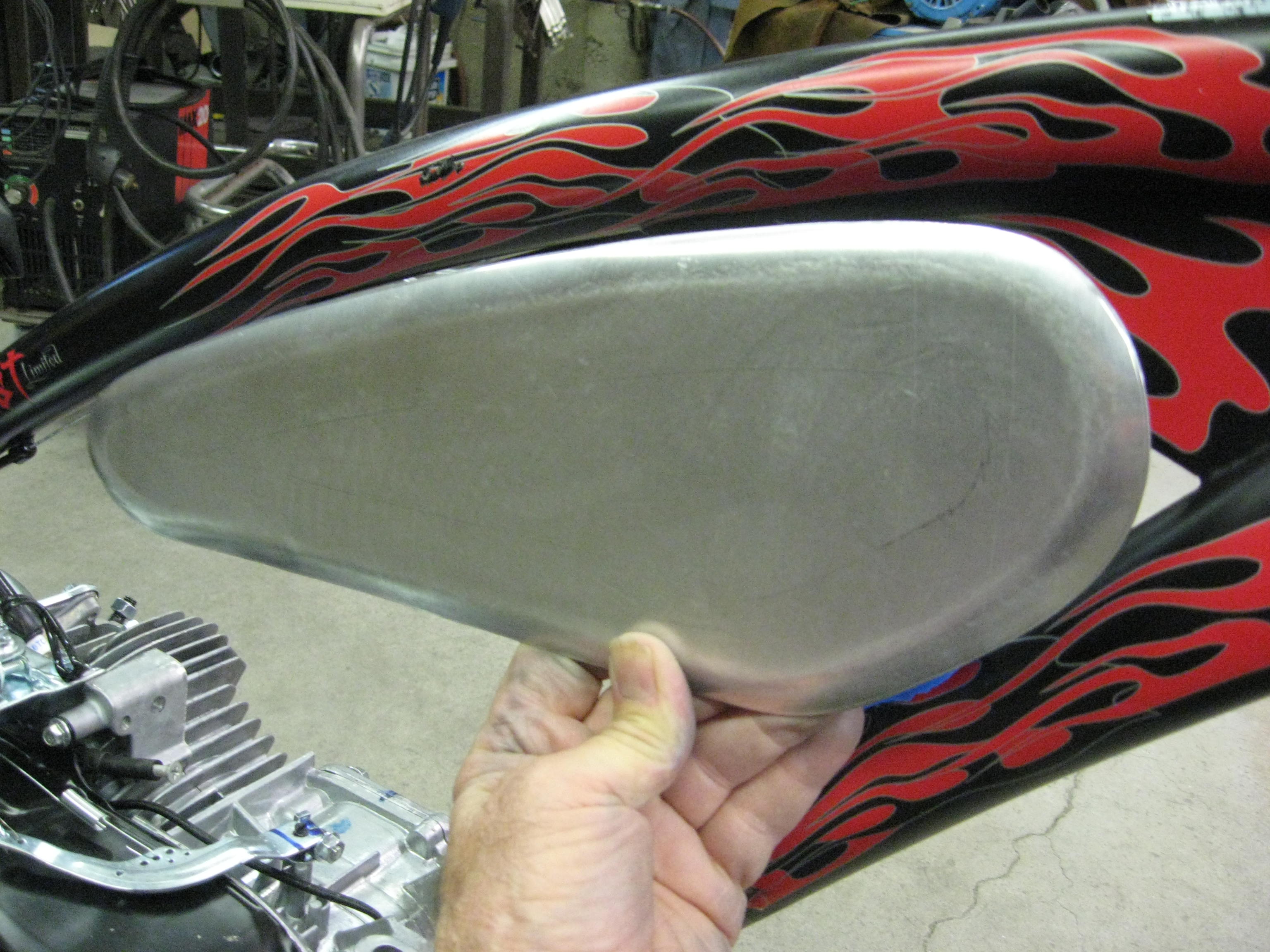

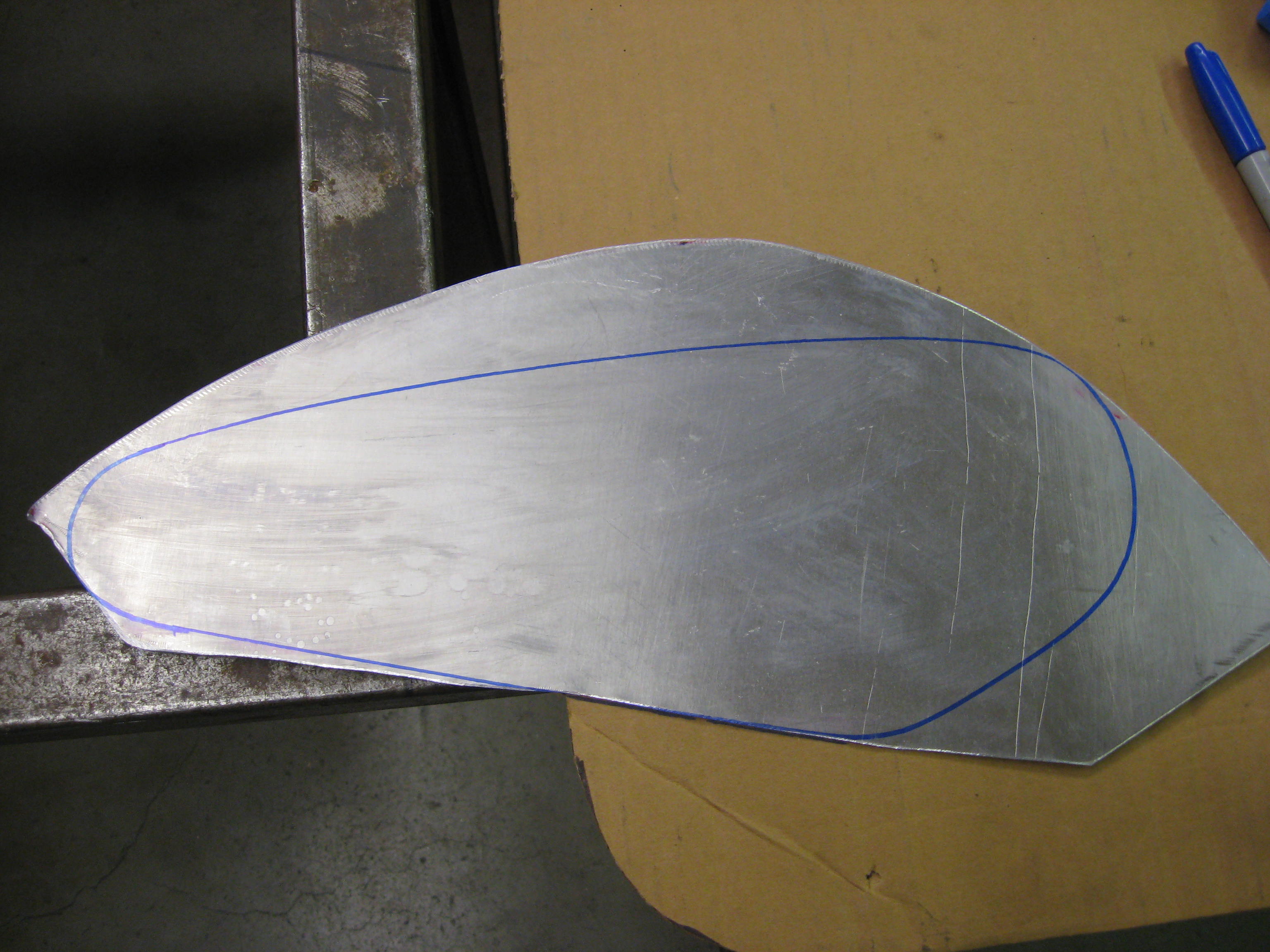

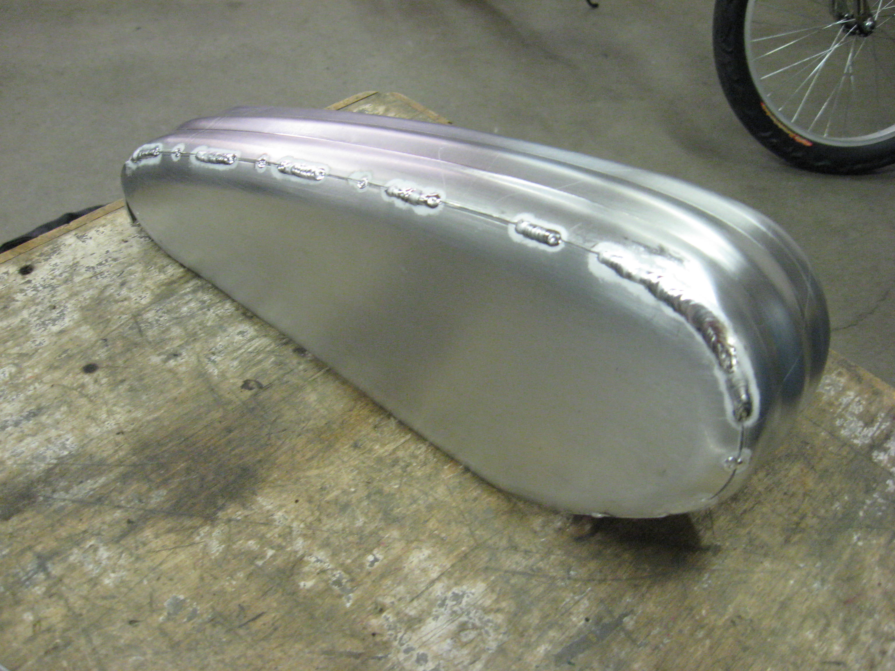

    I am building a motorized bicycle and wanted to build a gas tank that resembled something on a vintage "Speedway Bike". It might be a little OT, but it is metal shaping and welding on aluminum, and this will be my transportation at Bonneville next year. The material is .063 thickness and 3003 alloy. I regret not getting a pic of the tank roller dies and the bead roller, that is how I turned the edges on the sides and main shell of the tank. The Tig filler rod used was 1100 series, it seems to file and sand quite well. IMG_5030.JPG IMG_4998.JPG IMG_5001.JPG IMG_5022.JPG IMG_5024.JPG IMG_5025.JPG IMG_5034.JPG IMG_5033.JPG

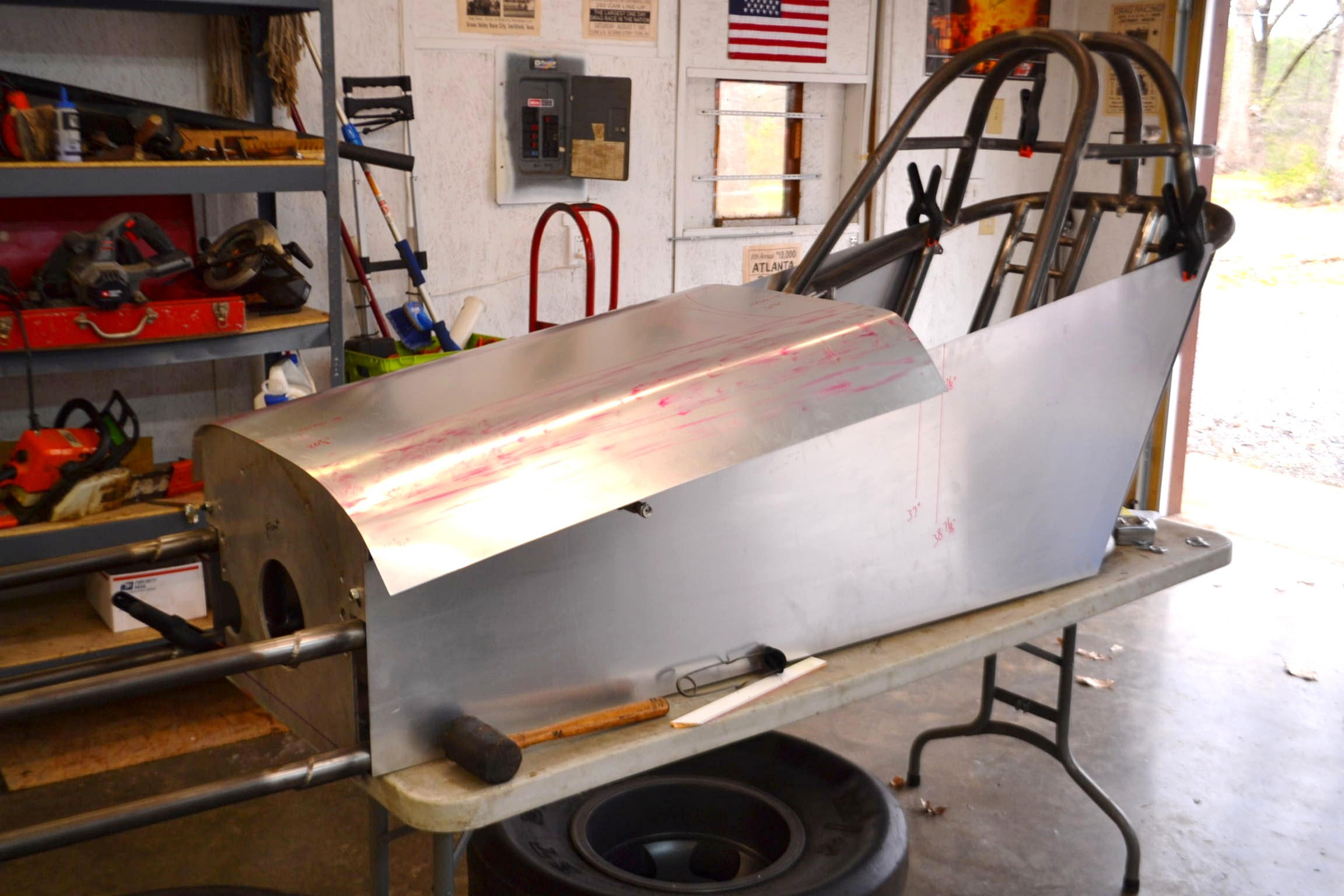

    I am a poor Rookie!! Never shaped anything but...I did make the cowl for my new Front Engine Dragster--bent it over a drive shfat that was stuck in the vise and just kept "coaxing" it until....
    You guys are amazing!

    Yup Marty, I did the same thing and also added a faux "oil tank" and some chain guards. But yours is nicer and blends well with your frame.

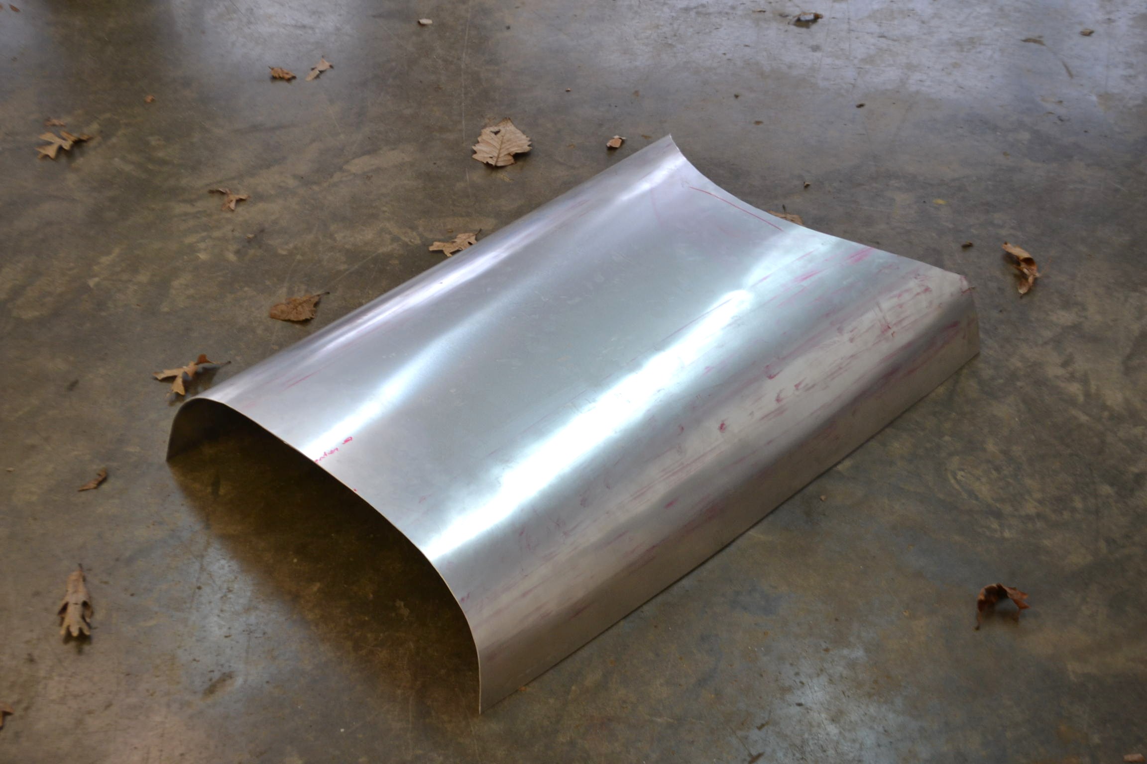

    I built a Bonneville car for a friend of mine this year. The final touch was an air intake scoop. Here again I used .063 - 3003 aluminum, plenty of pics. IMG_4534.JPG IMG_4539.JPG IMG_4540_1.JPG IMG_4542.JPG IMG_4548.JPG

    Frenchtown, that's a cool bike. Thought you might want to see the tank mounted on the bike. IMG_5163.JPG

    Gorgeous work! Thanks for showing the steps and rolled edges!

    Dave, That Dragster cowl looks great ! I sorta cheat when it comes to forming cowls and panels. IMG_4203.JPG IMG_4204.JPG

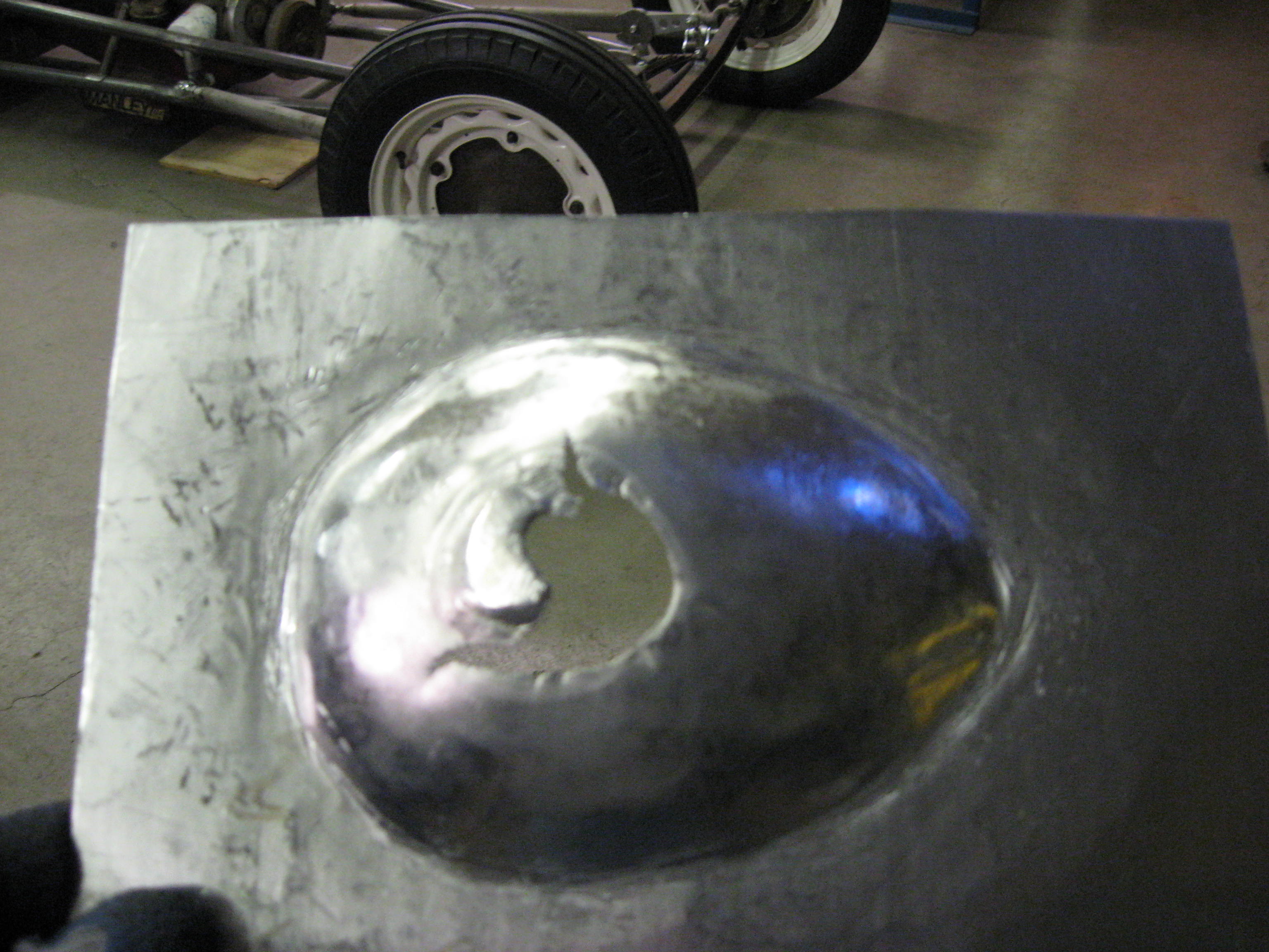

    This is a simple cowl steering bubble I did a while back, you will notice that I got too aggressive when burning off the carbon, during the annealing process. My thinking, was that I was trying to learn this stuff, so I tried to save it. I could have made a hammer form to control the shape, but I pounded it on a bag, and shaped it with a cheap planishing hammer. More pics to follow. IMG_1675.JPG IMG_1676.JPG IMG_1677.JPG IMG_1681.JPG IMG_1683.JPG IMG_1685.JPG

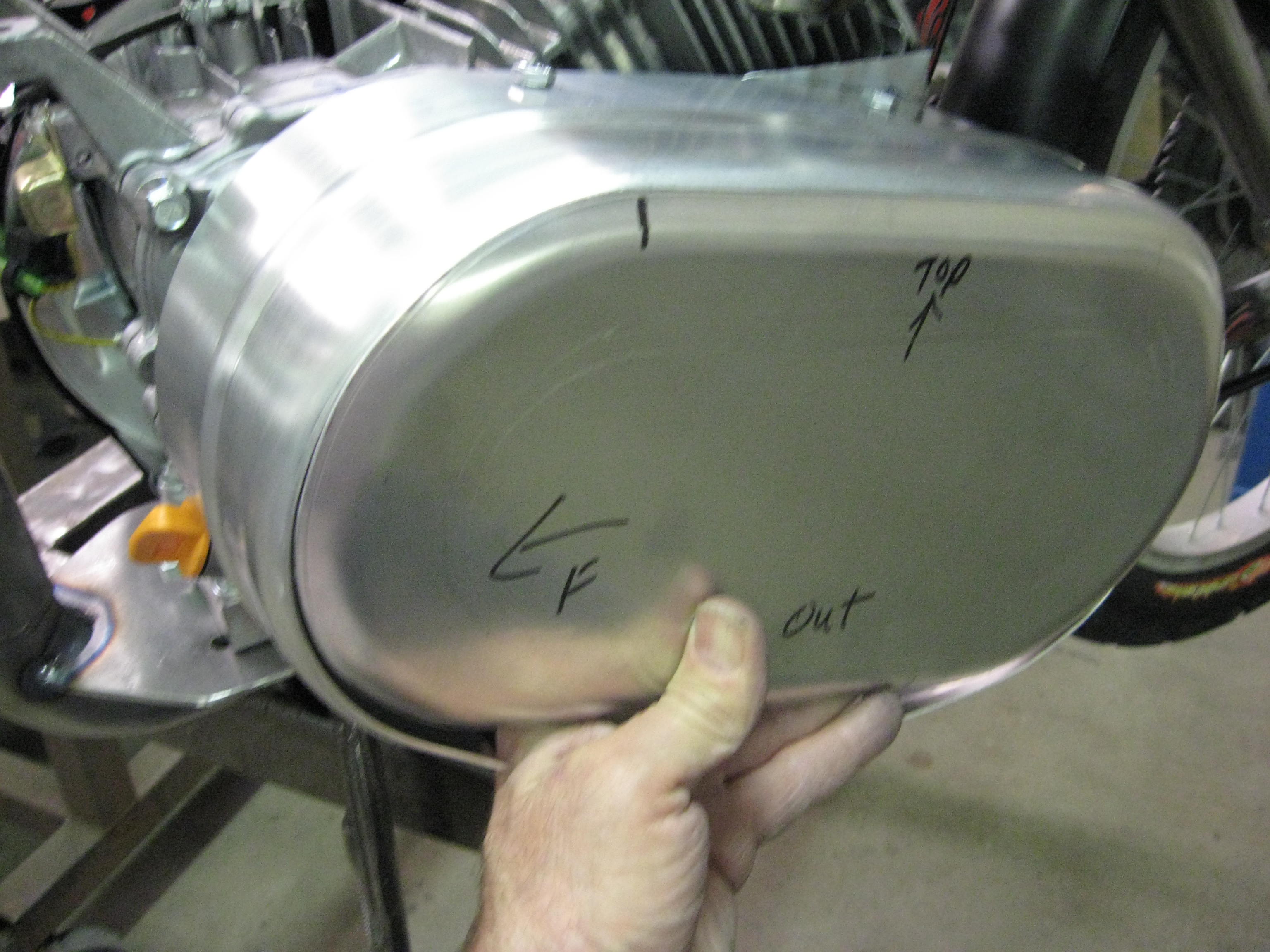

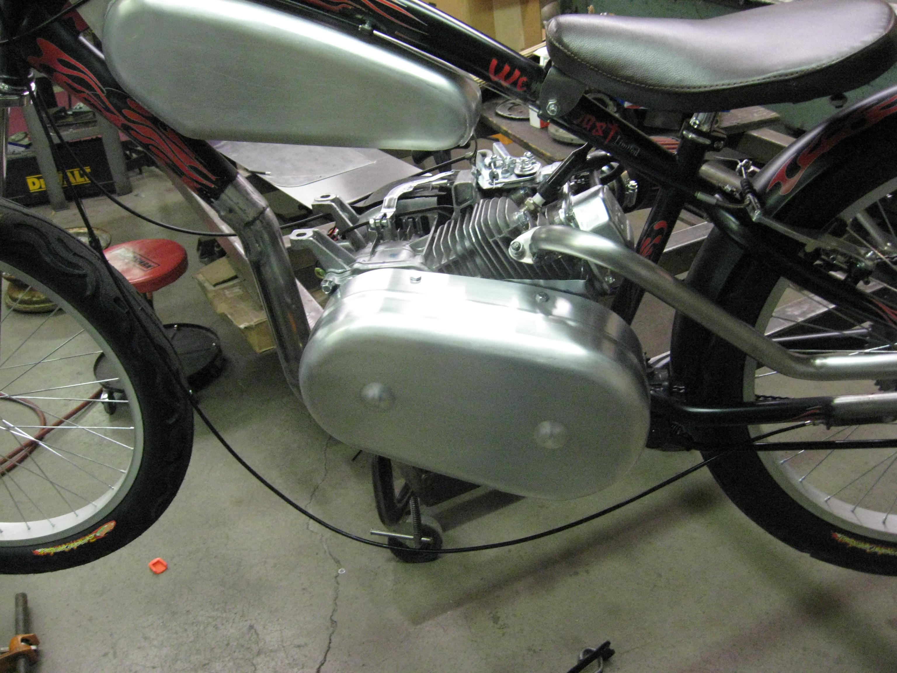

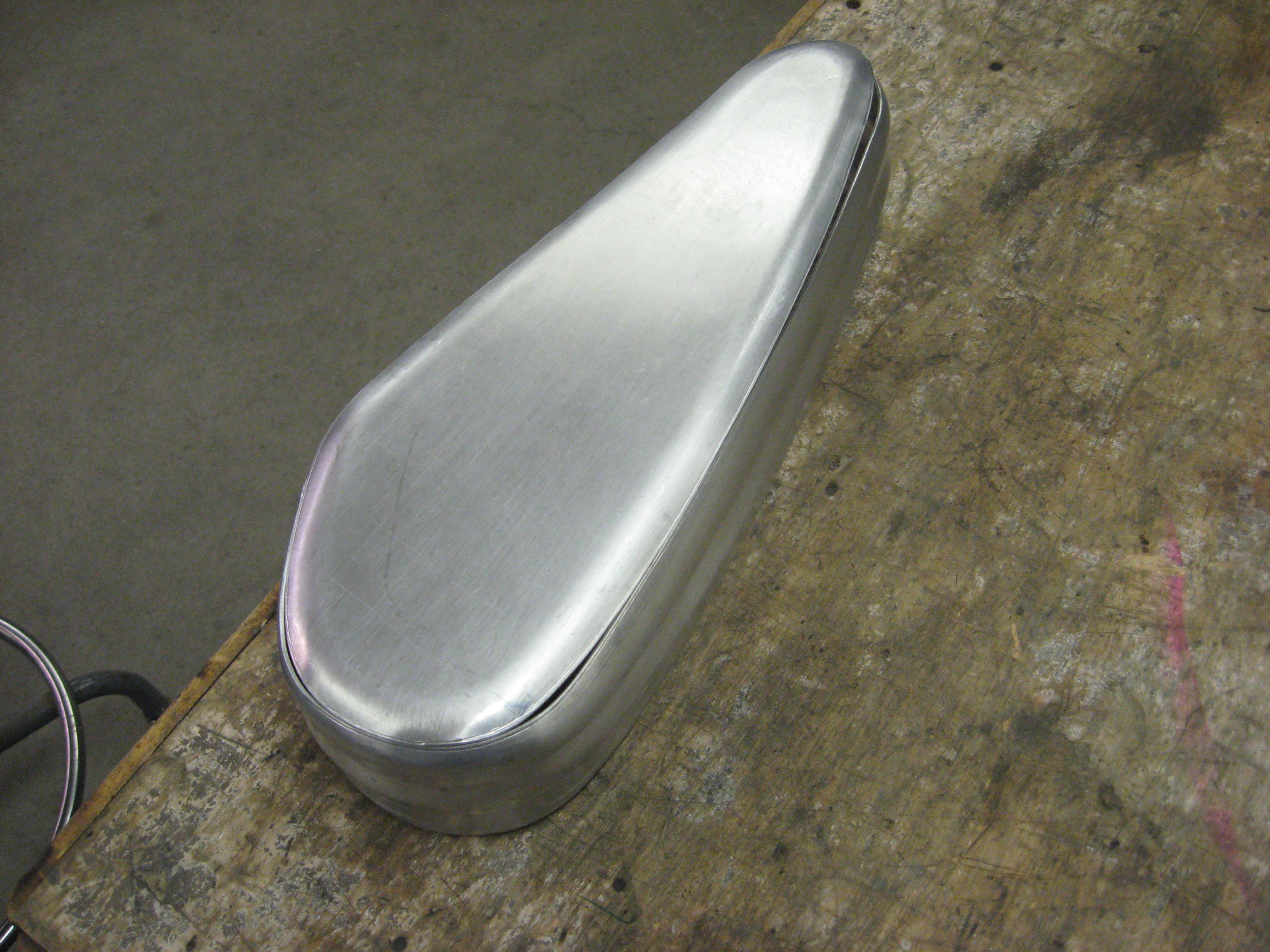

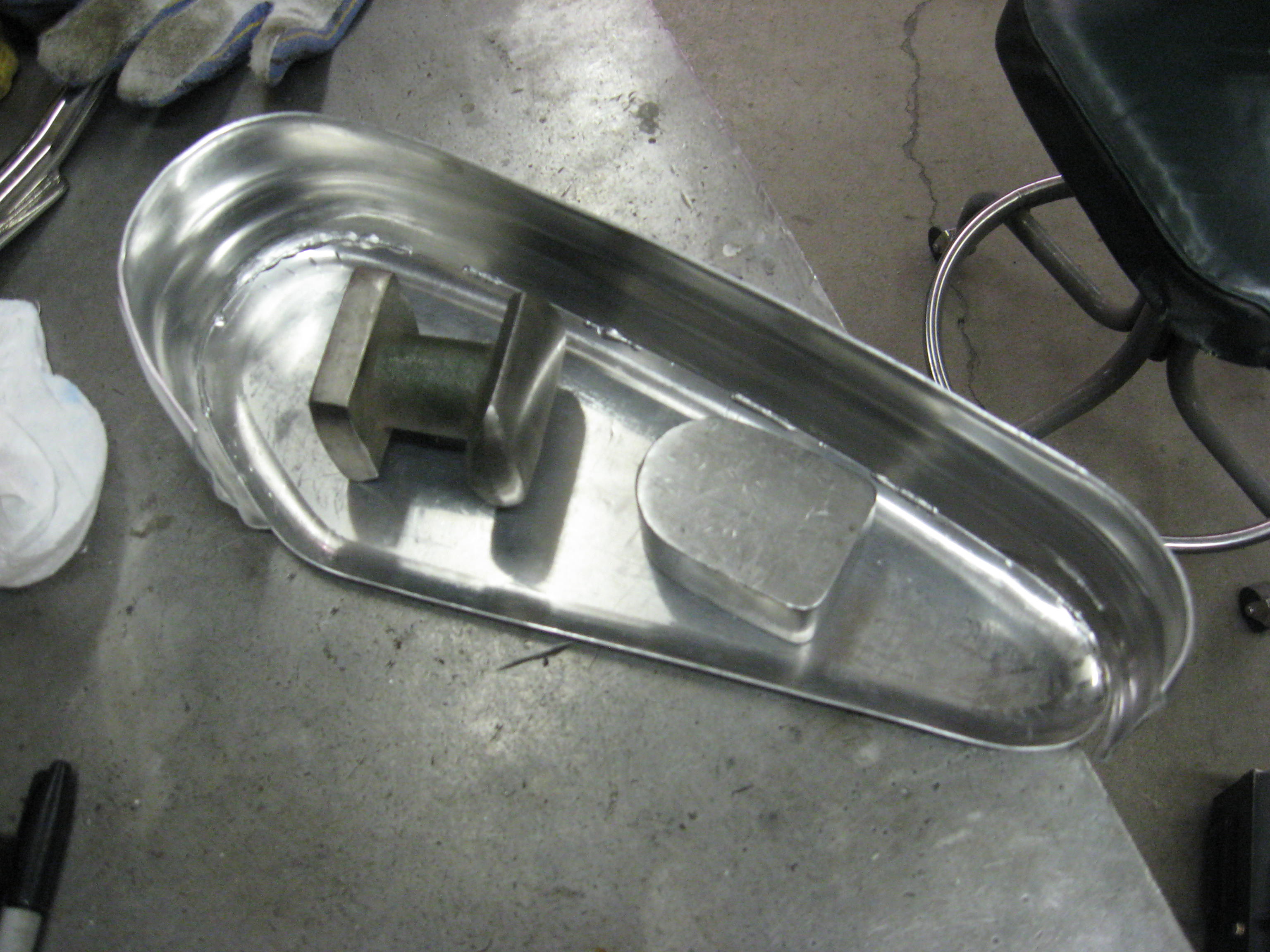

    Here is another part out of .063, 3003 aluminum. It's a belt drive cover for my motorbike, however if you lay it flat, it could be an air cleaner for multiple carbs. Simple steps, make a pattern of the outline, and roll a 4" wide band to fit the shape. Run both parts through the tank roller die, followed by a p*** with the 1/2" bead, for stiffness. IMG_5262.JPG IMG_5263.JPG IMG_5265.JPG IMG_5267.JPG IMG_5267.JPG IMG_5269.JPG
    Rastus likes this.
  30. Marty Strode
    Joined: Apr 28, 2011
    Posts: 9,706
    Marty Strode
    More steps, check for perimeter fitness. Add a couple of dimples, using an old headlight swivel base and the ball on a vice handle. Weld it up and grind to finish. Now I have to build an air cleaner for the tri-power on my 40 Ford pickup. IMG_5270.JPG IMG_5271.JPG IMG_5273.JPG IMG_5274.JPG IMG_5276.JPG
