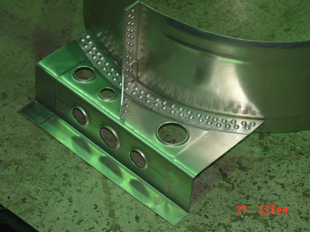

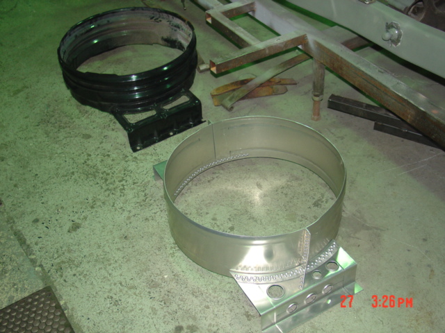

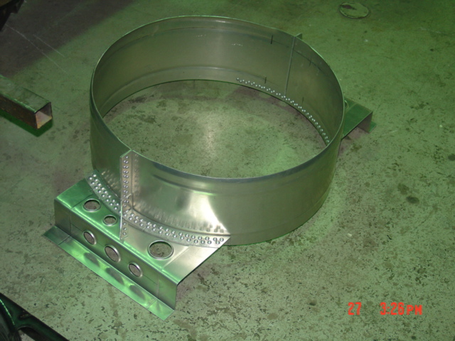

    I built a fan shroud for my '53 Ford COE. Using the newer ch***is, the engine is mounted with some offset, requiring the opening to match. The material is .063, 5052 alloy aluminum. IMG_5643.JPG IMG_5644.JPG IMG_5646.JPG IMG_5648.JPG IMG_5662.JPG IMG_5663.JPG IMG_5665.JPG
