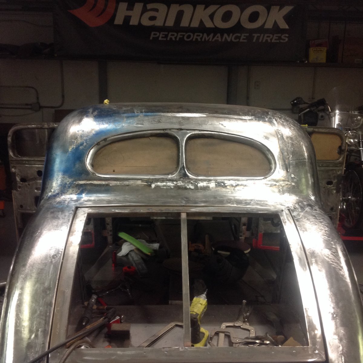

  4. Wanted a split rear window for my project.
    Started off with a sliced diced stretched 36 ford coupe rear window.
    Drew up the curves I wanted against the existing framework.
    Center punched the bend lines and cuts
    Combination of tipping wheel, vicegrips, post dolly and hammer gets here.
    Tipping wheel could have been left unused and done all with vicegrips and post dolly and an improvised dolly.
    Welded in the center section and staring the cut in process
    Tacked in. Getting cardboard temp lets for filler pieces
    One side fit in

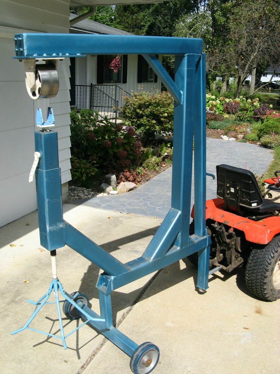

  8. MP&C
    Joined: Jan 11, 2008
    Posts: 2,574
    MP&C
    First off, yes, it's still bolted to the pallet.
    And the more I thought about it I just couldn't bring myself to use fabricated legs. So today was spent driving a 5 hour round trip to pick up some suitable legs..
    Here's the lower plate, and by my estimation I need about 4 inches of rise, so it will get some riser plates between the bottom plate and top plate..
    More to come..... need to find a nice bright color that will have Peter in sungl***es for his next visit.. :D

  10. MP&C
    Posts: 2,574
    MP&C
    Finishing up on the English wheel, the legs are bolted on with 1/2" bolts with nuts welded inside the riser.
    The wheel is held on with 3/4 bolts, with nuts welded inside the top plate of the riser.
    The John Deere lift device....
    The wheel is set up at 48-1/2"
    We wheeled a couple s**** panels, crushed some tucks, tipped a panel. Very pleased with the new wheeling machine.
    wraymen, oj, whtbaron and 2 others like this.
