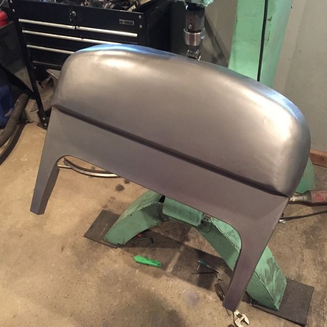

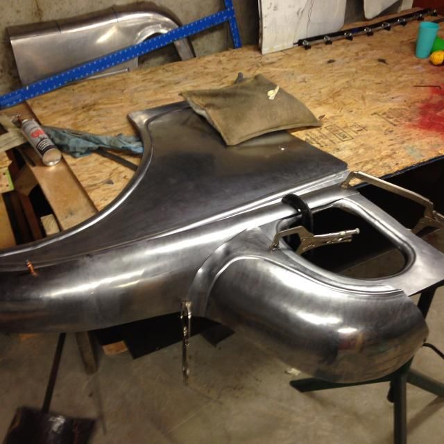

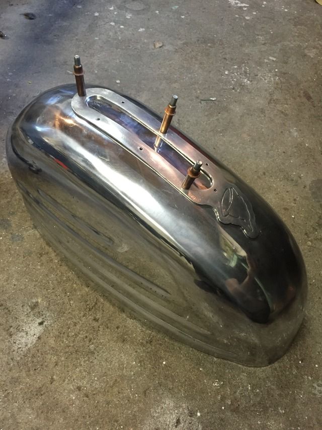

    just a hobby guy here but i love metalshaping
    cafe tail
    airstream i made
    console for my truck
    t bun panels
    [​IMG] most of a T[​IMG]
    t firewall
    parts of a 34.

    That's some topnotch stuff for just a "hobby guy"!

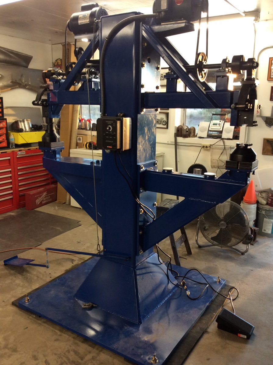

    NOW I NEED TO GET IN SOME TIME ! BACK TO SCHOOL ?
    Just setting it up right now .
    MP&C, 36 ROKIT, bct and 2 others like this.
  11. oj
    Joined: Jul 27, 2008
    Posts: 6,590
    oj
    Holy****!, whats that a Yoder & PullMax on a single mast?
  12. JOYFLEA
    Joined: Jan 22, 2013
    Posts: 2,056
    JOYFLEA
    Mittler Bros. power hammer . Copy of Yoder . I got the double head so I can leave the shrinking dies on one side and only need to change the dies on the other . Blue

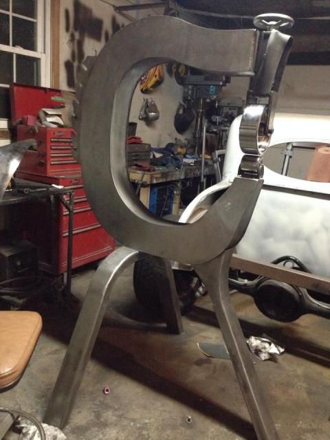

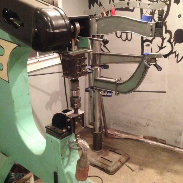

    built every ounce of my machines except the air motors which are CP clones. I built a pullmax style machine, a wheel, and a planisher... building another planisher now. But in reality you don't need all the fancy stuff it just makes the job quicker.
    http://i76.photobucket.com/albums/j10/low88/59515791-F9CD-483E-B5E2-ECBE76DF64BA_zpsni4yib6o.jpg[​IMG] [​IMG]
    Curious why ones VFD driven and ones Belt Slip? which do you prefer.
    biggeorge, 1952B3b23, 54reno and 4 others like this.
  15. JOYFLEA
    Posts: 2,056
    JOYFLEA
    The VFD is new forMB and they made me a deal on it . I haven't had it long enough to make a choice yet although I can slow it down to a speed I like at full pedal and leave it floored and work a big panel and not have to worry about speed control . I played with a door panel with it last night and the response was nice speeding up in center . Very predictable. I guess it's probably what you get use to . Time will tell and I'll let you know .
    ? For you. I got some blank dies I want to insert some home made blanks for bead lines . What width would you use ? Blue

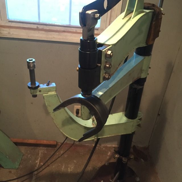

    What's the purpose of the second movable arm on your planishing hammer? I'd like to build one but im still trying to come up with the design i like. Thanks.

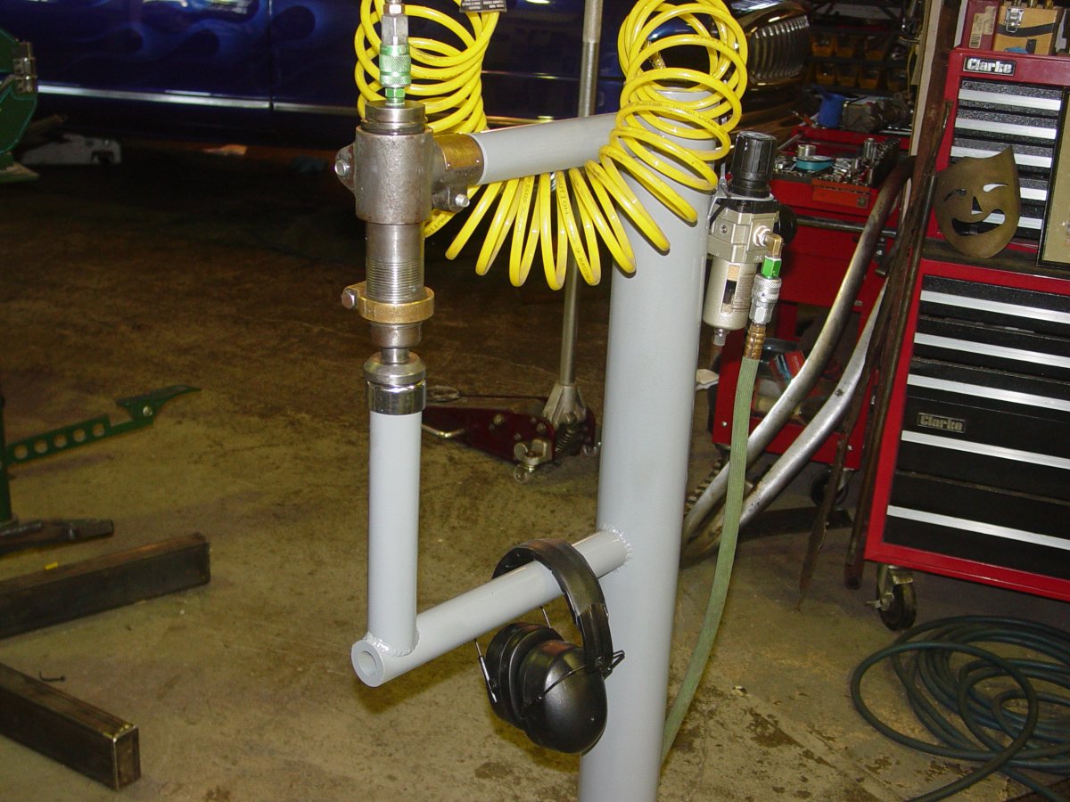

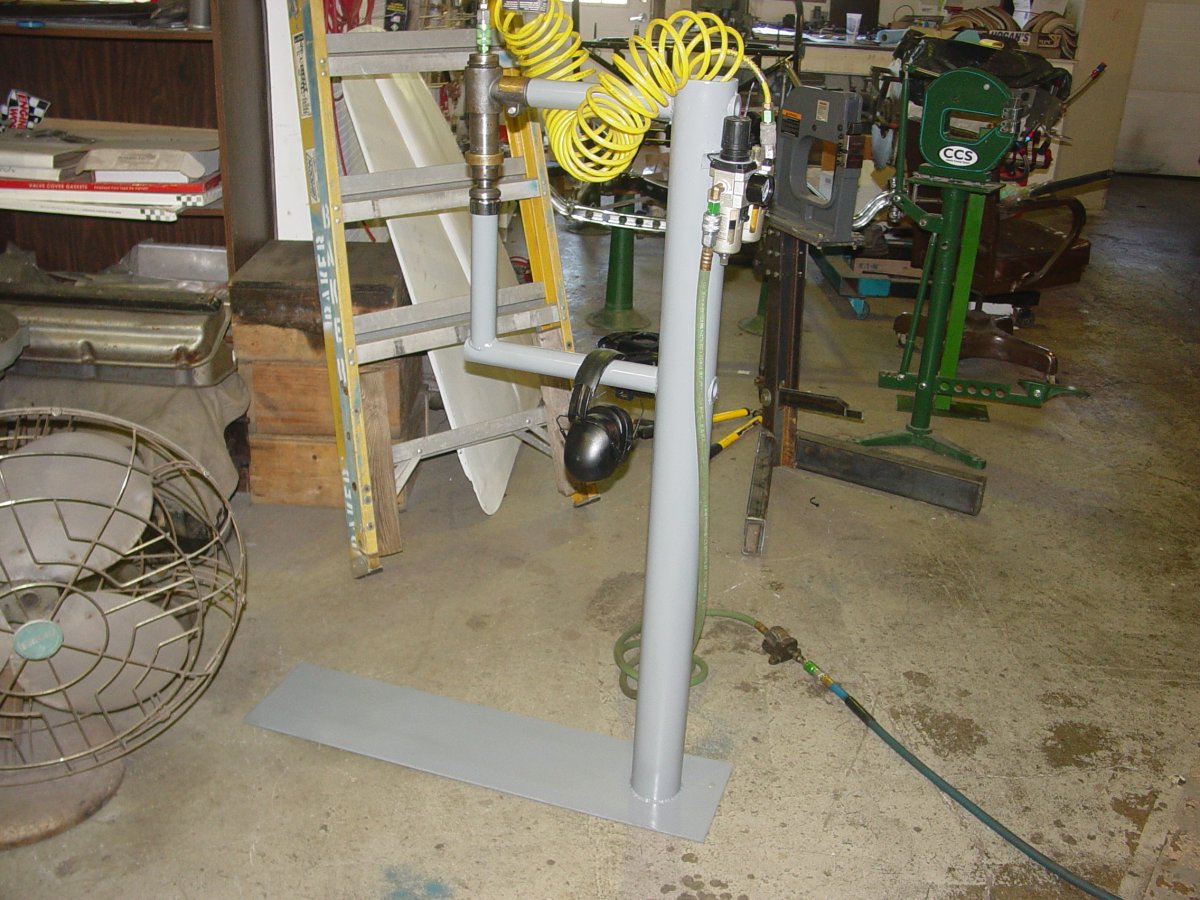

    Here's my Rams Head, I didn't think I'd need to get very deep in a panel. The arms are 1 5/8ths DOM with .375 wall. Very stout. The pics are from when I first made it and the hose from the regulator/oil supply to the head was temporary. DSC00368.JPG DSC00367.JPG

    Chris there's quite a few situations, especially with u shaped Parts where the lower arm just won't work. Here was one.
    Also been building another hammer for my cp type 1 head

    I love rams heads... super easy to adjust height, awesome looking machine

    Thats some clever thinking, I like it.

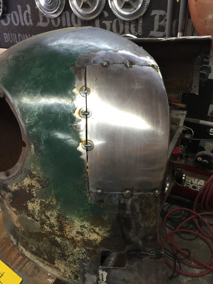

    Amateur just learning. It is a patch panel for my 41 ford PU front fender.

    Thanks for the info, very clever idea! Both of the hammers look great. Where did you buy the head for the green colored planisher?
