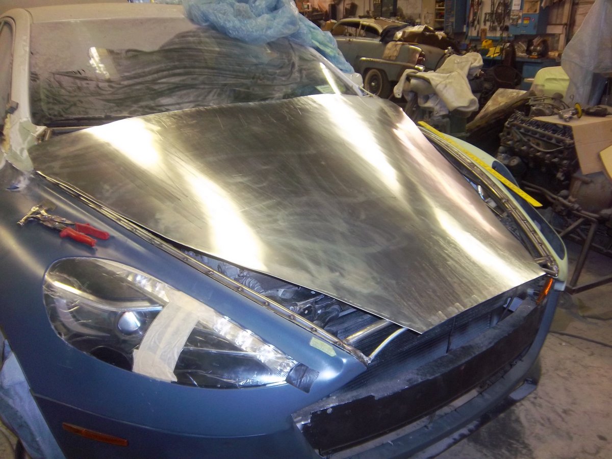

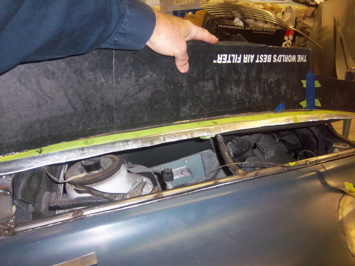

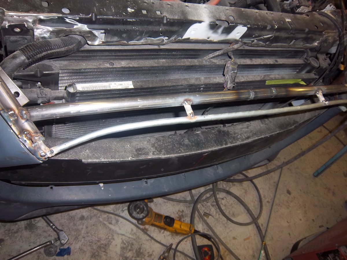

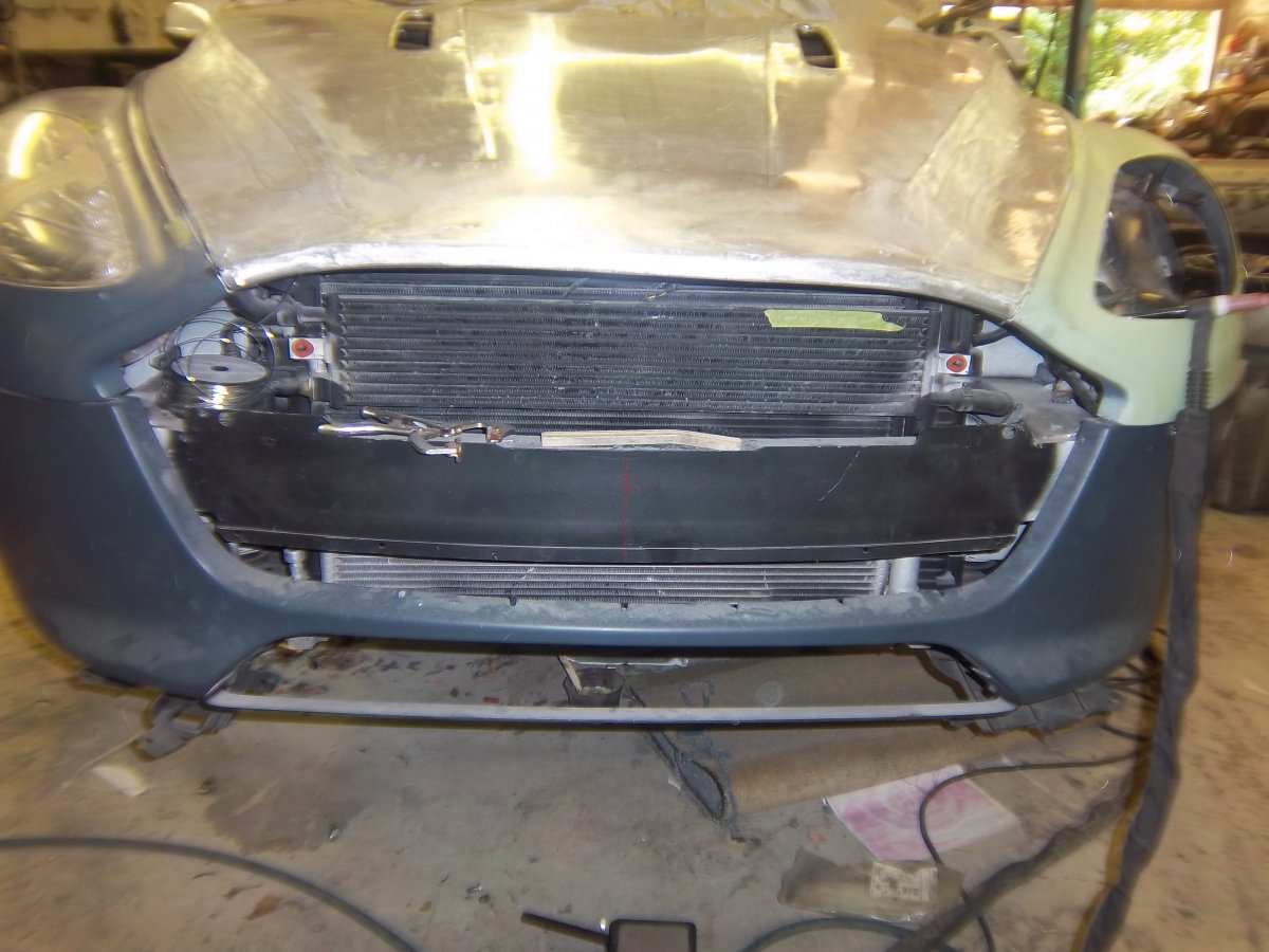

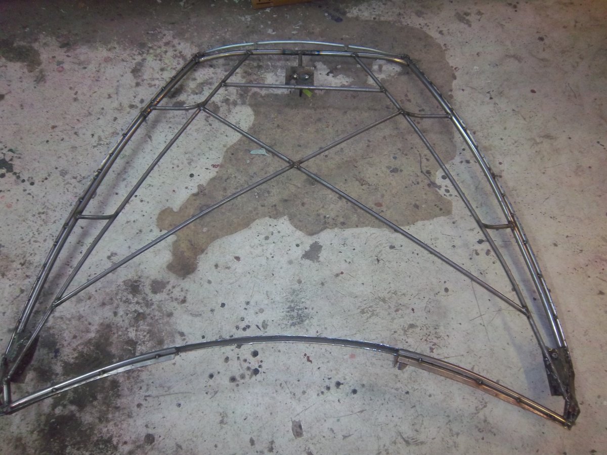

    Not sure if I should post these, it's a modern car, I almost never work on one, but this one I'm doing something I never did before, make a body panel completely from scratch, and first time doing anything in aluminum. I know it didn't come out perfect, like most of the metalshapers here, but I'm working on it!
    Customer wants to transform his 2014 Malibu into an Aston Martin styled sports car. I mounted real Aston fenders (fibergl***) and bumper/grill onto the car, but could not transform the old hood, too much difference in shapes. He also wanted it made out of aluminum. Built a frame out of thinwall steel tubing, to get the overall shape, and gaps, then made the skin, in 5 pieces to fit.

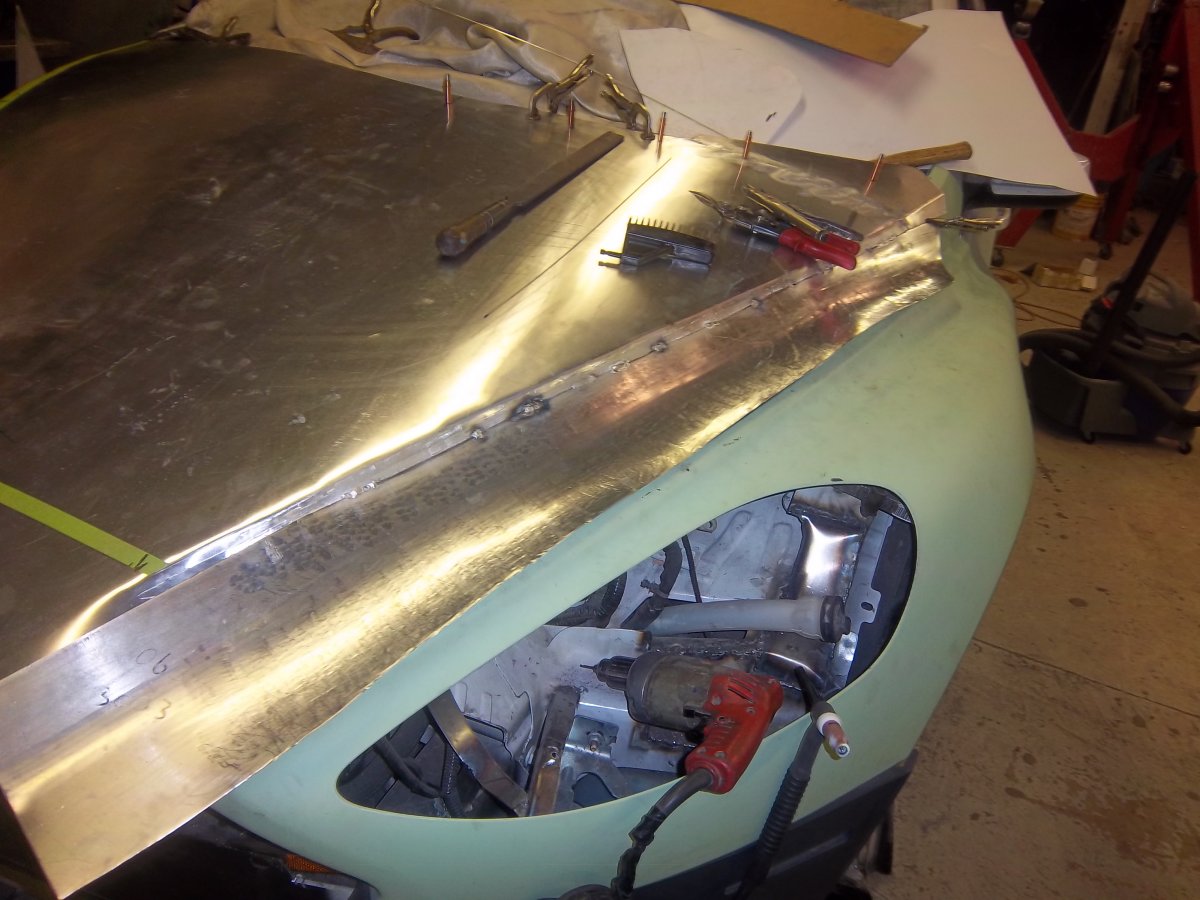

    Part 2 after putting in the sides, and front, I hammered in some 'vents' that will be filled with mesh.
