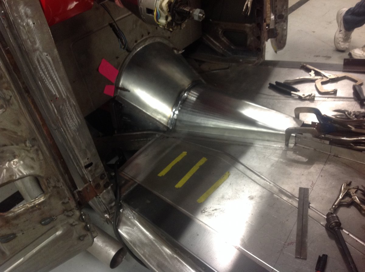

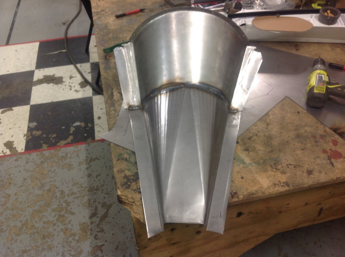

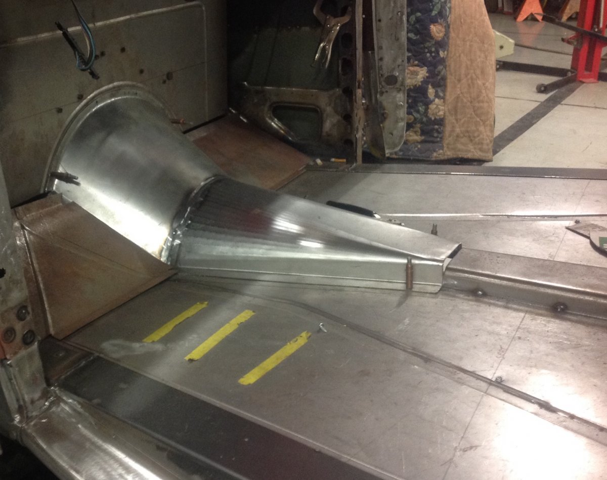

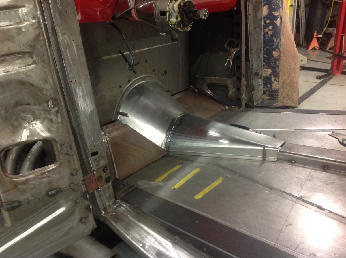

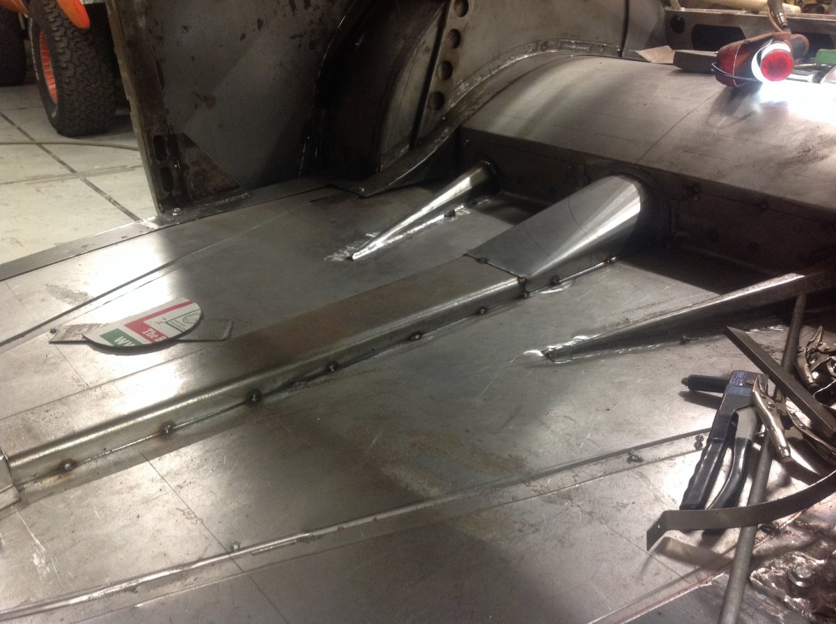

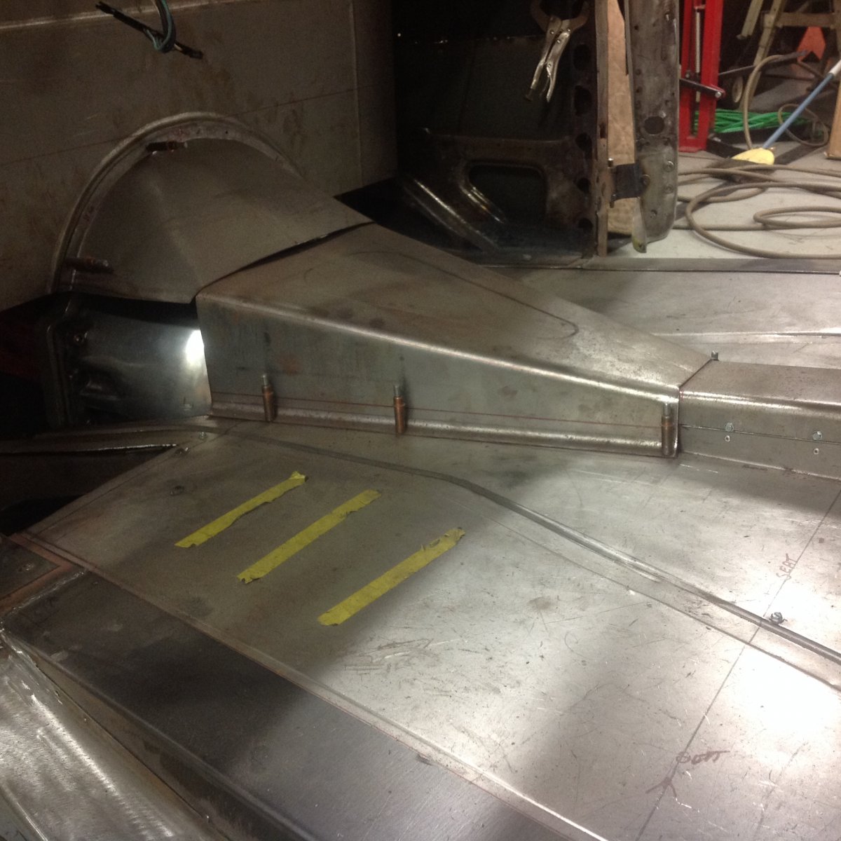

  9. Nothing fancy - not really shaping just down and dirty forming really. Like HVAC type stuff.
    Anyway here's what got started yesterday and done today.
    I did this Trans cover and tunnel a while ago and didn't love it a whole bunch but it was good enough to do its job. I don't really need the tunnel, but it adds a tremendous amount of strength to the floor, a back bone of sorts. B
    Then I set my seats in and the tunnel hit the bases by 1" **** !!! So since I never finished it then I guess it's time for a redo.
    So from some Jerry rigged bent up loops in outer space the shortened tunnel I got paper template - then I got this.
    Put in the brake and came up with the lower 1/2 of this
    Missed a pic or two of The upper section
    But once I had the lower 1/2 set in place it was just pretty simple to get up to the firewall.
    A few pieces of duct tape to support the paper then make a template.
    I cheated and put it in the slip roll to get the first part of most of it shape.
    Then I finished with it over my knee to tighten up the transition.
    The fire wall edge was turned up with vice grips then back to the stretcher to capture the firewall radius.
    So that the upper part of this
    Getting it to fit in is a sneak up on it dance. Tweak fit repeat trim tweak fit repeat.
    After
    Still have One little piece to get on the hump/tunnel.
    Maybe I'll run the tunnel thru the planishing hammer maybe not.

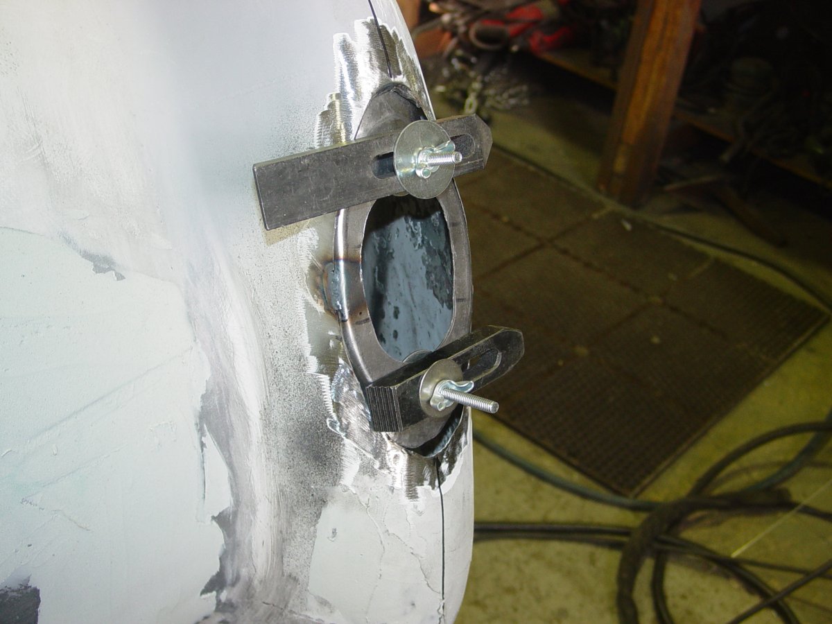

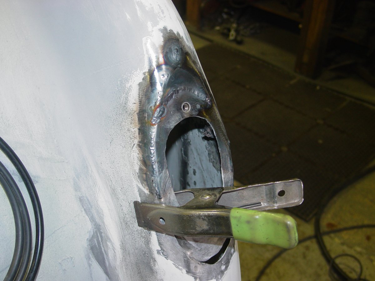

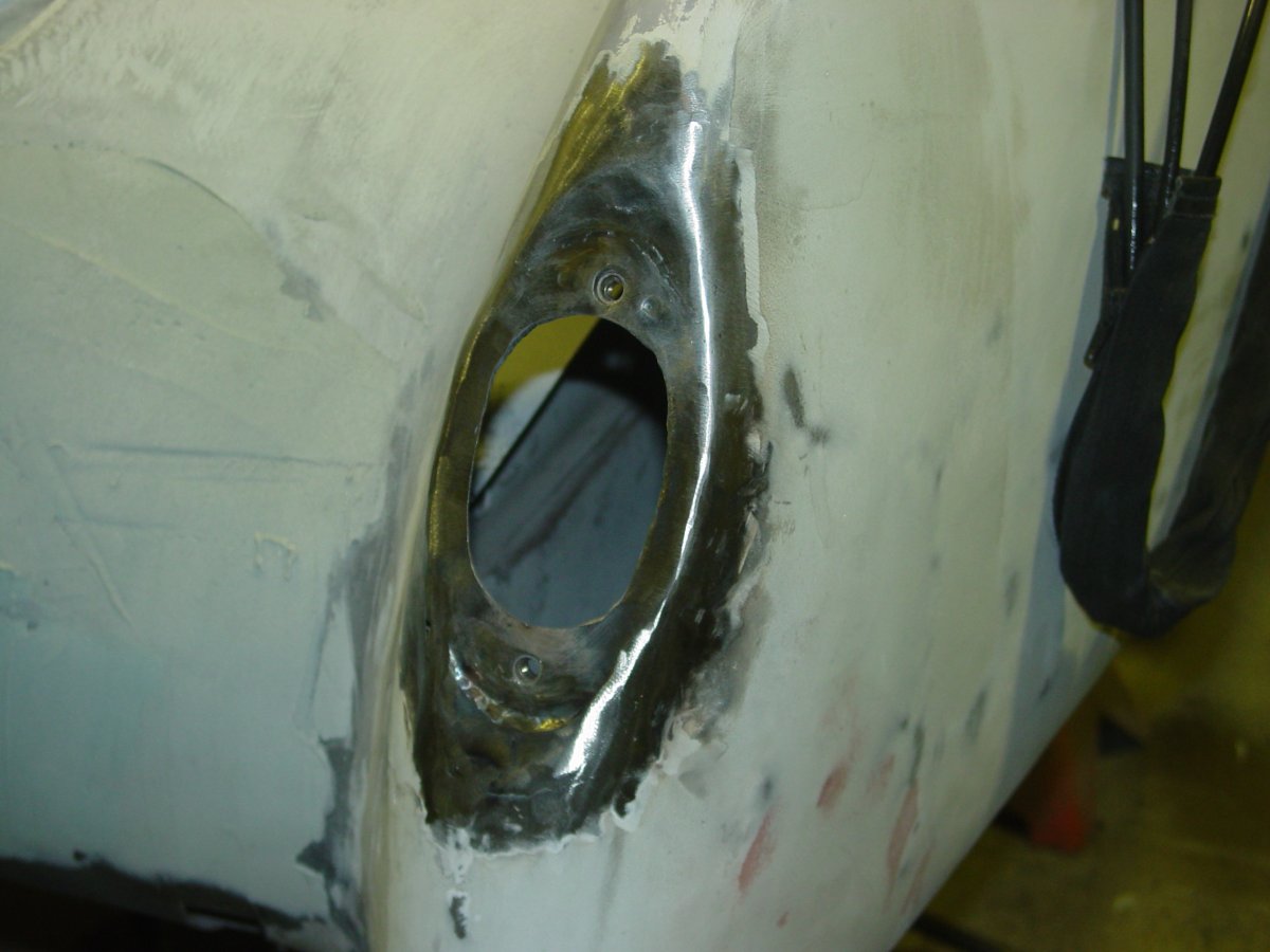

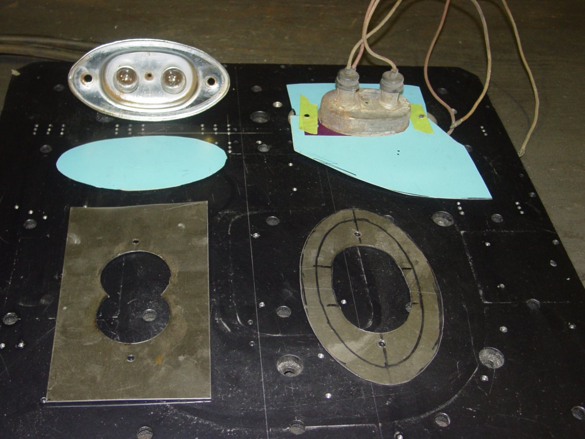

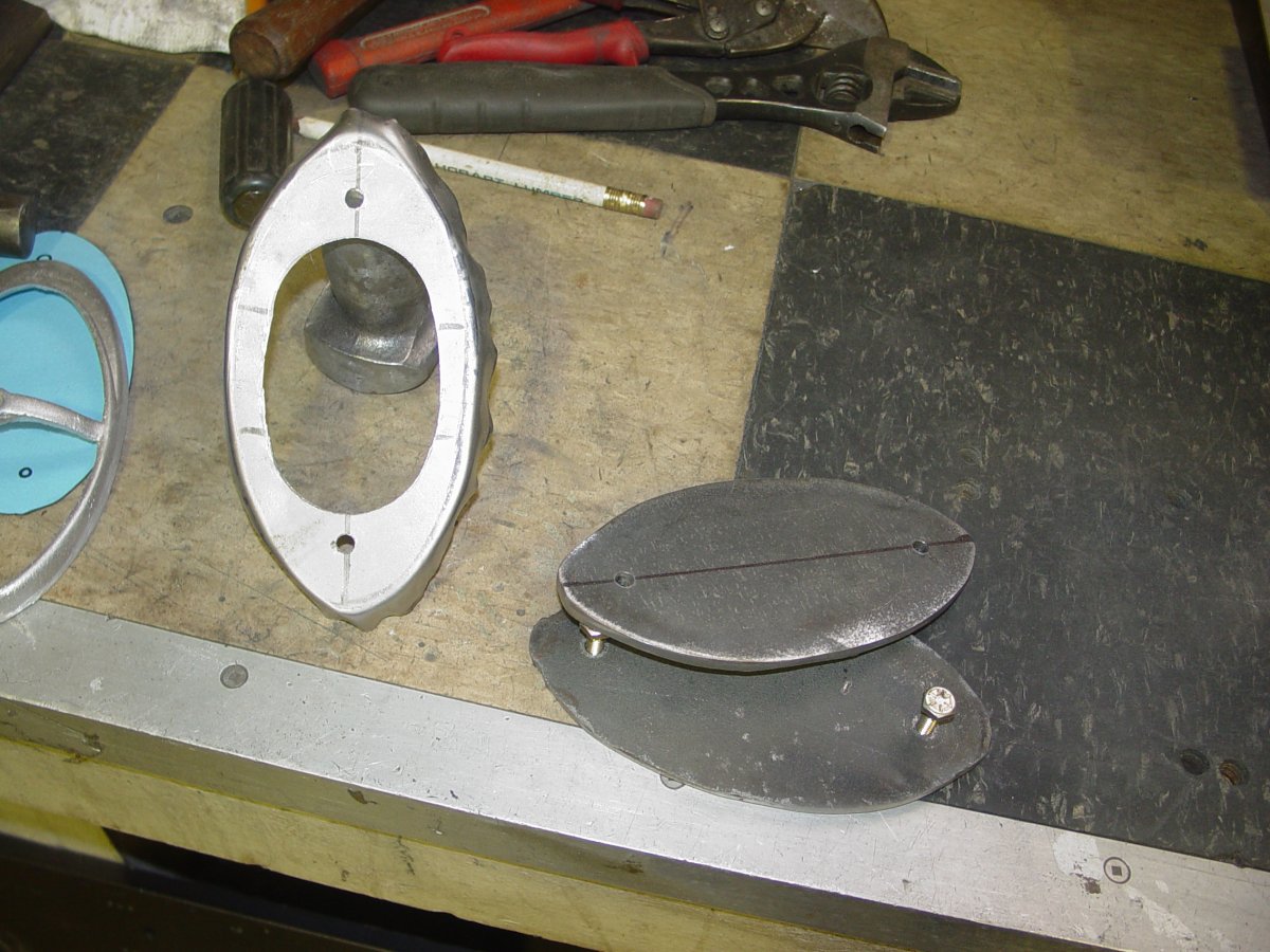

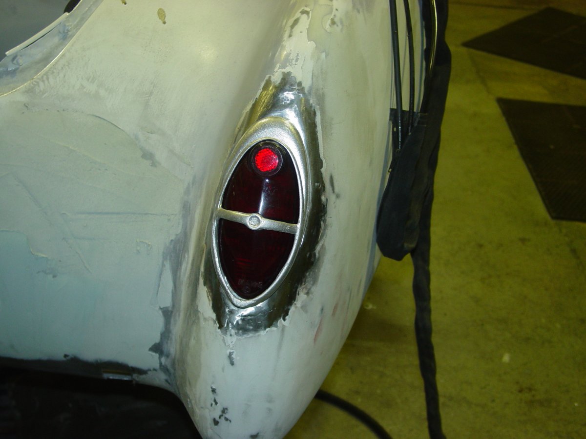

    I needed to make a taillight mount. This one was so far gone I researched the internet to find others, unfortunatly all were different. So just did what felt right.
    I can't do the word thing to describe whats what, the first pic is what I had to start with and the last pic is what I finished with. DSC00494.JPG DSC00511.JPG DSC00514.JPG DSC00515.JPG DSC00521.JPG DSC00524.JPG DSC00525.JPG
    MP&C, 36 ROKIT, loudbang and 3 others like this.

    Very nice work on the taillight Hobo Jim

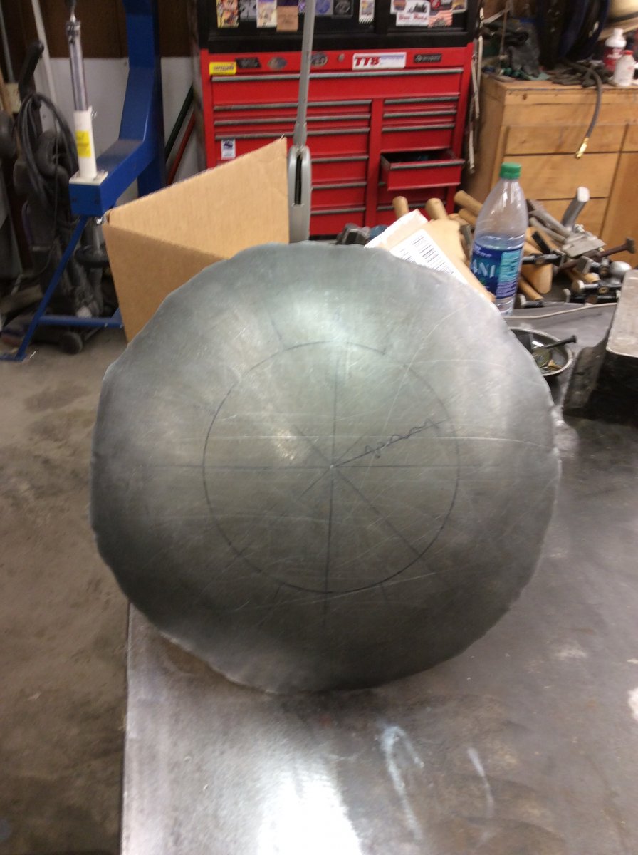

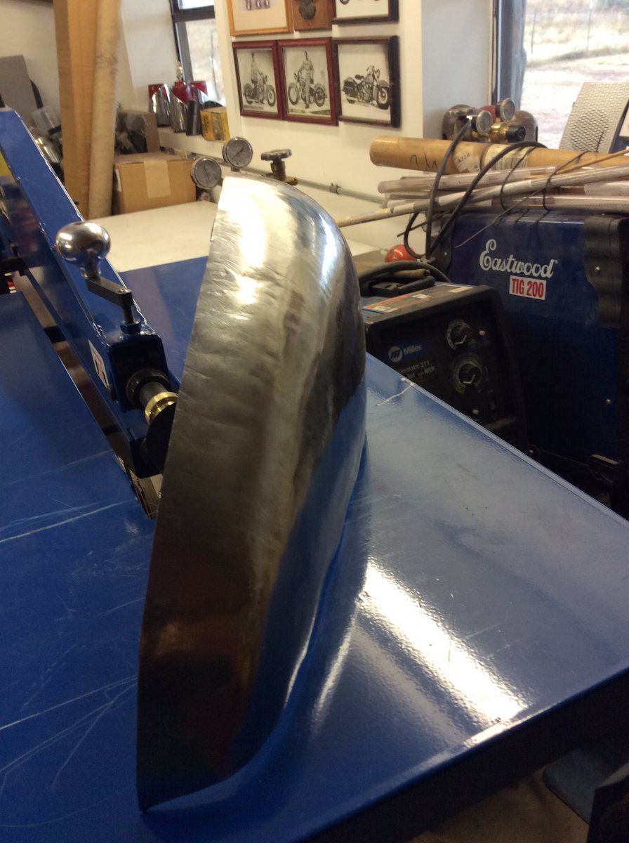

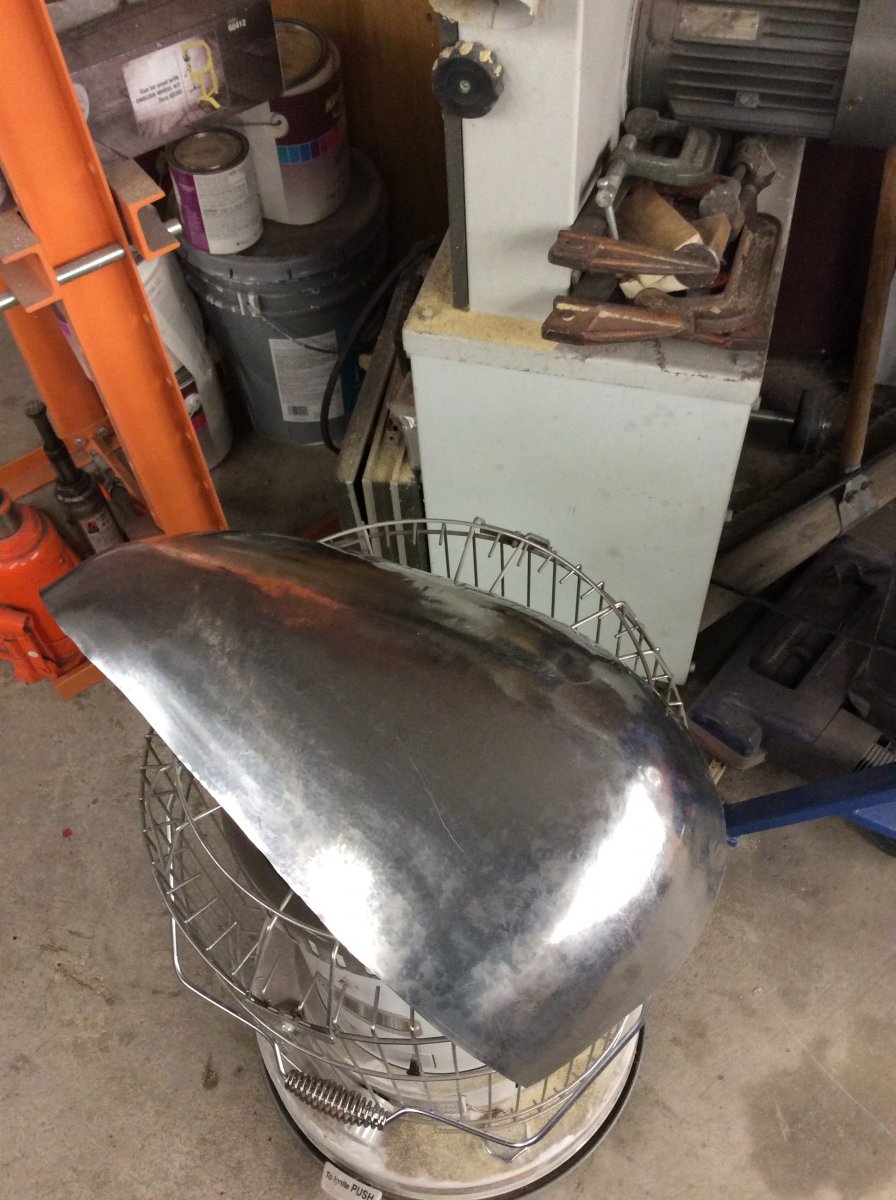

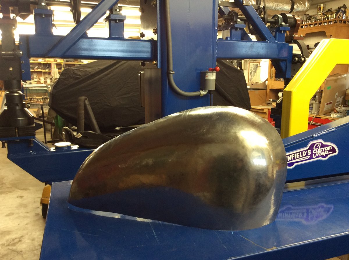

    Been playing with my new PH when time allows . I had a short cl*** on it when I picked it up . One of the things we were taught was building a buck for a tank , then doing a paper patern and transferring to the metal . Then played with the hammer for about 45 min each . I did not get the hang of it while I was there.
    I finished the tank but don't have the buck to check it with . Getting a set of radius gages from Fay ****ler this week then I will planish it and see ?
    Also cut our a 18" round out of some 18 ga paint grip and beat out and shrunk this disk . I really need some intense one on one with a real craftsman Hope the learning curve goes faster in future . Blue

    Very nice, how are you doing the deep shrinks? I ask because I am trying to make similar shape but its' kickin my ***, I can't figure out how to do a deep shrink with hand tools.
  18. MP&C
    Joined: Jan 11, 2008
    Posts: 2,520
    MP&C
    OJ, If you're trying deep shrinks on the stump, try starting the tuck in farther from the edge. If you start at the edge it tends to lock it there. If you need the shrink in farther, start at the "in farther" point. May also help to "adjust" the shape of your stump's recess to accommodate the larger size tuck. Peter Tommasini has a video on youtube that shows making a quarter panel for the Holden Monaro(sp?) inside the door jamb were tucks about 4 to 6" in length.. IIRC, he did these with tucking irons..
    When you come down to look at the Lennox/Pullmax tooling, I have a yellow tool that will do real deep shrinks if you'd like to try it...
