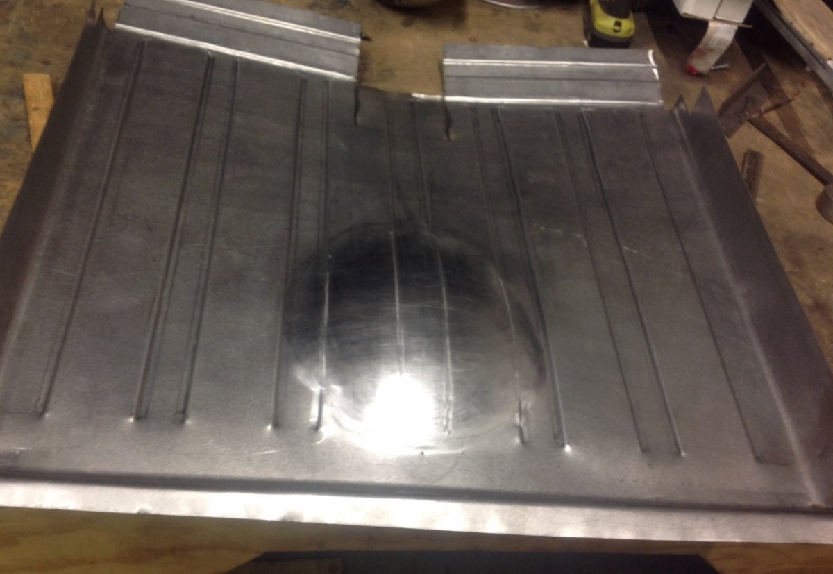

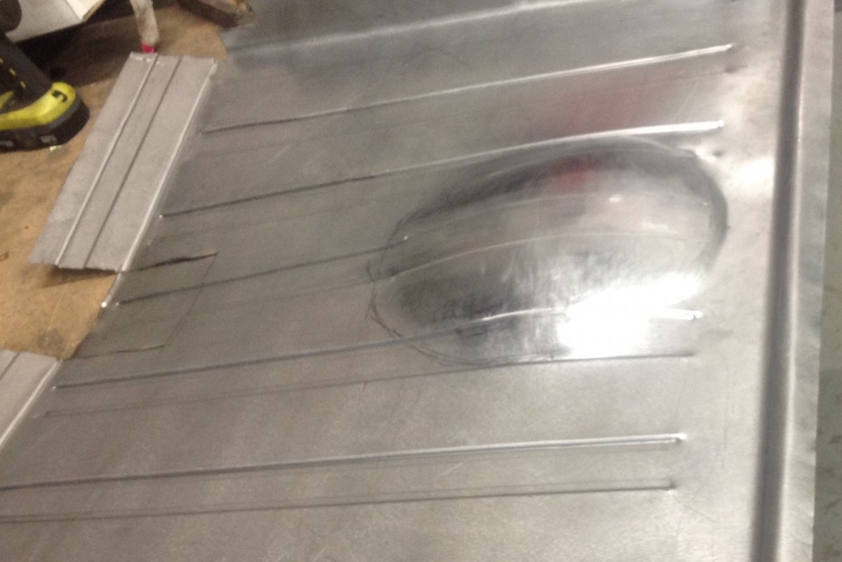

  2. Cave man Floor pan.
    It's not quite finished yet but no bad for a days efforts and fitting in into the car 30 or 40 times o_Oo_O
    Bent on the floor, over a beam.
    Tacked a 1" round to the beam, and bent it over.
    Little differential bump

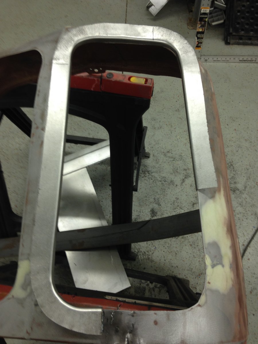

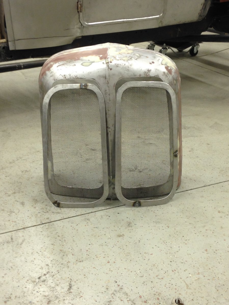

    Working on inserts for my tractor grille turned track nose. Far from perfect but hopefully close enough with a little more work. 12-7 016.JPG 12-7 019.JPG 12-7 022.JPG

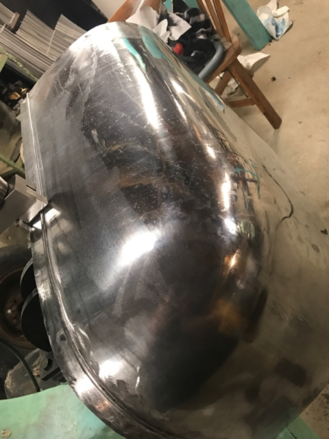

  7. 28,000 light taps
    Each.
    Fixed planishing hammer with just light wash over pressure.

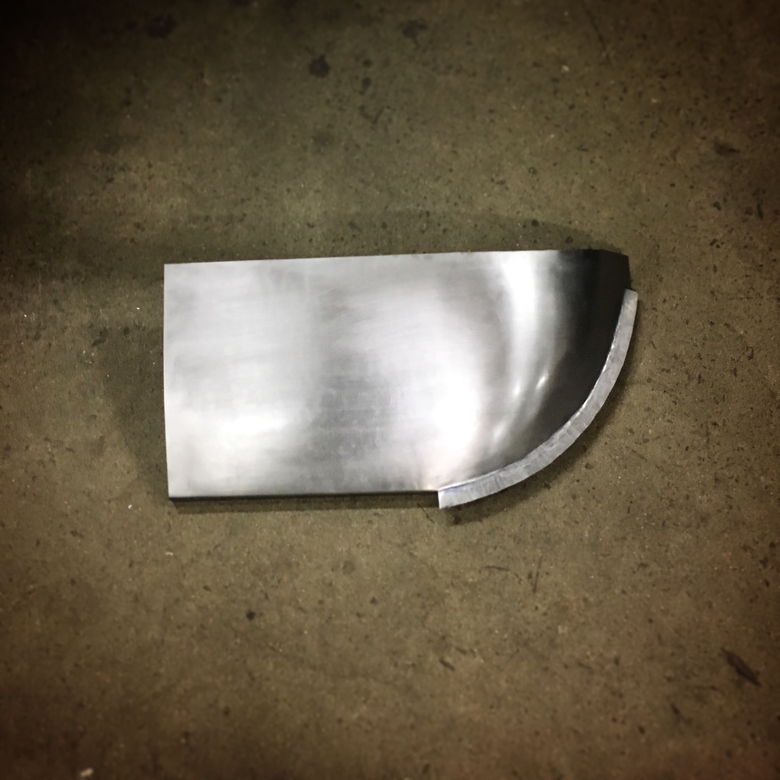

    I haven't really done any sheet metal work in a while.
    Got a chance to do some last week.
    Made a patch for my Model T project.
    Unfortunately, I probably won't be able to get back to the project till after GNRS.
    bengeltiger, loudbang, gonzo and 2 others like this.

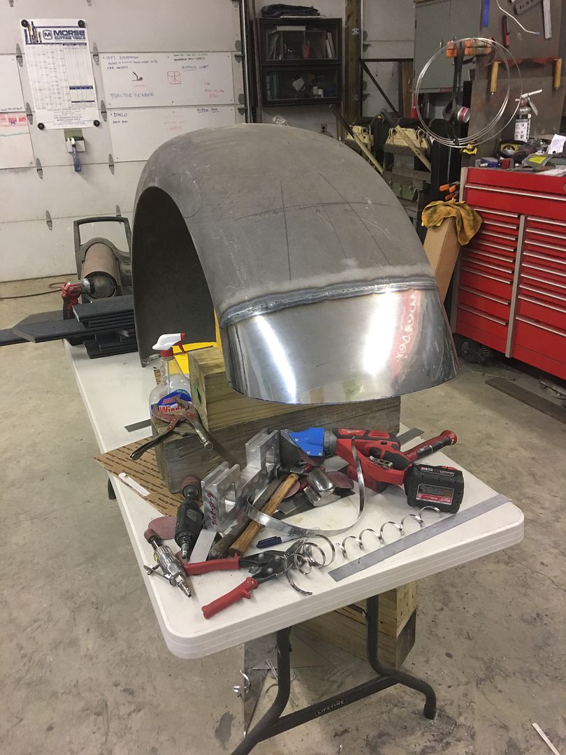

    Well, I need to make a little progress on a 16 gauge fender, so the highly precise stand for the Laser Level was used. We have about 13-3/4" difference in height from back edge of fender to front edge. So Laser is set at 13-3/4 above the table, with heights verified to all four corners of the table.
    Prior to t******* the front of the fender we had measured some reference marks to the front edge for locating the new cut line..
    Adding those lower edge marks back on our fender patch, we adjusted the height of the fender front for the laser to match those marks by sliding our jack stand fixture around inside the fender until we had the correct height. Hey, this is technical stuff!
    And traced the laser mark with the sharpie...
    Initial cut to remove the bulk was done with the Milwaukee shear, the final was done with Midwest Shears. I figured slower = more precise...

    Doing a test fit of the Biederman fender....
    Was going to do a little bit of touch up on the front weld seam, needs more shape..
    The fender spans about 53" at the bottom, where it wouldn't fit in the wheeling machine sitting on the floor. We added a lift kit under the legs, except for one which needed to be open under the leg..
    in process....
    Needed to wrap the wire edge....
    Note the genuine John Deere anvil...
    The flange was hammered over using various hammers and dollies (anvils) with the final wrap tightened up with a pair of vise grips modified with smooth jaws...

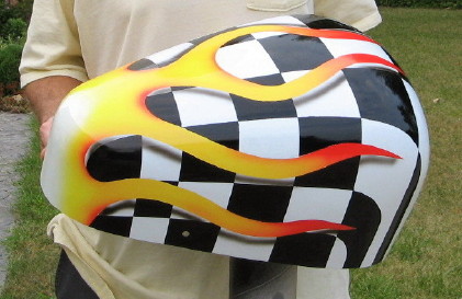

    I liked the use of the laser to get the fender edge right. I used a laser to lay out the tapered checkerboard lines on the inside of my '46 truck hood and also the air box. Laid the hood upside down on the floor and hung the laser from the ceiling.

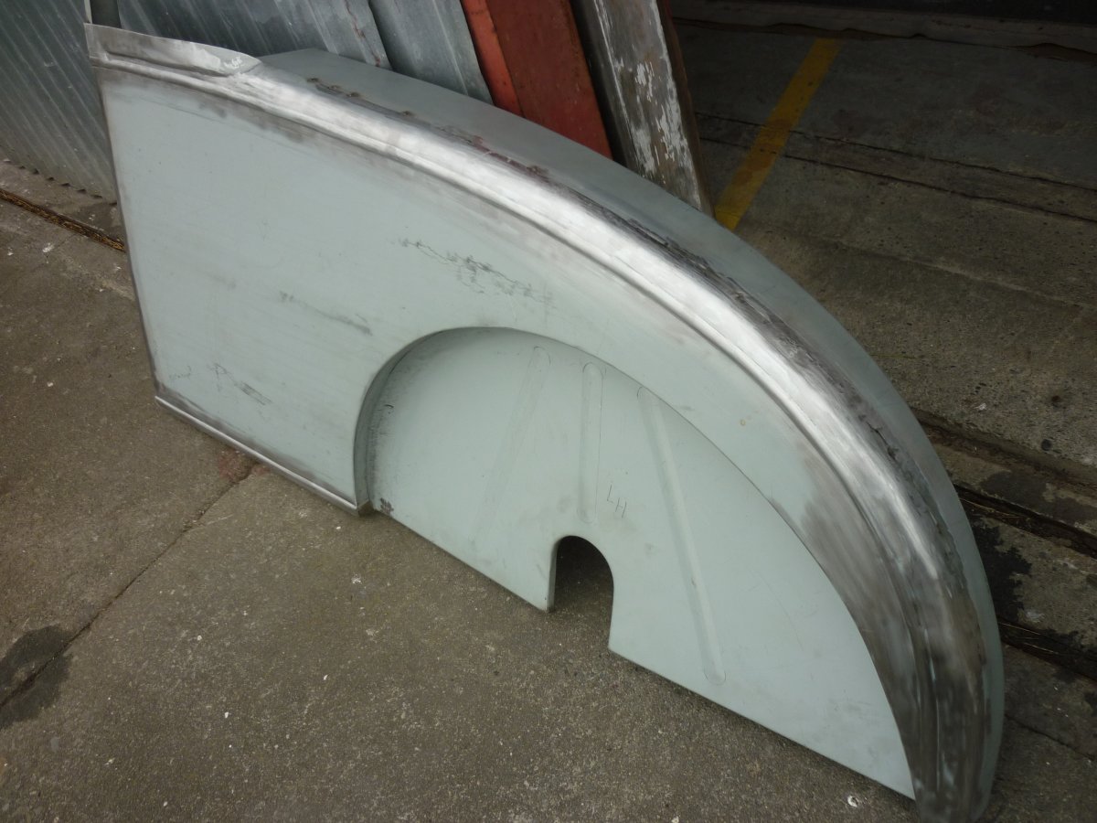

    The left hand rear quarter for my scratch built 28 A roadster, has since been dressed out and the right hand side made....came out much better than this one. Just making all the bits and will ***emble them one day, this is just a backup project for when there's hold ups on my Desoto pickup

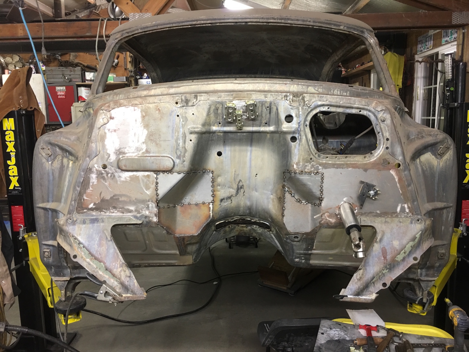

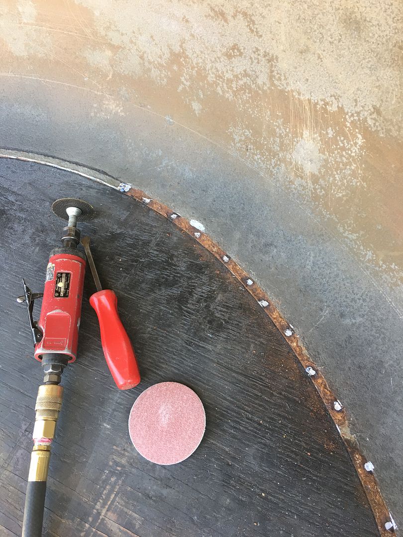

    The flanges were TIG welded in place, welds dressed, and then worked to remove the remnants of the old filler panel. The old spot welds were removed using a cut off wheel in a die grinder. When the upper panel gets thin, the heat turns it blue. When you see shiny metal again, you have found the second layer, so stop grinding!
    This video explains the process a bit better...
    Next to clean all the rust that was hiding between the layers. A tight squeeze!
    The filler panel we fabricated was positioned, and drilled for some 1/8" cleco's. Then another test fit:

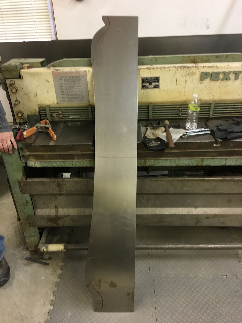

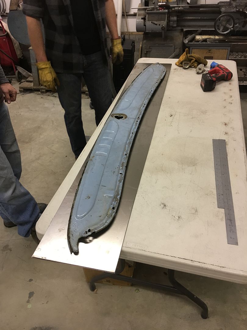

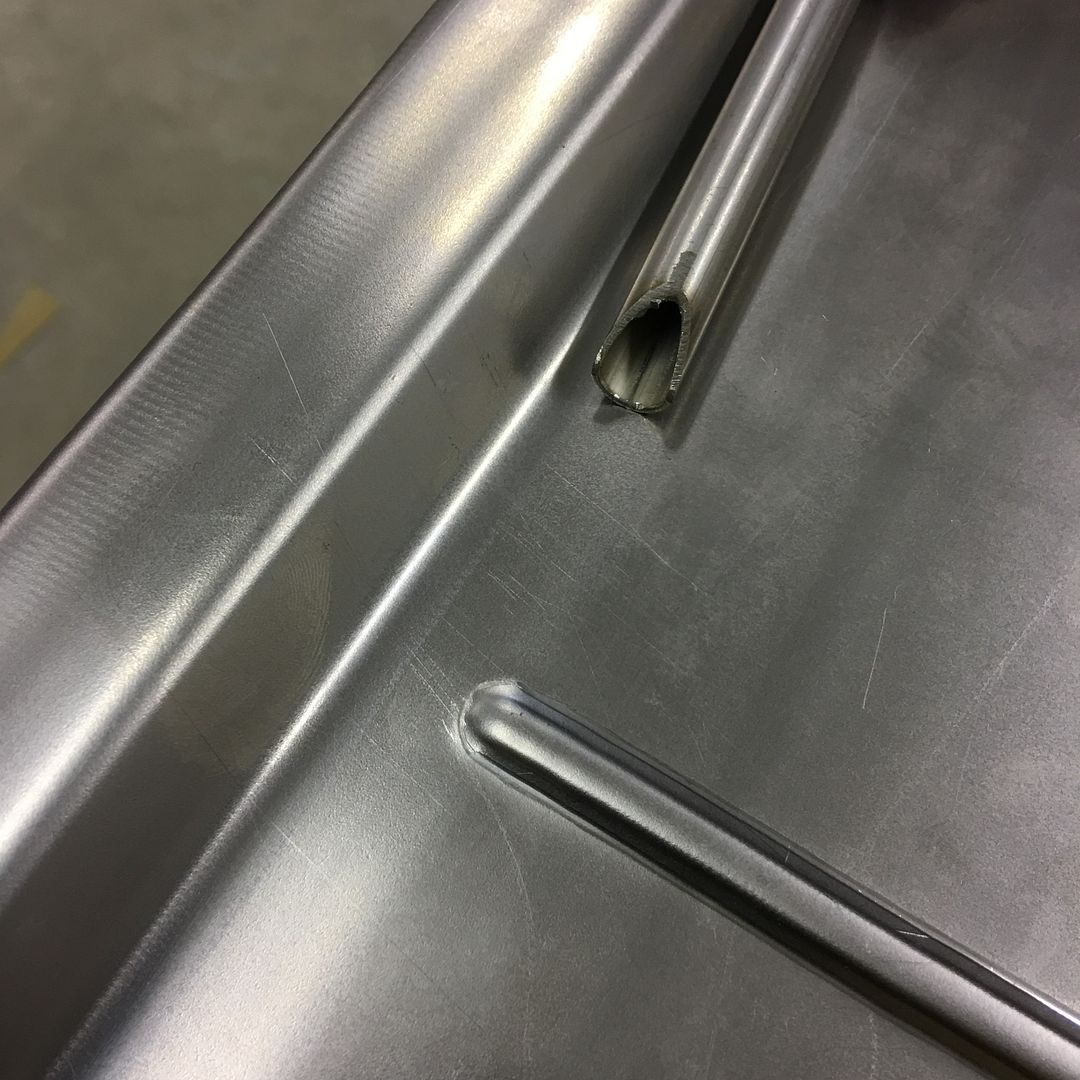

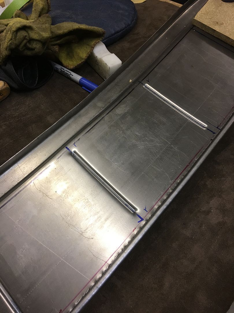

    Spent today hosting a Pullmax Workshop for some of the guys from the VA HAMB. OJ Higgins recently took delivery of a gargantuan Trumpf universal machine (a Pullmax on Steroids) and wanted a down and dirty on how these machines could be put to use. So OJ and a few other VA guys stopped by today and for a sample to use, ClutchDumpinDan brought by a tail pan from his 52 Chevy that was in dire need of rust repair.. We found a piece of 18 gauge cold rolled steel large enough to do the trick, so Dan cut it in half just in case we needed to do this twice...
    Dies made for the universal tool holder in the Lennox Nibbler
    Profile check...
    Test sample...

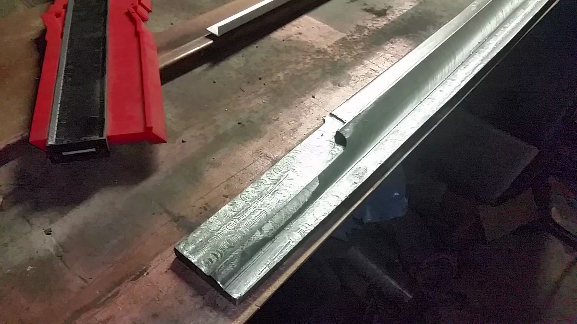

    Our new panel ready to run through the dies...
    Step detail
    Tipping the leading edge..
    Dan takes a *****ie break
    Videos....

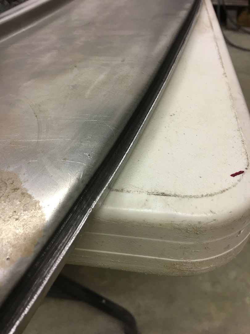

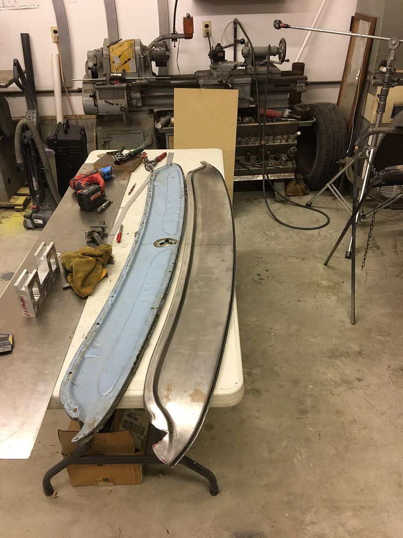

    Comparing new to old...
    Rusty seal joggle on the old panel...
    The new one...
    Adding some bead details to change things up a bit...
    Comparison....
    Fancy tool for finishing the bead ends...
