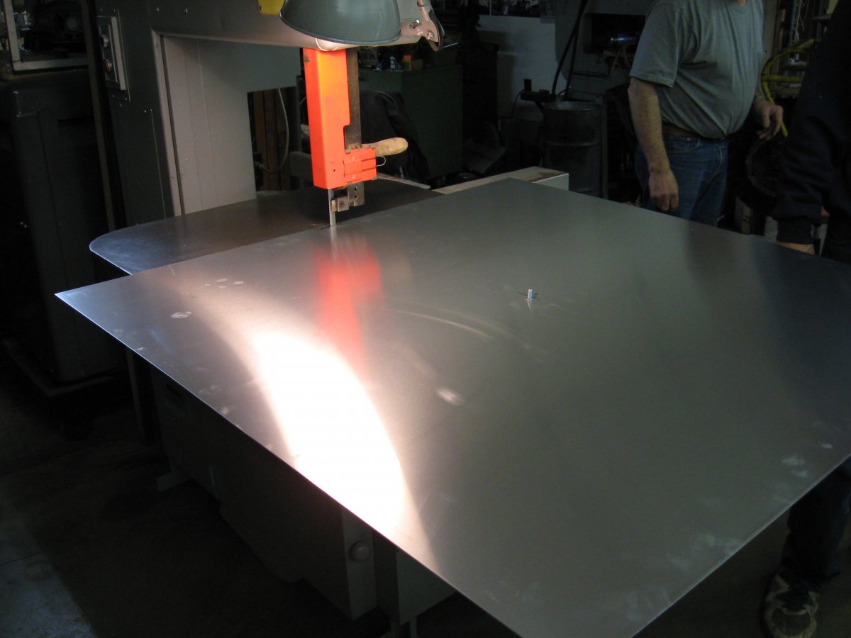

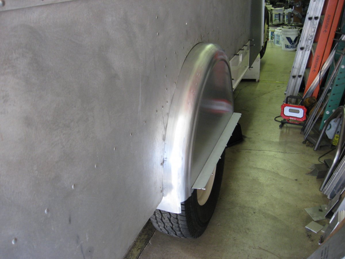

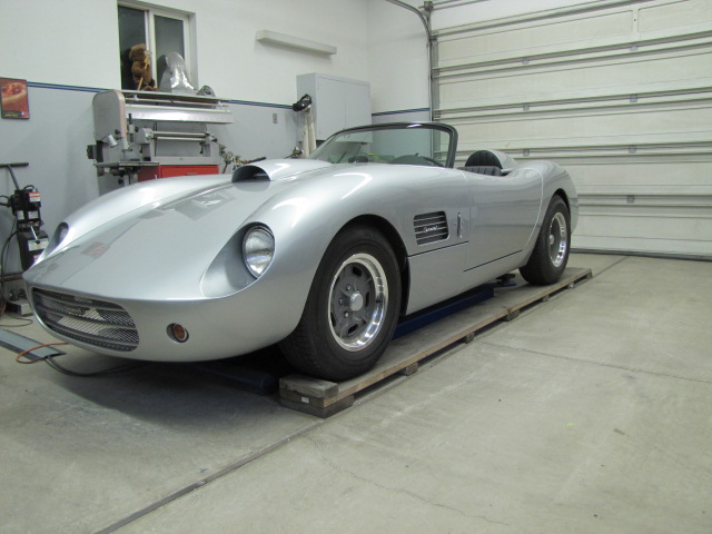

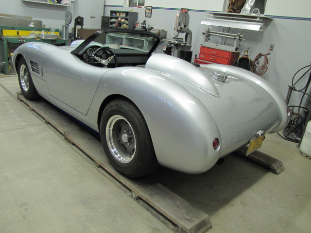

    Here is what can be done with a lot of determination. Self taught and not my profession.
    Designed and crafted by me and all aluminum. Just sharing. Ray in OR

    I wanted to build some fender flairs to cover the outside dual tires on my 53 Ford COE, with an aluminum Grumman box. I started by clamping a bracket with a center pin @ 20-1/8" outboard of the band saw blade, to cut a 40-1/4" disc out of .063- 3003 alloy sheet. After running it through the bead roller, and then the tank roller die, I sawed it in half. To maintain the semi circle shape, it required building a plywood fixture with angle clips to clamp it secure while welding. The panel and the perimeter strip both needed shrinking to make the fit together. The steel angle is clecoed to the base of the panel to keep the part a flat as possible. The next photo group will show the finished part. IMG_7653.JPG IMG_7655.JPG IMG_7657.JPG IMG_7667.JPG IMG_7679.JPG IMG_7683.JPG IMG_7684.JPG IMG_7686.JPG IMG_7688.JPG IMG_7702.JPG
    The 39 guy, lbcd and loudbang like this.
  10. Marty Strode
    Joined: Apr 28, 2011
    Posts: 9,706
    Marty Strode
    Finish ground and roughly clamped in place. If my truck was from the 30's, I might entertain leaving the skirt portion in place, but my plans are to band saw the flat section out, leaving the bead as the finished edge, and trim and radius the bottom corners. IMG_7704.JPG IMG_7707.JPG IMG_7705.JPG

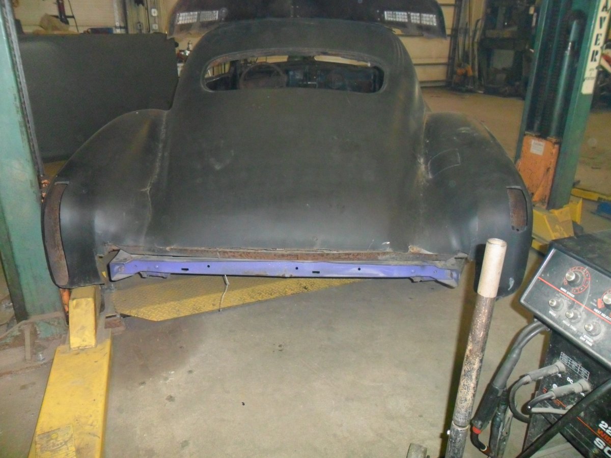

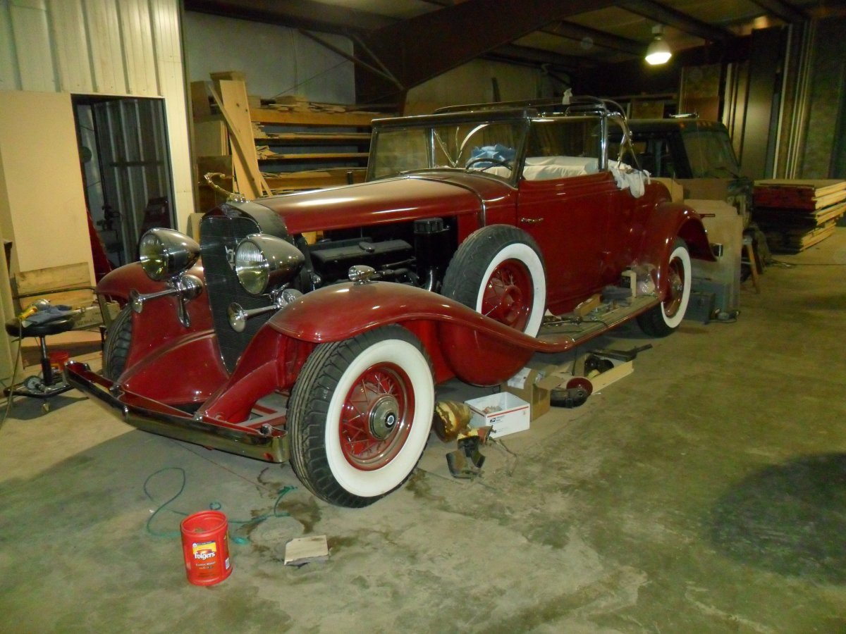

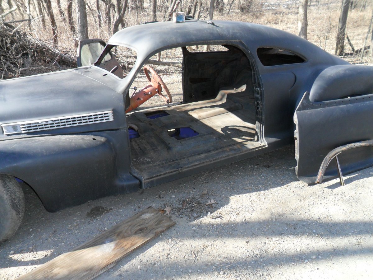

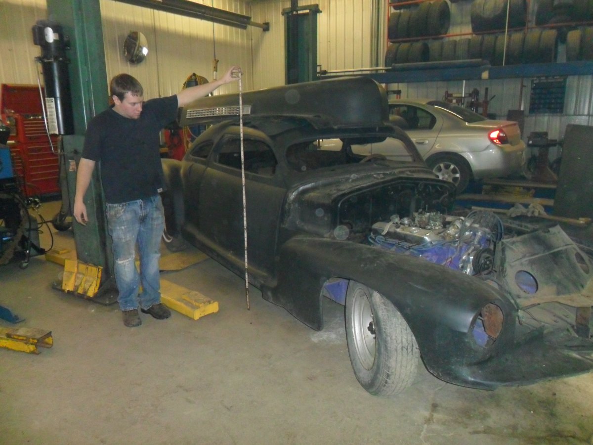

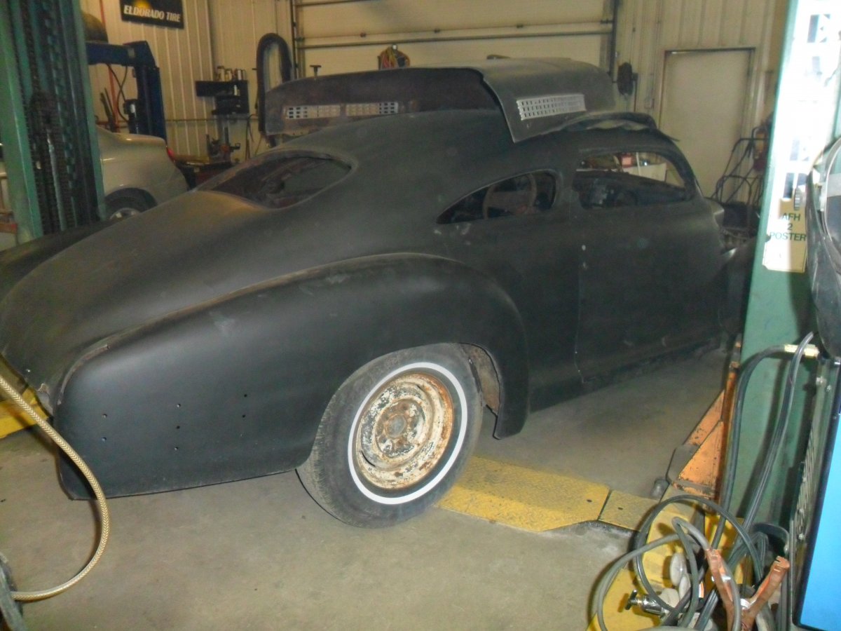

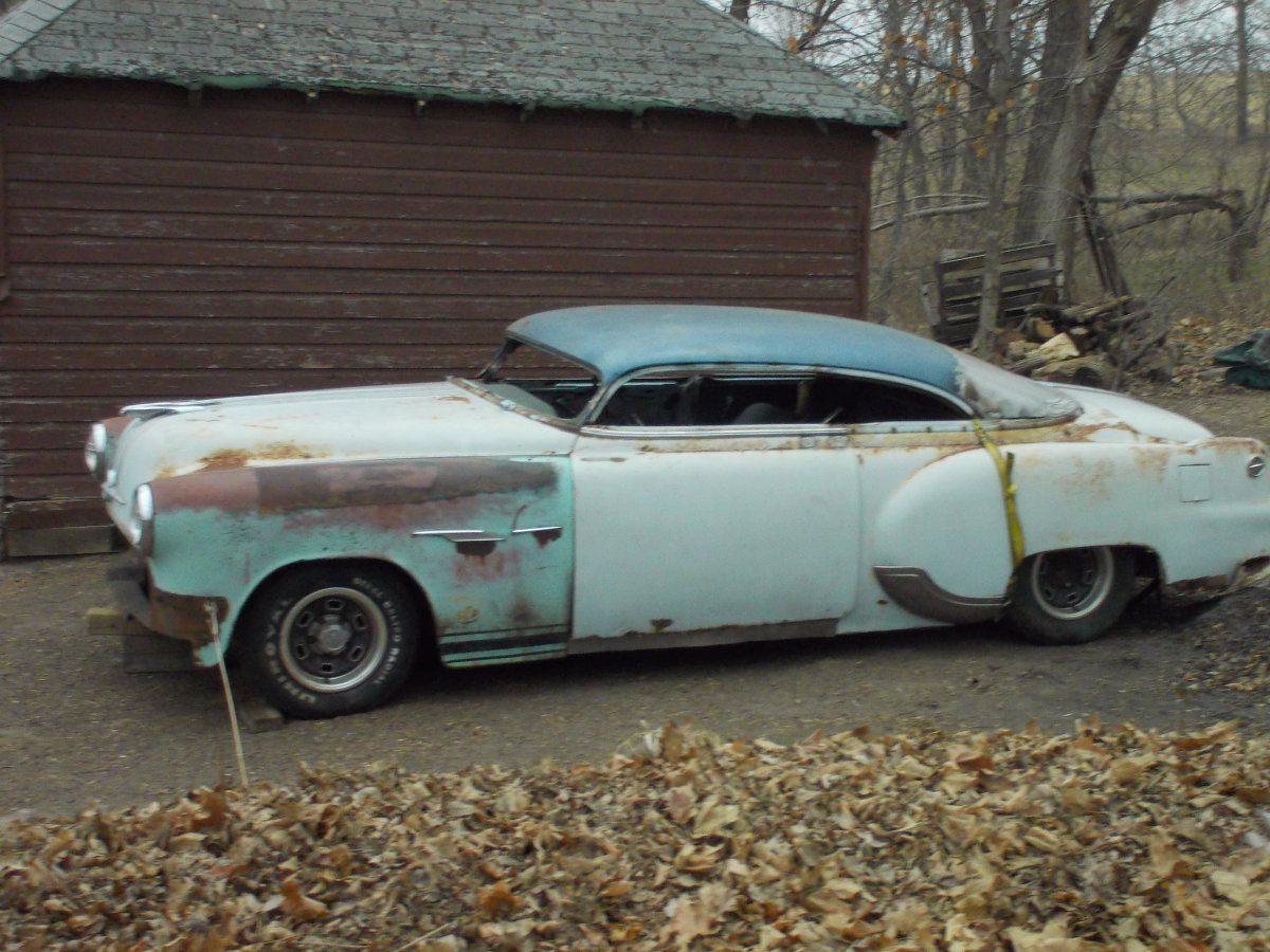

    measure twenty times,practice on ,some thing like chocping, cutting in half,channeling,lowering roofs,are the best practice.
    the cadillac has driven many nuts for 30 years,on to next builder it just keeps going.the pontiac was an effort also averted.
    home made tools such as these others have shown in photos can be some of the best.
    the shiny cadillac shows a craftsmans build where parts simply need to be built[coachmen]
    i pick up a lot of projects that others simpl give in to[Win or Lose Steve''s Buying] has gotten to be a p***ion for me ,we simply build race car panels nightly for repair and than take on hard work for relaxation.
    and usually find someone to become the next artist.

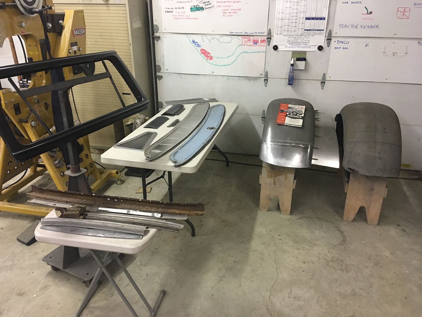

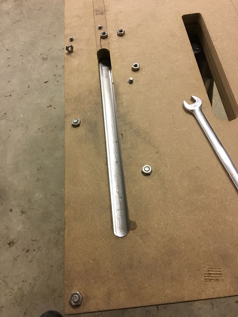

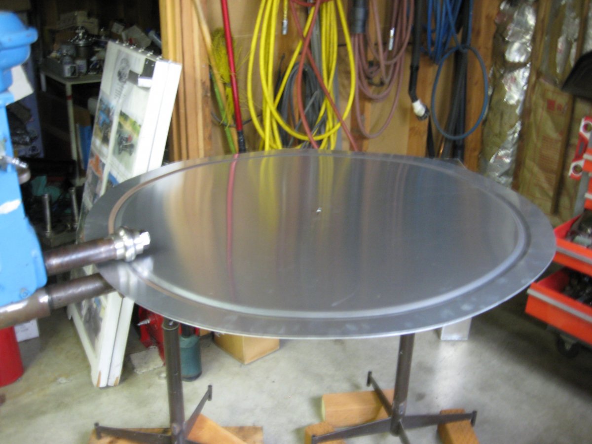

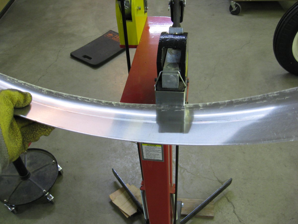

    Doesn't seem like much got done this weekend, but here's what we did..

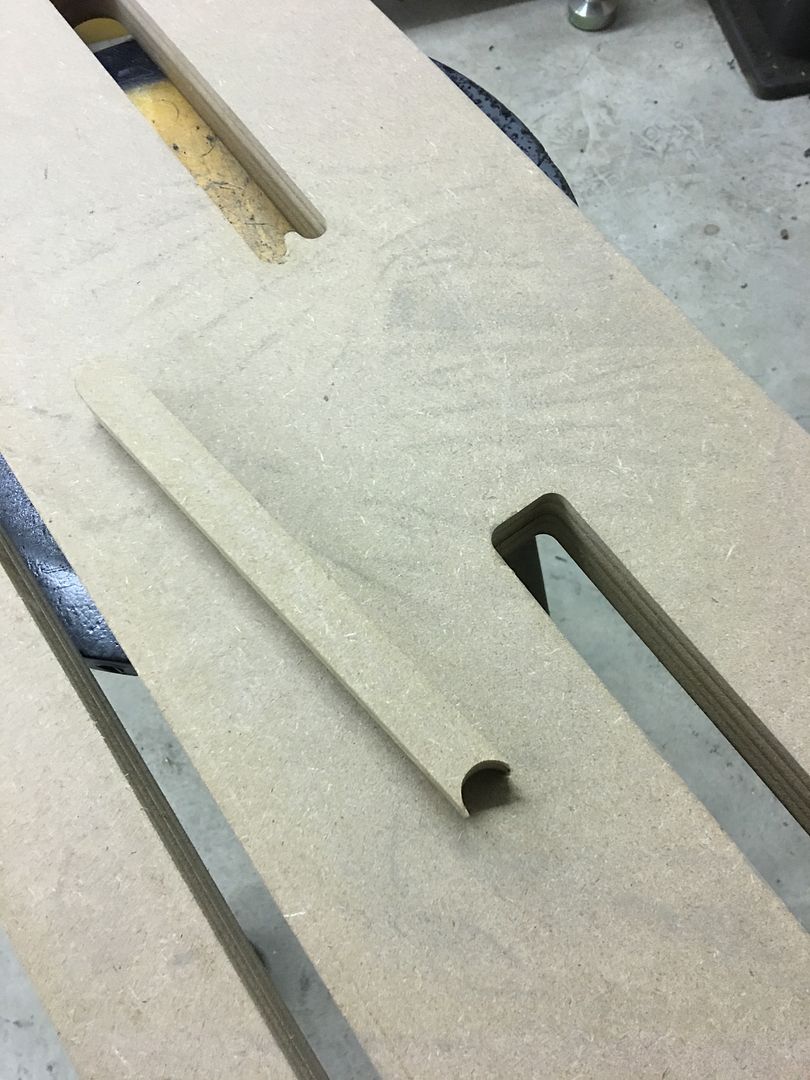

    Stopped by the local CNC router facility to get some generic guides made for bead detail on the Lennox Nibbler...
    Also had some blanks cut out over there to the right side. These were to form stops so we can adjust length of our pattern shorter as needed..
    It has a snug fit like so:

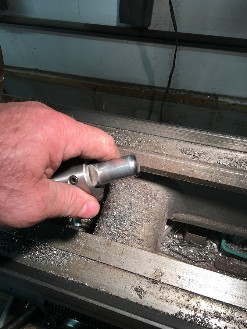

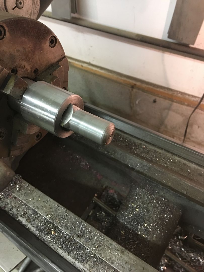

    Next was to turn up a new die with less crown than the other we've been using, just to have a different look, a flatter bead..
    Setting up for some practice runs...
    Here's a comparison between the new die and the fuller radius we've been using..

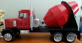

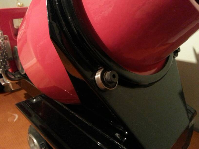

    This is ot..but it is cool! I fabbed this up back in 94 for a metal cl*** final project. The drum spins on 2 german racing bearings and the mirrors are polished to a mirror finish...the wheel rubber material is off a rowing machine sliding mechanism...it measures about 26" long and 14" high. Still have it displayed in my home office
    BradinNC, Johnboy34, 36 ROKIT and 6 others like this.

  18. jnaki
    Joined: Jan 1, 2015
    Posts: 11,411
    jnaki
    upload_2017-5-15_3-43-28.png made by LBCD
    Hey LBCD,
    That is a totally rad cement mixer construction and very cool model. You are a craftsman...Kudos… My son loved the cement mixers as they were always in motion, even when rolling down the street. In our neck of the So Cal woods, there was this giant red cab mixer with a white rotating cement holder on the back. It stood out because the owner had painted wild red/yellow flames going from front to back and they rotated all of the time.
    That truck was my son’s favorite. From his car seat, whenever he saw that truck, he would shout out, “There is my flame truck.” Then he would say those flames are like what daddy always draws on everything. Ha ! 35 years later, I got chastised for bright red/yellow flames I drew on our granddaughter’s white “tennies.”
    Today, I still see those huge red cab/white mixer trucks, with those flames, rolling down our So Cal streets. It is very cool, especially to have built your own model. Darn, I just thought of something, I should have painted my son’s yellow Tonka cement mixer those same colors…

  19. LBCD
    Joined: Oct 28, 2009
    Posts: 1,059
    LBCD
    Thanks! The term German racing bearing too comes from the 70's when I was a kid and I skated not only for fun but as a way to get around...I was hoping someone would get a kick out of that!

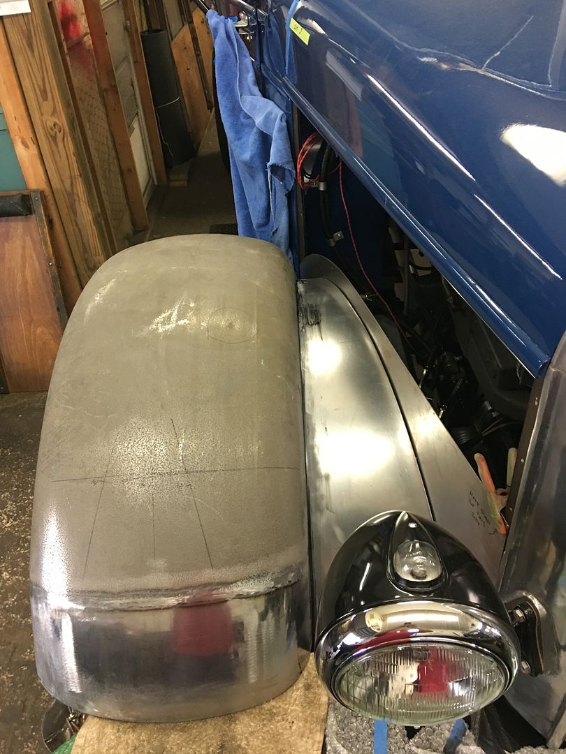

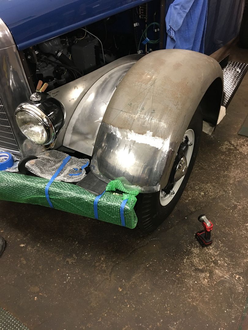

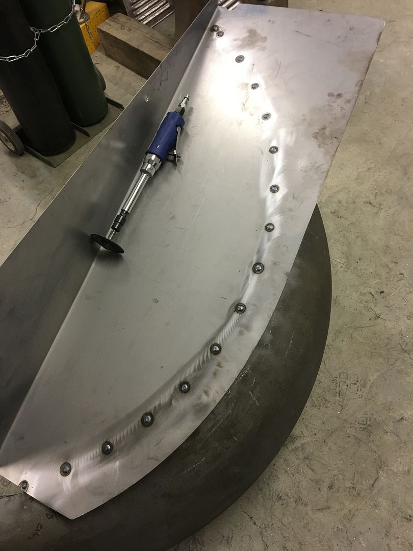

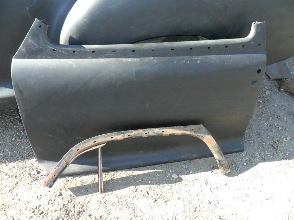

    Some more progress on the Biederman fenders, here's where we left off last time...
    On the p***enger fender, we removed the cleco's holding the filler panel and John (the owner) media blasted the flanges where the panels overlapped..
    Cleco holes were enlarged on the filler panel flange to accommodate plug welds and the two parts welded together...
    After grinding the welds, John brushed some SPI epoxy in the lapped panels to seal them up..
    Back on the driver's fender, time to trim off the rusted and bent front edge....
    The door skin removal tool is used to unwrap the wired edge...
    Once the wrap is broken free, the top is scored with a cutoff wheel and then peeled around. No cuts on the wire as this may weaken it..
    Trimmed and clamped in place for a test fit..

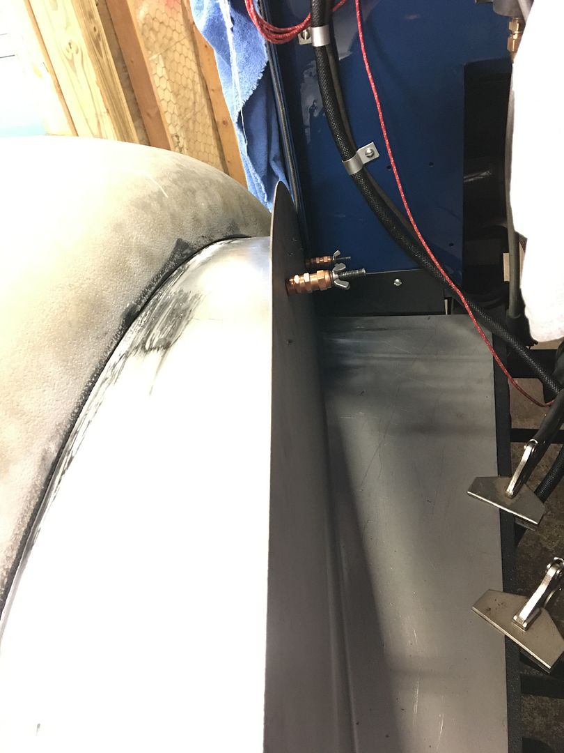

    This evening we took the p***enger fender over to John's so we could mock it up on the truck and locate/cleco it to the lower hood side..
    The wing nut cleco's used in about four spots to hold things good and snug....
    Back at the shop, we'll get this plug welded on Saturday..

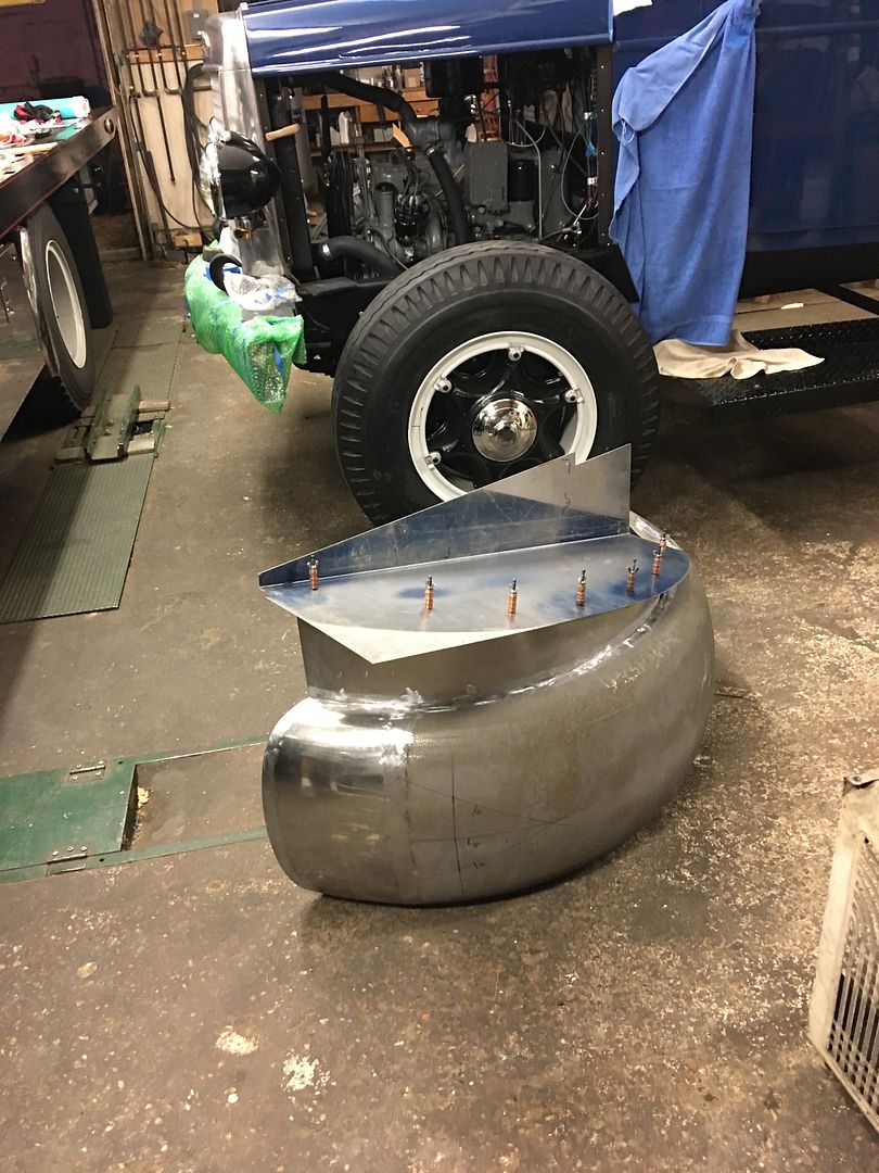

    tried to make some headway on the Biederman. John is taking it to the truck show in Macungie PA so we're trying to get the fenders complete so he can bolt them on and answer questions all day about their bare finish..
    With the lower hood side cleco'ed to the p***enger fender using wing nut clecos to pull things up nice and tight, lets get some plug welds done to join all three parts together...
    P***enger fender lapped seams then had SPI epoxy brushed in from both sides to seal in case he runs into rain. We he returns they'll be ready for media blasting and paint..
    Next onto the Driver fender, the remainder of the flange from the old filler panel is removed, a cut off wheel is used for releasing the OEM spot welds..
    Next, we had a rub issue where the fender was a bit close to the cab....note the flat area, as well as a rust through. So we'll just trim this out and replace..

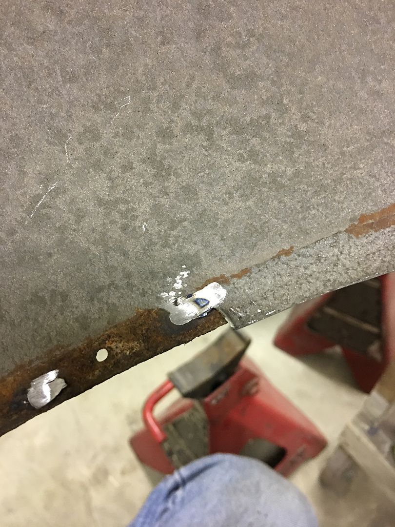

    Today I finished up the TIG welding on the rust repair...
    This area has a recess so it doesn't rub the side of the cab...

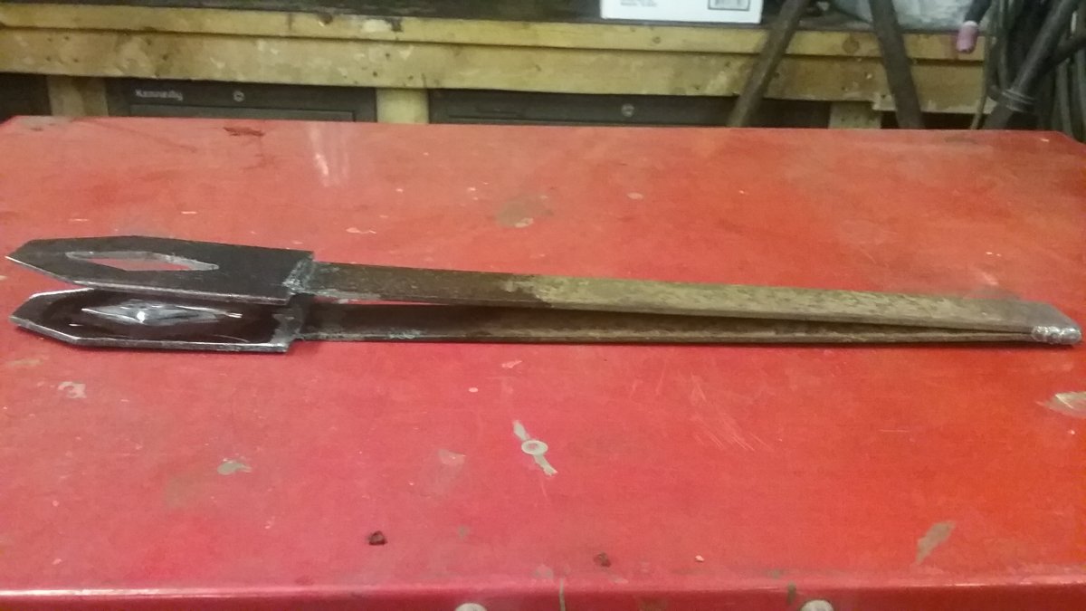

    Next to clamp the front repair section, the vise grips tend to rotate after clamped and allow the weld joint to open. So to fix the gravity issue, we broke out the painters tape..
    16 gauge sheet metal wiring, gotta love it!
    Next time we'll get the filler panel added to the Driver's fender..
    whtbaron, brEad, biggeorge and 8 others like this.

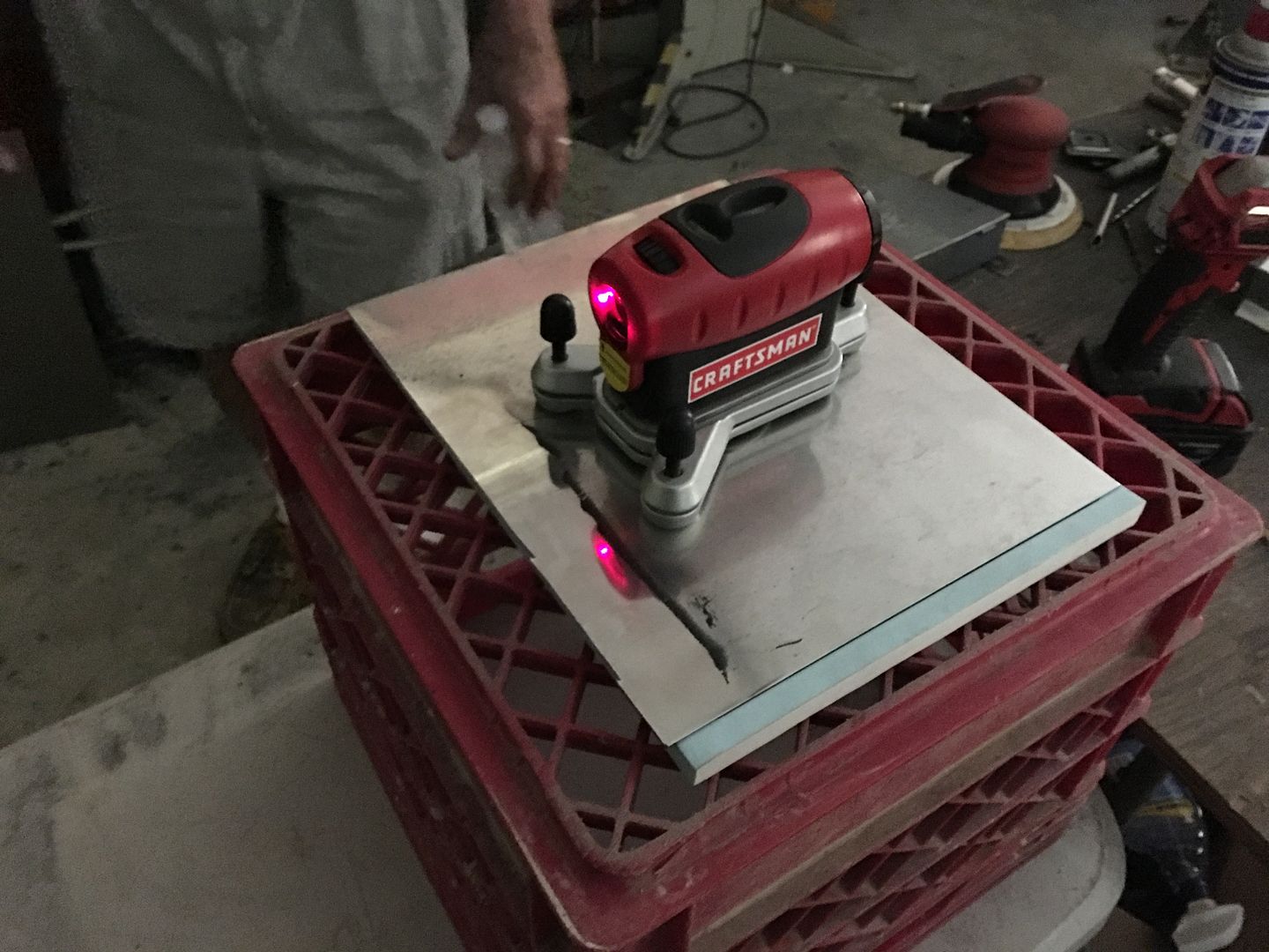

    This evening's progress, the bolting flanges were cut out of 12 gauge steel, and tacked in place using the TIG. Then welded and dressed..
    Next to trim the front of the fender, a laser is set up 13-3/4" above the table holding the fender. This is the differential we measured off the truck from the bumper filler panel down to the running board. all four corners on the table are checked to insure the laser is set correctly. Then the laser line is transposed to the fender and trimmed..
    The height was adjusted by sliding the blocks forward/backward in the fender.

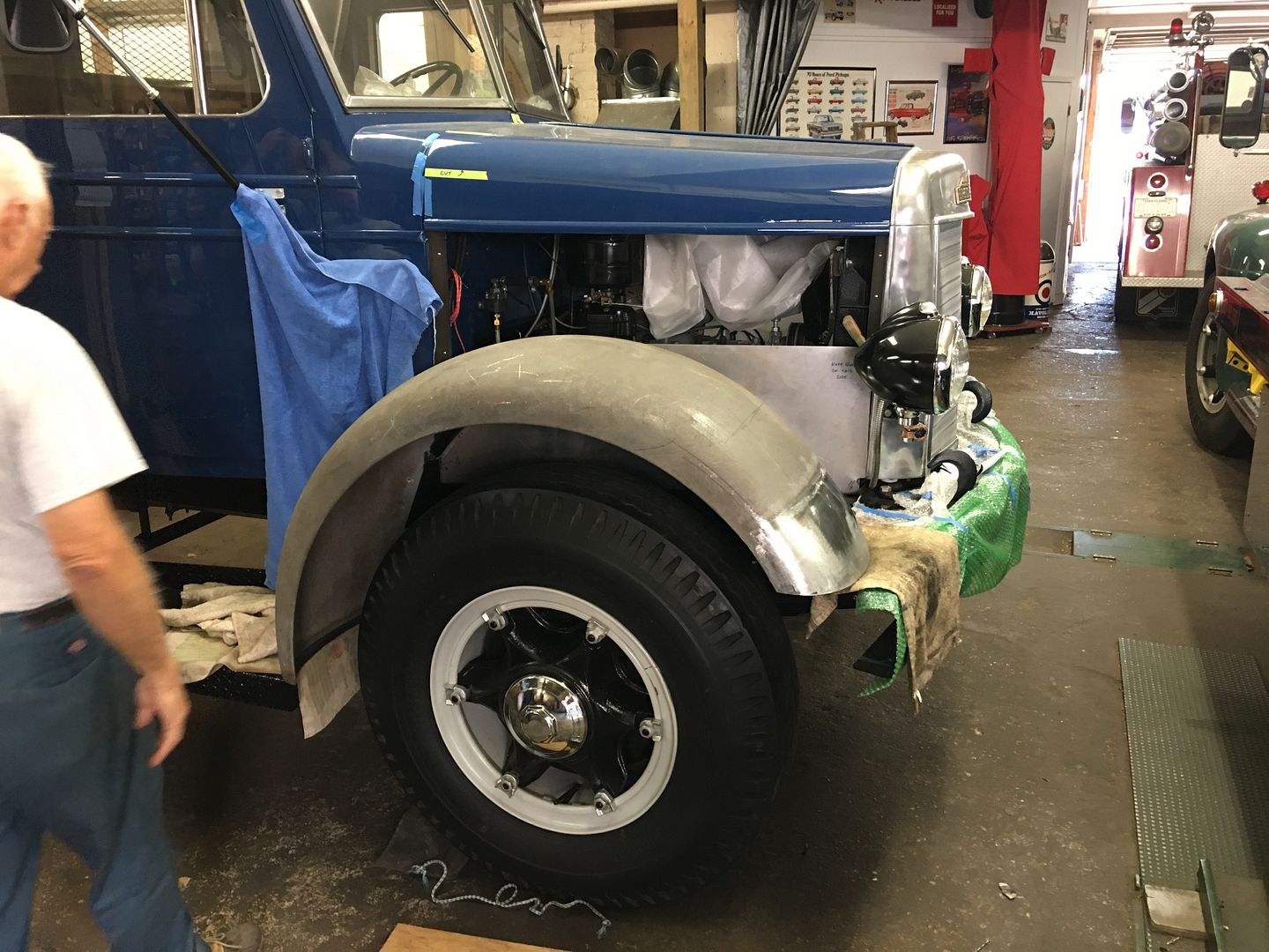

    Tonight we got the lower hood side plug welded to the driver's fender, then the lapped seams were brushed with SPI epoxy primer from both sides to seal out the elements. John will be taking this to a couple shows with the fenders in bare metal, so we needed to seal those areas.
    With the fenders all one piece again, we took them to John's shop for re-***embly. First order of business is to add some welting to the fender area adjacent to the cab's lower cowl area...
    ..then bolted up the fenders and battery tray.. This should give John a head start on the finishing touches tomorrow before loading it up for the Macungie Truck show.
