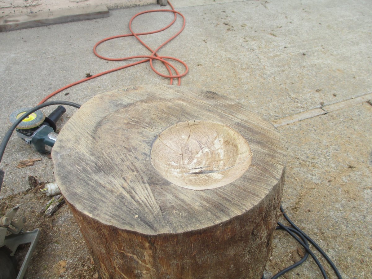

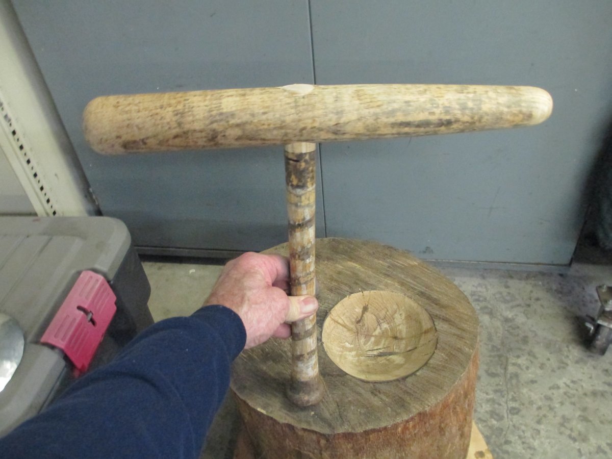

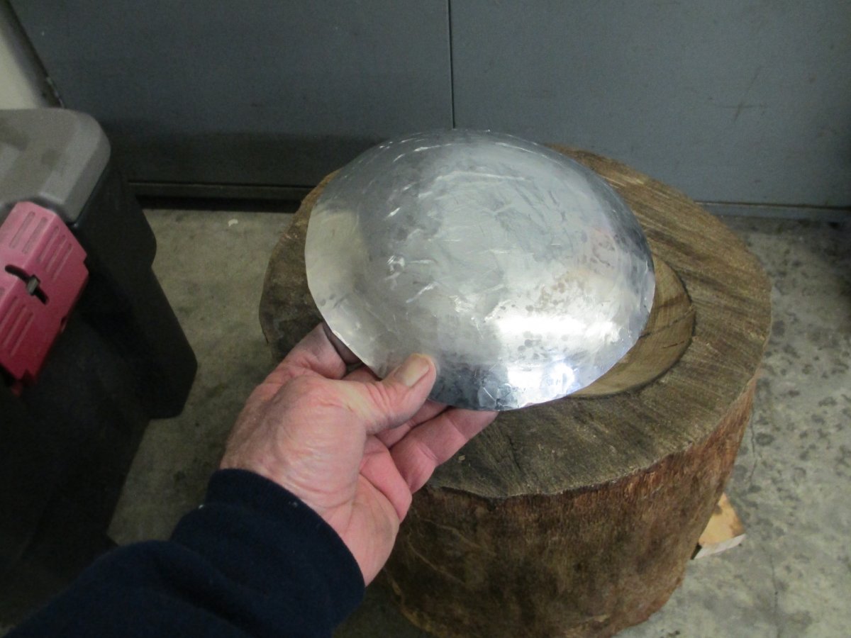

    I finally got around to making a tuck shrinking stump and a bat hammer. For a quick trial, I shaped a hubcap size bowl, albeit still rough, it didn't take long. My current project is a complete aluminum Lakester body for a land speed car, with an enclosed canopy. Just getting started by wheeling the side panels, we will see how it turns out. IMG_1346.JPG IMG_1351.JPG IMG_1359.JPG IMG_1360.JPG IMG_1362.JPG IMG_1355.JPG

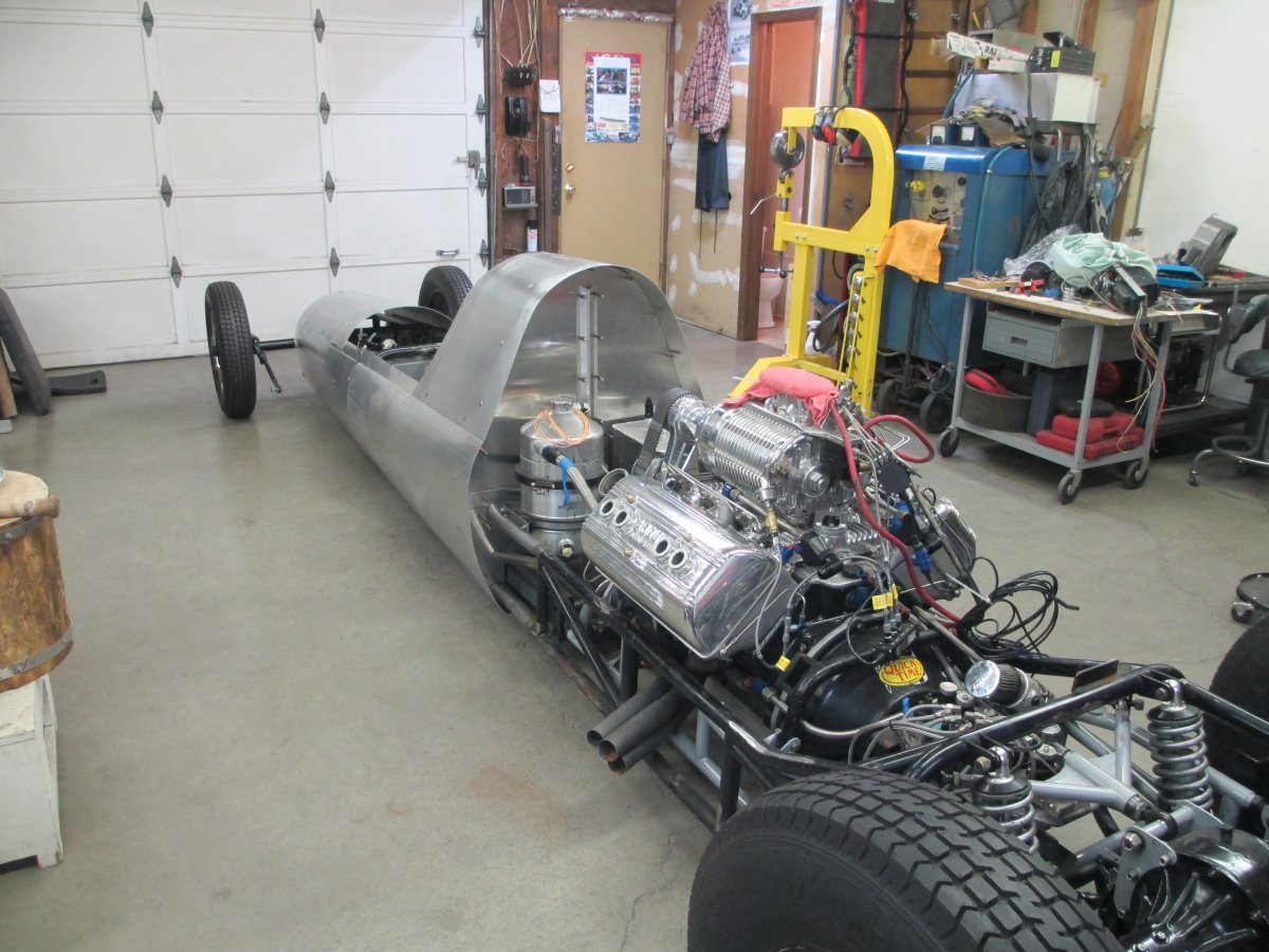

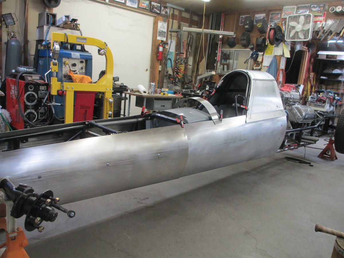

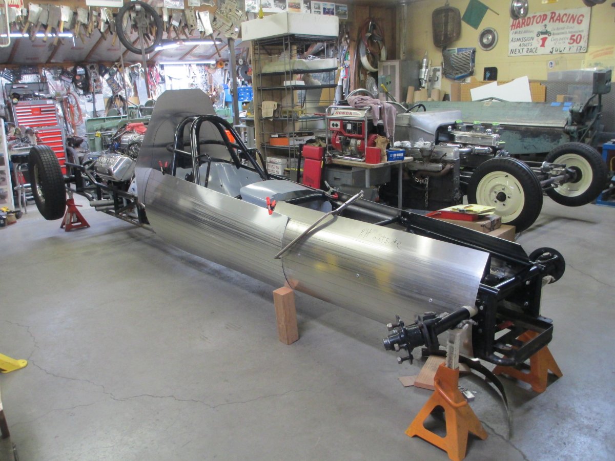

    A little progress on the Lakester body, mainly the bulkhead, front side panels, fuel tank, and rear canopy cover. IMG_1403.JPG IMG_1411.JPG IMG_1408.JPG

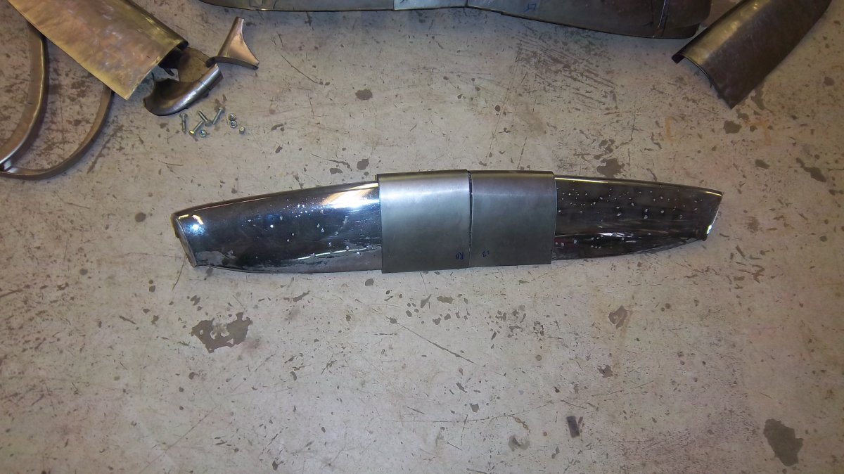

    I posted this on it's own thread, but no response at all and it disappeared quickly. hought it would be better shared with guys that appreciate this work.
    My friend Kenny, who is building his 54 Plymouth in my shop, wanted to stretch his 52 Packard grill to better suit his car. After debating how to weld up pot metal, he decided to make a copy out of sheet metal, as he is more comfortable with that. He'll shape it, weld it hammer it, and smooth it, then to multiple copper dips and sandings before going into the chrome tank. 100_0319.JPG 100_0319.JPG 100_0320.JPG 100_0321.JPG 100_0322.JPG

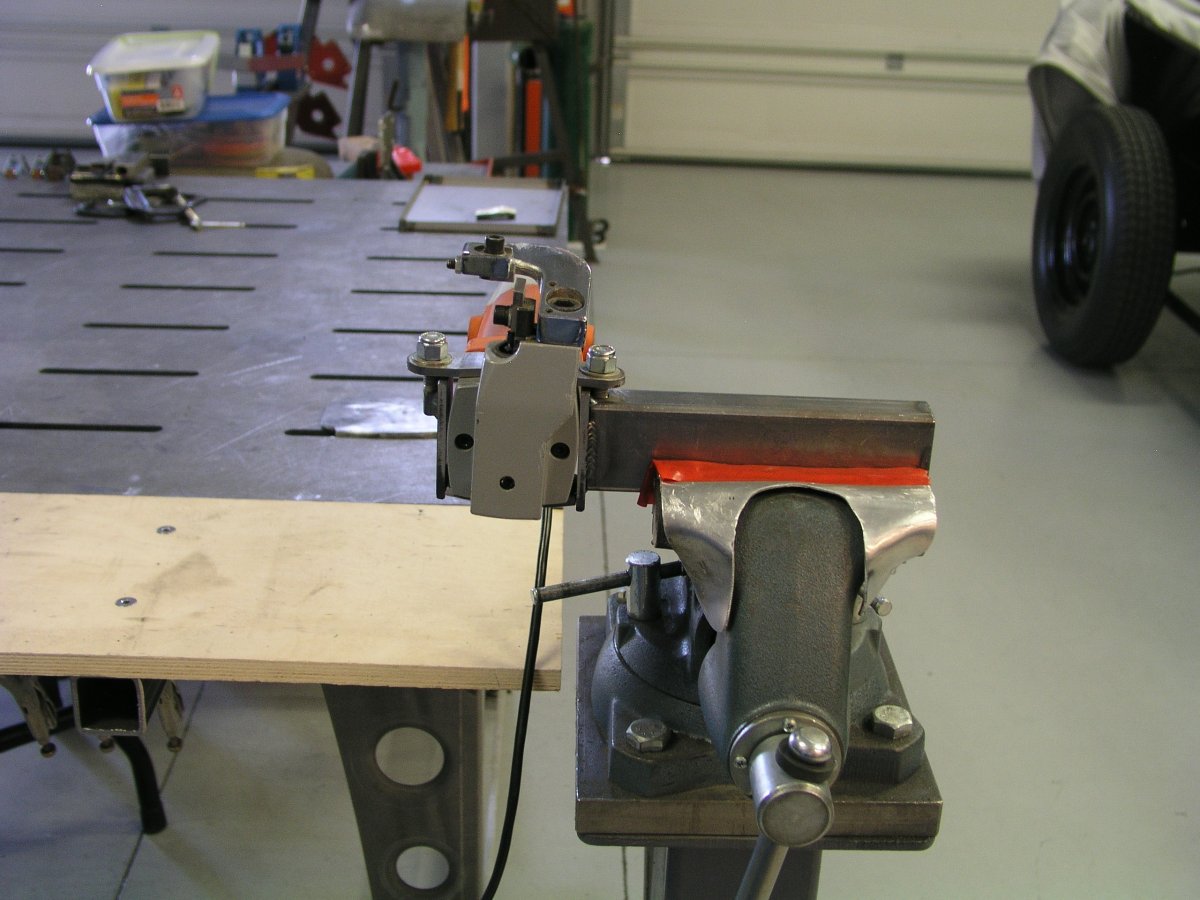

    Bench mounted shear, I took my $29 HF hand held shear and made a vise mount. Allows both hands to guide the metal, works great when cutting down a 4x8 piece.

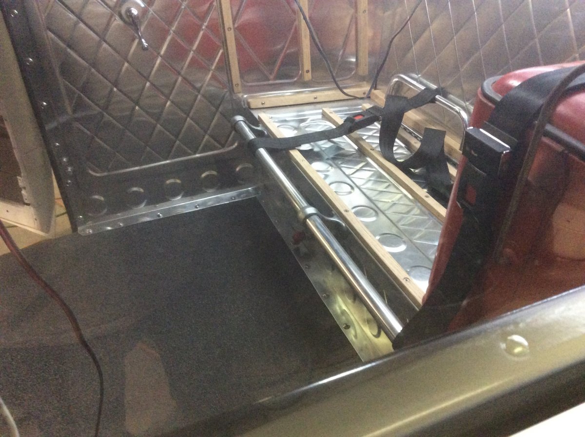

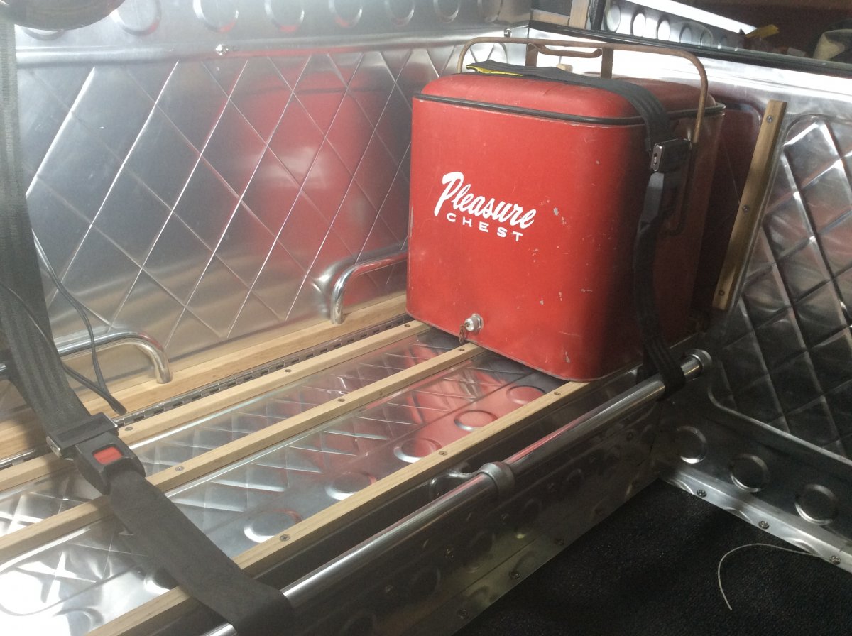

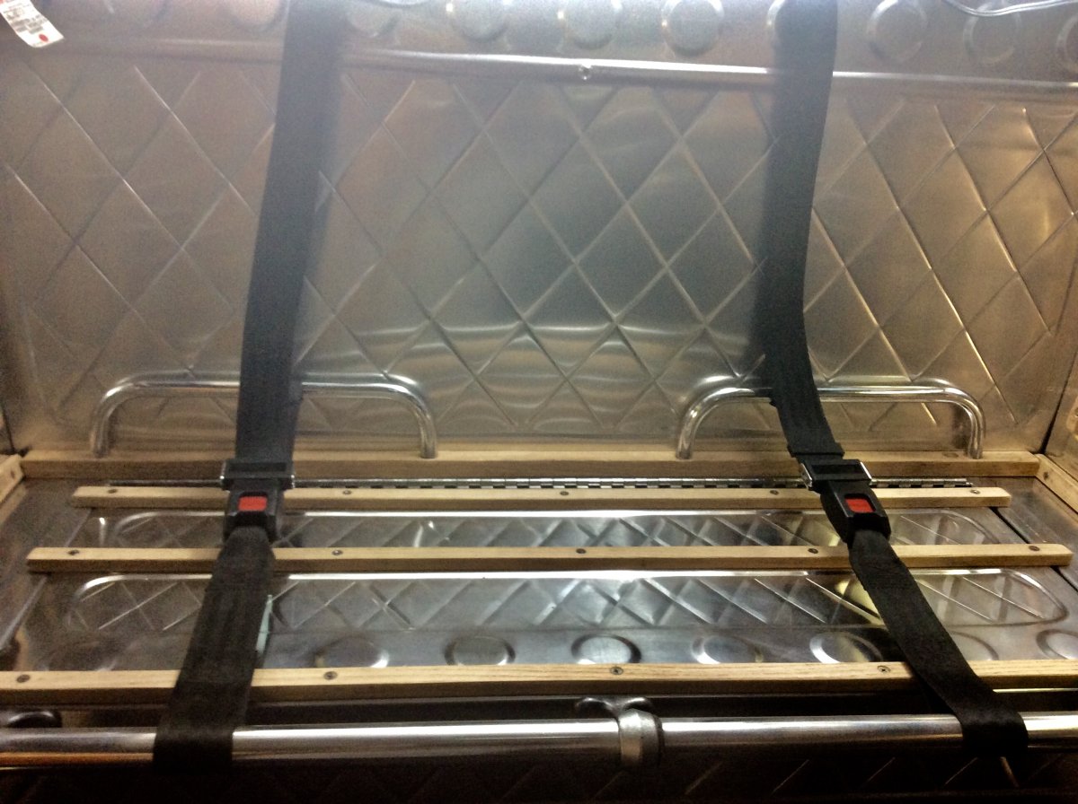

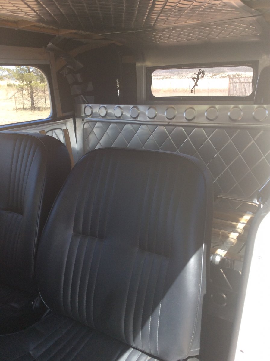

    After many hours of cutting , beadrolling, bending , and mounting I’m about 75% finished with my Al interior. Will finish by the end of the month. Blue
    E8958977-0825-4E9B-B604-23FA0653C704.jpeg E0CD11AC-CF86-4E53-9F56-9FDC56B5FE6C.jpeg A644764D-1D4D-4E8B-B73D-AA4263A14727.jpeg 01F83320-0357-4B6B-A744-D8CC7091A0F8.jpeg 51CAC587-EBCD-40A0-A624-2EB1B07A91EE.jpeg 5CF769DD-4651-4E26-9E4E-D3353B4AE3FF.jpeg D3F23FEF-964B-42E5-A4B8-B21624752708.jpeg E517307C-745F-4D9B-B5CD-66BFD9EF95F7.jpeg

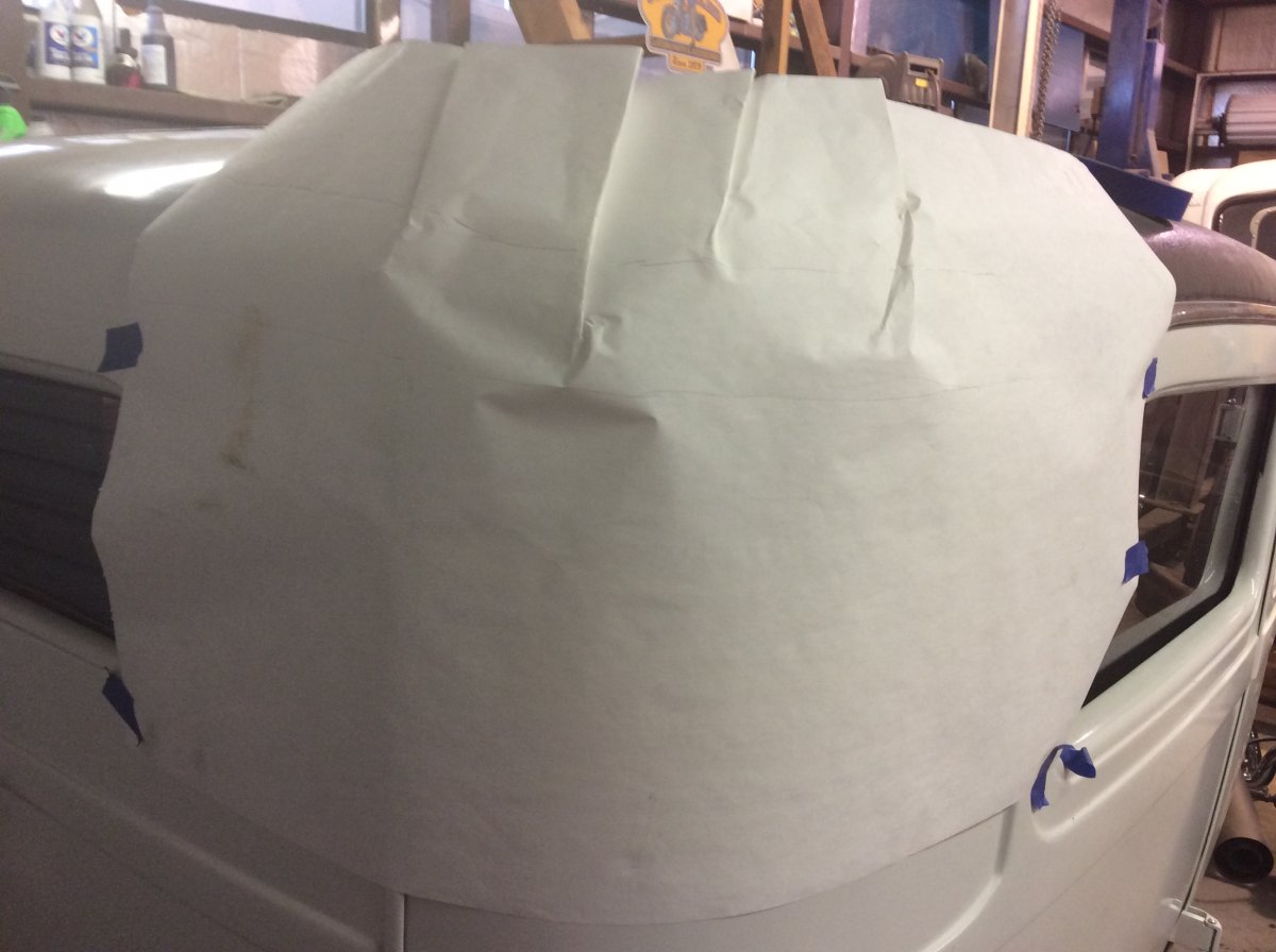

    Today we started fabricating the new hood for the Biederman truck. During restoration John had bought a replacement cab with less rust issues that was a couple years newer, and unfortunately slightly wider as well. Since the original hood did not sit down where the bead details aligned, we're going to fabricate a new one that will fit correctly.
    Doesn't look like these are going to fit either. Me and dominoes..
    Hood is removed and a paper pattern taken for starting point of the new one. Slight bit more material will be added for good measure..
    pattern laid out on 16 gauge cold rolled steel.
    A straight edge finds the start of the radius on either side, marked with tape, and measure to find the center of the radius. Then the radius center and widths get marked onto the new panel.
    the panel was wheeled to add a slight bit of crown prior to switching to the go kart slick for adding the corner radius.
    Both sides formed, ready for t*******..
    Video version:

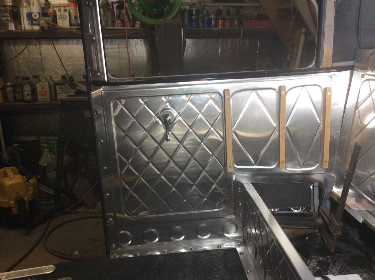

    So I woke up this morning and just wanted to hit something with a hammer . Made a pattern for inside cab corners and started shrinking some Al. could not get the radius small enough .? Did make a little rice runner fairing with it though . No buck just free hand . Needs planninshing but my cheap *** China anvil broke again for 3rd time . Can’t shrink the radius enough , any ideas ?
    03A2484D-3657-4FFA-9032-CAF0513C1788.jpeg C2521F65-E252-4837-AB19-9FEA9A83FFBD.jpeg EF442A04-4991-4F7F-B8D7-4A4D200FCC2D.jpeg 027F3023-00F1-481E-A1AA-7328933CDB21.jpeg 36B71382-A6B0-4363-A95F-AFB357912910.jpeg

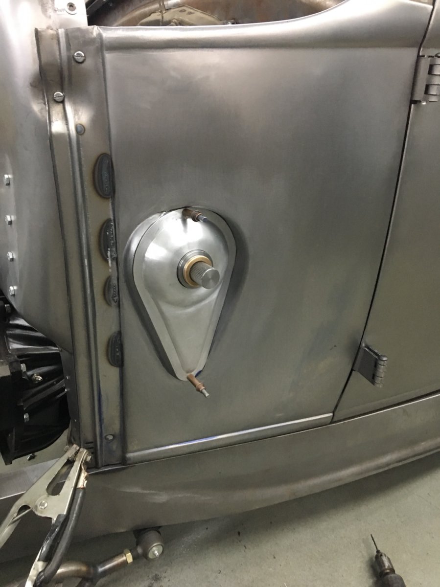

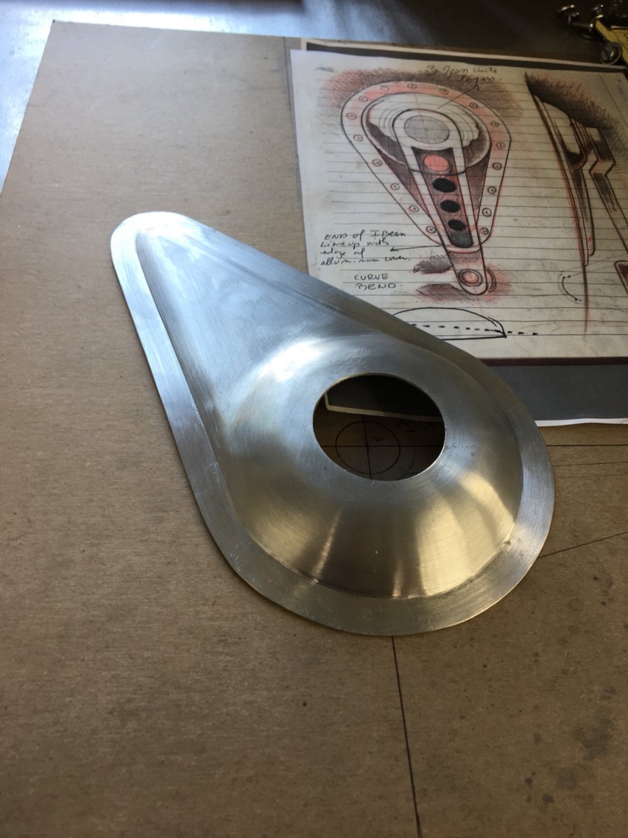

    For quite a while, the work I have been doing hasn’t required much sheet metal shaping. So it was fun to get back at it a little bit this week.
    I made this aluminum blister for a cowl steering setup. It is going to get some br*** embellishment, but I’m going to fit it to the car first. It’s being mounted in a recessed pocket in the cowl.
    I’ll post another photo when it’s further along.
    jerseyboy, The 39 guy, brEad and 10 others like this.

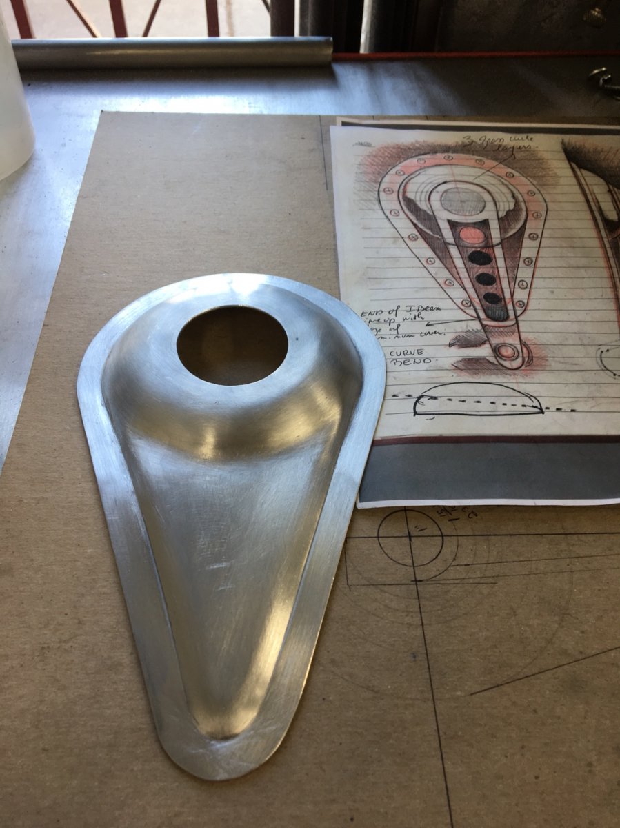

    I got the half recessed half embossed panel made and fit and welded to the cowl. Next step is to get the blister finish fitted to the panel, and add the br*** embellishments.

    An update on my Lakester body project, the enclosed canopy is my current challenge. The plan is to hinge it on the p***enger side, so it can tilt sideways. IMG_1451.JPG IMG_1455.JPG IMG_1456.JPG IMG_1458.JPG
