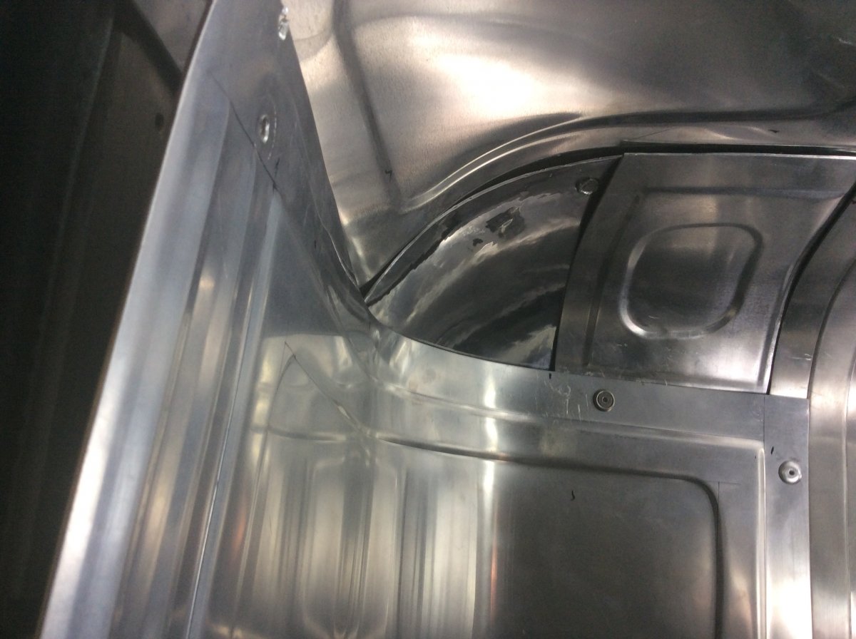

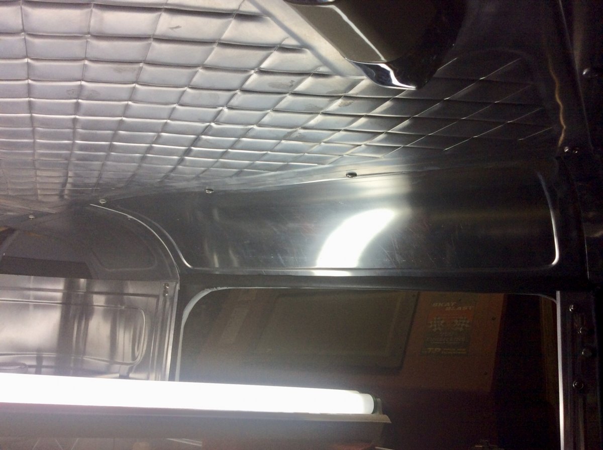

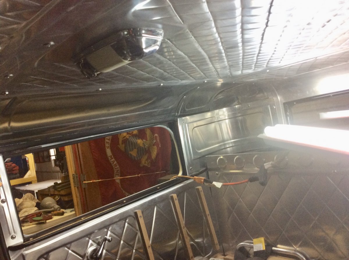

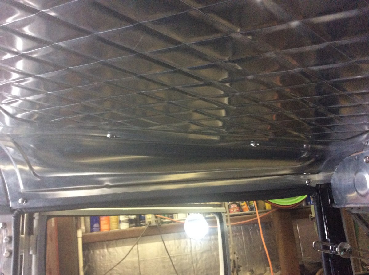

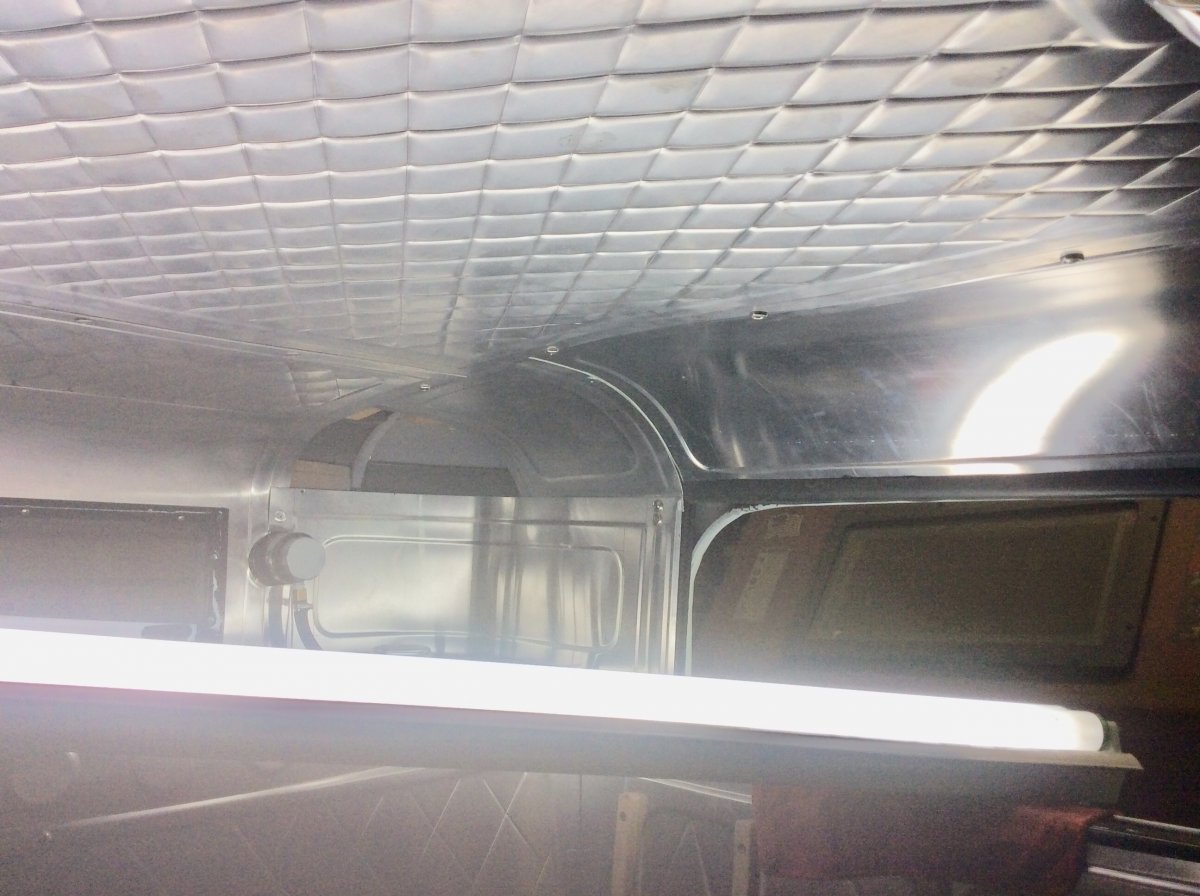

    Worked on my headliner a little this week . Got8of the10 side panels done . Couldn’t get my thumb nail dies to do right, so did the old stump trick . Still need to tweak the corner piece and going to make longer b post covers . As Mr. Winfield says “ everyday is a school day , I got a C “
    DE24A9A6-15AF-4C9B-8549-7027E05FAD17.jpeg F4F81936-A7A1-4C91-A875-C94DFBFAF3E0.jpeg 92263981-E532-4958-9560-AF44E33CBF8B.jpeg 66EA573B-7FD2-4F3C-8843-4CC8847C6BBE.jpeg 4C09DD24-FDEB-4C07-8766-663995F69CDF.jpeg 64948C5F-A094-4B57-AECD-F54D5CFE0FB8.jpeg
  4. 56 Dodge Pickup
    Joined: Jul 1, 2009
    Posts: 1,837
    56 Dodge Pickup
    Man that looks amazing! What gauge metal are you using? And is it sheet metal or aluminum? Always trying to learn Hobo Jim
  5. JOYFLEA
    Joined: Jan 22, 2013
    Posts: 2,056
    JOYFLEA
    .062 3003half hard Al. Thanks for the comment. Hope to have interior done by next weekend. Front door panels should be fun to do , much more than the rounded pieces .

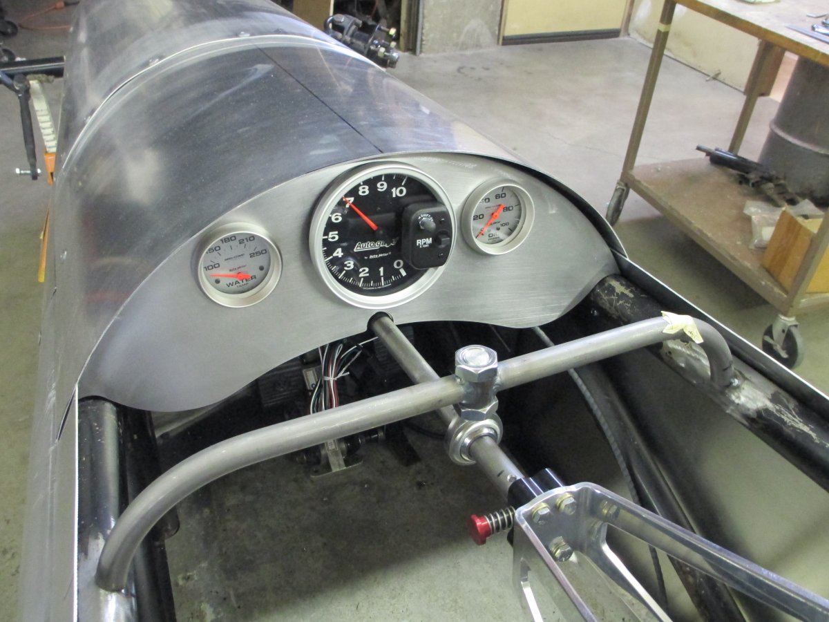

    I built a guage panel for the Lakester this morning. Not much shaping, just some angle shrinking, welding and grinding. IMG_1501.JPG IMG_1502.JPG IMG_1503.JPG IMG_1504.JPG IMG_1505.JPG IMG_1506.JPG IMG_1509.JPG

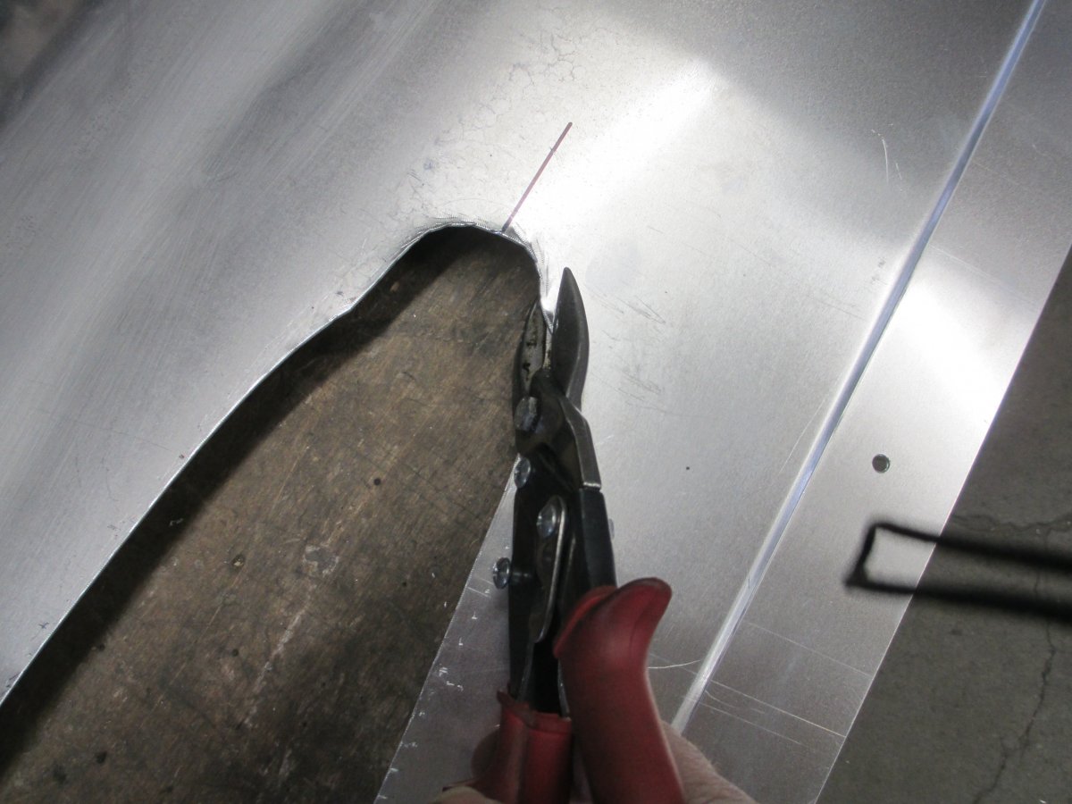

    I started on some tear drop bulges for the side panels on the Lakester, to clear the plug wires on the Ardun. Now I will hammer out another one, then cut and flare the openings to match the outer perimeter and weld them on. More to come. IMG_1574.JPG IMG_1579.JPG IMG_1580.JPG IMG_1581.JPG IMG_1582.JPG IMG_1583.JPG IMG_1584.JPG IMG_1585.JPG IMG_1586.JPG IMG_1588.JPG

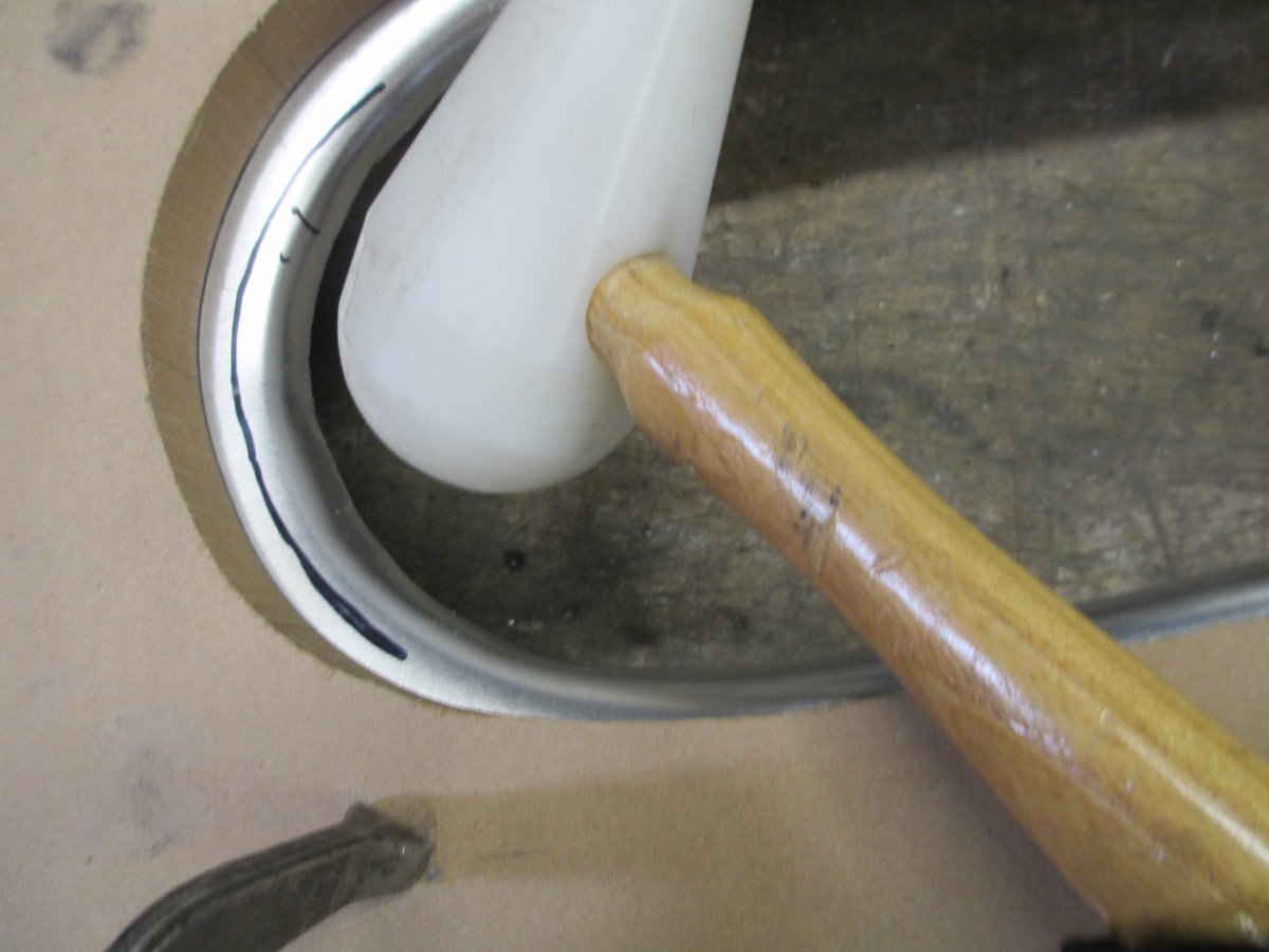

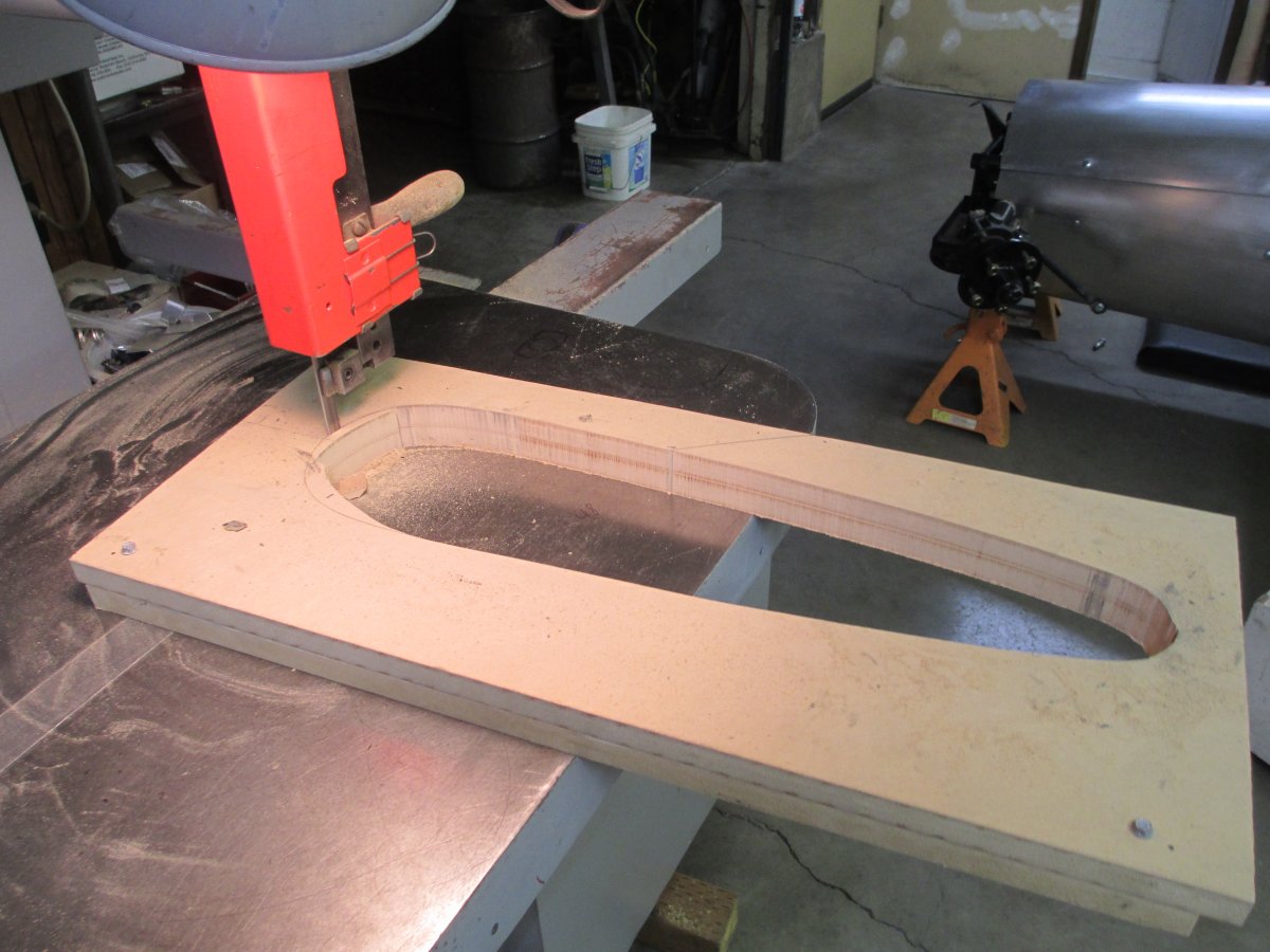

    I got one side done today ! My first attempt at building and using a hammer form. IMG_1591.JPG IMG_1595.JPG IMG_1597.JPG IMG_1599.JPG IMG_1602.JPG IMG_1605.JPG IMG_1608.JPG IMG_1609.JPG IMG_1611.JPG

    I built a buck and now getting going on the nose for the Lakester. IMG_1683.JPG IMG_1686.JPG IMG_1698.JPG IMG_1702.JPG IMG_1699.JPG IMG_1703.JPG IMG_1704.JPG IMG_1705.JPG IMG_1706.JPG

    Marty that is Great work! What kind of wood did you use for the buck?

    I used 3/4" MDF, out of the same sheet as the hammer form for the blisters. Thanks !
