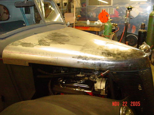

    Here is one I started today.
    I have two '36 ford front fenders. I need to make the front section of this one.
    And get rid of the br***.
    The other side needs work too. I made a shape pattern off the right fender. Inside out it fits the left.
    I made this new toy this weekend. I need it to do the crease down the center. I've been wanting a tipping wheel for a long time to go in the wheel. I have one for my beadroller the throat is very limited.
    I have shrinking dies in my truedge machine, and this "stump" to do the stretching.
    Took a hell of a chainsaw:p.

    what kind of machine is that?
  5. Dyce
    Joined: Sep 12, 2006
    Posts: 1,980
    Dyce
    You talking about the Truedge? It is the same style as a Lennox. Mine is a Baker Truedge.

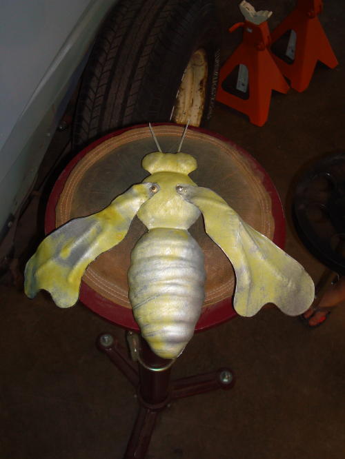

  22. DocsMachine
    Joined: Feb 8, 2005
    Posts: 289
    DocsMachine
    from Alaska
    Does this count?

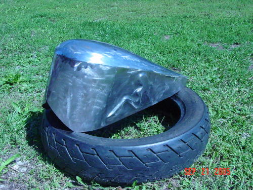

  26. southpaw-customs
    Joined: Jul 19, 2005
    Posts: 475
    southpaw-customs
    Stude p/u bed. I made the lower bedside pieces and the patch panels for the rear fender.

  29. DocsMachine
    Joined: Feb 8, 2005
    Posts: 289
    DocsMachine
    from Alaska
    -Click the "this" in the post, take ya right to 'em. :D
    I need to make another one of those... maybe a sabertooth tiger this time...
