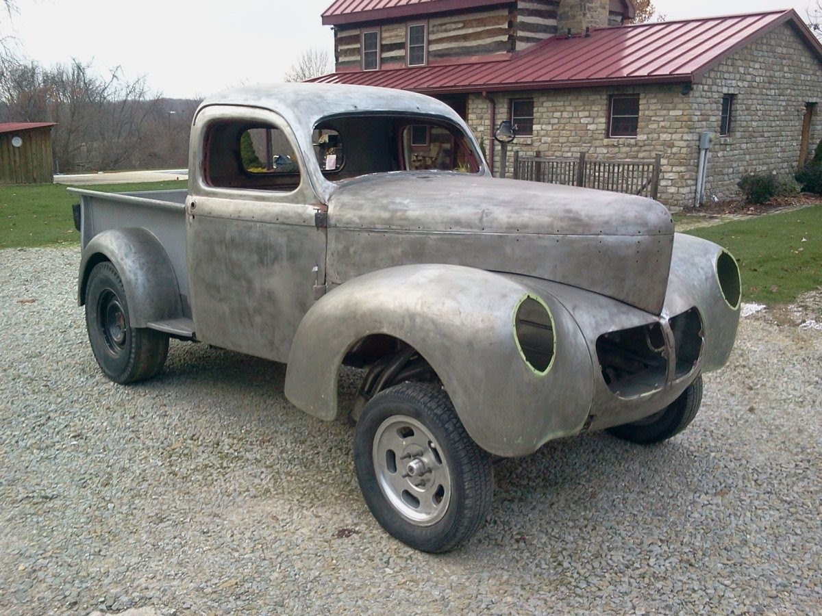

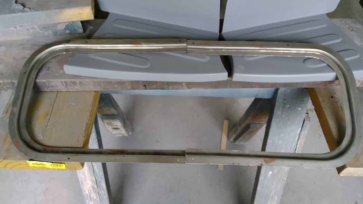

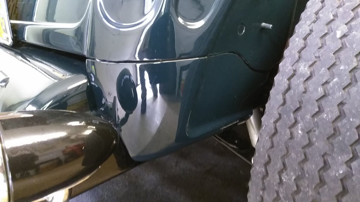

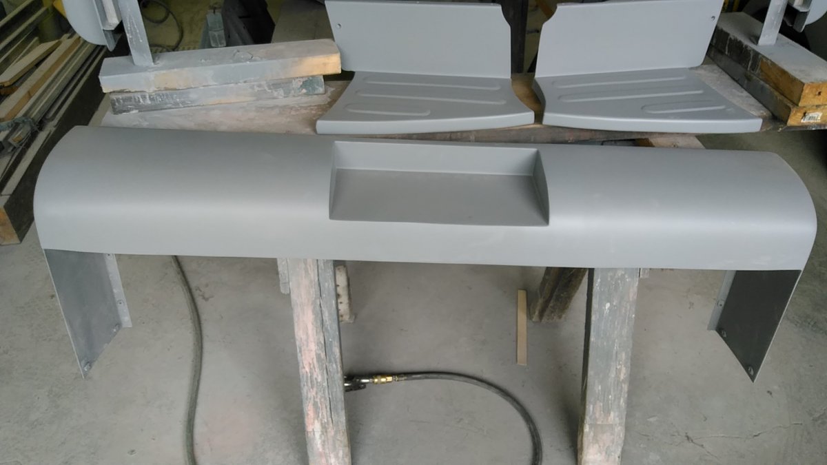

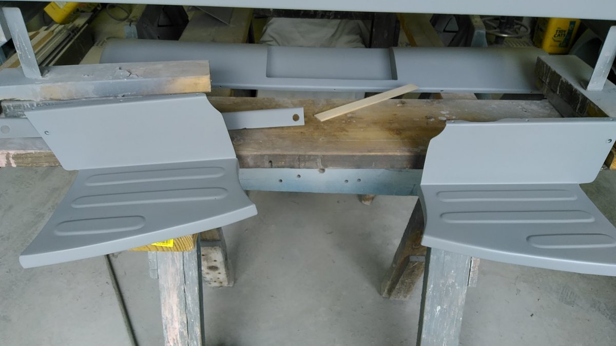

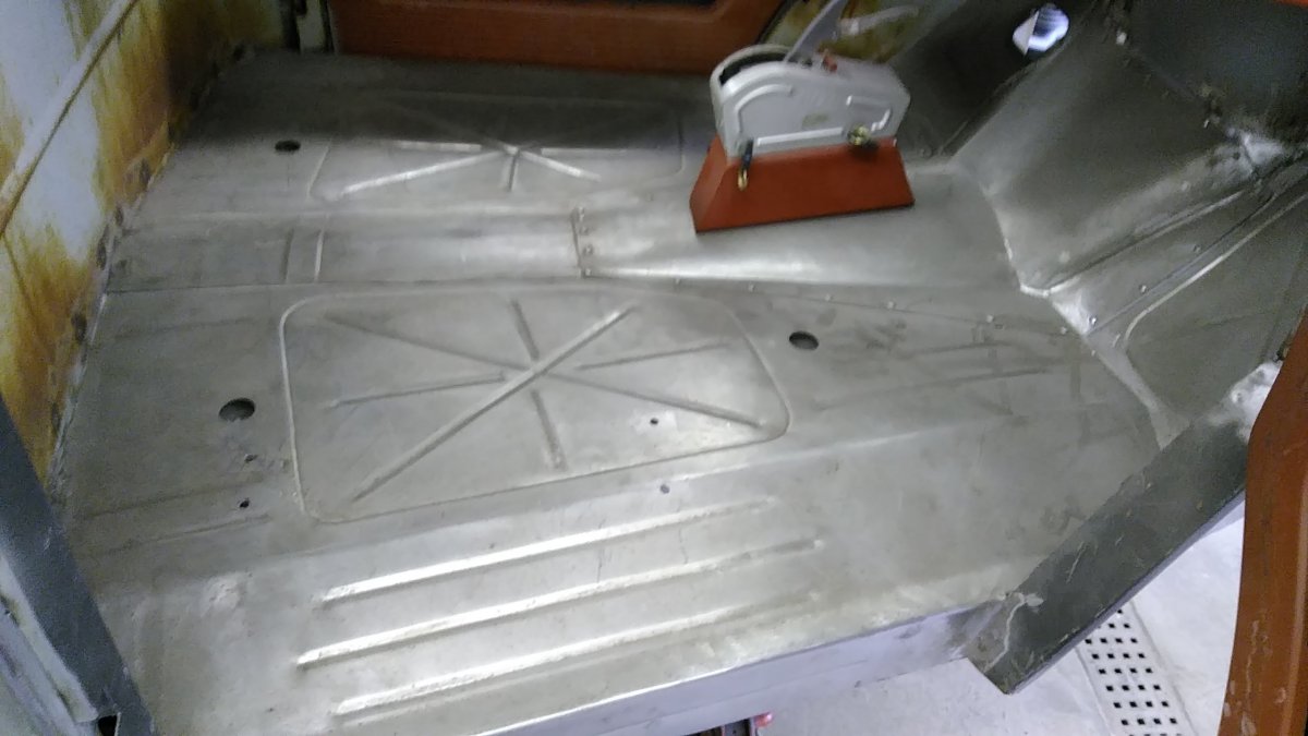

    14894509641931588976588.jpg IMG_20180610_131105.jpg IMG_20180610_125659.jpg IMG_20180610_125508.jpg IMG_20180610_125643.jpg IMG_20180610_131521.jpg Rear corner fill in piece for my 32 hi-boy and floor, running boards and rear roll pan for my Willy's pick-up. Also rear window garnish moulding for the willys
