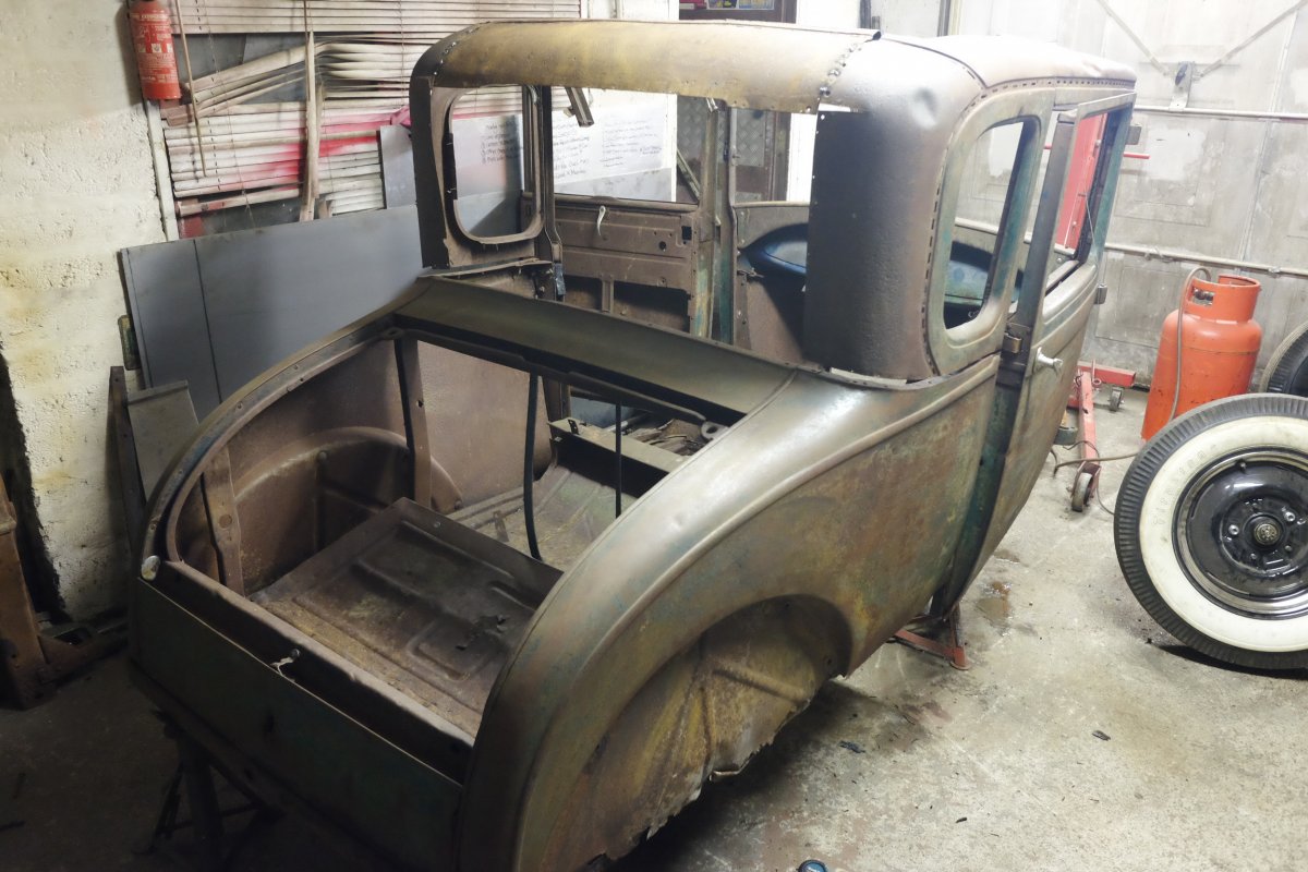

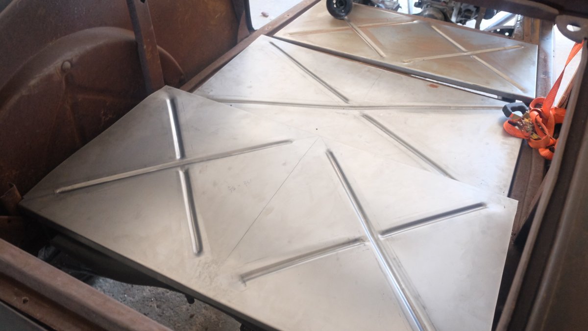

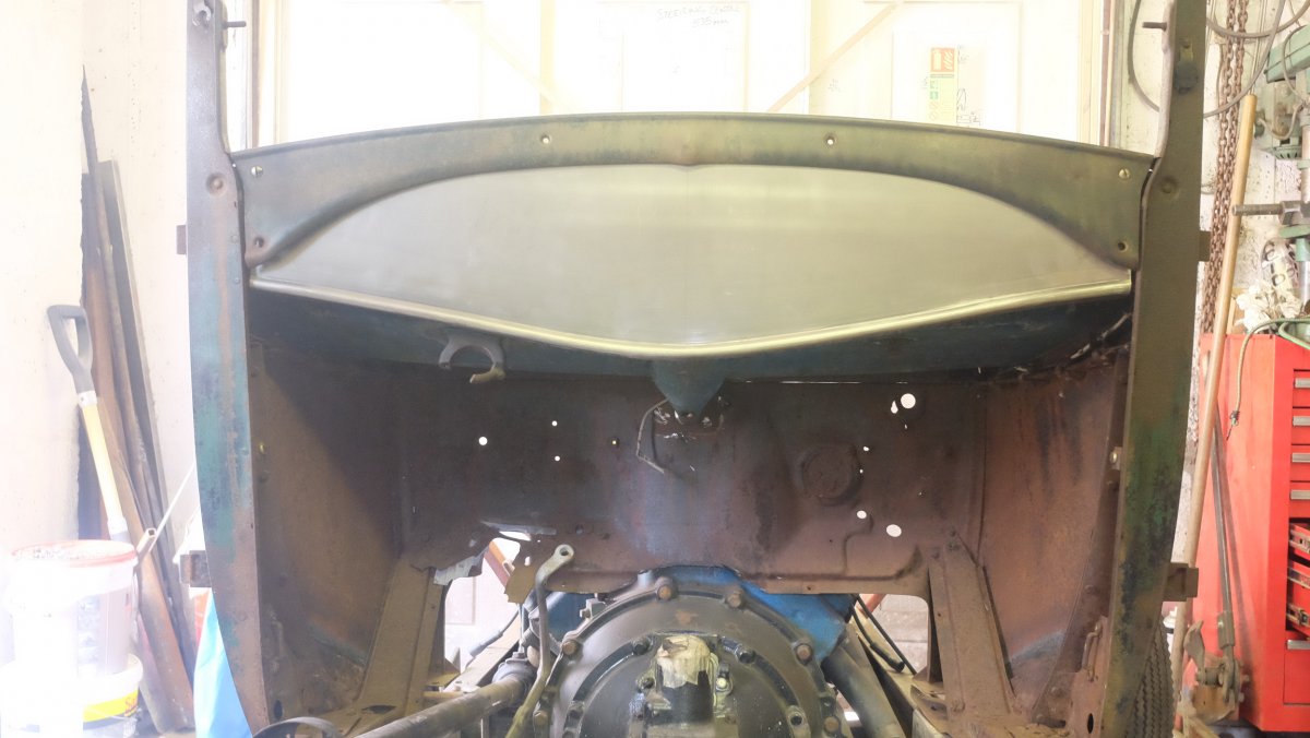

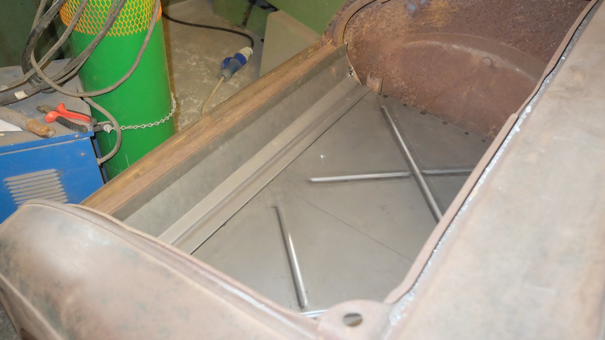

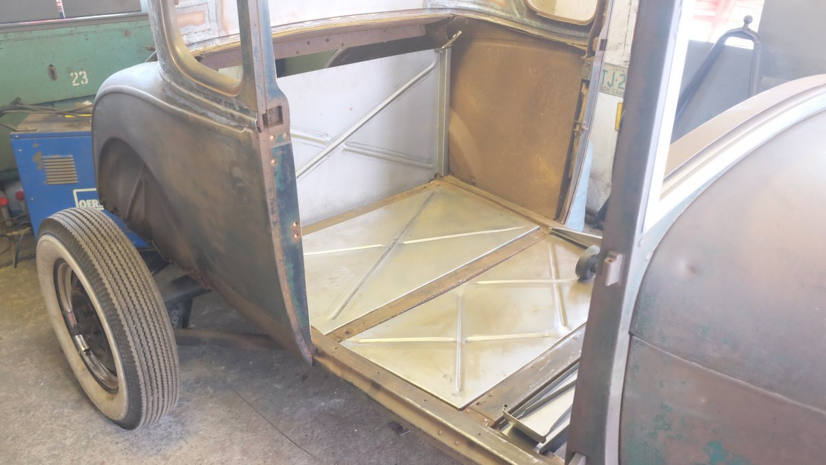

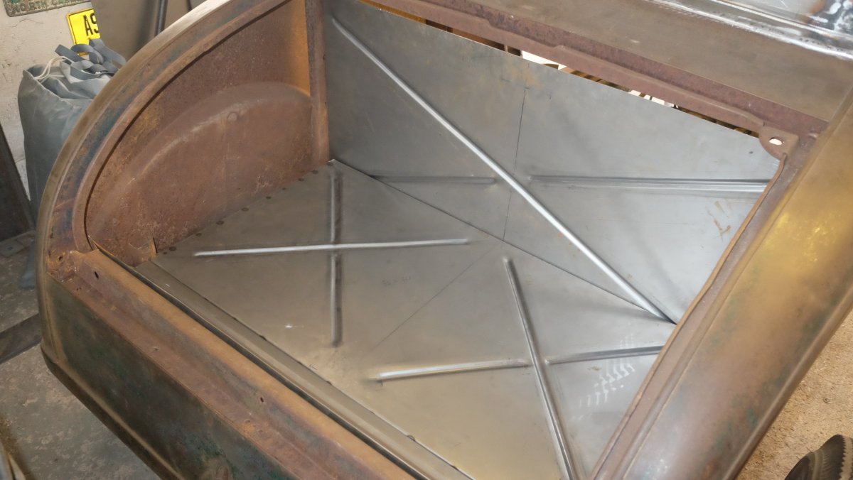

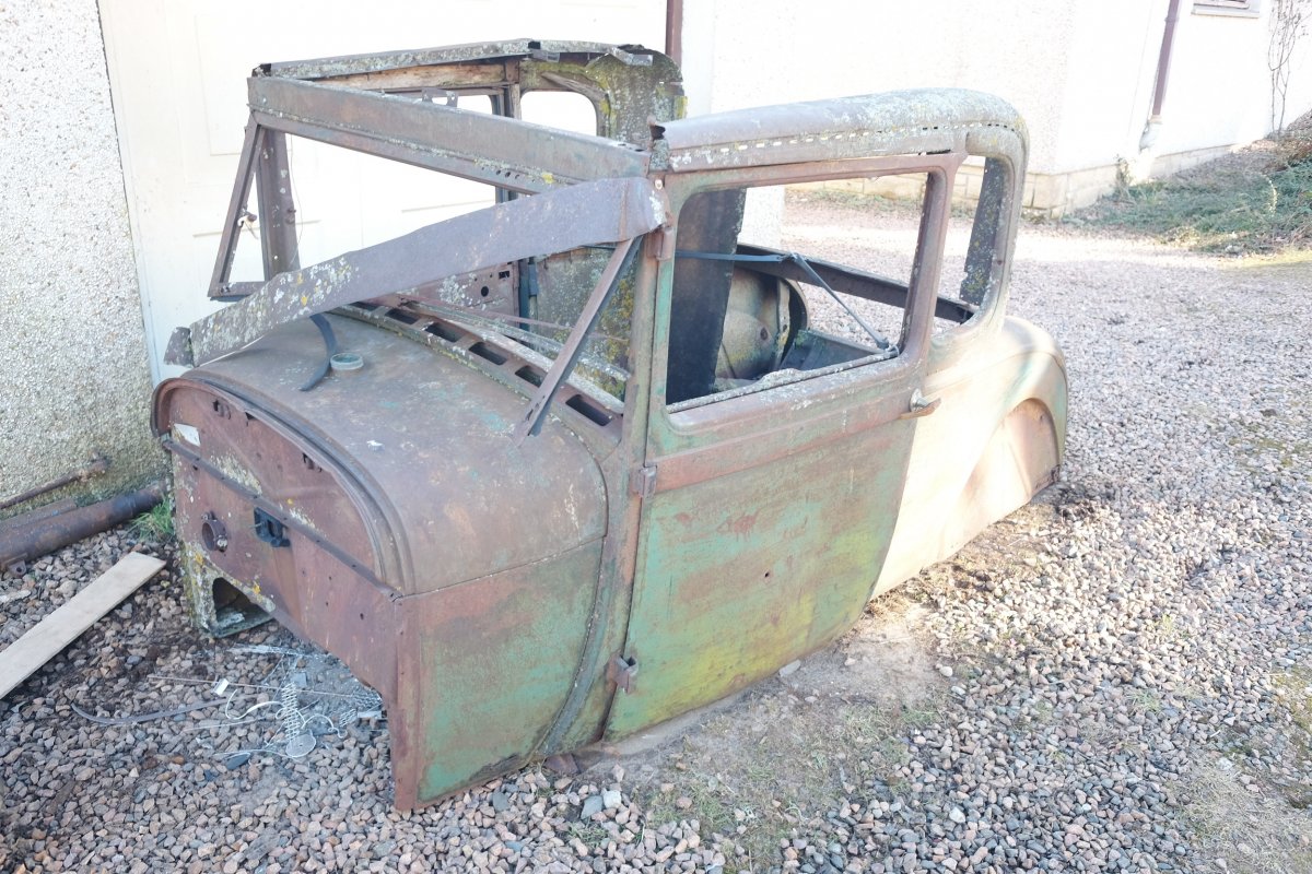

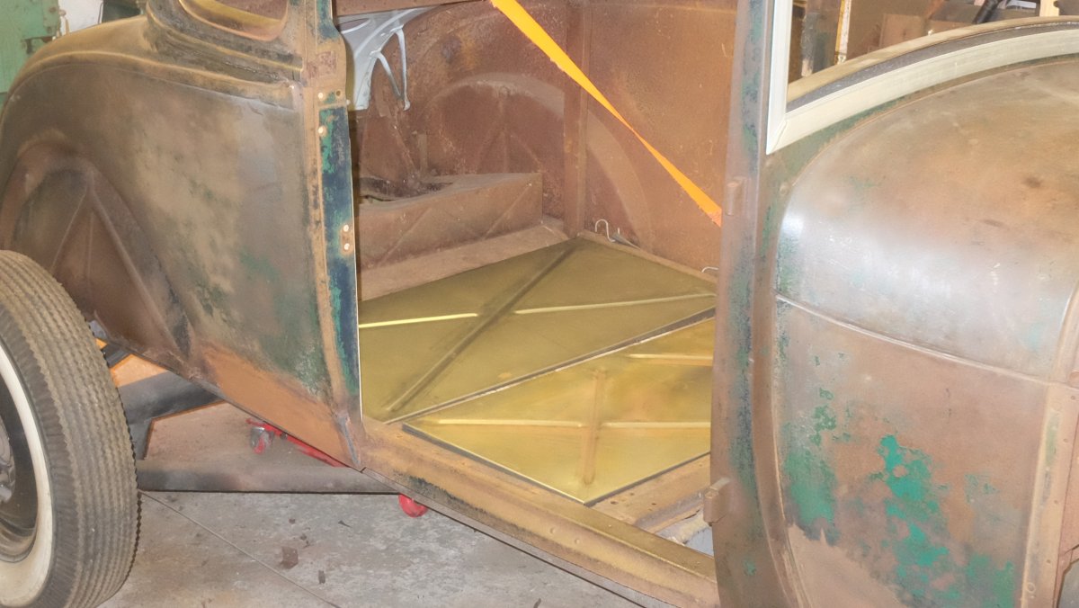

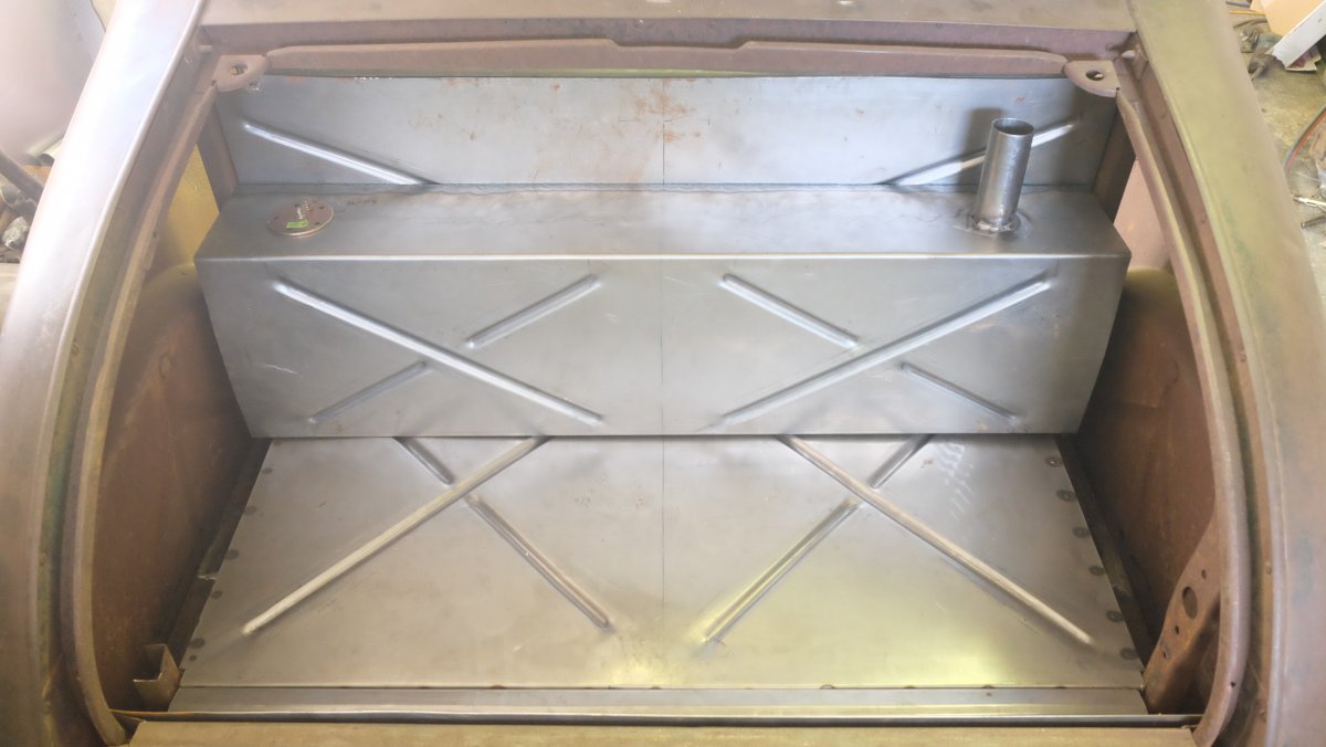

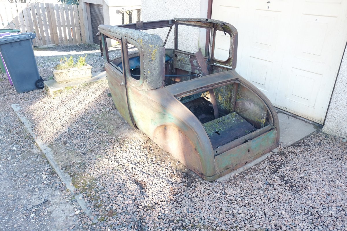

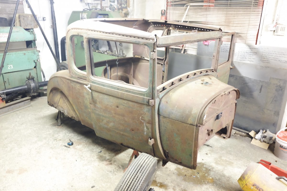

    My junk.. took a 28 special coupe body in part ex for the work on my buddies T .
    body looked pretty rough but turned out not so bad oce the moss was pressure washed off it .. ( never let a first impression taint you) ;) Im just having a bit of fun with this, not being to fussy, just trying to get it done ..
    Currently making this into a proper coupe.. if I can say such a thing? fabbing the rear roof section and other bits .. but keeping the repairs to the bare minimum and trying to blend them in.. BUT this is on hold for now as tied up with other stuff .. the usual story.. But at least on a car the size of an A coupe its not so easy to loose track unlike the 40 Mercury basket case I messed with.. Big cars with big issues need all your attention and no side tracking.. Small uncomplicated cars are more forgiving :)

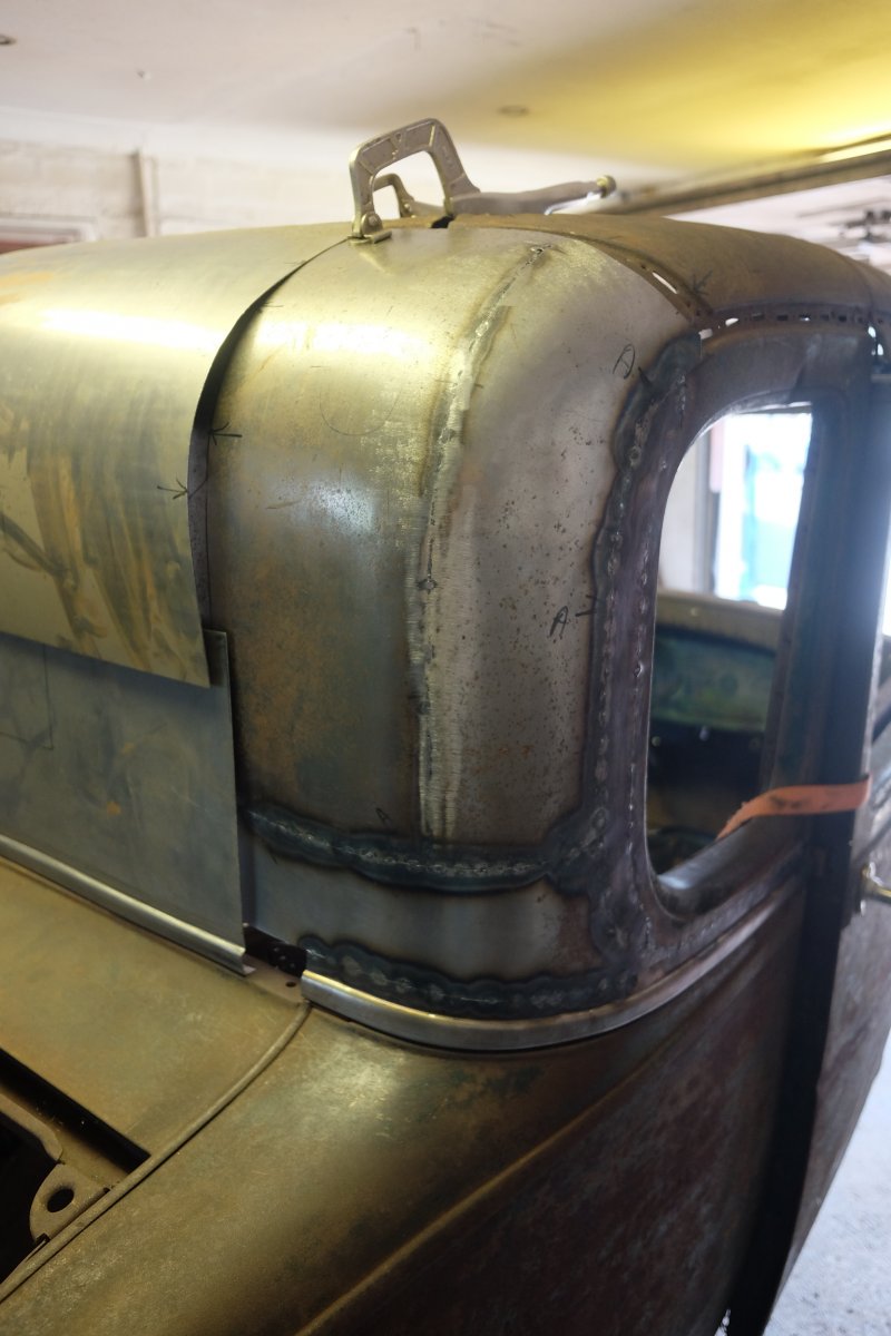

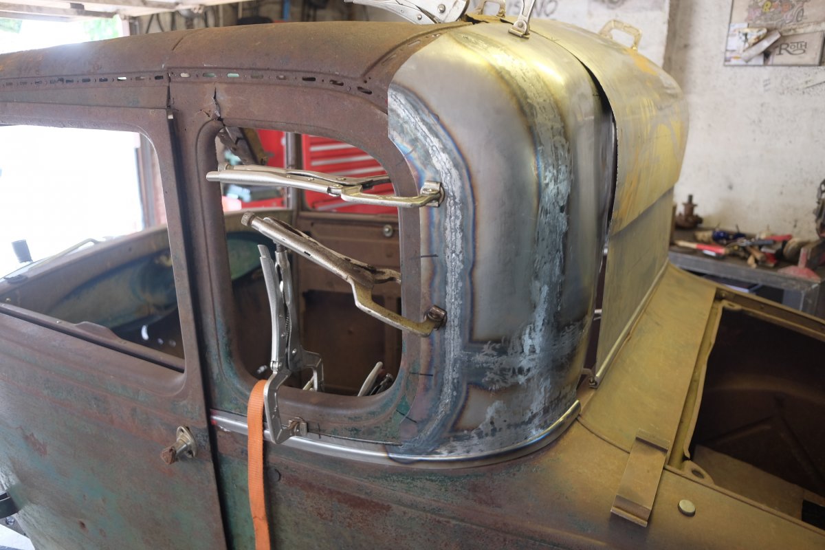

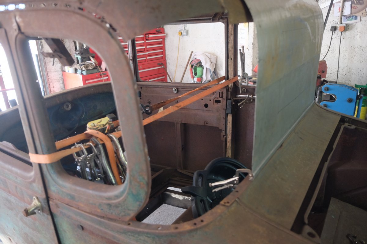

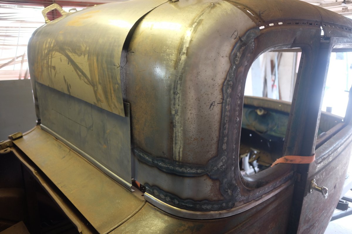

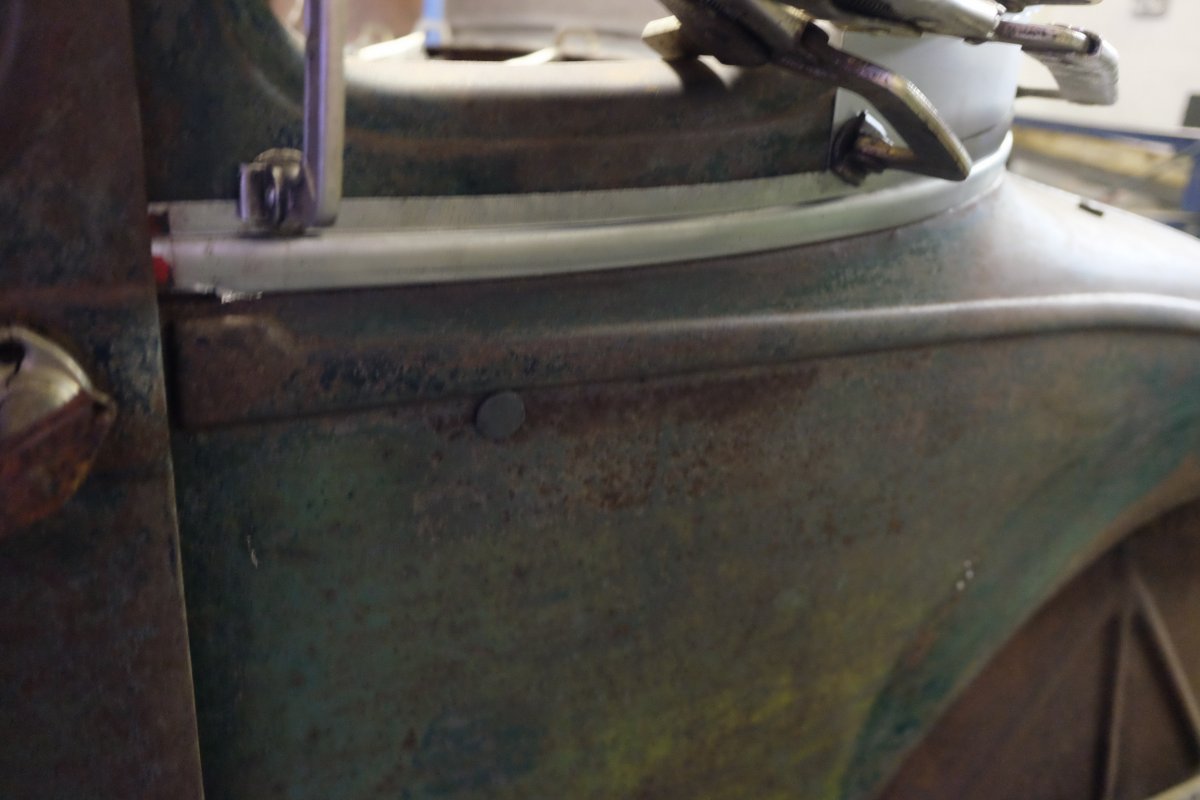

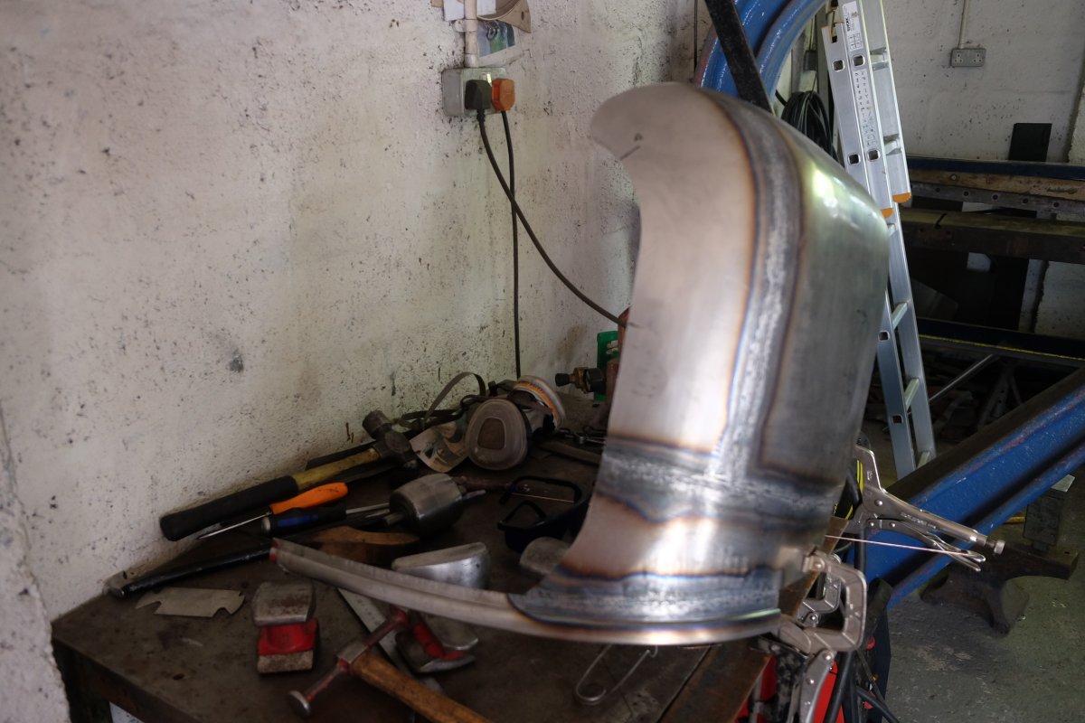

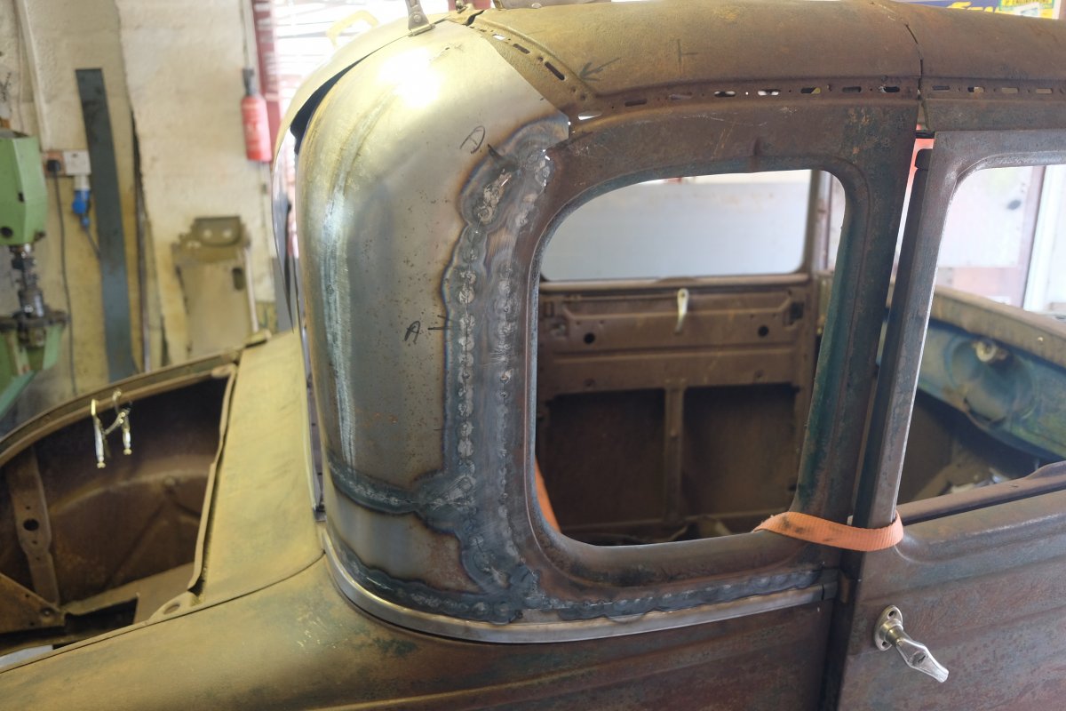

    roof work on the special coupe warts and all :) still got to get around to cutting out the rear window and making the aperture

    Redoxide that's nice work there. Also nice to see someone else that takes "ugly" photos. With what I've been doing lately on the kombi, that kind of shaping just looks like fun to me.
