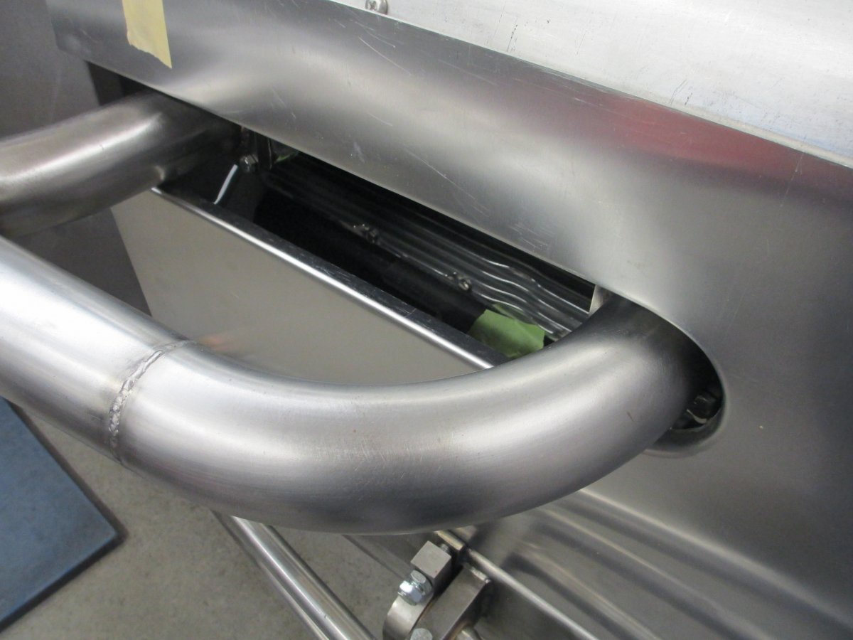

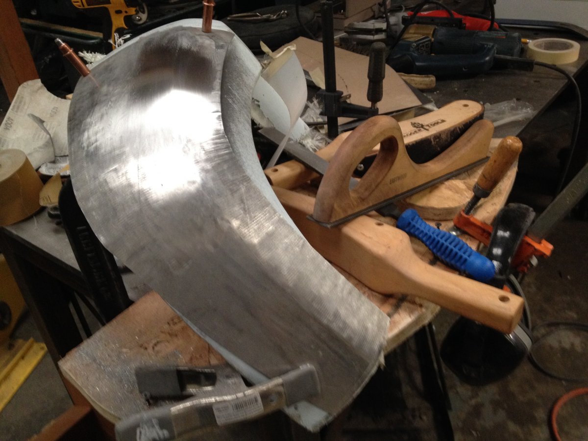

    Some aluminum work on my cyclecar project. Hand formed grille shell, slip rolled hood with bead roller used for hood support structure and engine turned panels. Windscreen frames are made from 2 pieces welded together and polished.

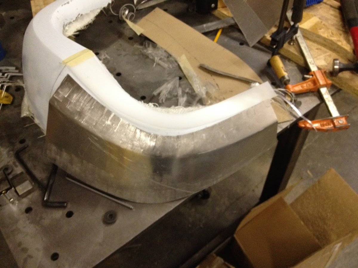

    Here are some construction pics. Used english wheel and shrinker. Plaster buck to fit pieces and weld together. grille2.JPG grille1.jpg grille3.JPG

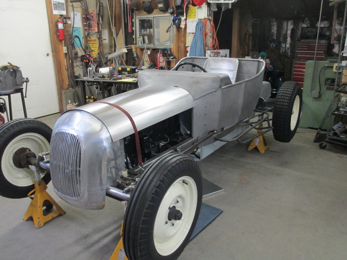

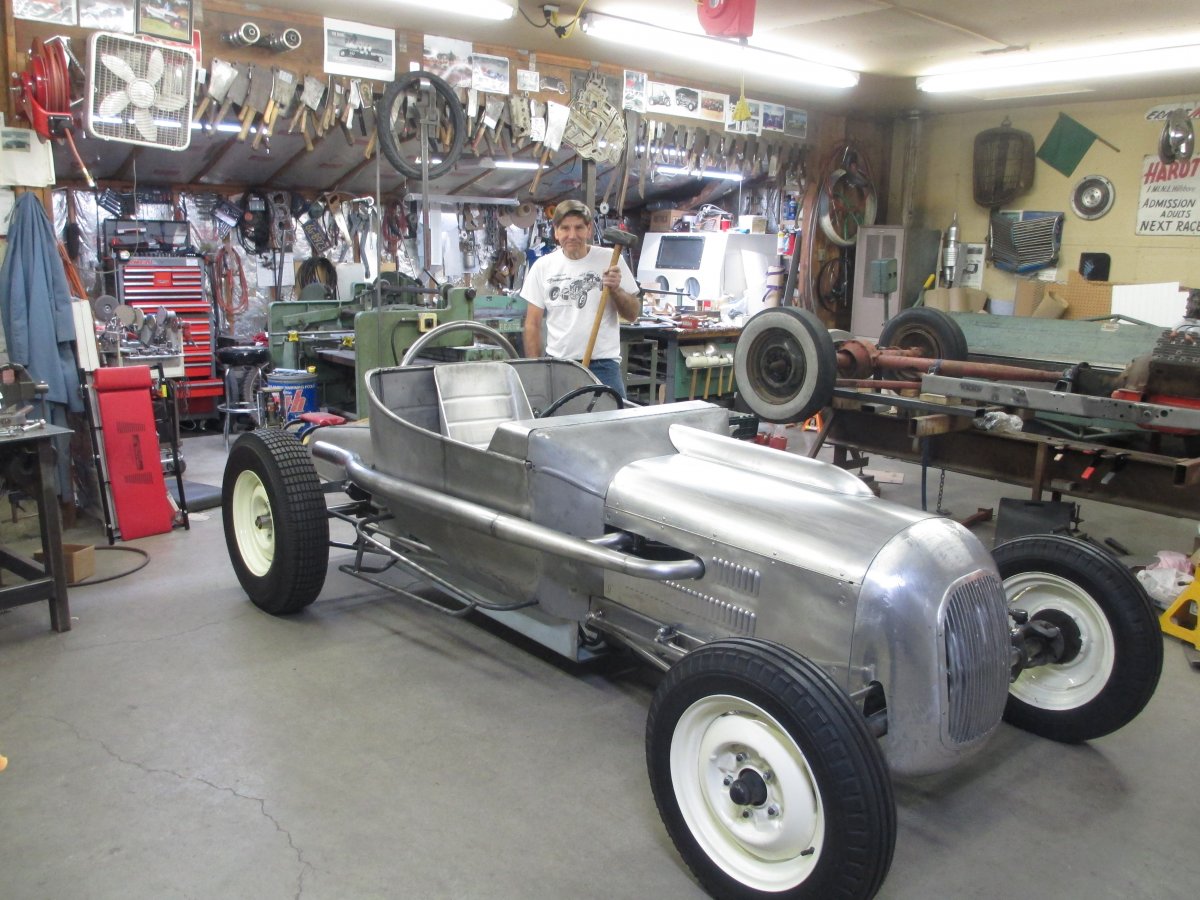

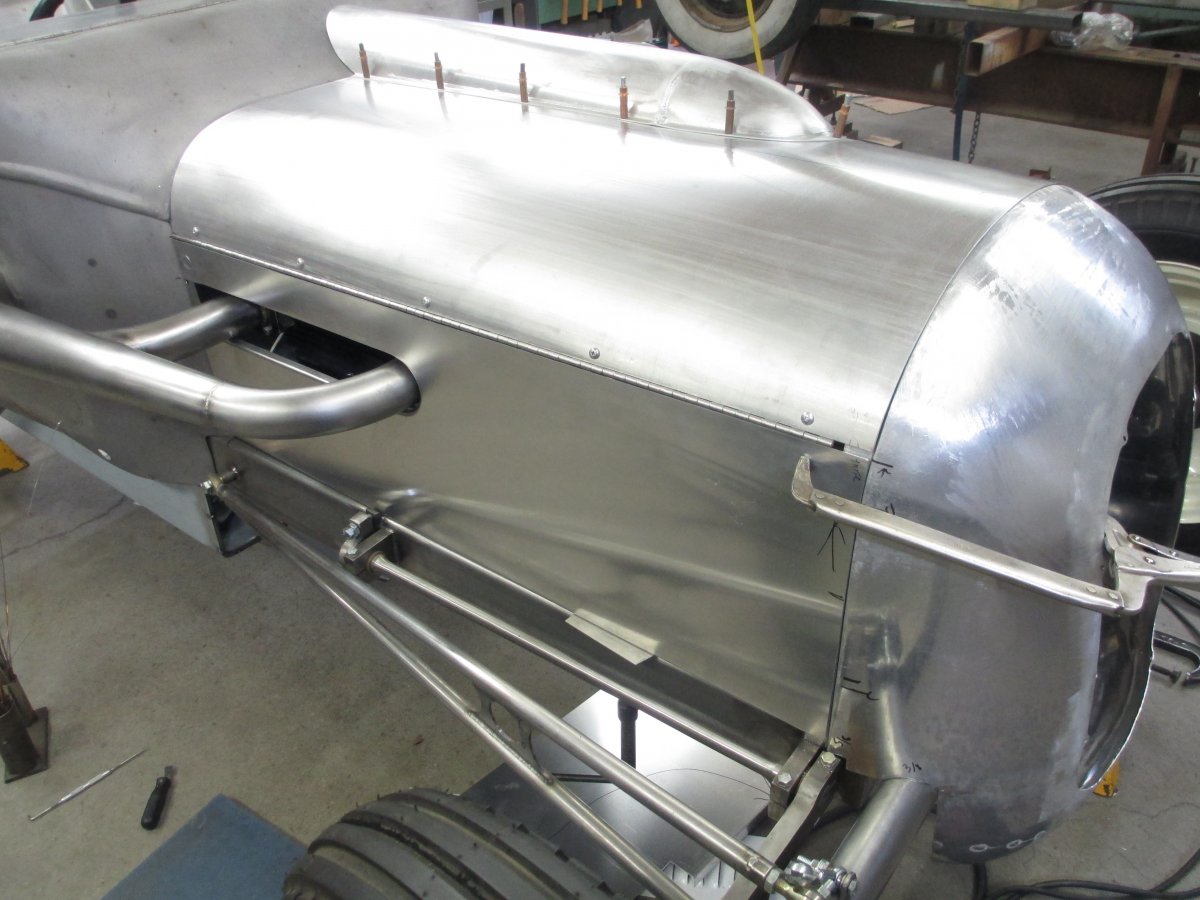

    The hood for our Spalding Roadster copy. IMG_2326.JPG IMG_2378.JPG IMG_2402.JPG IMG_2410.JPG IMG_2420.JPG IMG_2422.JPG IMG_2426.JPG IMG_2428.JPG IMG_2432.JPG

  12. Marty Strode
    Joined: Apr 28, 2011
    Posts: 9,852
    Marty Strode
    Those cleavers, numbering over 180, are my retirement !

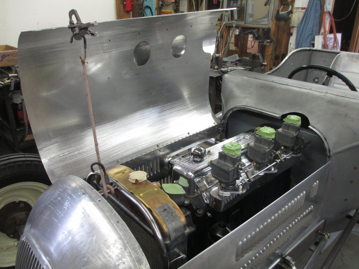

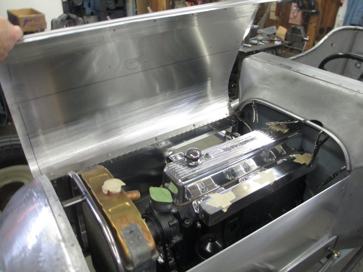

    Thanks for the kindness, I have plenty to learn, just wish I had tried pounding aluminum earlier in life. A couple of shots of the bubble finished, with the hood up. IMG_2550.JPG IMG_2556.JPG
    Okie Pete, XXL__, brEad and 5 others like this.
  17. THE FRENCHTOWN FLYER
    Joined: Jun 6, 2007
    Posts: 6,296
    from FRENCHTOWN
    Nice work.
    But I must be missing something...
    Where does the air for the carburetors come from? Under the hood around the entry ways to the three carbs?
    King ford and loudbang like this.

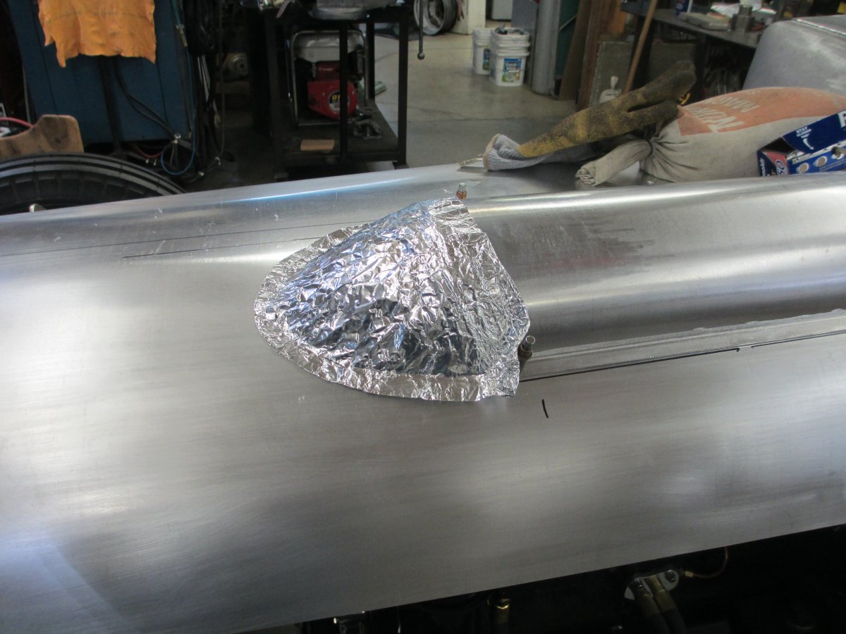

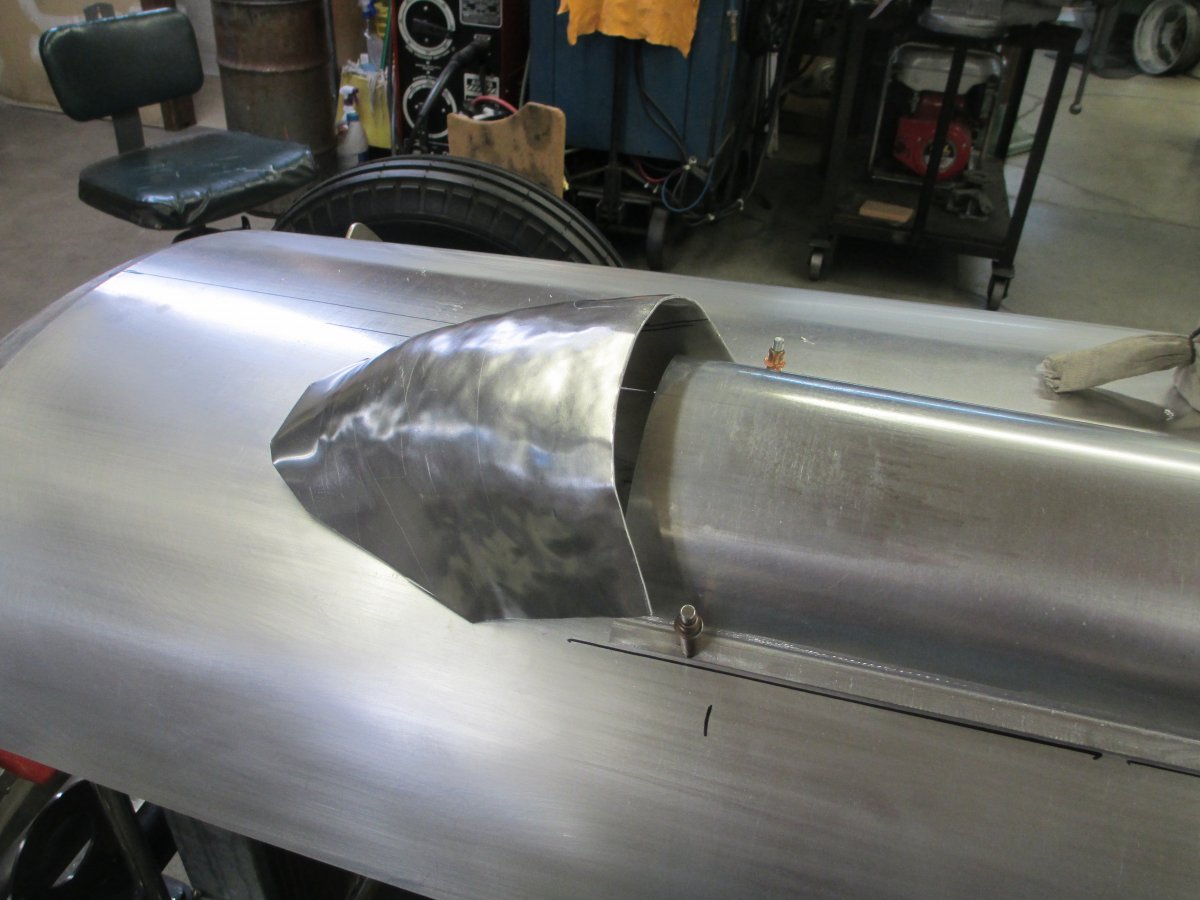

  18. Marty Strode
    Posts: 9,852
    Marty Strode
    Okie Pete, 36 ROKIT, brEad and 5 others like this.

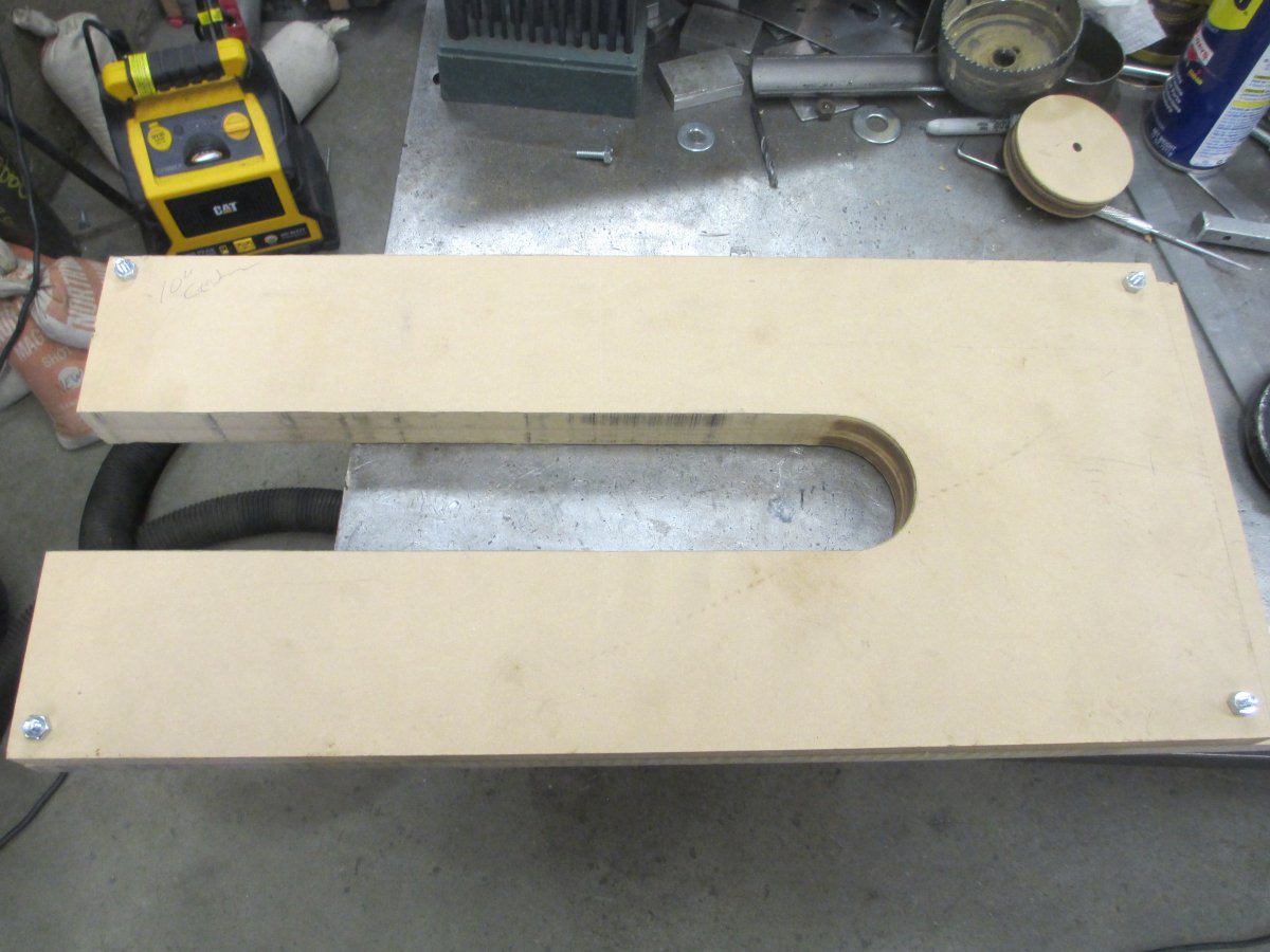

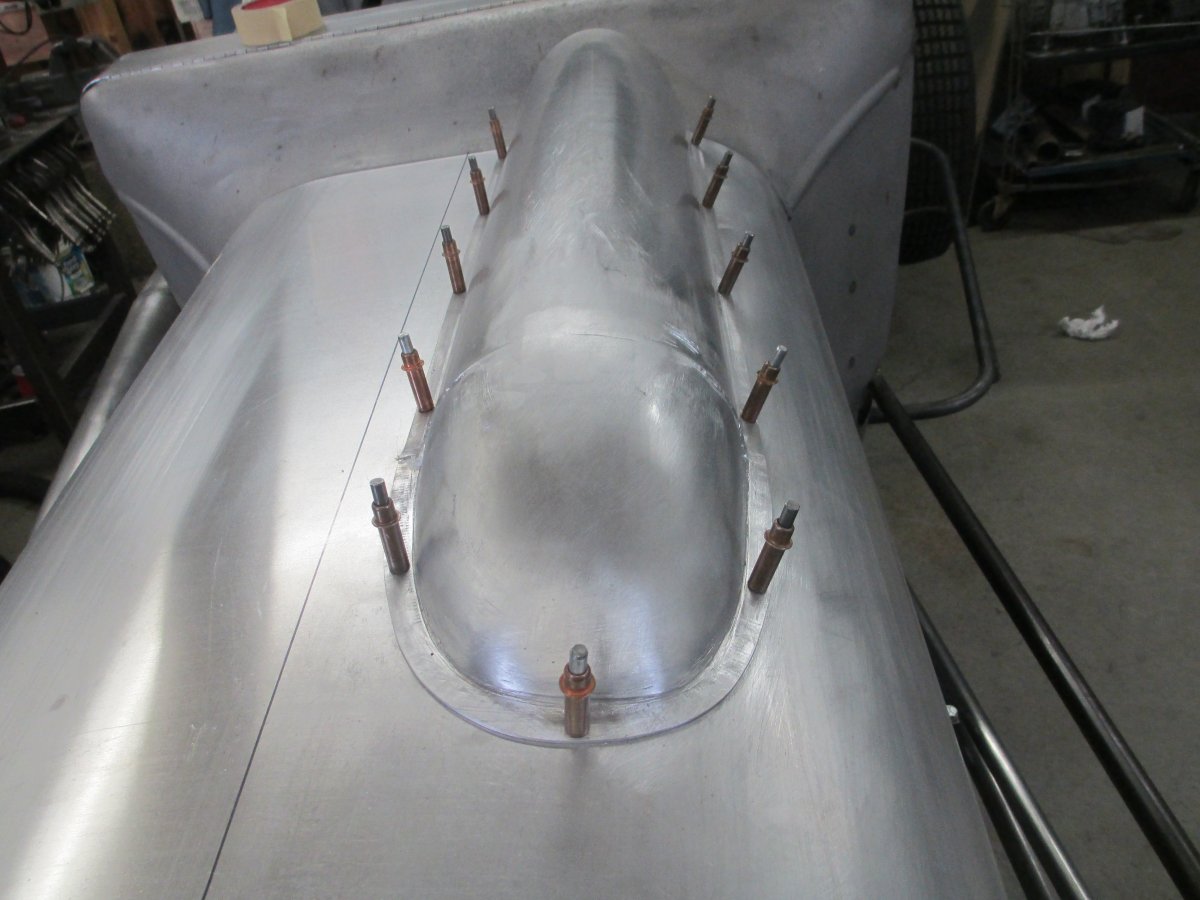

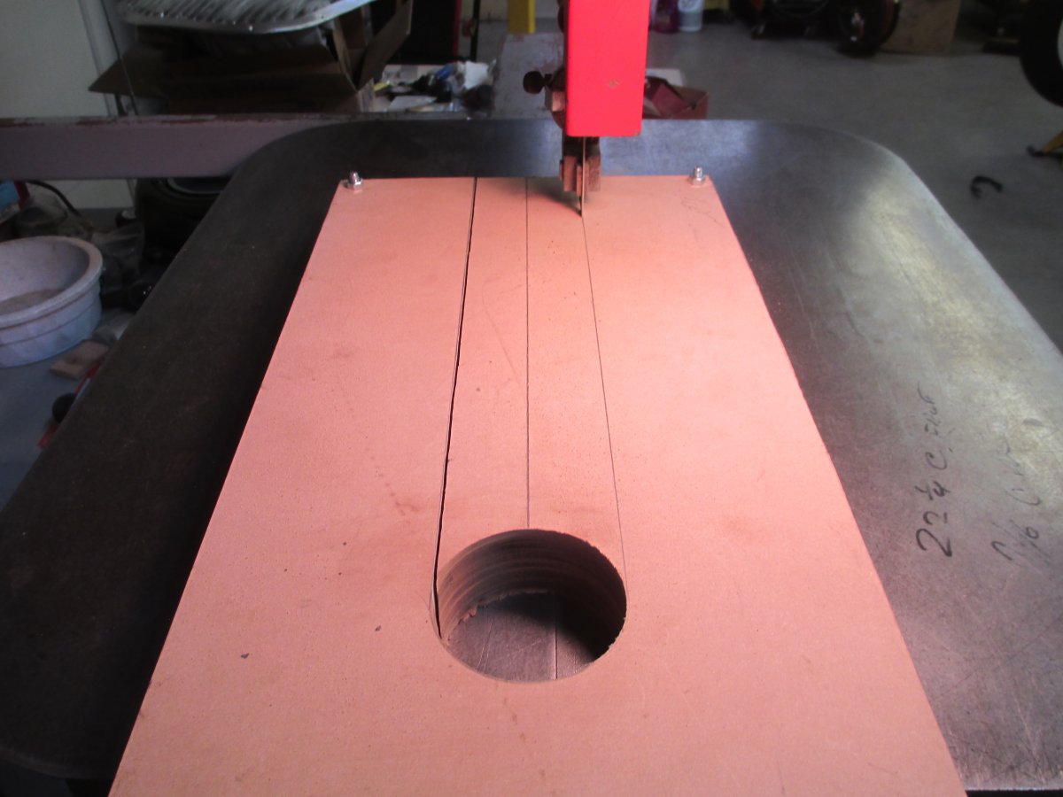

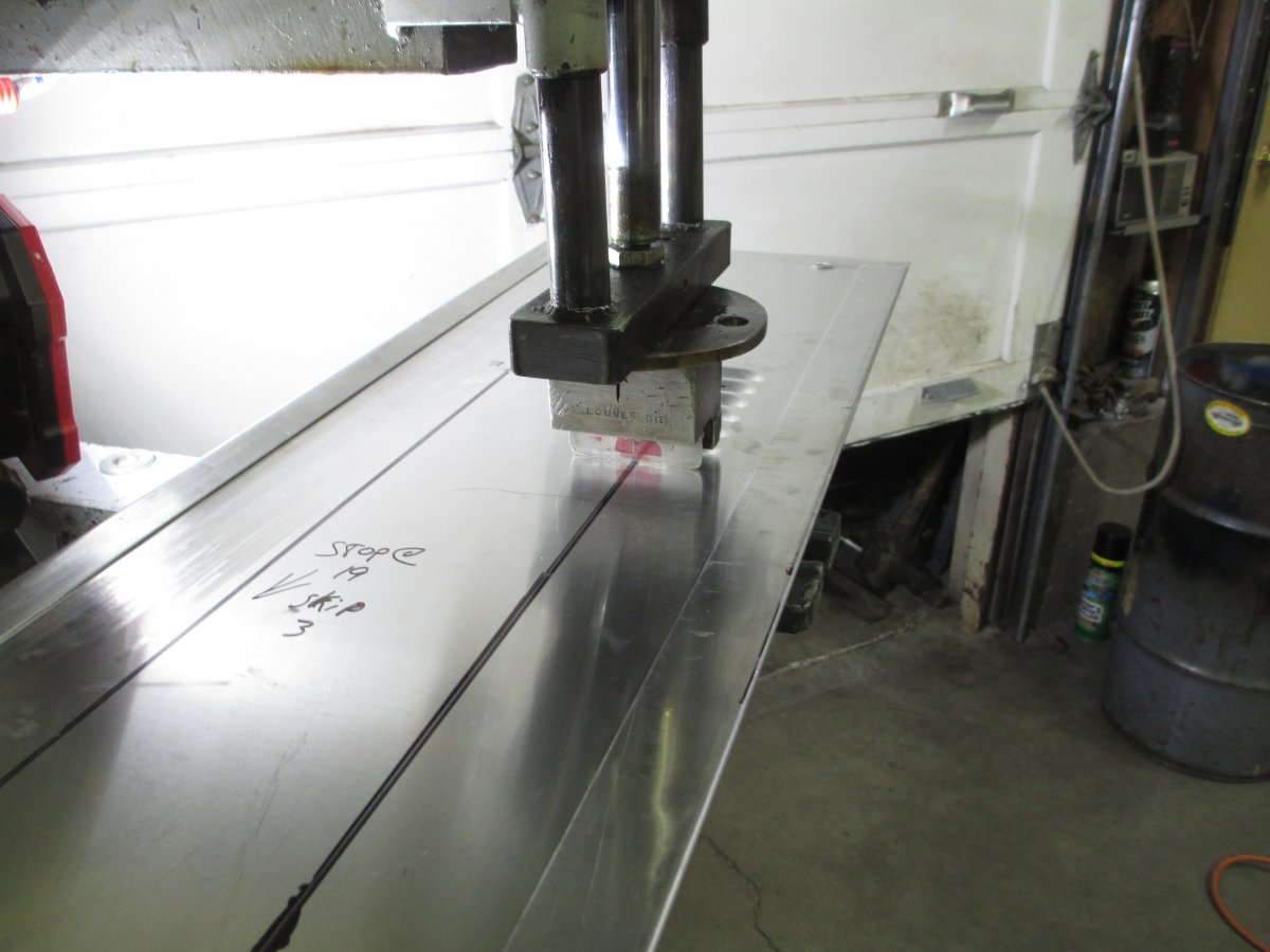

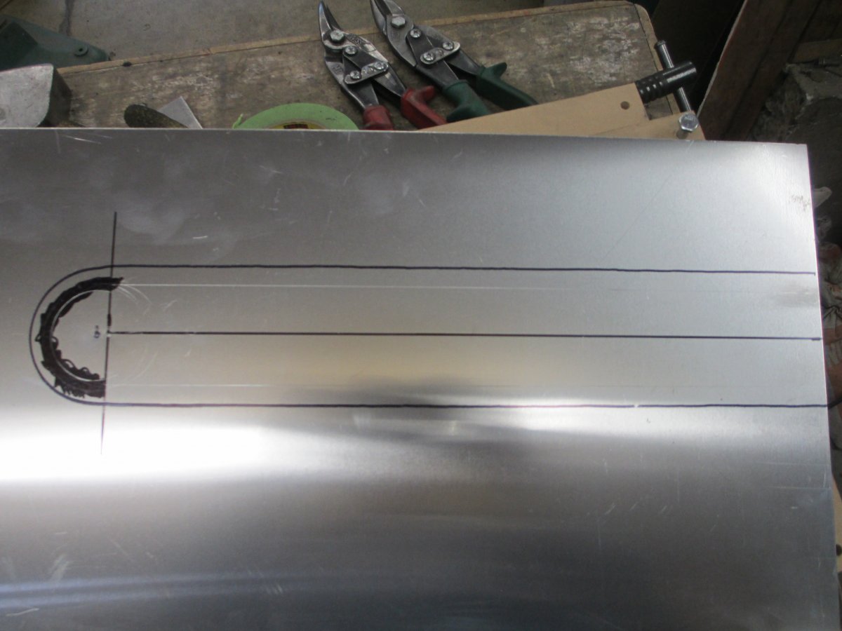

    Hood side number two completed yesterday. The flanges of the tapered pan get some stretch treatment in the kick Erco to match the profile of the hood side..
    For the questions about the cutting device, it is a long nose pneumatic cut off tool from Blue Point. For keeping the cut nice and perpendicular, and disc width, the long nose works better (for me anyhow) by having the long nose as a visual guide to keep it parallel to our centerline. I don't think I would have seen as good of results using the standard cut off tool.
    Each slot has stop drill holes at the end, to help remove any cracking issue and also to better determine end of cut.
    E helped out with the punching efforts...…
    Panel gets tacked in and welded with the TIG...

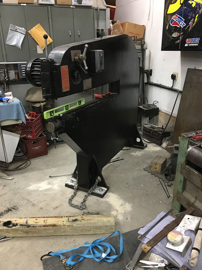

    Well after about 12 years, the Lennox TE150 is leaving the building. When we did the 35 Chevy louvers for Cody Walls, it hinted then of it's limitations. Simply put, not enough throat capacity with some of the automotive panels.
    I bought this from Northwest Airlines and picked it up from their then recently closed DC-9 maintenance facility at the Hartsfield Atlanta airport. They had shut down the operation and moved maintenance overseas. This and a 100 ton drop press was the last that remained in an otherwise vacant building.
    I've found another metalshaper that has a larger machine, but doesn't really use it for the capacity. So after negotiating the terms, he will be using this for the (mainly) motorcycle fabrications, where I will have more capacity for larger automotive panels.
    Like a kid in the candy store.....
    Okie Pete, 1952B3b23, brEad and 7 others like this.
  27. MP&C
    Joined: Jan 11, 2008
    Posts: 2,574
    MP&C
    Good thing I got a tilt bed trailer last year, it came in handy.. As well as borrowing some piano moving jacks..
    With rain in the forecast for Friday, we loaded up the TE150 Thursday night and left it inside. All ready for the 2+ hour drive to it's new home on Saturday..
    With our "trade-in" situated next to the newsed machine, you get a hint to the comparison in size. What you don't see is what is used on the inside. The TE150 uses 1/2" thick steel plate on the sides, the TE250 uses 1-1/4" thick steel plate. Quite a difference, and easily noticed when moving..
    Winch helps with the uphill movement..
