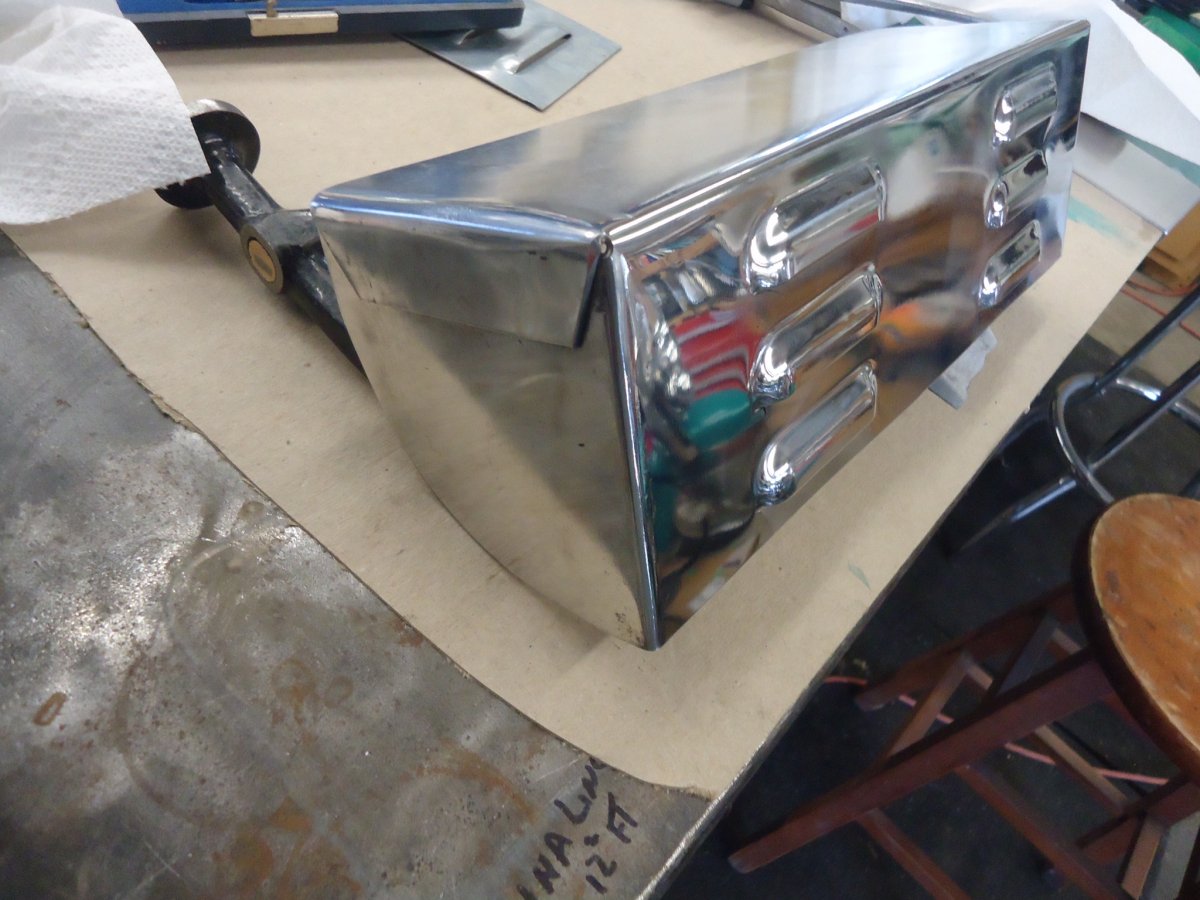

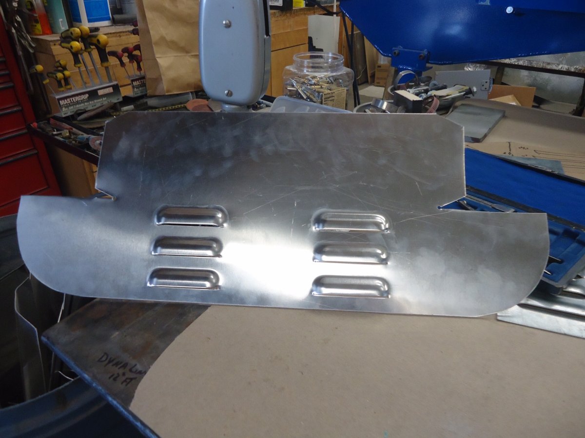

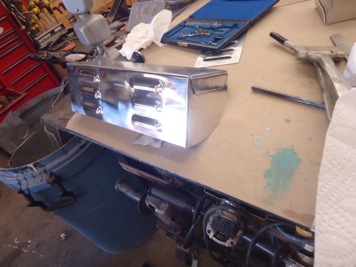

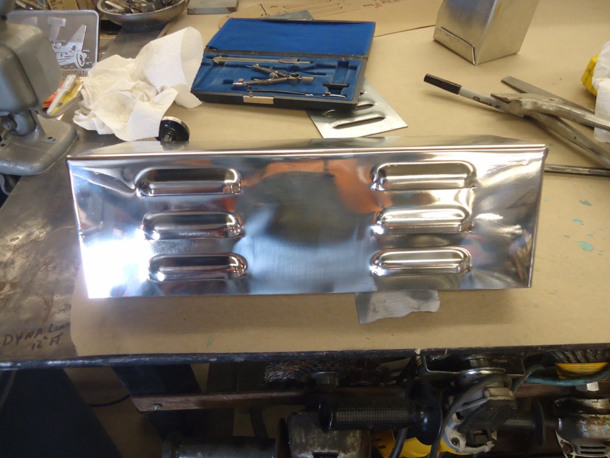

    More practice with the hand formed louvers, these were rotated 15 degrees.

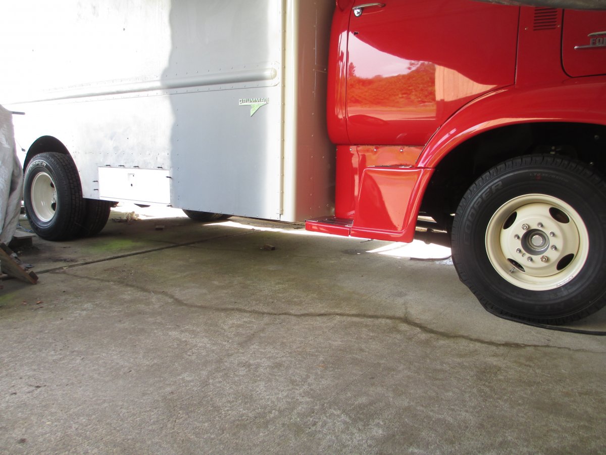

    John stopped by the shop last night so we could fit up the running board skirts on the Biederman.
    I know he will be glad to close off this gaping hole.
    After taking some measurements we got the top flange folded over using the magnetic brake. The flange will be bolted to the underside of the cab to support the weight as we will leave about a 1/4" or so gap above the running board to allow for frame flex.
    Rivet Nuts installed under the cab...
    The rubber edge trim is our attempt to keep the paint from rubbing off, and these are held in place using weatherstrip adhesive.
    The dump bed had been painted over when John bought it, but closer inspection showed where some additional layers of paint in the hand painted lettering, "Phone 60" had staved off surface rust in it's previous life and was still visible...

  12. That’s got to be THEE nicest dump truck paint job I’ve ever seen

    Make that one of the nicest trucks I have ever seen. Beautiful, thorough work, all the way !

    I like your method of letting the filler panel "float" on the running board taking into consideration that there
    is probably a small bit of movement between the running board, cab and fender where positive attachment could lead to stress cracking.

    Probably more than a small amount of movement. This lucky truck probably won't be put back to work again, but when an end dump is on the job, everything is in motion.
    Very nice job on the whole truck.

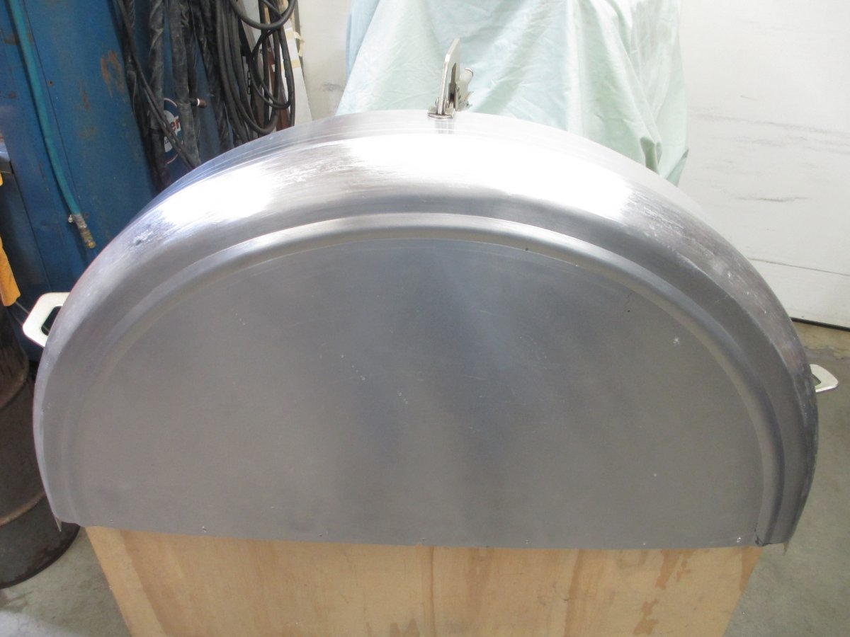

    I got the back end closed up. I should have taken more pics of the parts before I welded and ground the corners. I used my small tank die in the bead roller, and rolled a 1/2" bead, before cutting the center out. The low side of the center needs to be open for the parachute hook ups, and access for a floor jack. I may cut and bell some holes in the larger flat areas to let trapped air out. IMG_2895.JPG IMG_2900.JPG IMG_2902.JPG IMG_2903.JPG IMG_2908.JPG

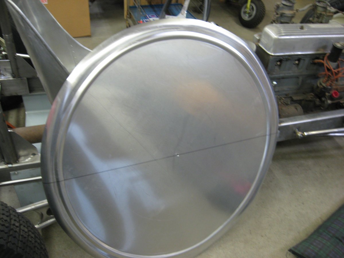

    The nose isn't finished yet, I am working my way forward completing the center of the belly pan, then the nose, and the canopy last. IMG_2913.JPG IMG_2912.JPG IMG_2914.JPG

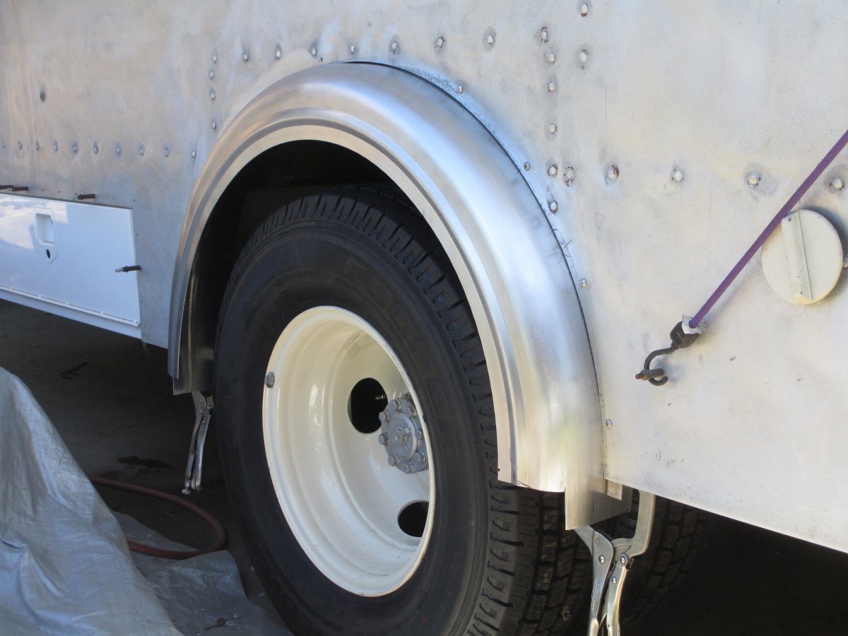

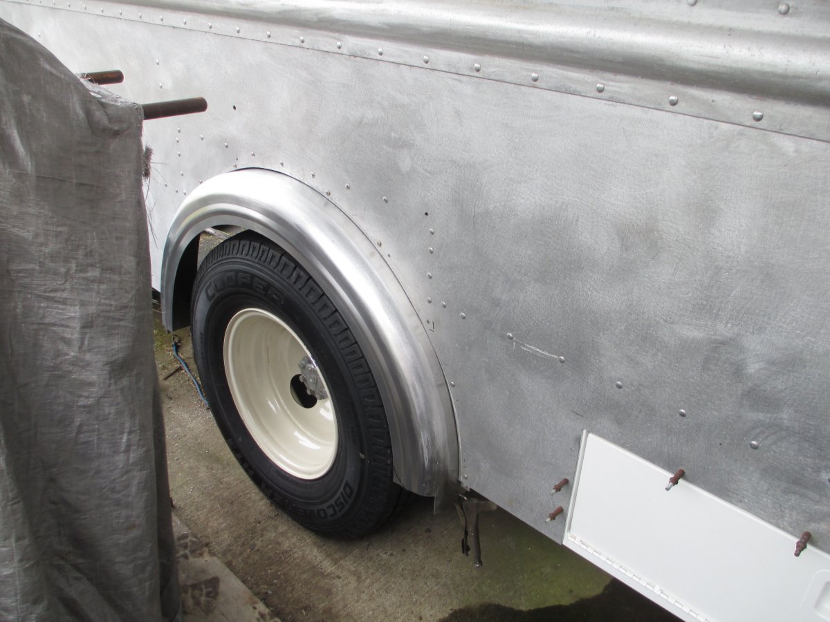

    Some time back I showed some fender extensions that I built for my truck, that started out looking like a large pizza pan. This weekend I got them on the truck, now they need a final trim, and complete the mounting. IMG_7657.JPG IMG_2989.JPG IMG_2987.JPG IMG_3006.JPG IMG_2975.JPG
