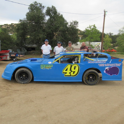

    Damned fine work on that tail, sir.
    Slick as hell.
    Us oval guys gotta make 'em flat like that, so we can "walk 'em straight" again after the on-track alterations. ;)
