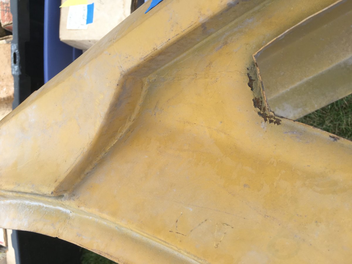

    I love watching people make up panels. It is majical to me, and hoping one day I can do something similar. Took these pics at Hershey this week. I believe they are original NOS panels for mid 60's Ferraris.
    Okie Pete and lothiandon1940 like this.

  27. SinisterSleds
    Joined: May 6, 2012
    Posts: 92
    SinisterSleds
    from MA
    Daytona (yellow) and Dino 246
    Sent from my SM-G950U using Tapatalk
    Okie Pete and loudbang like this.

    Thanks for the up close detail pics.
