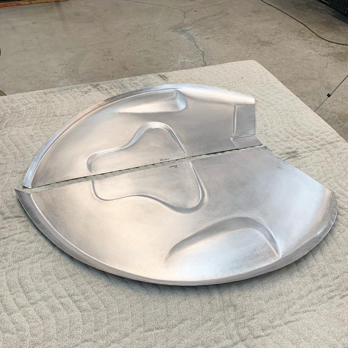

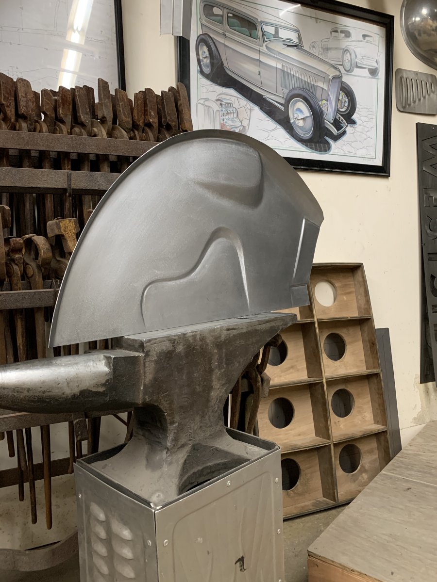

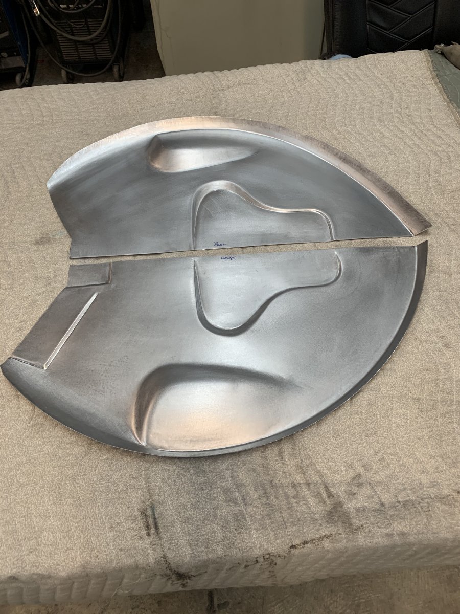

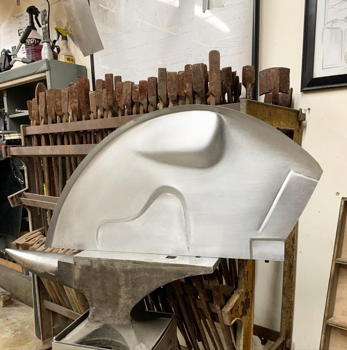

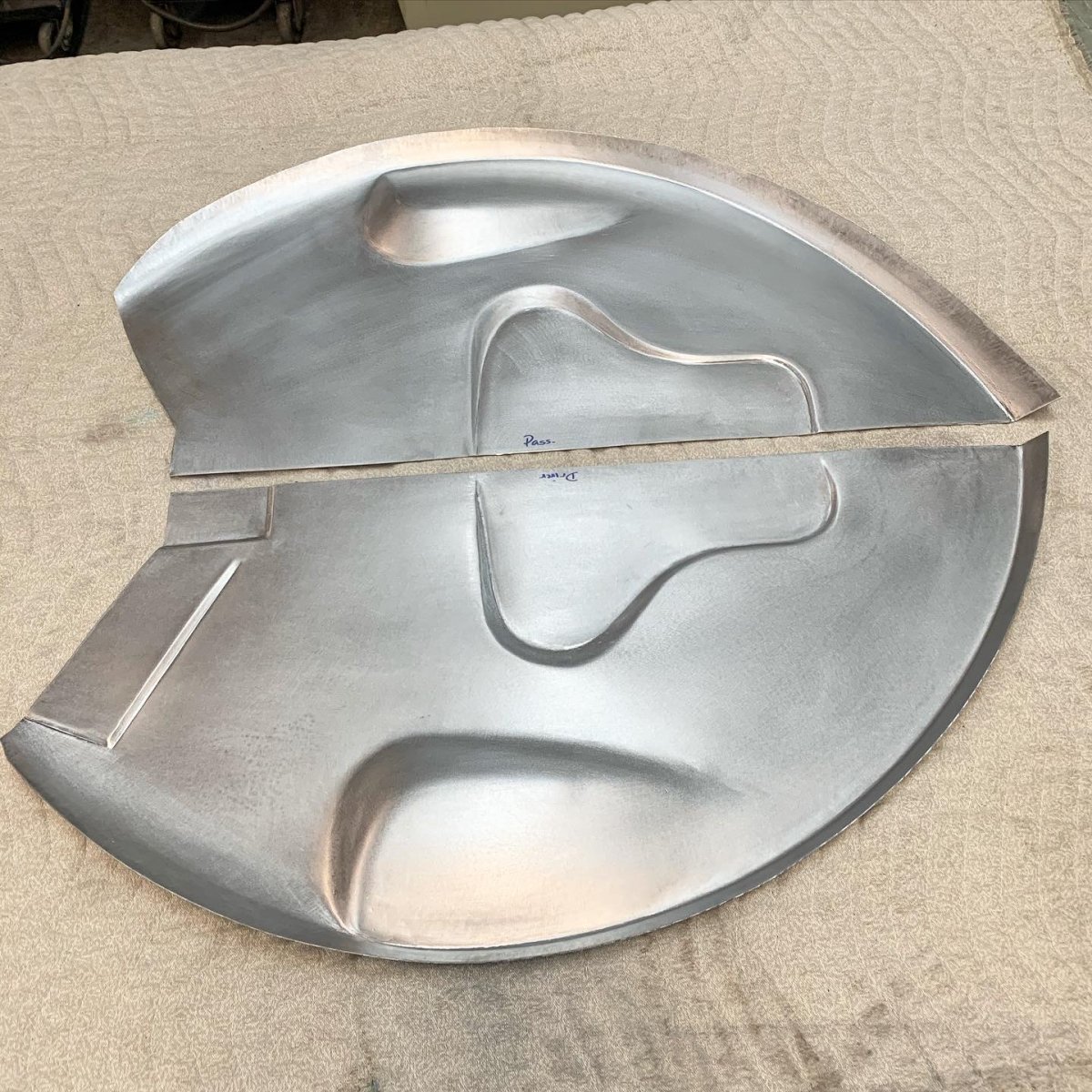

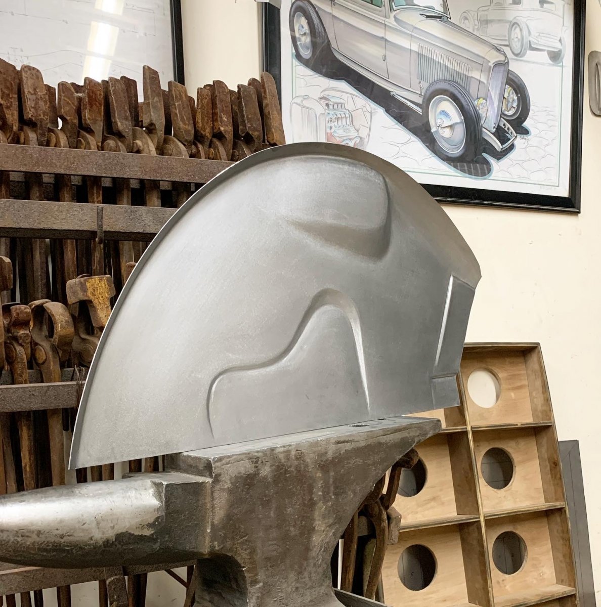

    here is some stuff i have been working lately
    more parts on the aluminum roadster project
    hammering out some welds on the big hammer
    made a set of inner wheel tubs for a buddies 50s chevy truck
    also beat this out by hand for a demo panel and to hang in my booth at events

    Exceptional work.
    I particularly like the way that your pictures of the inner fender wells progress from "bag of hammered ***holes" directly to "finished perfection" with no steps in between. lol
    Like sheetmetal magic, it is.

    the only steps that are not pictured is planishing out and then turning the edges. hard to get in progress pics of that stuff since i am in the shop alone a lot of the time

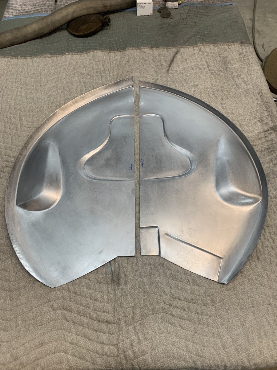

    Made some model a sedan inner wheel wells the other day. Working on the rest of the quarters in the next few weeks 24CA02A8-D01E-4983-BCF6-171BC3995564.jpeg 764D2AF4-2CB3-4D77-BBE0-83B6DC1B0928.jpeg 125A2D2F-C743-444B-935F-73C545372020.jpeg

    Did you use any form to hammer over?
    JOYFLEA and loudbang like this.
  18. cornfieldcustoms
    Joined: Feb 2, 2008
    Posts: 1,064
    cornfieldcustoms
    No, just hammered into a lead bag and cleaned up with the planishing hammer

    You say you hammered the deep draw pockets into a shot bag and planished on the full size blank? Seems like it would thin drastically and split at that depth.
