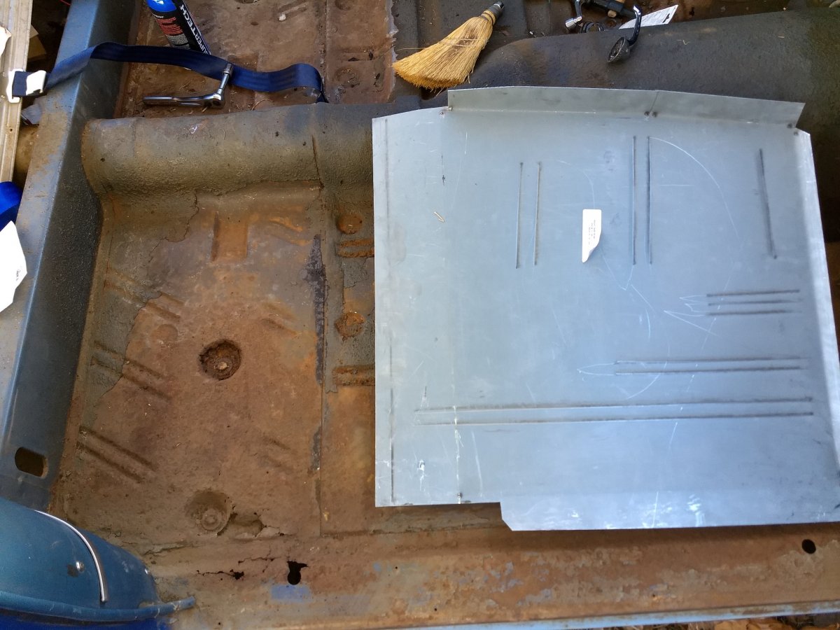

    Some advise please! I bought these floor pans for my 55 dodge, but they are nothing like what is needed. so I'm making my own. The recess area to bolt body to frame, is what is giving me problems. I have the recess started, but I need to go another 1/2". I'm have the problem of it warping. I'm using a home built press, so I press it and than take it and hammer and dolly it. Is this the way it should be done?

    The sides of that recess are going to need considerable stretch. By using a small blocking hammer while in the flat, you can add some stretch before putting it in the press. What are you using for dies, pipe?

    I'm using slide off an old dent puller, and a thick piece of wood. bolt them together with the metal between. and tighten. I pre-stretched it with my English wheel, before i started, but I didn't do enough.

    So I should stretch it with a Hammer and a sand bag, than use my press. I pre-stretched the areas where I put the beads in and that worked, but this recessed area is a lot deeper. Thanks

    I've used home-made dies, heat, and a BFDBH to do some fairly deep draw:
    I think your area in need of stretch is too localized to use the English wheel, and you need to resort to a blocking hammer.. For "pressing", instead of a bolting action, I'd either try using the force of the slide hammer by making it's slide rod an alignment into the wood, or use two pieces of thick wall pipe appropriately sized, and placed in a press, or other implement of brut force. If you choose to use the pipe, don't forget to radius the pressing edges, they will cut...

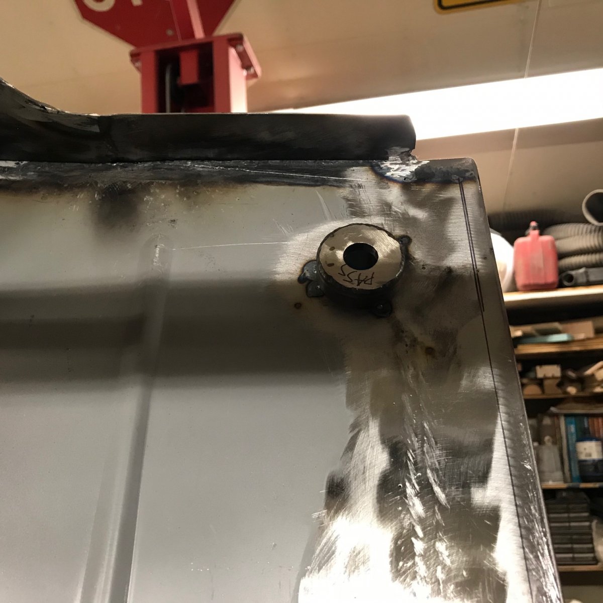

    Time to get the hood brace end welded in place. The overall measurement had been taken prior to cutting off the old one, down to the 14 gauge outer plate as a reference. So the new end is trimmed to match this dimension, then held in place with rare earth magnets. The center (inside) rib is aligned and tacked using the TIG....
    Working outward, the panel surfaces are aligned and tacked as we go. Note the "batwings" left on the outside of the new brace end (yellow arrows). This will act as a heat sink when we make the outer tacks. Had these been trimmed to match prior to welding, the edge will have a tendency to burn back from the heat.
    The entire seam is TIG welded and then our batwings are trimmed using offset snips, then welds dressed..
