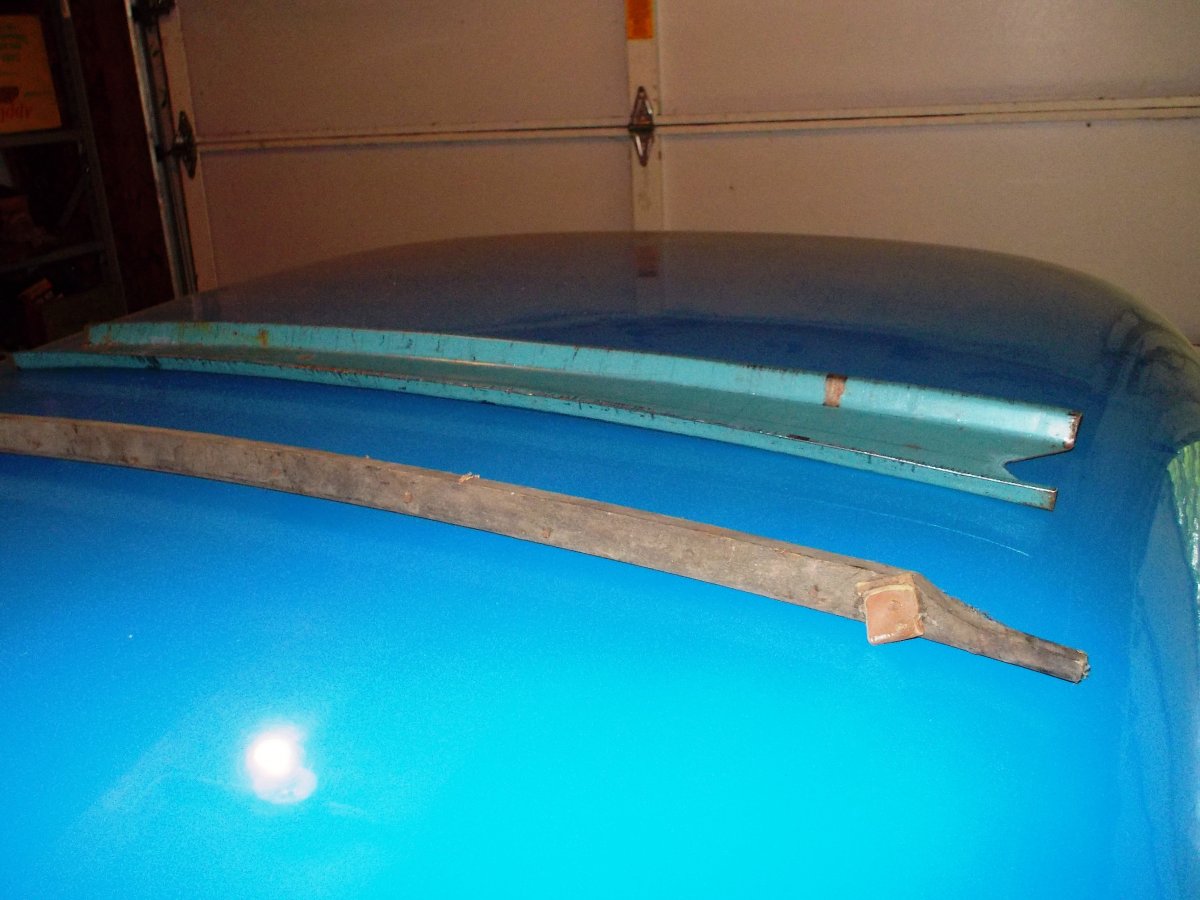

    I was fortunate to acquire a set of sweeps at an auction. These were once used by auto companies in their drafting rooms to lay out body lines on full size drawings. (Fun Fact: There are very few "flat" surfaces in an auto design. Virtually all panels have a crown to them.) Now all the companies use CAD technology so these are "obsolete" in the auto design business and as such sometimes come up for sale at auctions and on line. They are sometimes referred to as "mold sweeps". Mine are stamped with the radius in inches. I just want to give everyone a "heads up" that they exist and are useful for car building.
    I used one to replace the wooden roof support in an Anglia with a metal one.
