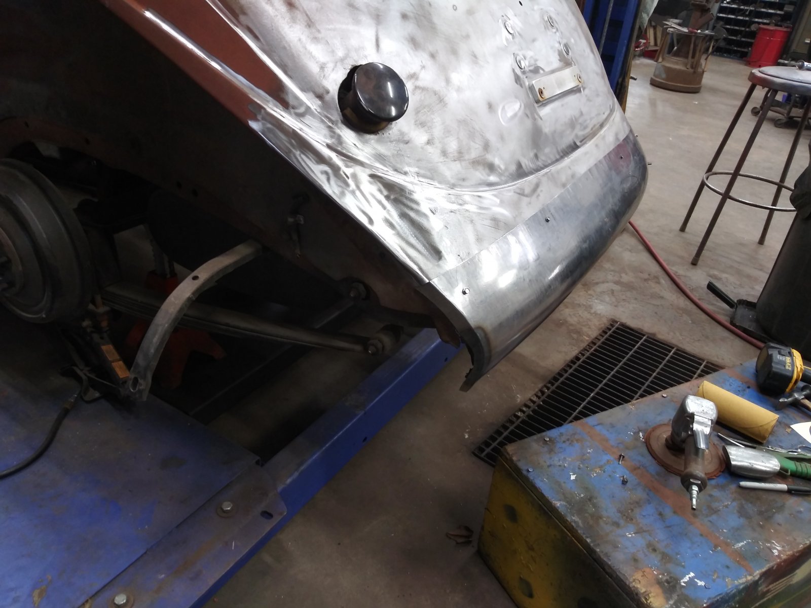

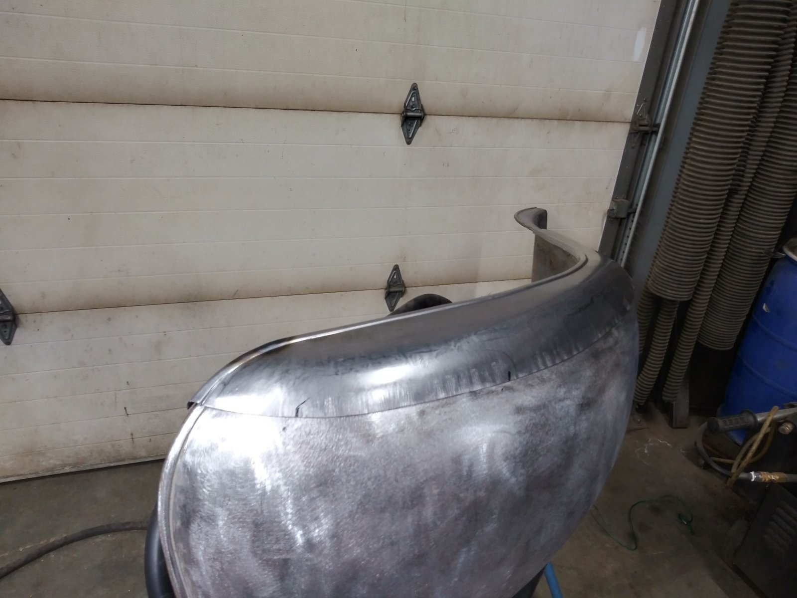

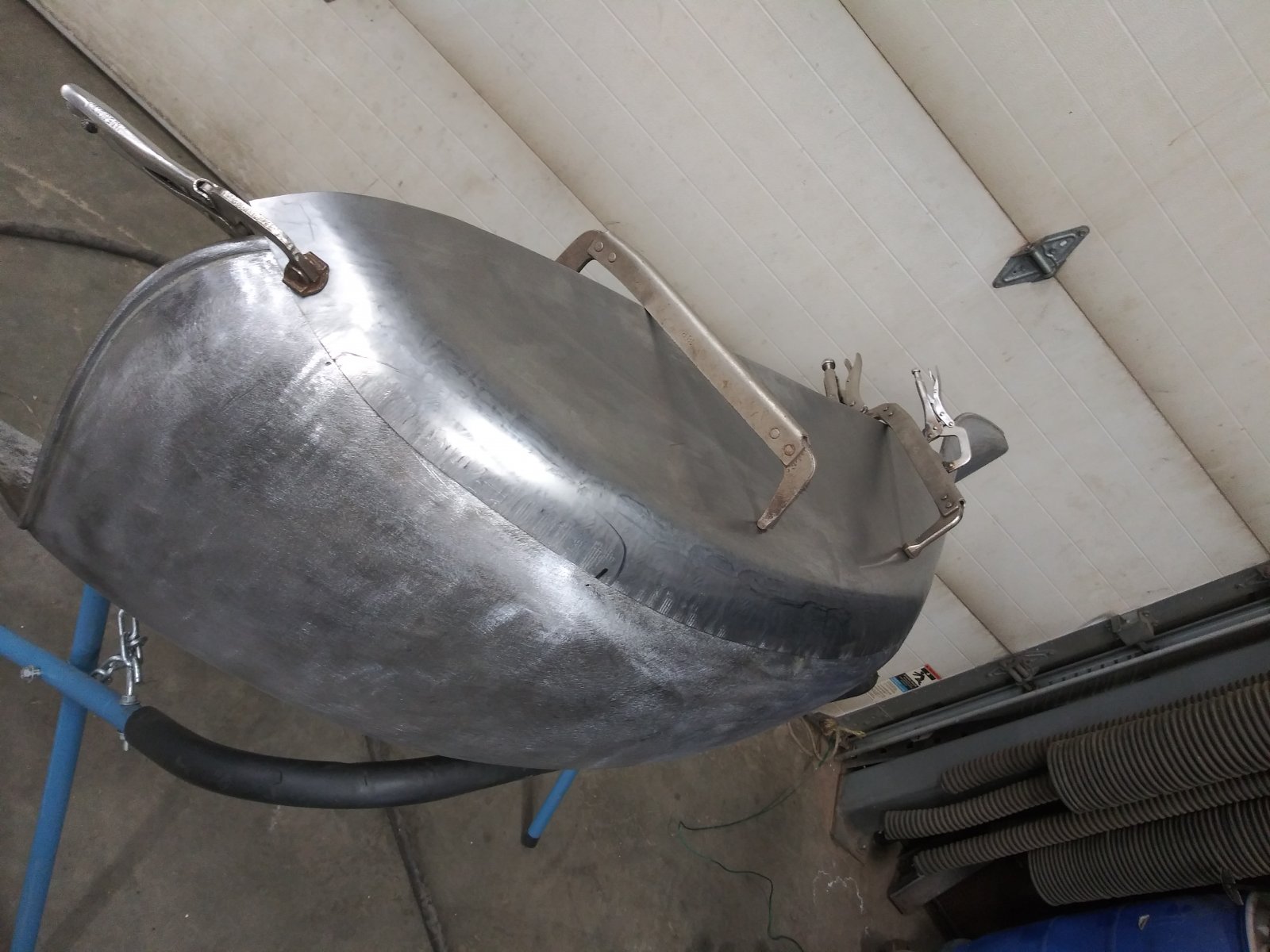

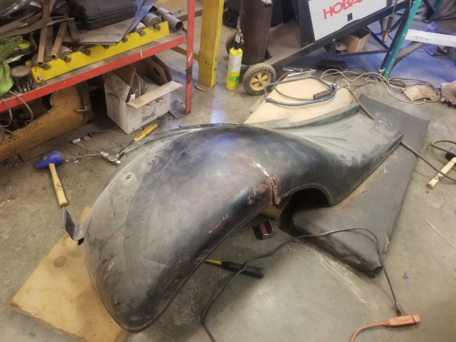

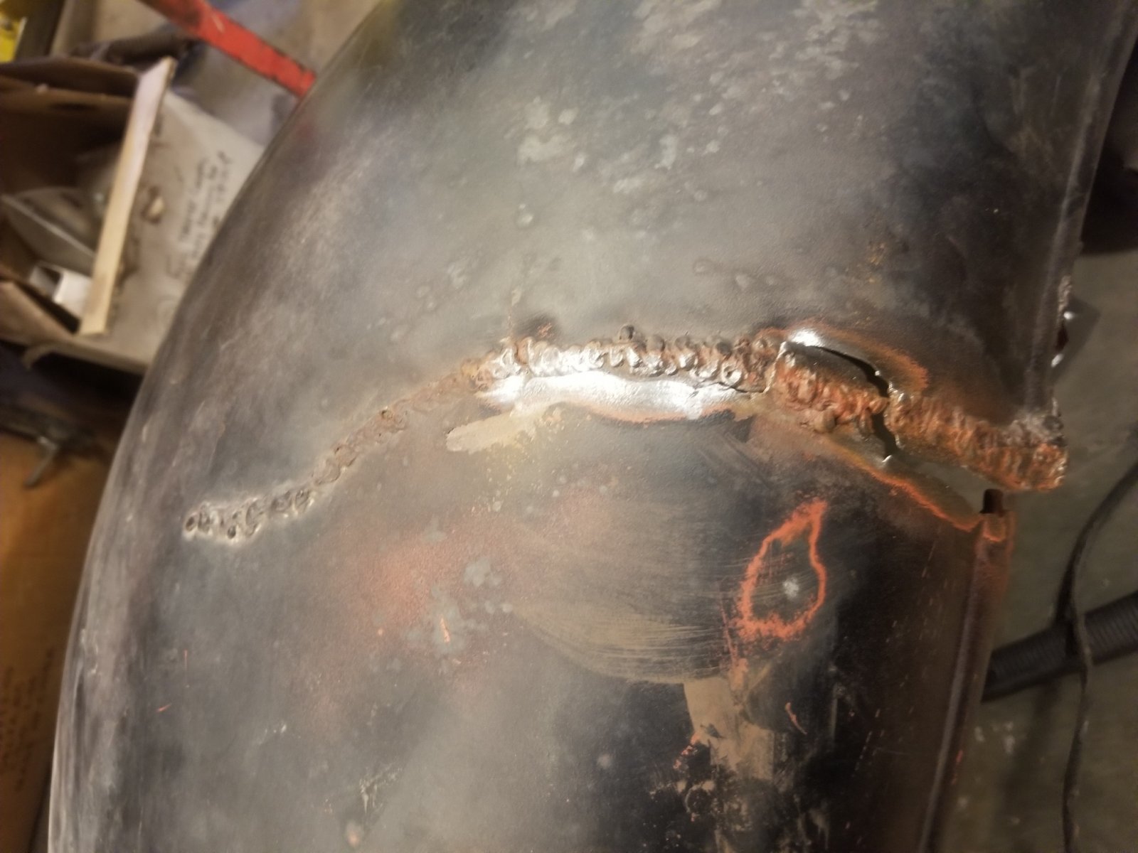

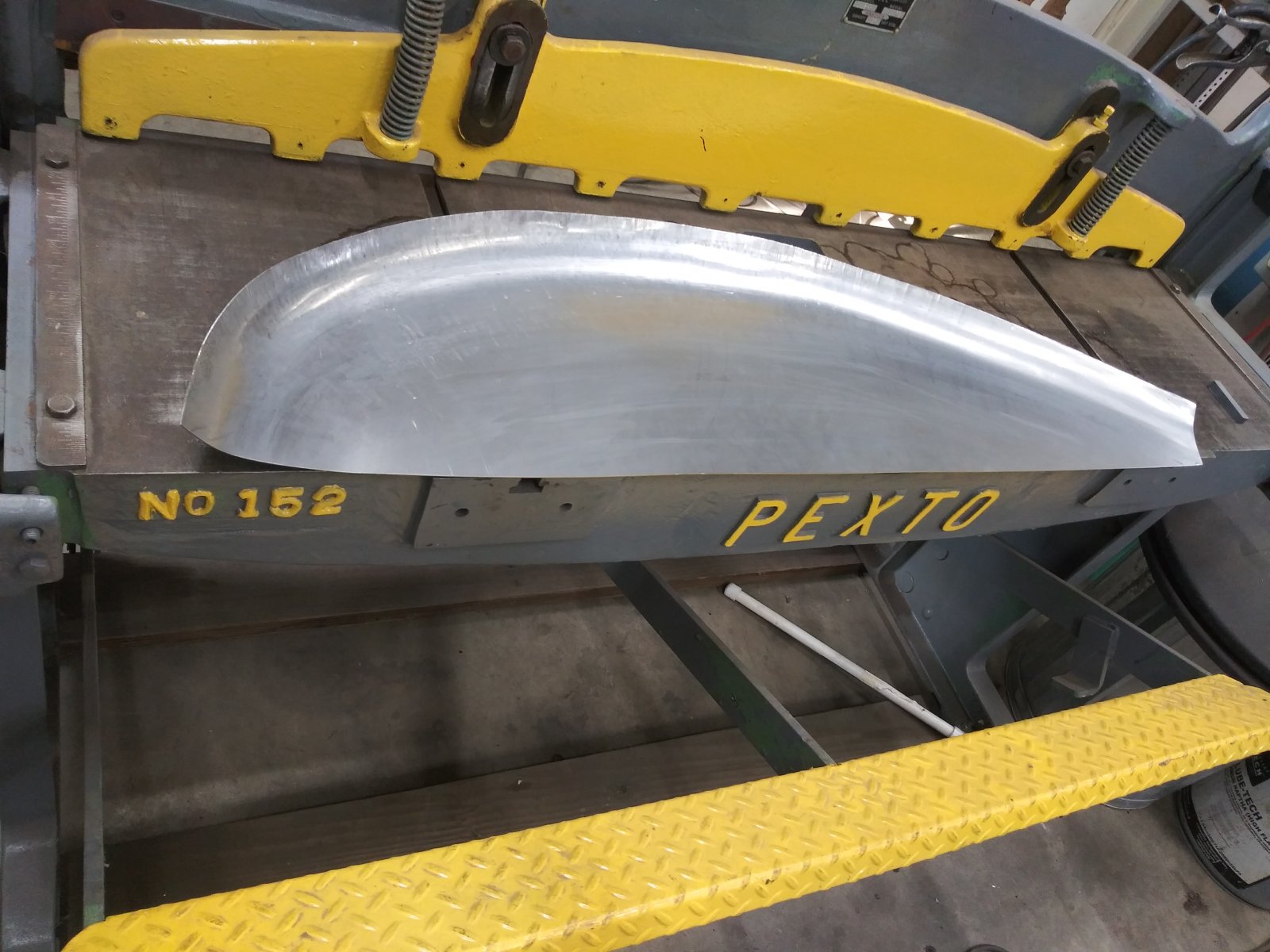

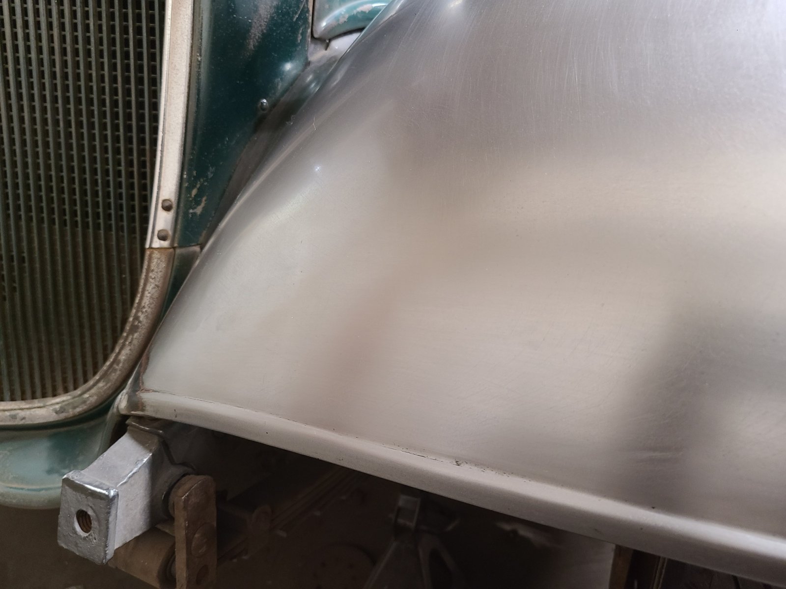

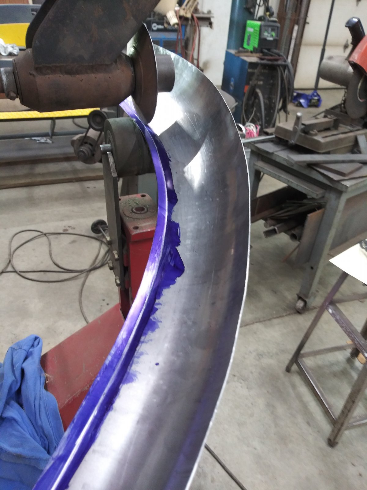

    Another 32 front fender bead patch. The owner plans on welding it in.
    I first make the radius leading up to the bead.
    Mark and trim allowing for the part that wraps around the wire.
    The dies I made to make the bead guide off of the flange.

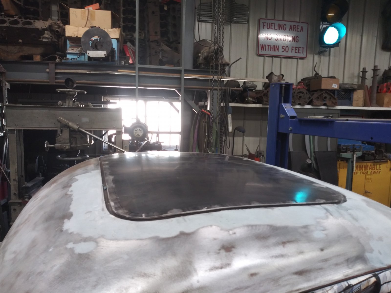

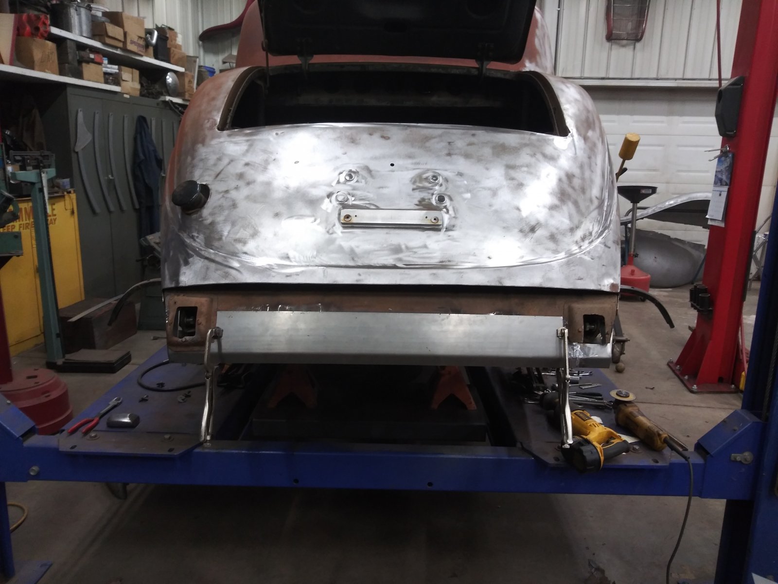

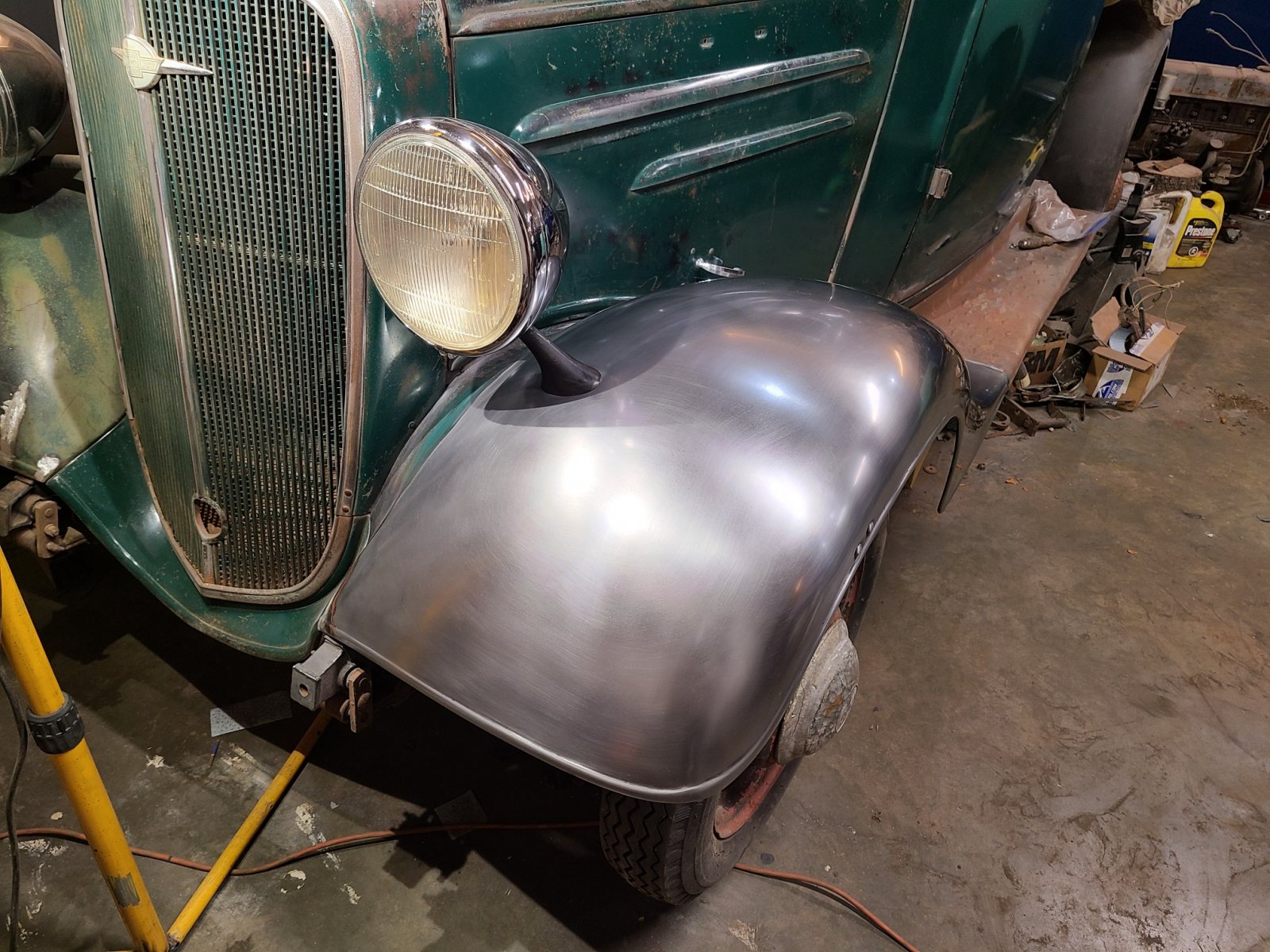

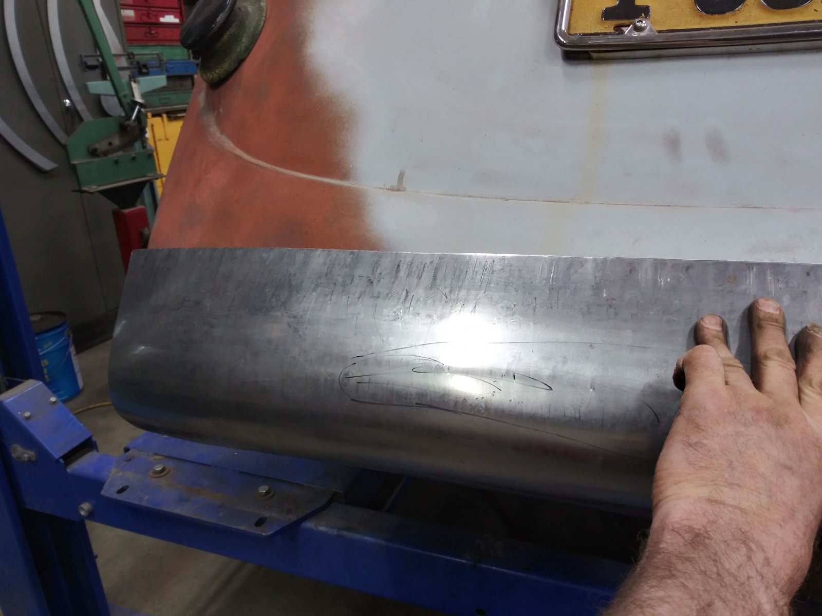

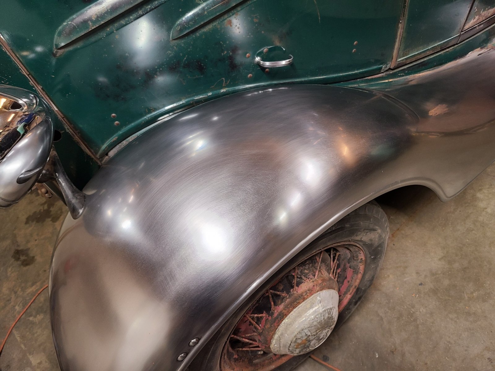

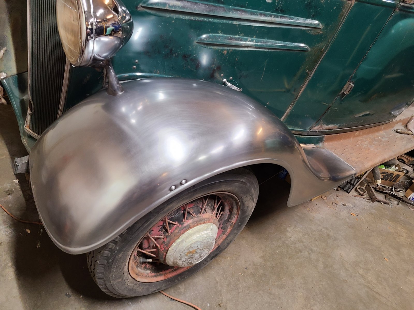

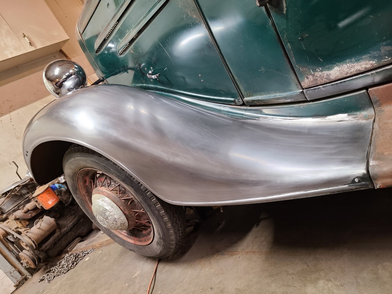

    My father-in-law's 35 plymouth panel below the trunk.
    Bad before picture.
    Started by shrinking with thumbnail dies and wheeled out the shape.
    Tuned it up with the shrinker/stretcher.
    Tipped the edges. I had to heat shrink the flange.
    20220117_124915_HDR.jpg this is the inner panel. I have some blasting to do before it goes back together.
    rod1, Okie Pete, 36 ROKIT and 8 others like this.

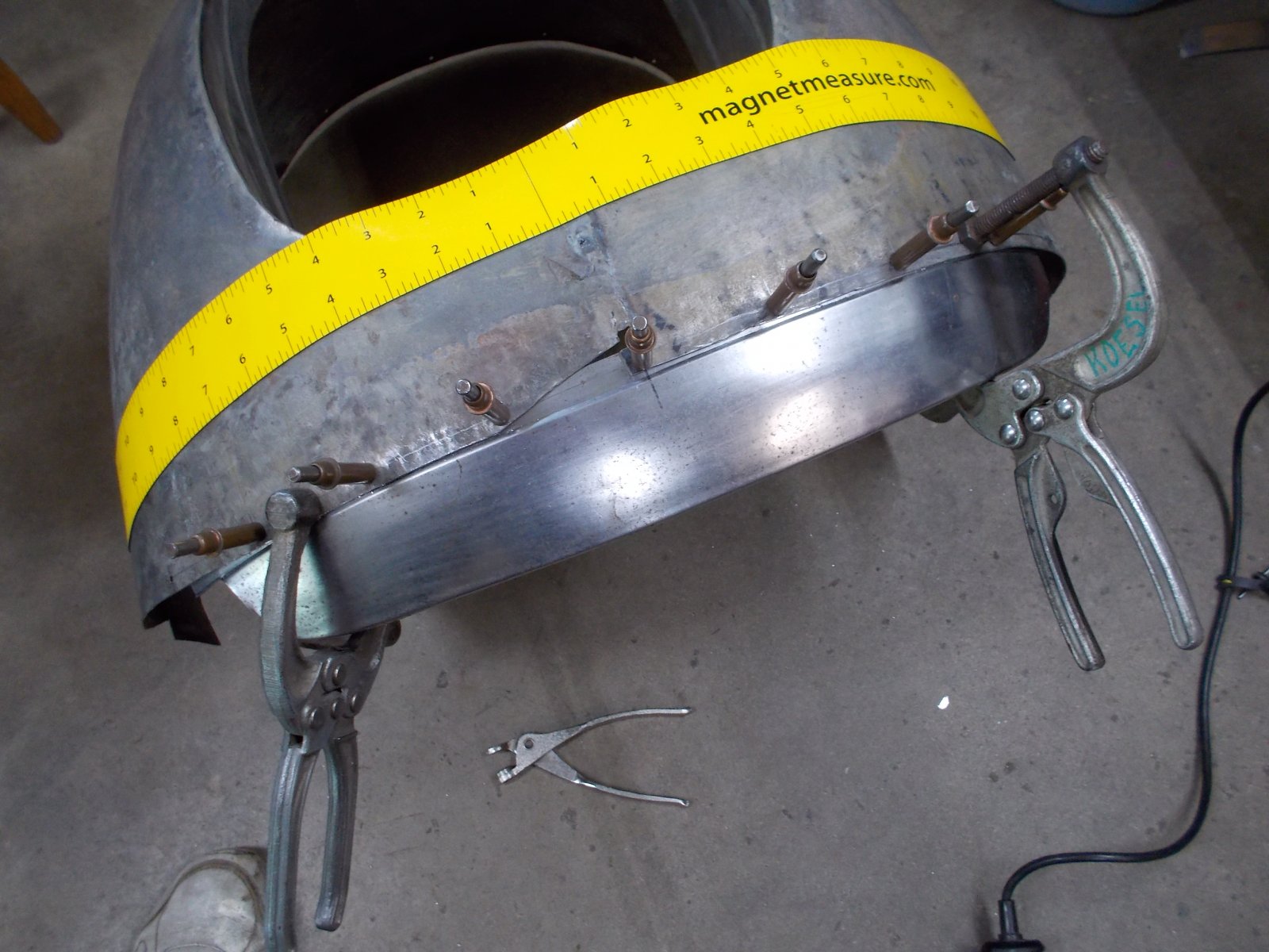

    Here's another useful one.
    magnetic

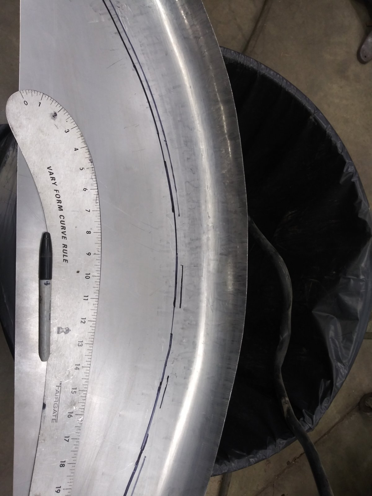

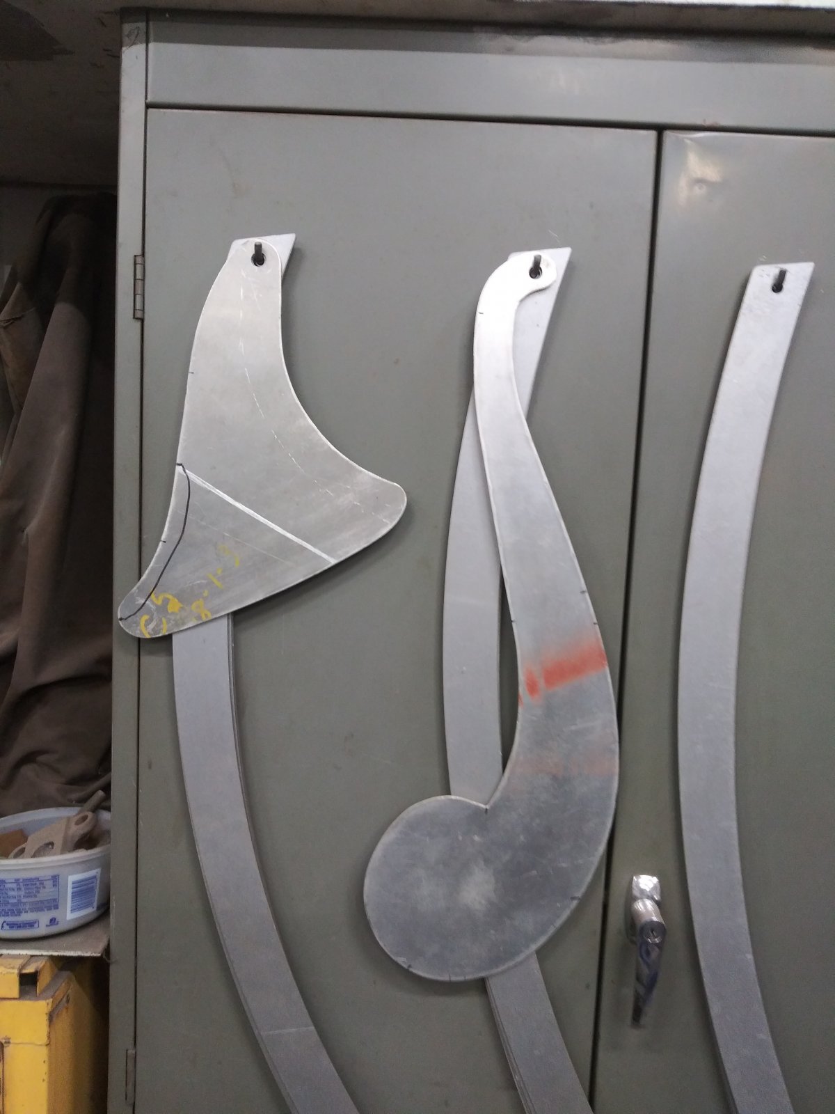

    French curves are another great source of shapes. I have an overhead projector 20220118_101913.jpg I use to make larger sizes like these.

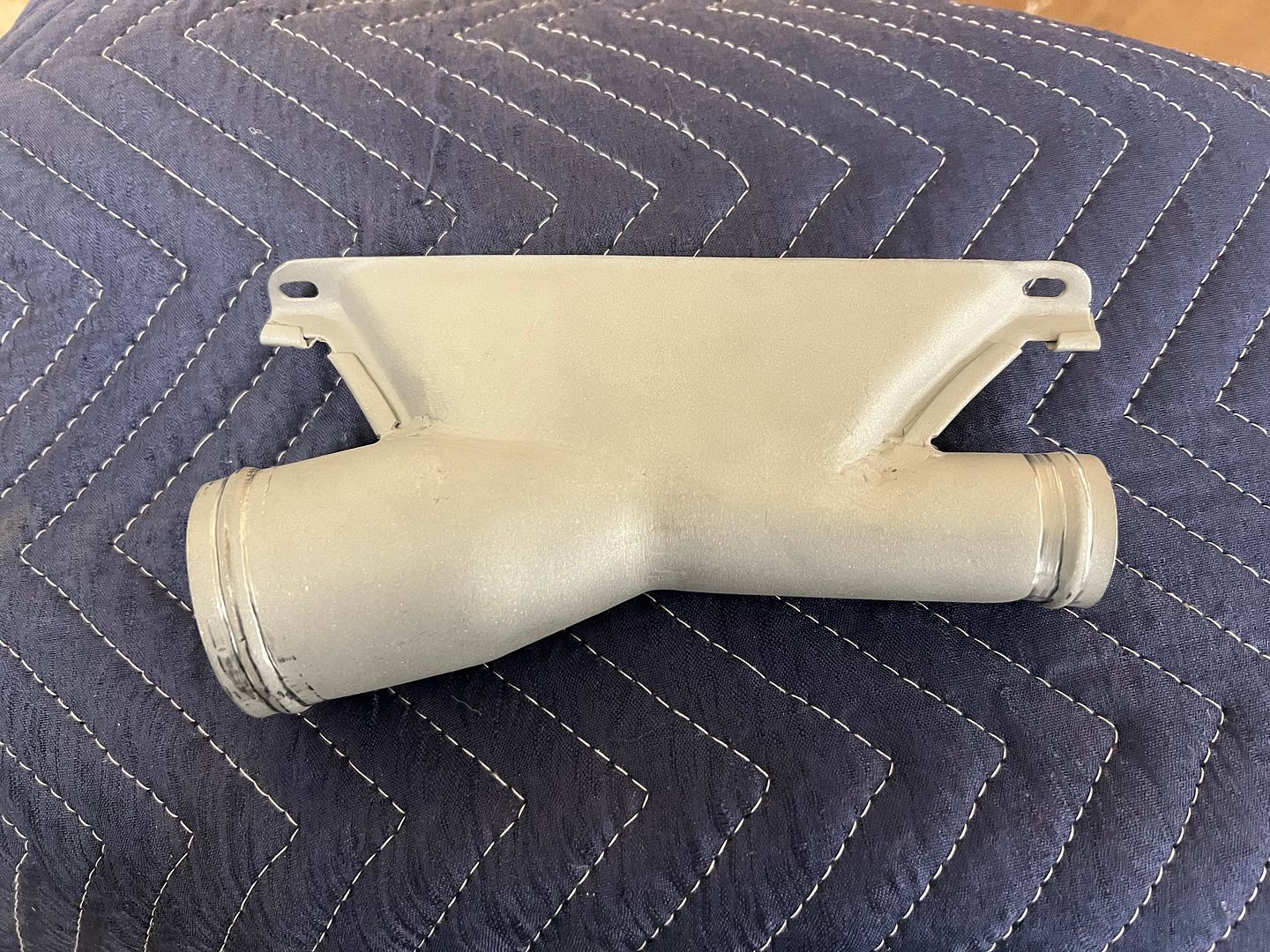

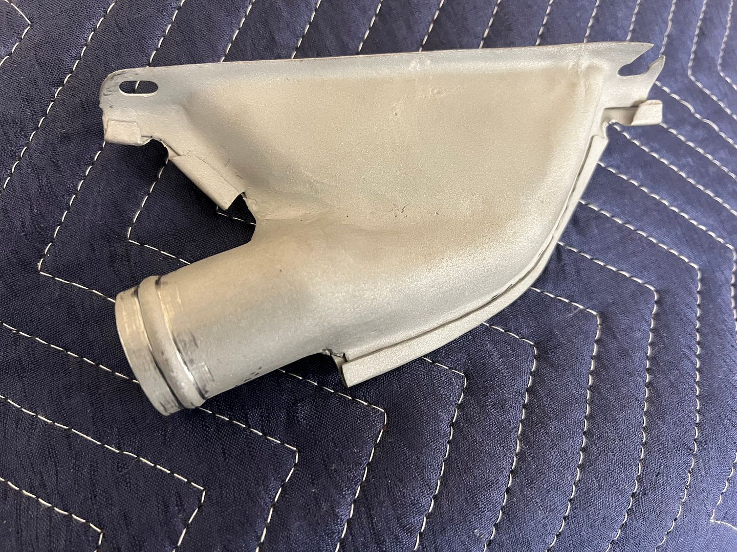

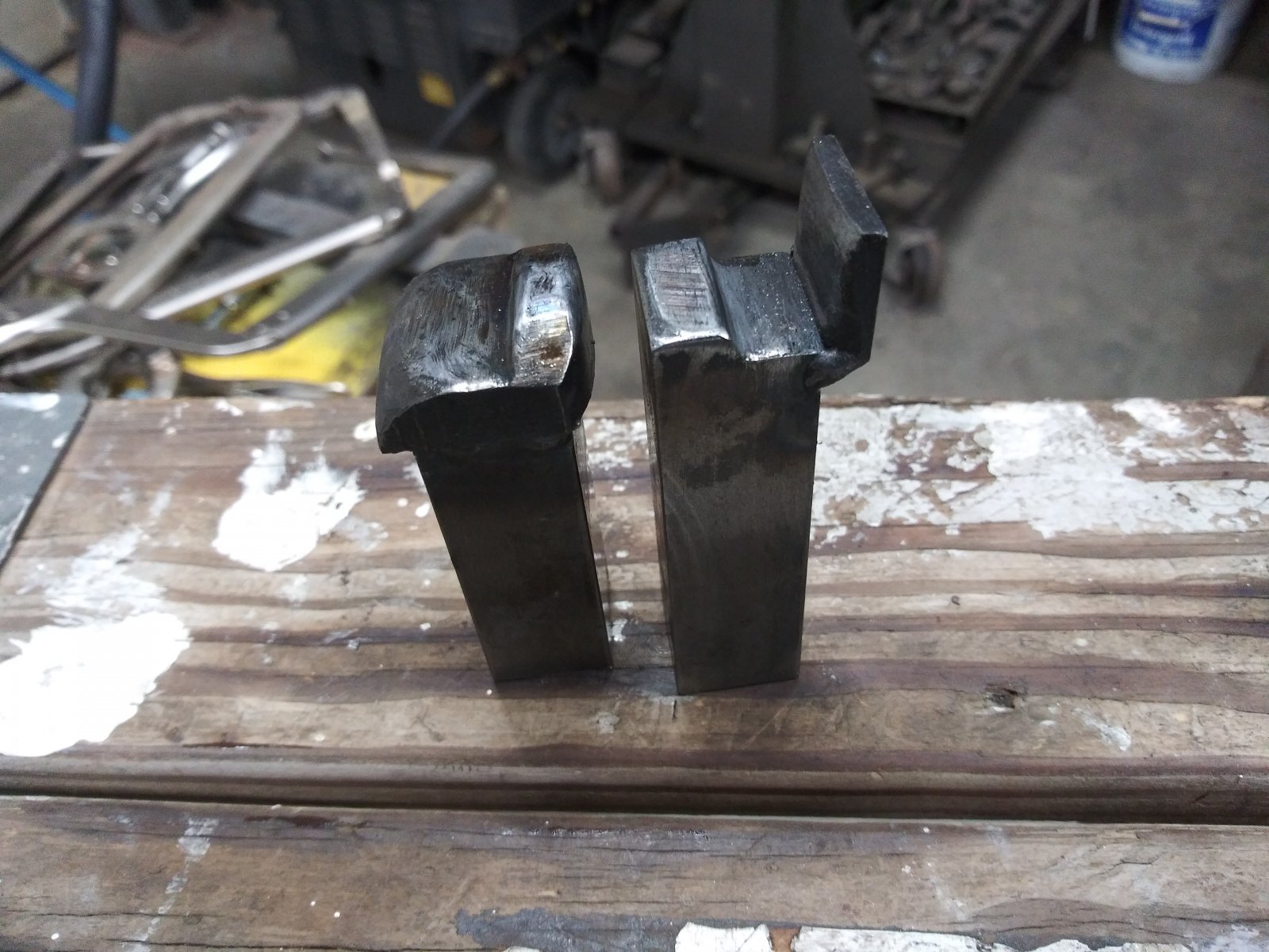

    We are presently adapting defroster vents to make use of heater hose (to fit VA heater box), we needed to add a bead in the tubing to better retain the hose attached. The beading die we made for this purpose on the bead roller was too large to fit the 1-1/4" tube, so another tool is in order.. Our worn out Southbend was used to make the round profiles, with a step in the bottom die to act as a backstop for better consistency in bead placement.

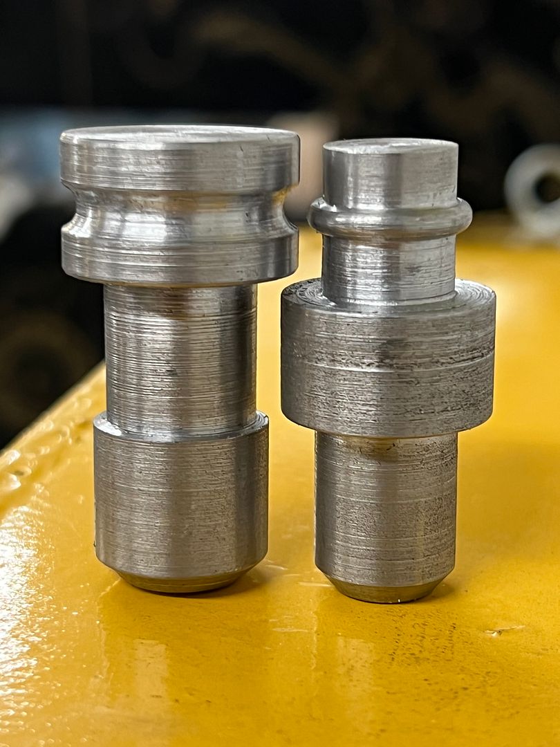

    I don't have much in the form of hardened tool steel for making specialized cutters for the lathe, so I used a 3/4" square cutter from the Lennox to form the following for making the concave shape.. the male counterpart was done on the fly...
    The 4140 square stock was squared on both ends, then a relief added for our round profile to rest in.
    Our c-clamps had a VEE notch that would ***ist in keeping the round bits from moving, so that was used in lieu of a vise..
    The infinitely adjustable clamps worked well, the TIG was used to add a fusion weld around the perimeter (no filler rod)
    After welding, the ***embly is heated to a straw color (pre-blue) and dipped in our official Mickey Thompson fluid container (transmission fluid) to harden things up a bit.
    Here are the dies in use, take note of what happens when you don't keep pressure against the backstop.... No harm no foul, a couple more p***es cleans it right up...
    That should help to keep the hose in place...

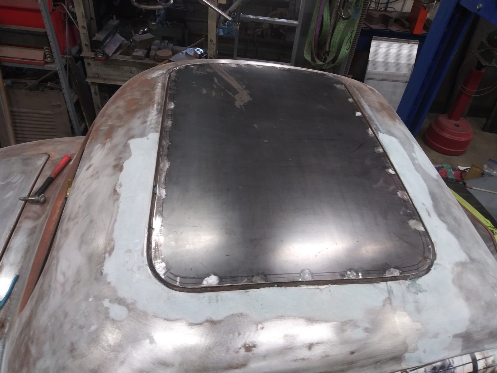

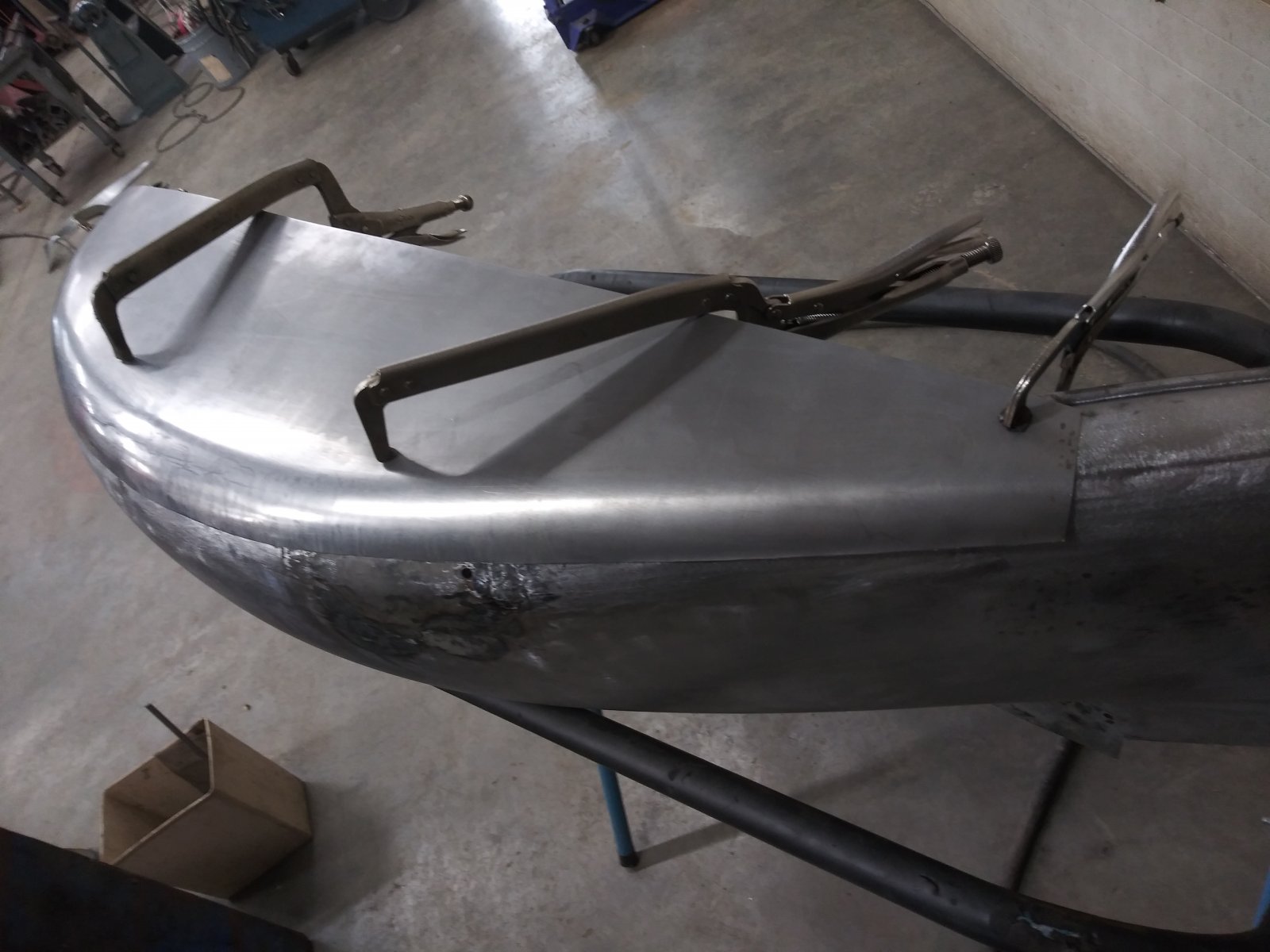

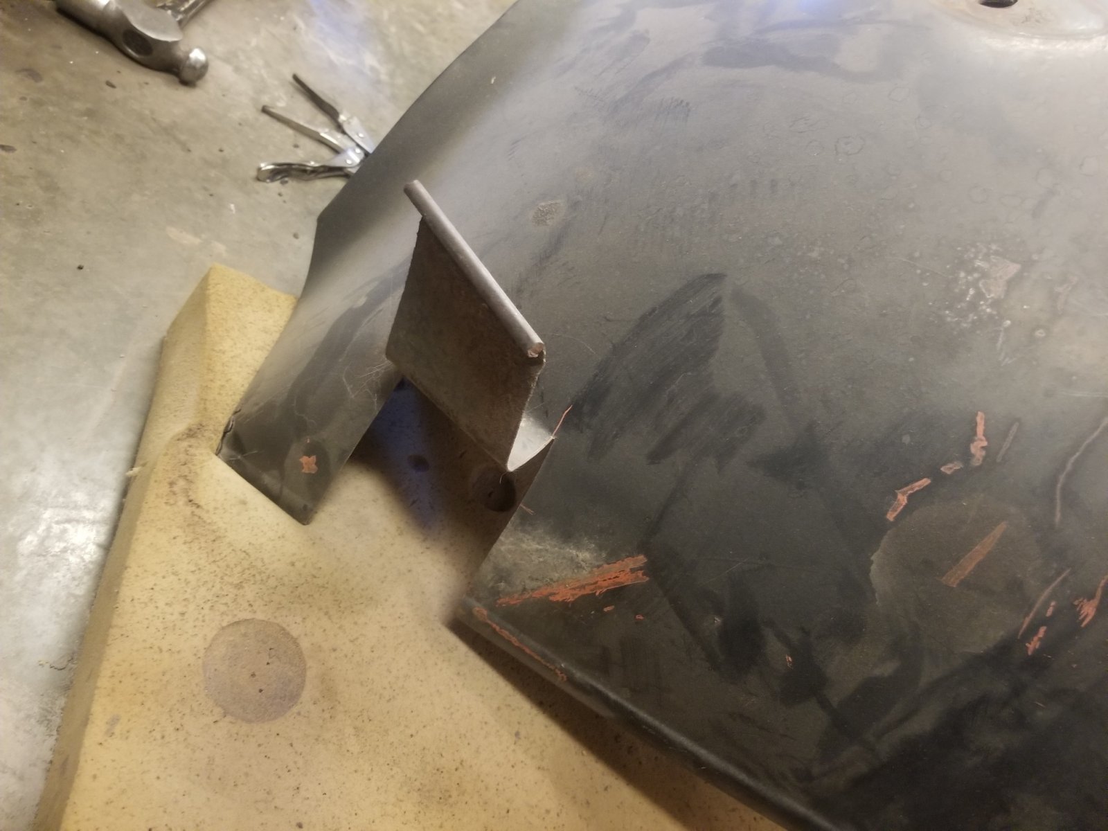

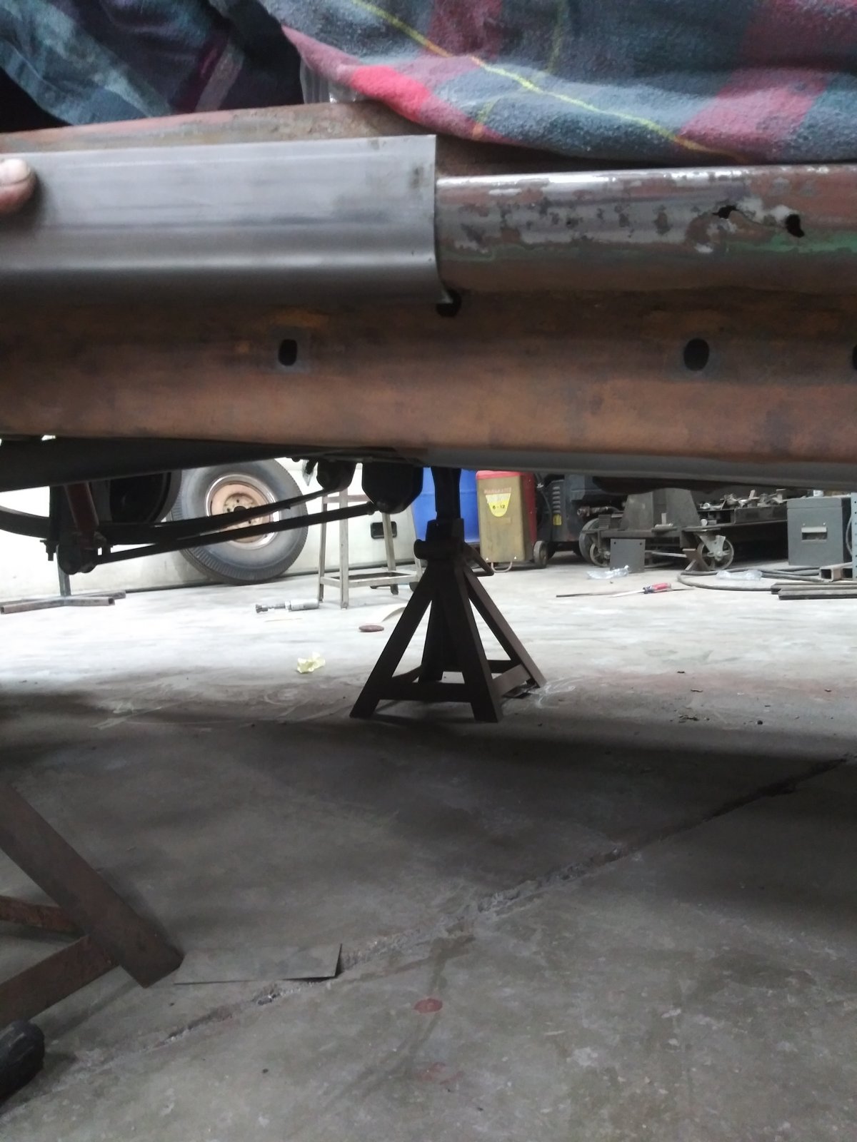

    More work on the 35 Plymouth.
    I wheeled out a top insert. There was a piece of galvanized screwed over the top. 122 screws to be exact. 20220314_161829.jpg 20220314_161847.jpg
    I got a good start on the rocker panels too.
    I prebent them with a radius break and ran them through a repurposed set of dies to get the right curve.
    Then I made plates to rattle in the quarter detail line with my Baker (pullmax) machine.
    They fit nice!
    20220331_214033.jpg 20220331_214028.jpg It's my father-in-law's car and he's going through some serious health problems so I called for some help. I got a great crew helping me out now! 20220331_204951.jpg

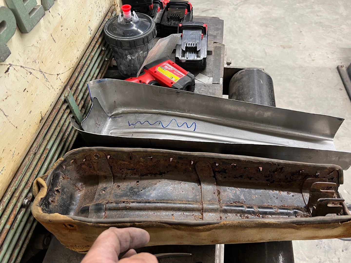

    A good friend of mine has a powder coat business and has been restoring a Kent model KMX850 bmx bike. The bike was found in the woods and was brought to him for repairs, with many of the obsolete parts being sourced from other style bikes and scooters. Here is where he has it thus far..
    Once the sun had taken its toll on the seat upholstery, the foam inside became a nice sponge for all the precipitation that Mother Nature could throw at it, leaving much of the seat pan gone. So he needed a seat pan fabricated, and this is where I entered the picture..
    His major concern was that we duplicate the impaling spikes to secure the upholstery.
    I had attended an estate sale about a year ago and picked up a set of Malco notchers, not knowing what I'd ever need them for, but also knowing I couldn't do without them.
    So when I pulled these out of the tool box all fears had been abated..
    We started with a piece of 19 gauge AKDQ and used Stan Fulton beading dies to add the center bead.
    A piece of 5/8 round stock on the magnetic brake then added the radius for the side bends. Some of the 5/8 round stock was also used to make some post dollies with a welded stop for use in the bench vise..

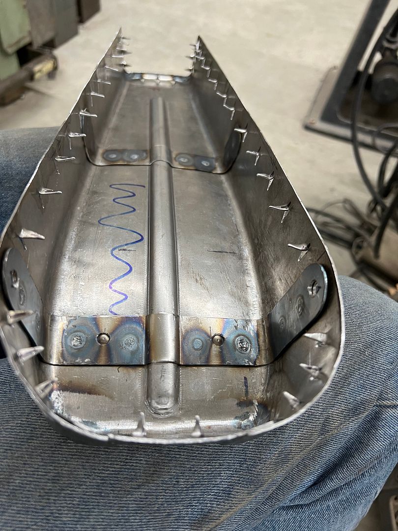

    Basic shape
    The Erco kick stretcher used on the sides and the post dollies on manipulating the radius bend helped to provide the kickup needed at the rear.
    A solid rod across the rear mounting holes gives us some critical dimensions for layout....
    For the mounting holes in the rear, we measured 9/16 from the edge to hole center as per original, and then made a two ended transfer punch that fit snugly between the sides. Once we had our rear measurement and the point aligned to the 9/16 scribe line, we tapped either side to mark the holes.
    Once drilled, a rod through these holes lets us locate the front bracket. We reused the bracket to save some time (and money) as it was still good and solid..
    Impaling spikes added
    All bracket installed and ***embly gets media blasted to prep for powder coat.
