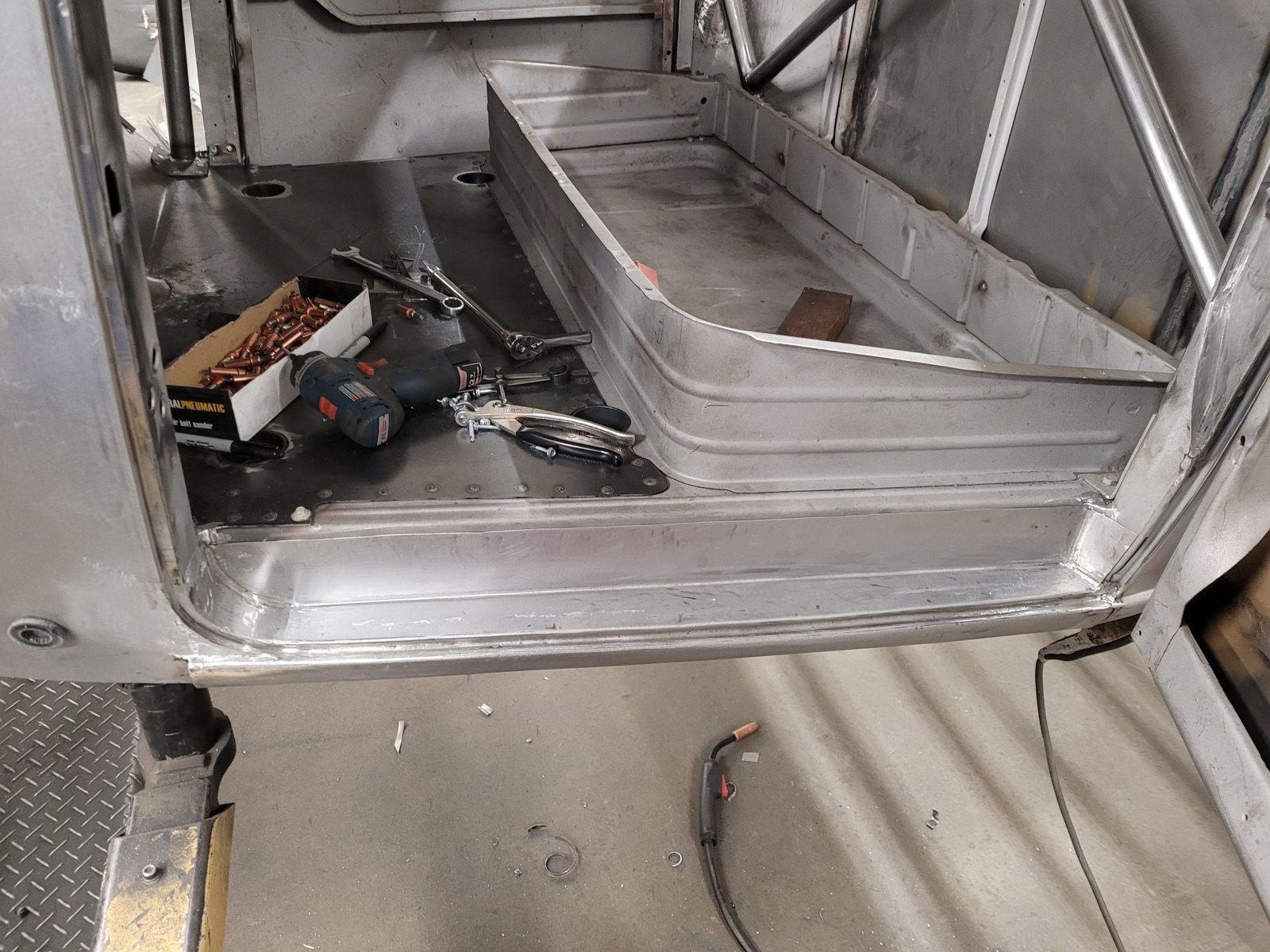

    Working on some Caddy engine bay panels 25F0CD82-B146-45CA-97C3-FE7F6C49C7DB.jpeg 41378A14-C63F-463F-A2DE-FE5B8EAD1D8A.jpeg C1247266-1F61-4DAB-A840-3D774A276522.jpeg EE0084B4-A9CB-4E75-B3B6-91E931B3AA19.jpeg 0DEA181D-C6C6-4E51-A919-69342DF7DA6E.jpeg BF726BE1-0E09-4BD3-9396-1A0798E4FD2E.jpeg

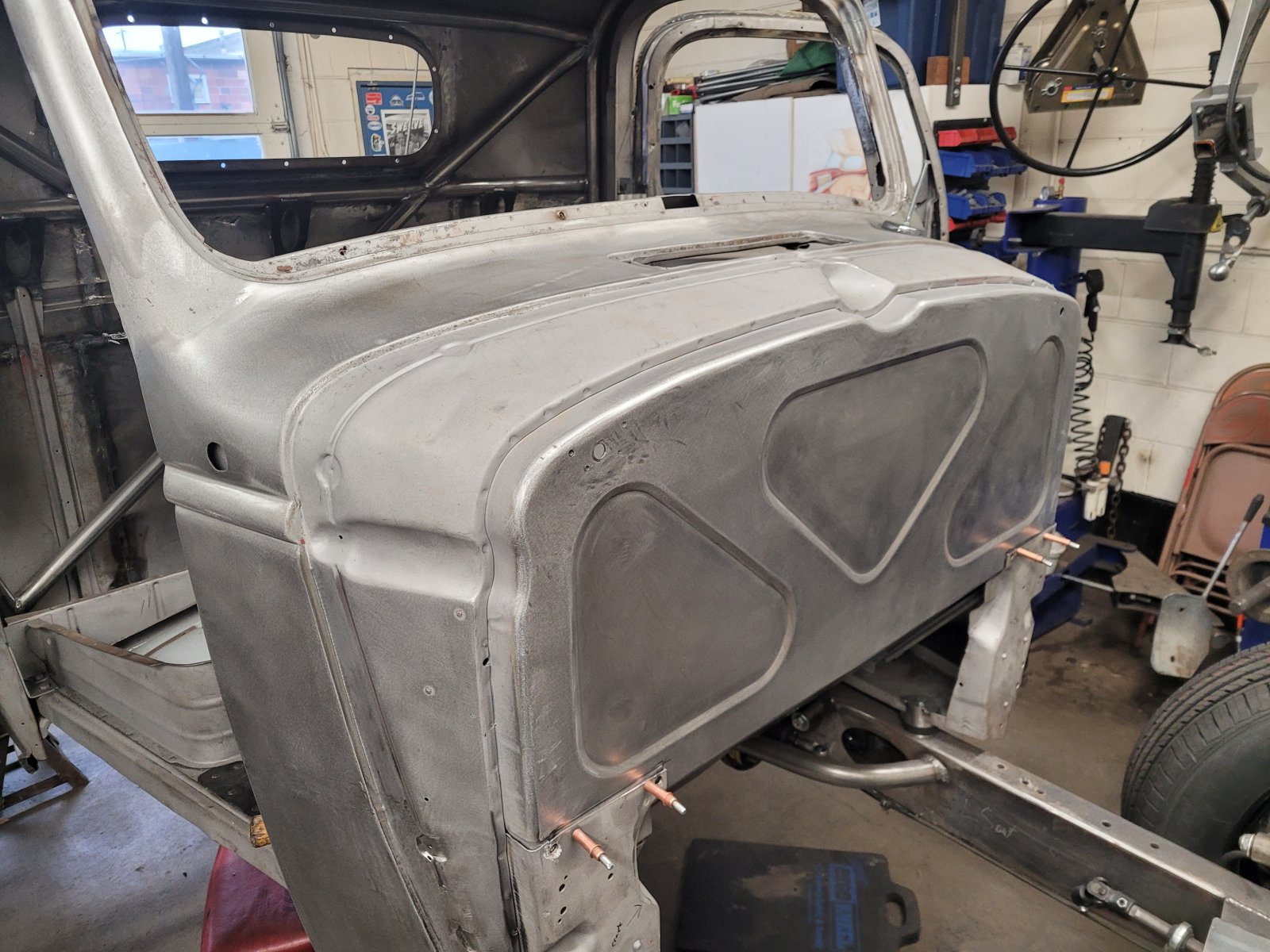

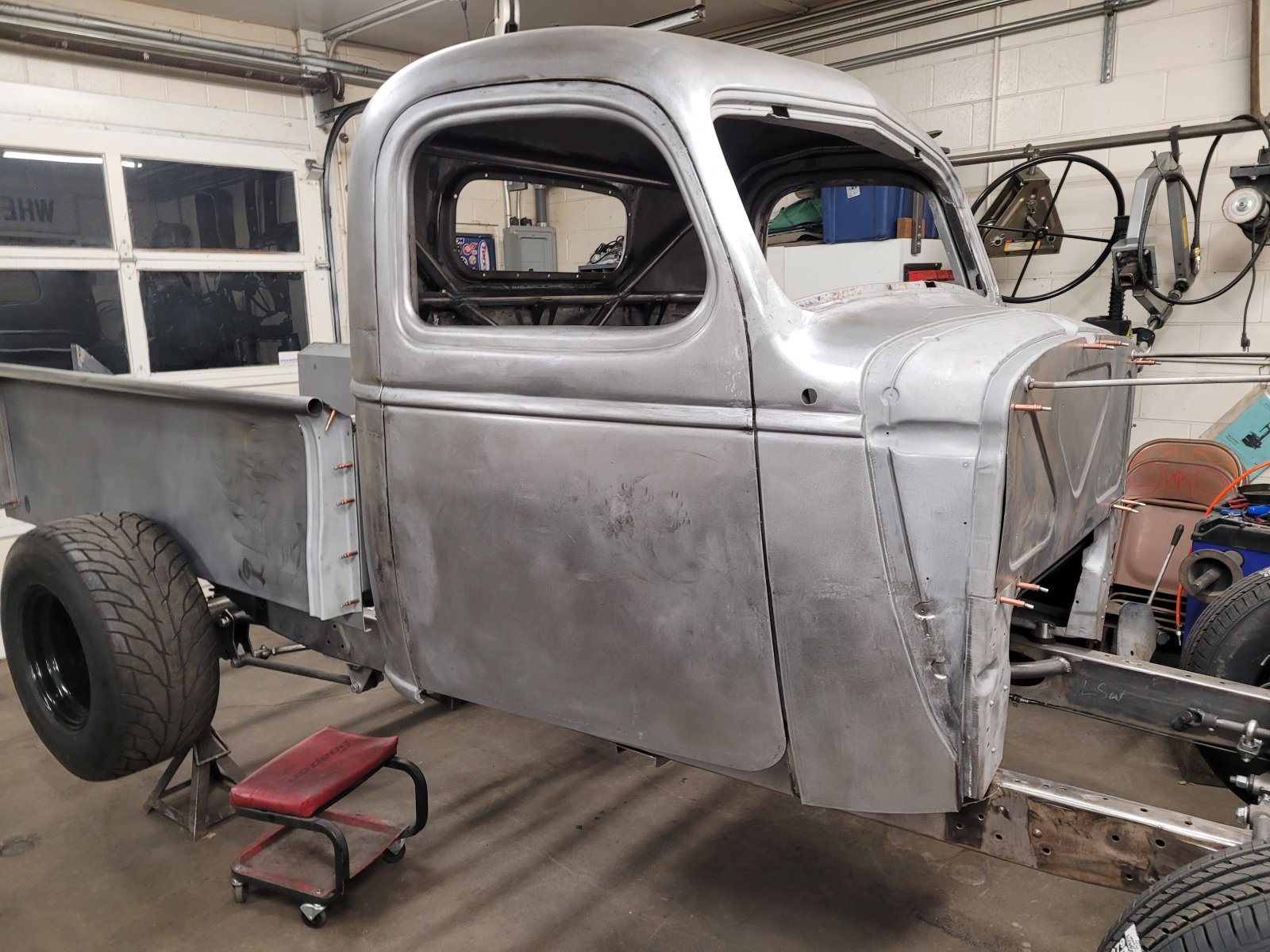

    46 chev I have been building for a customer.

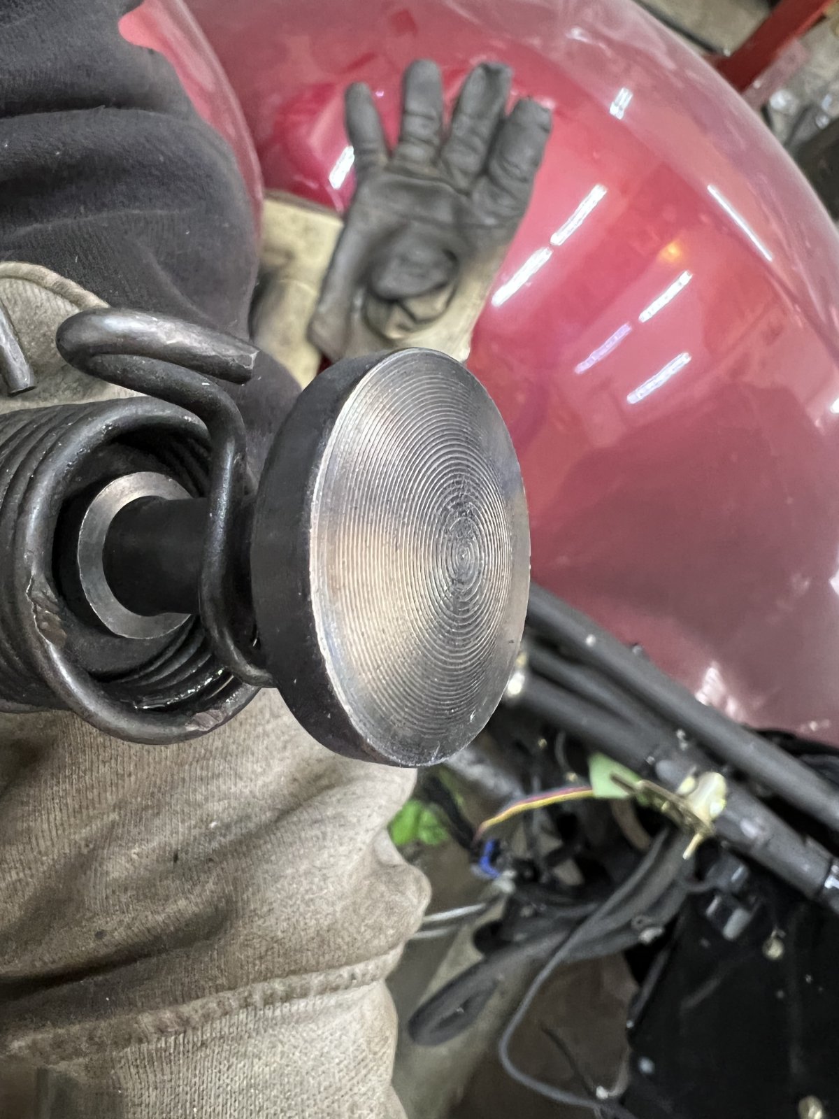

    I needed a little more clearance between the firewall and the distributor cap,on my 35 Ford. An air hammer and a radius anvil head did the trick. Lower pressure is a must.
