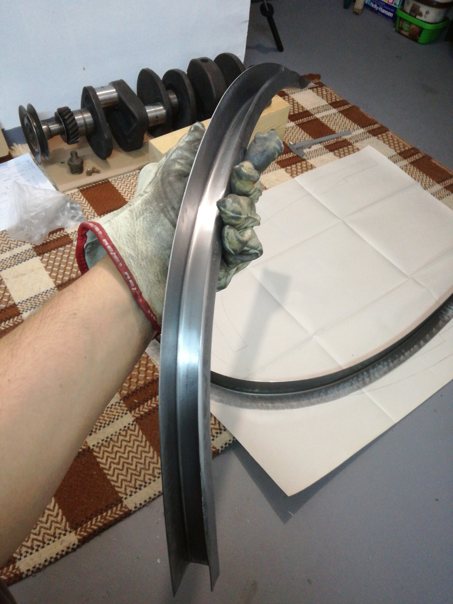

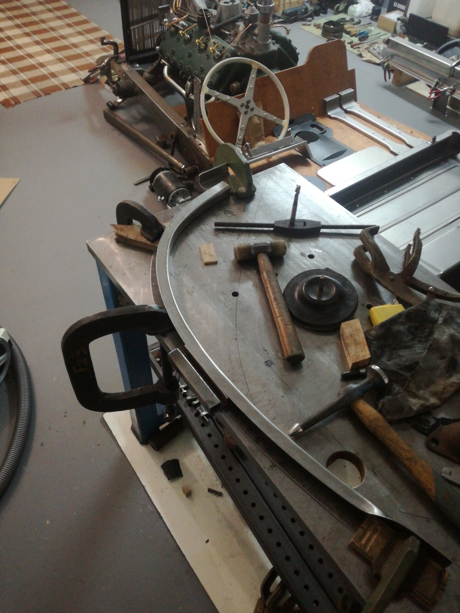

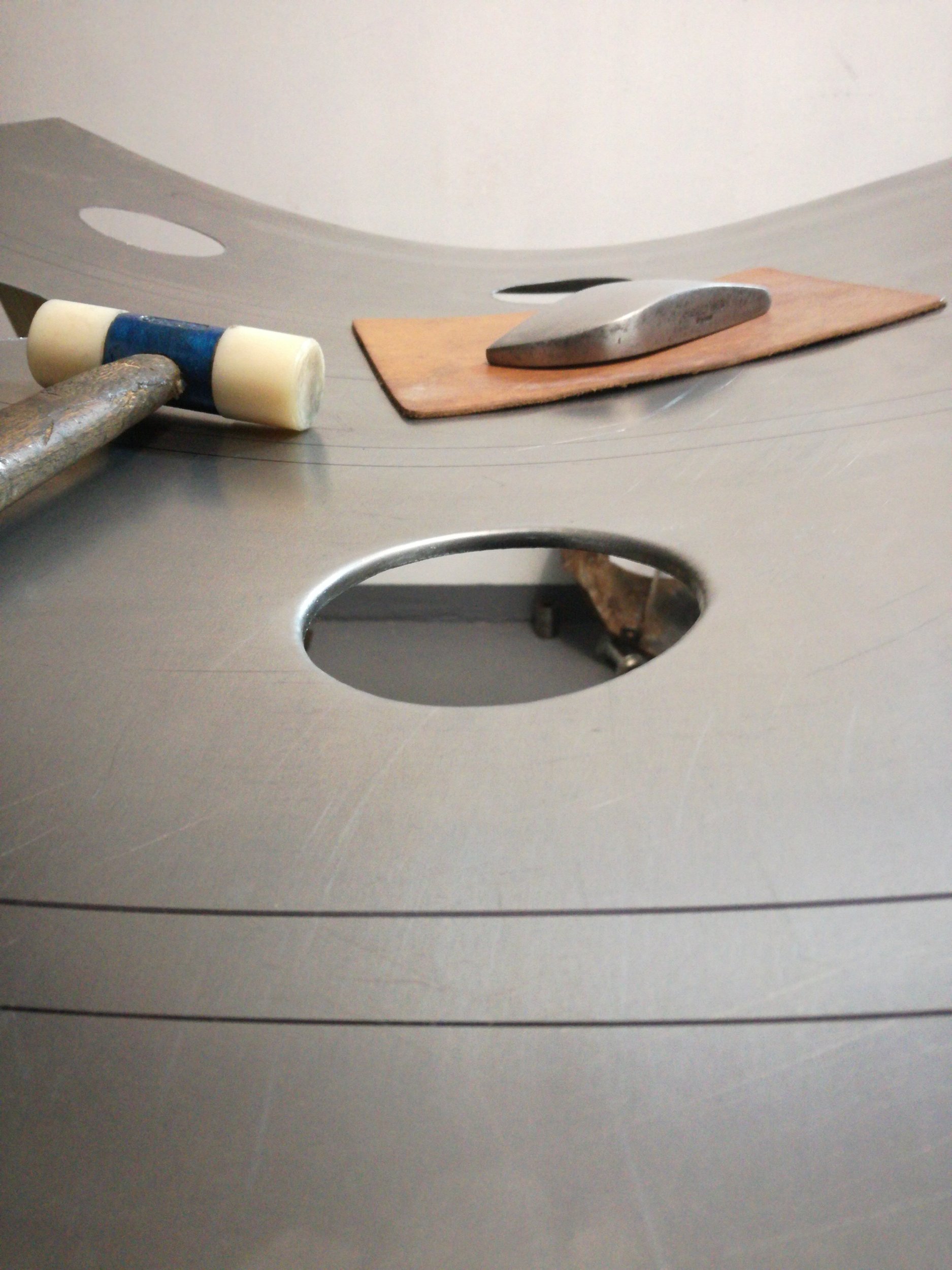

    Some small parts made for that Alfa I posted earlier :
    Both side grilles
    Doors window frames (one polished the other not yet)
    The windshield frame
    And I don't know if it's really metal shaping, more like straigtening : the center grille
    Which is the only original brightwork I managed to save from the car, the rest was too far gone
    Edit I just found the picture of the car when I received it

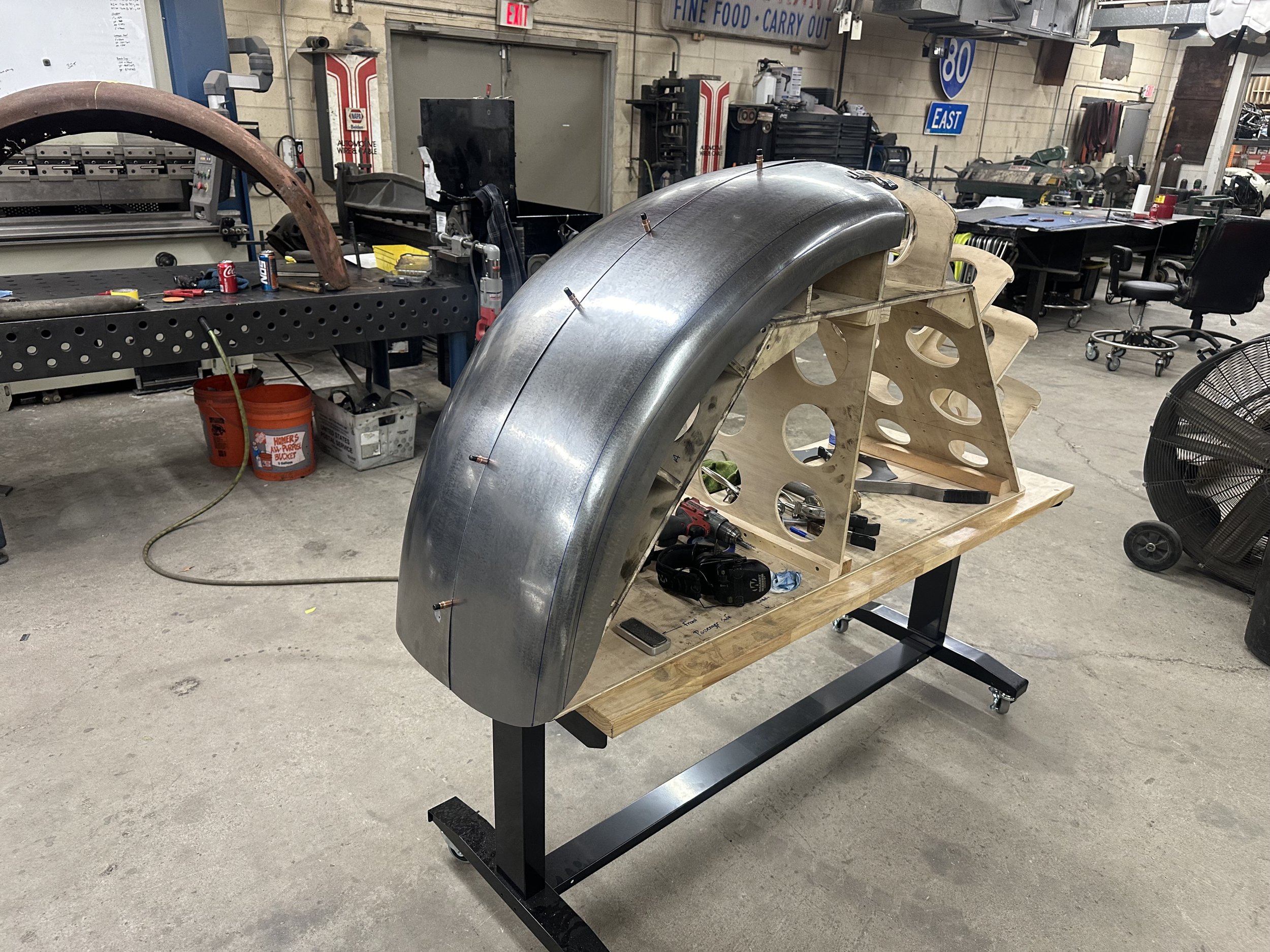

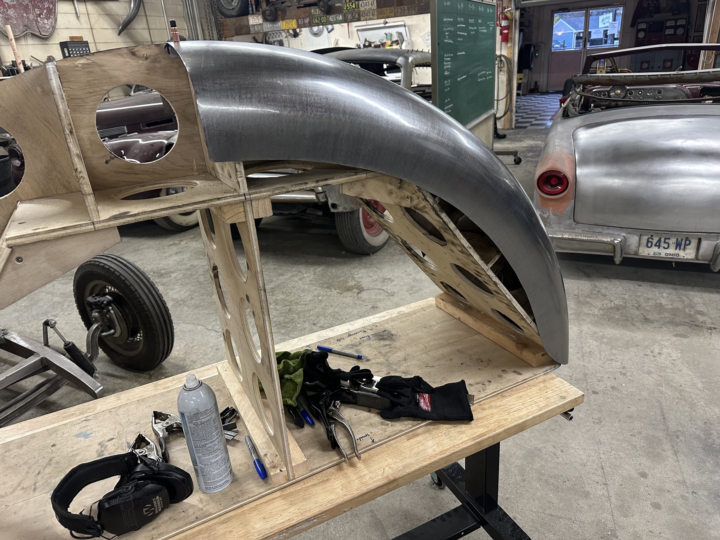

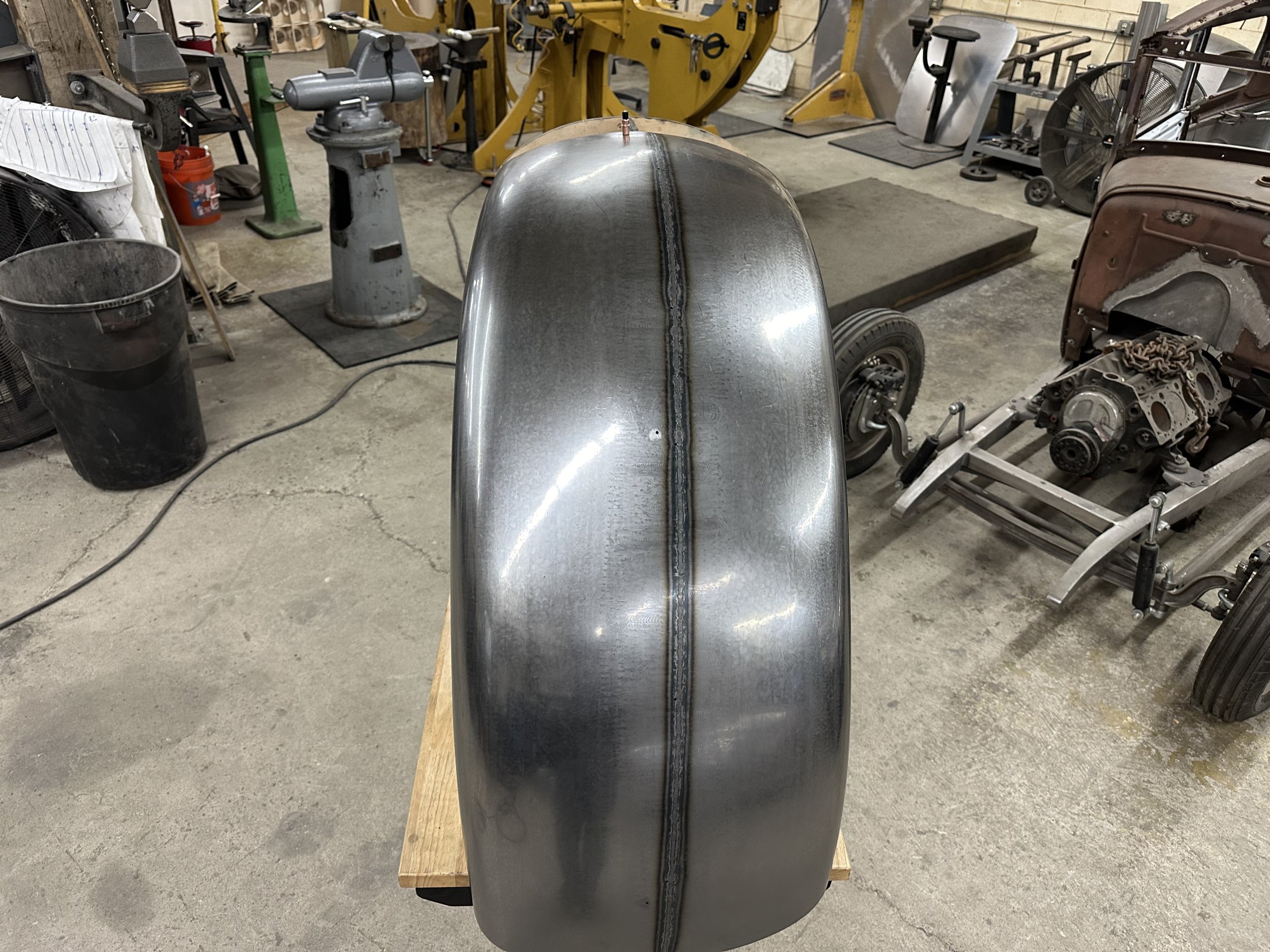

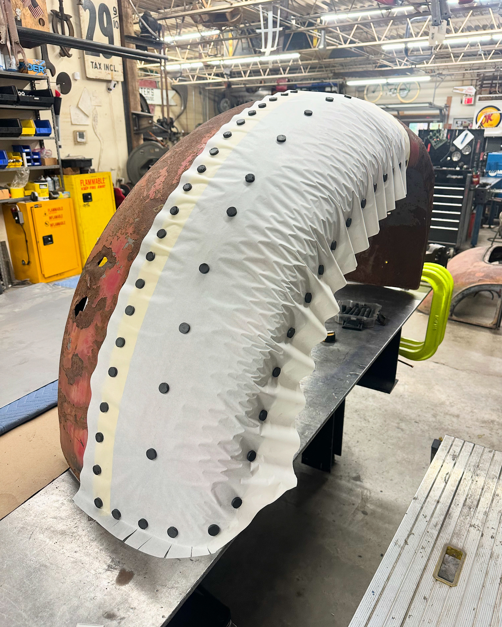

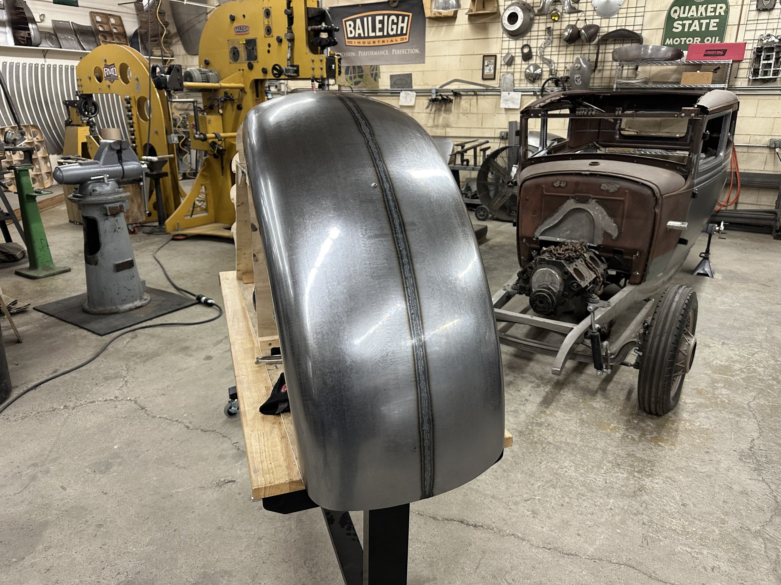

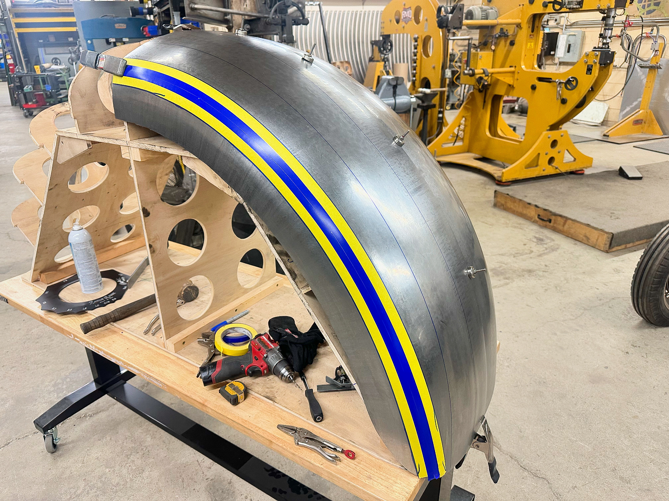

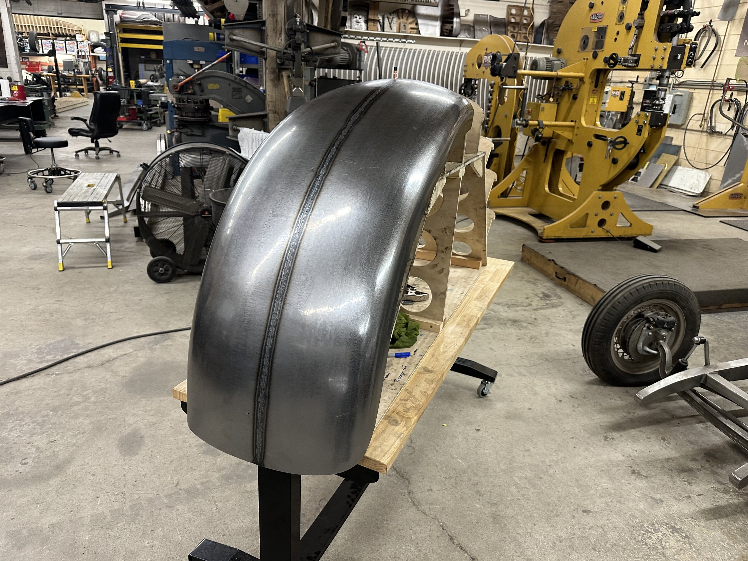

    Working on some early Mack truck fenders. Started by making a buck, they are so large I decided to do them in 1/4s instead of halves. Then started patterning and shaping IMG_0983.jpeg IMG_0984.jpeg CD8D13DB-58FC-4FAF-A0E4-B0162333B43E.jpeg IMG_1113.jpeg IMG_1114.jpeg IMG_1116.jpeg 71AB301A-AE33-4AE7-A68A-CADF6DD54436.jpeg IMG_1402.jpeg IMG_1403.jpeg IMG_1404.jpeg IMG_1405.jpeg
    Bugguts, Tim, Deutscher and 15 others like this.

  23. cornfieldcustoms
    Joined: Feb 2, 2008
    Posts: 1,064
    cornfieldcustoms
    I dont use the wheel in shaping. Its all power hammer shaping, power hammer rough planishing , then finished on the air planisher
    Tim, MP&C, fauj and 1 other person like this.

    superior finishing!!!--thanks

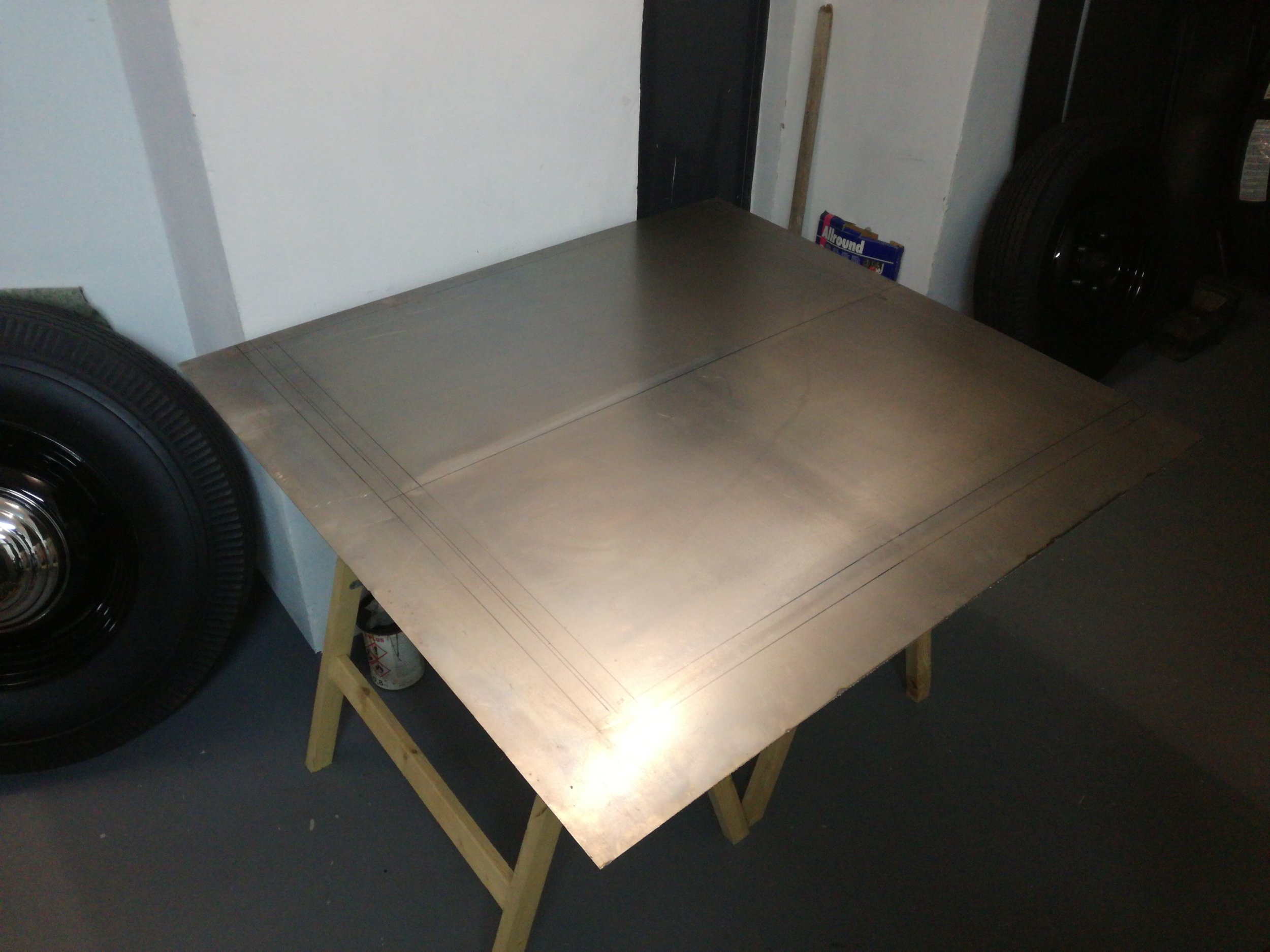

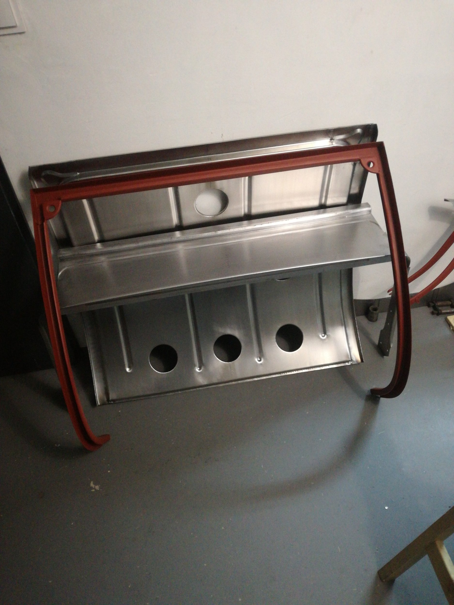

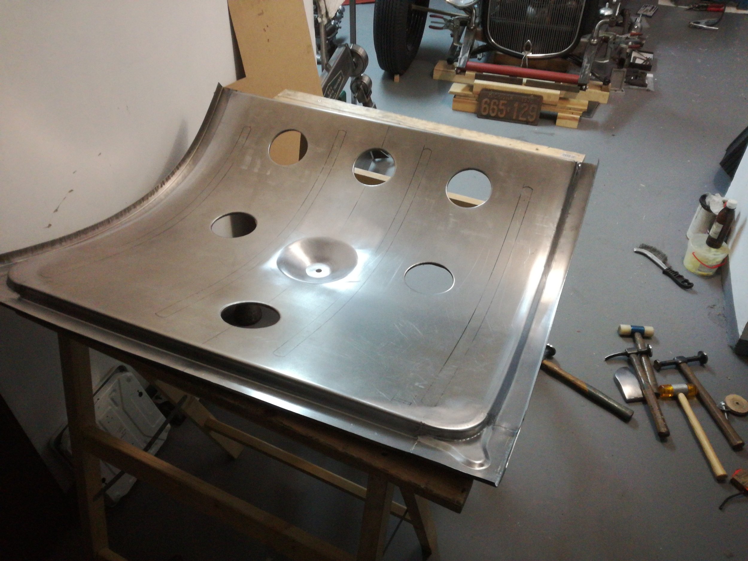

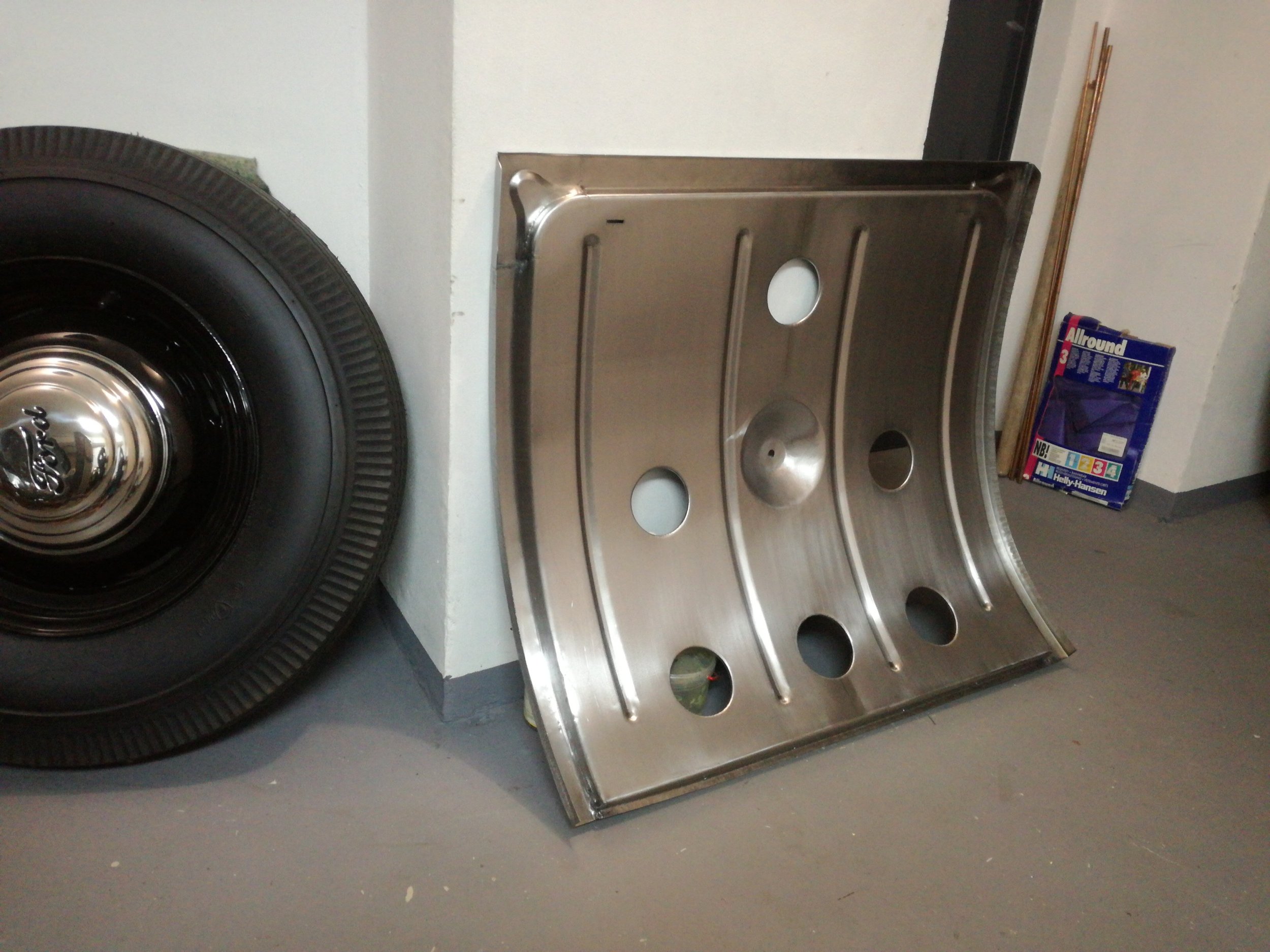

    All hande made parts for deck lid
    32 Roadster
    IMG-20231214-WA0003.jpeg IMG-20231214-WA0020.jpeg IMG-20231229-WA0007.jpeg IMG-20231230-WA0017.jpeg IMG-20240115-WA0012.jpeg
    IMG-20240104-WA0022.jpeg IMG-20221215-WA0028.jpeg IMG-20221216-WA0000.jpeg IMG-20221215-WA0033.jpeg IMG-20221215-WA0040.jpeg
