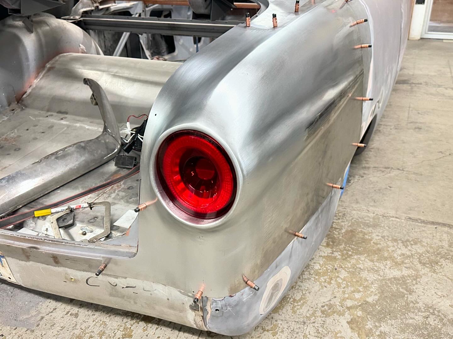

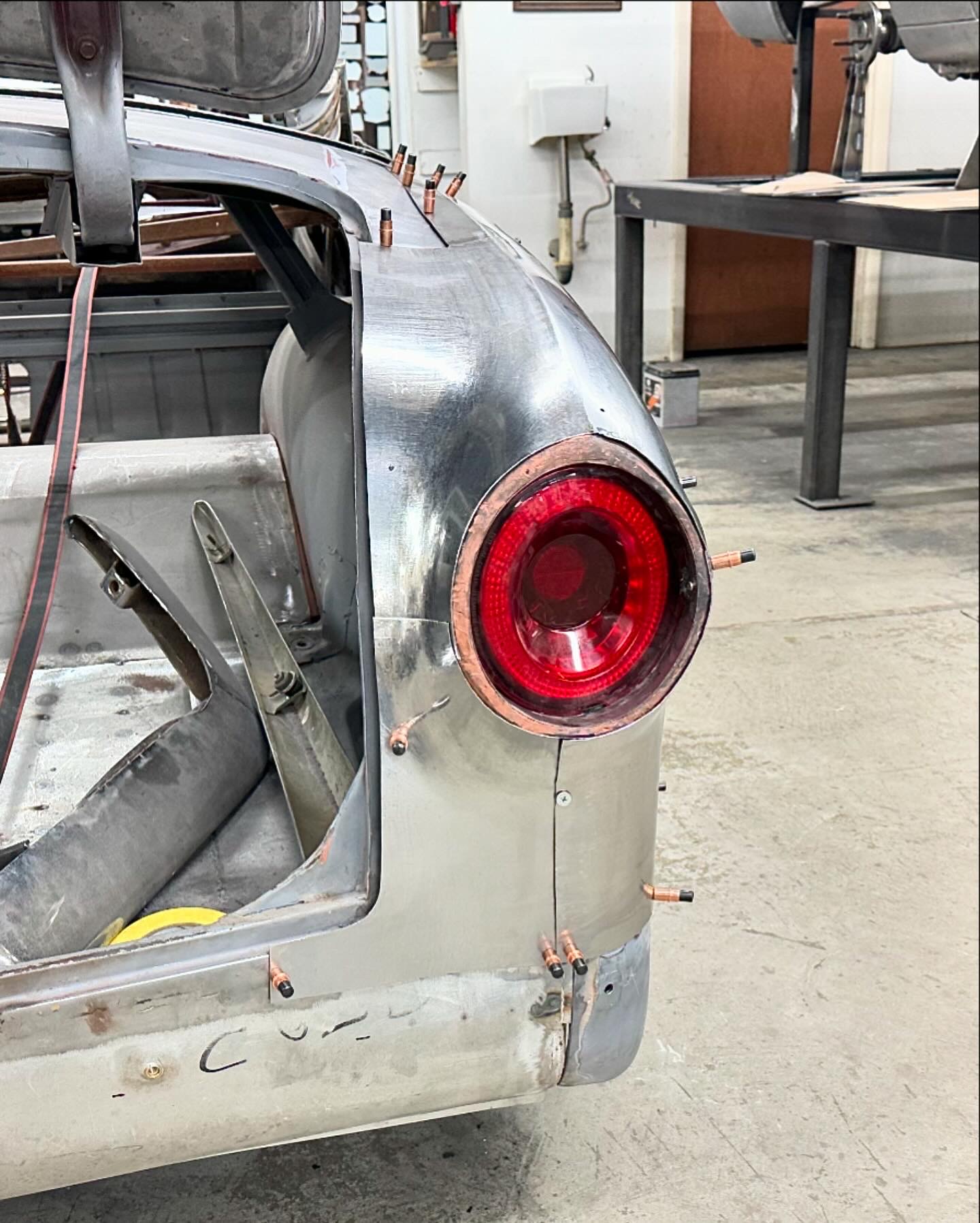

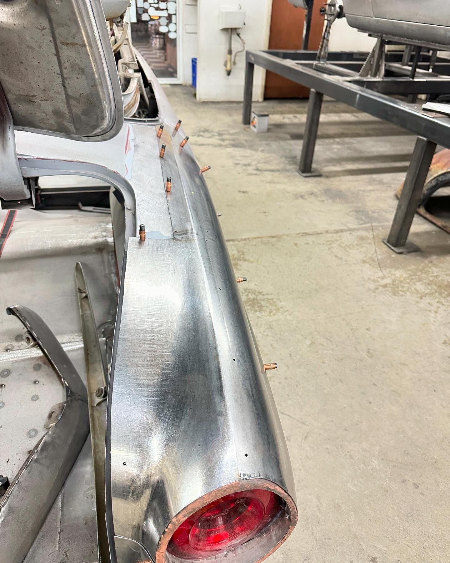

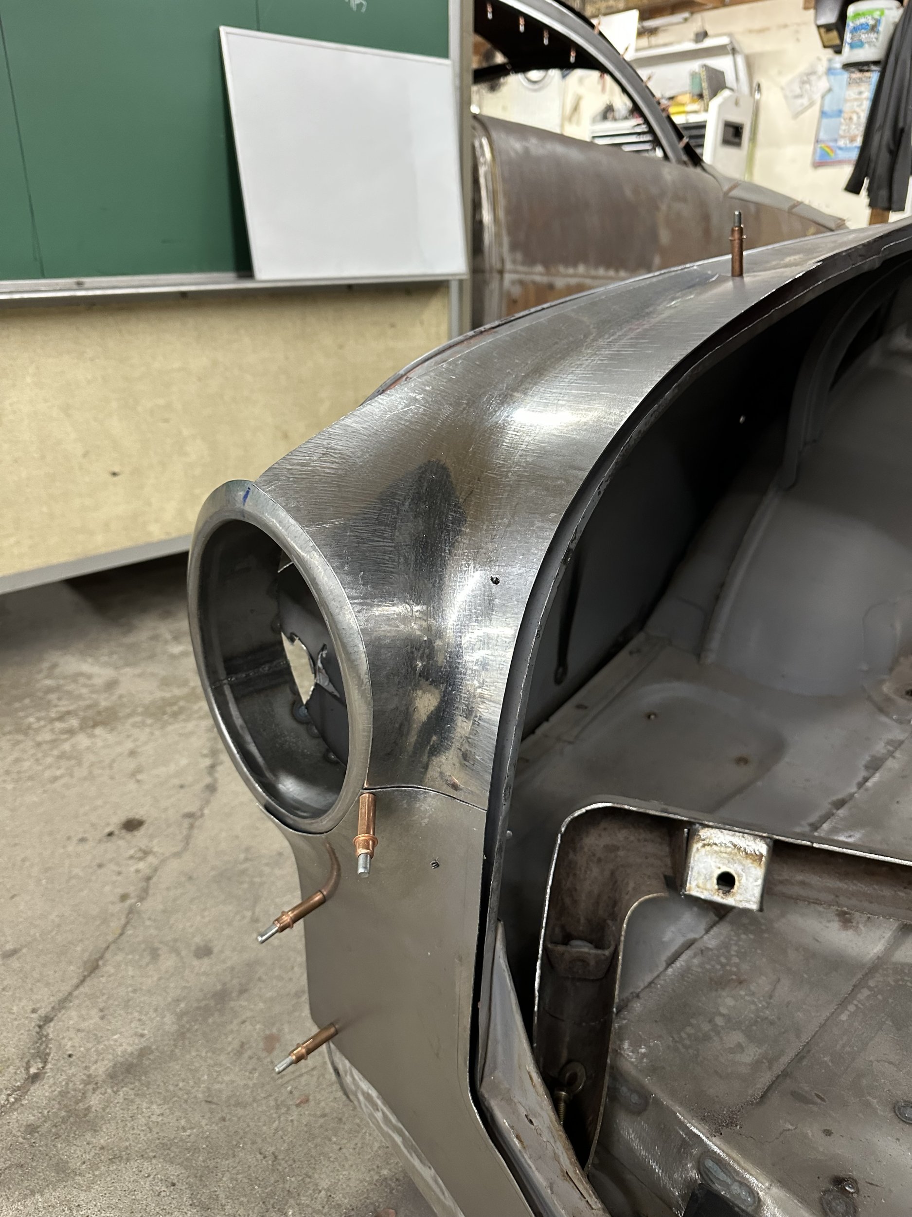

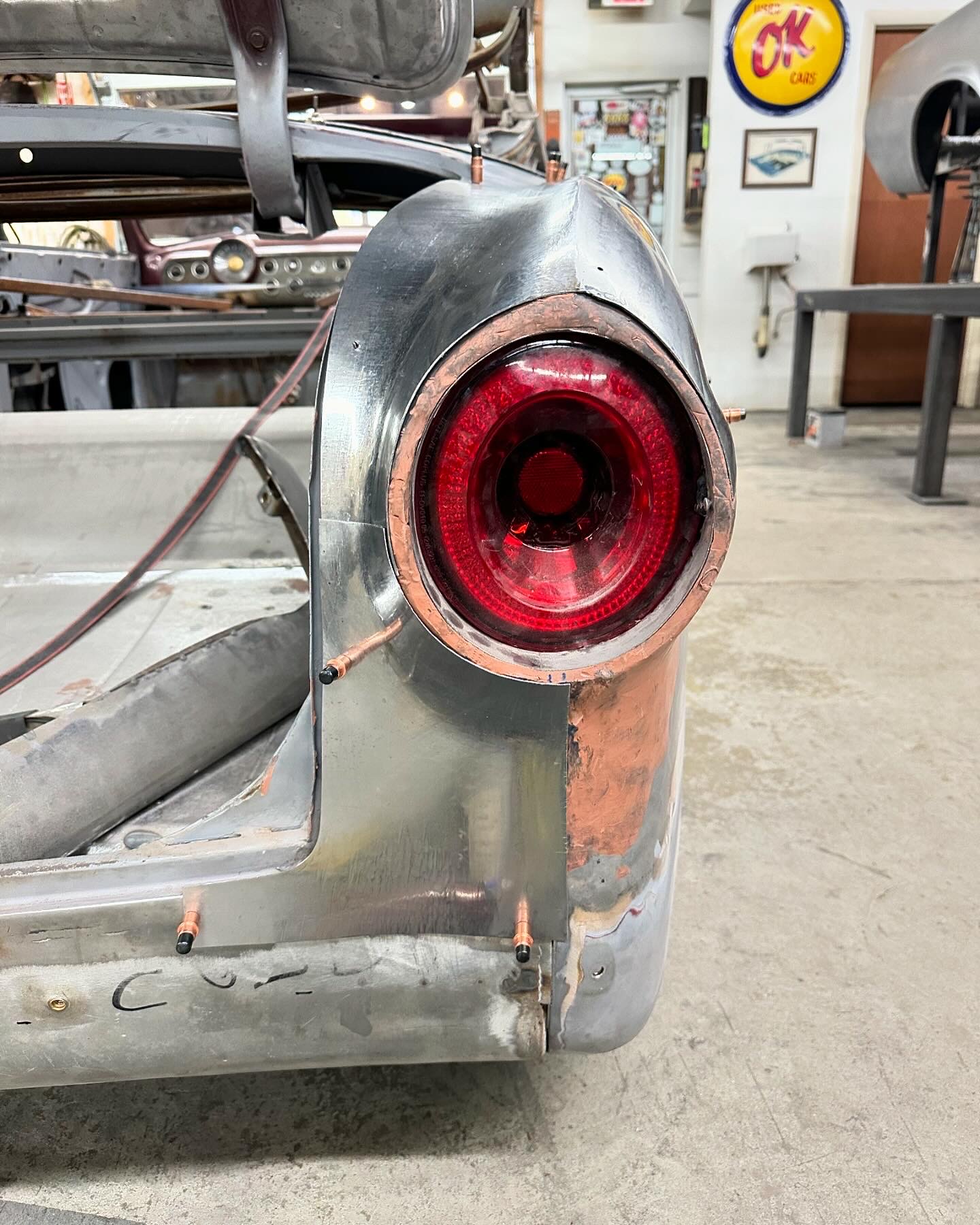

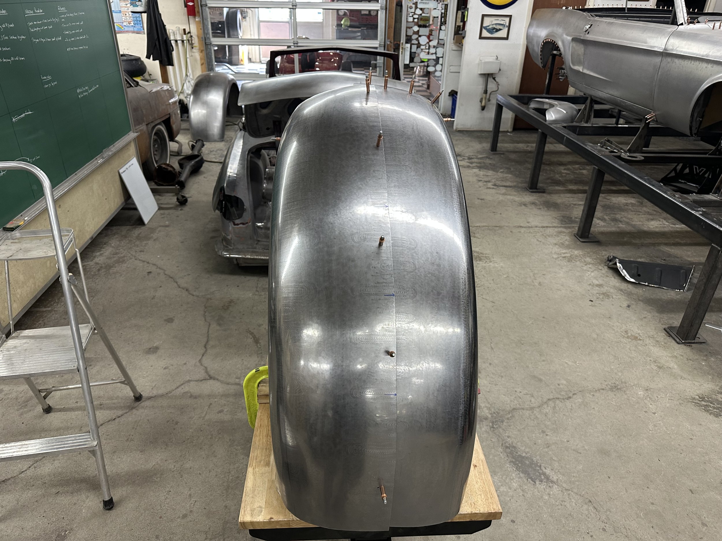

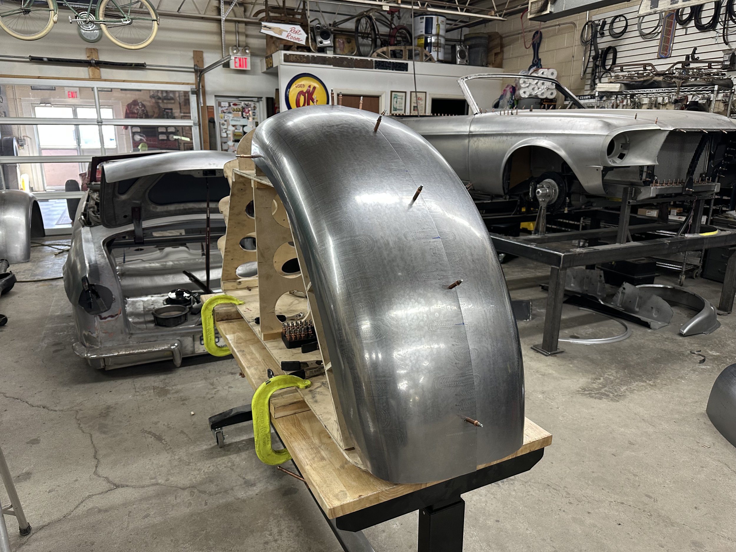

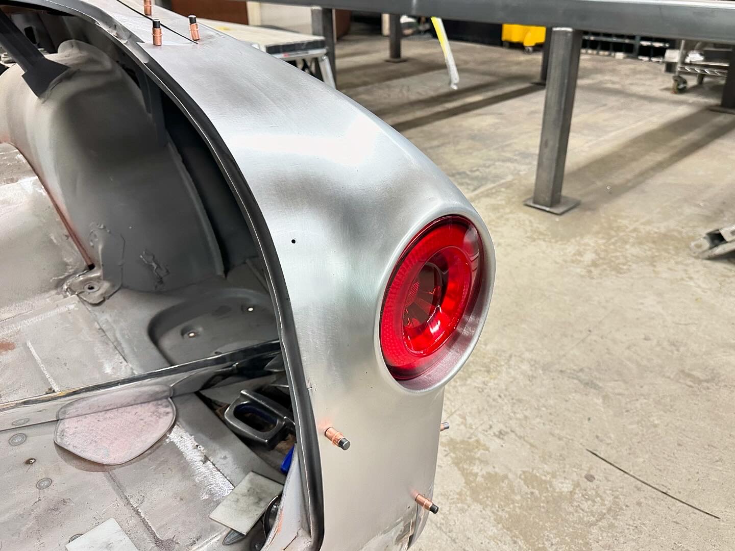

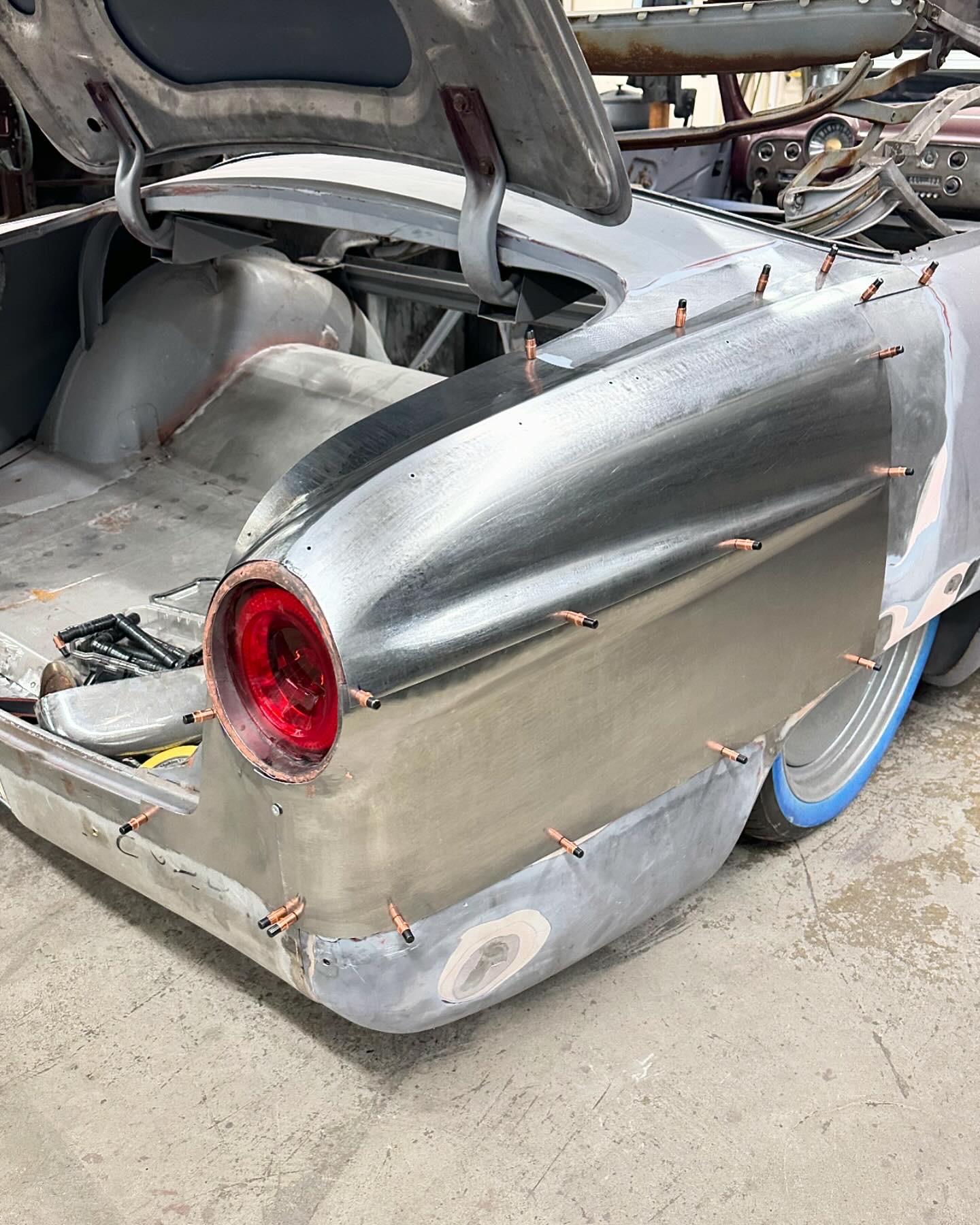

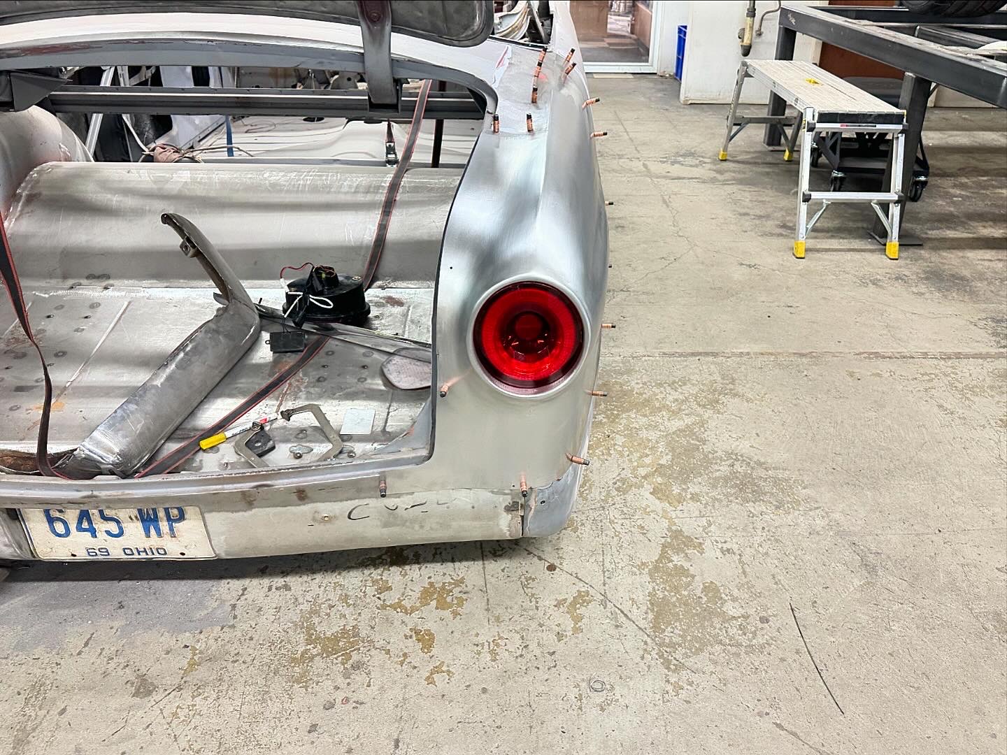

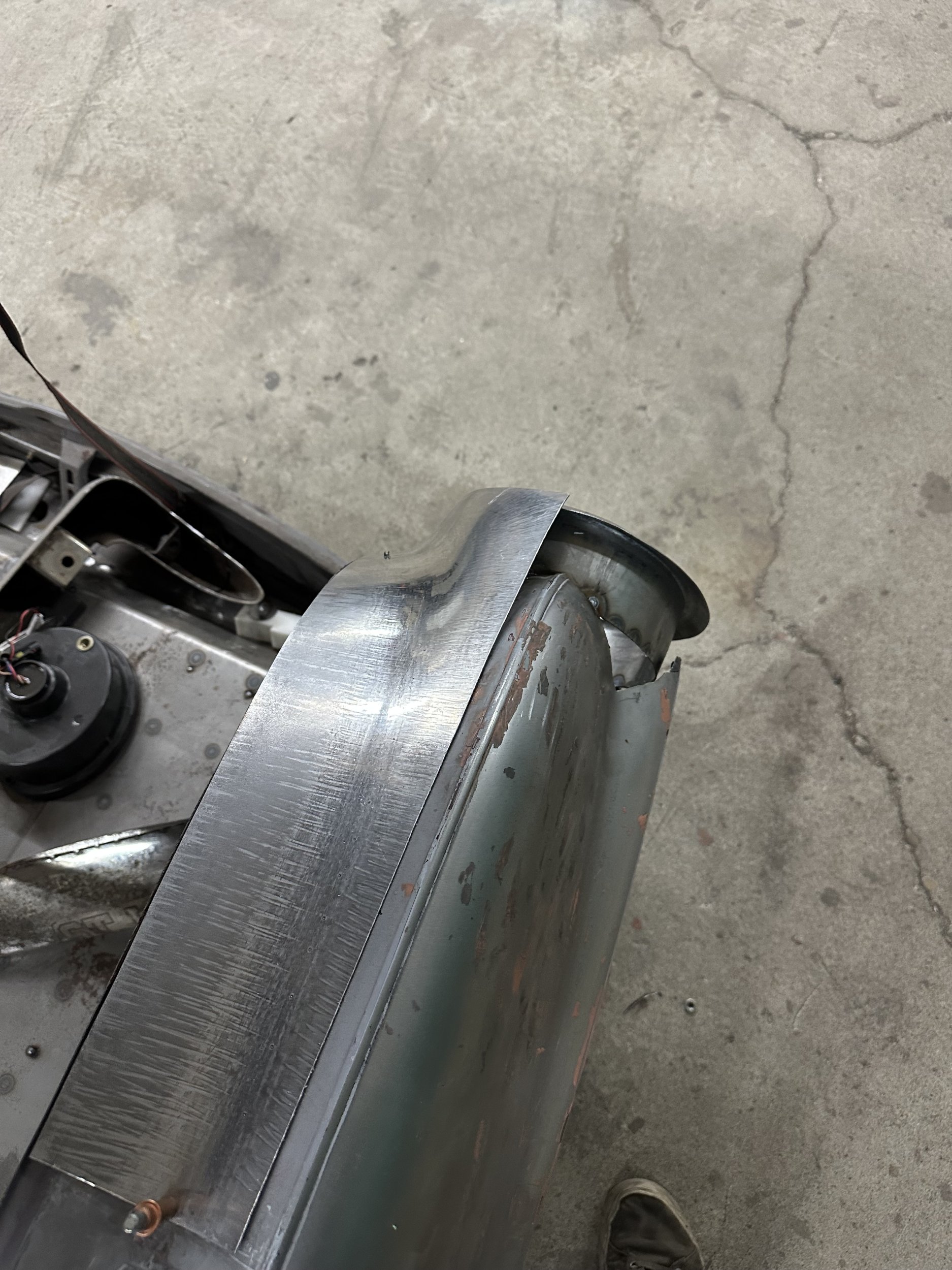

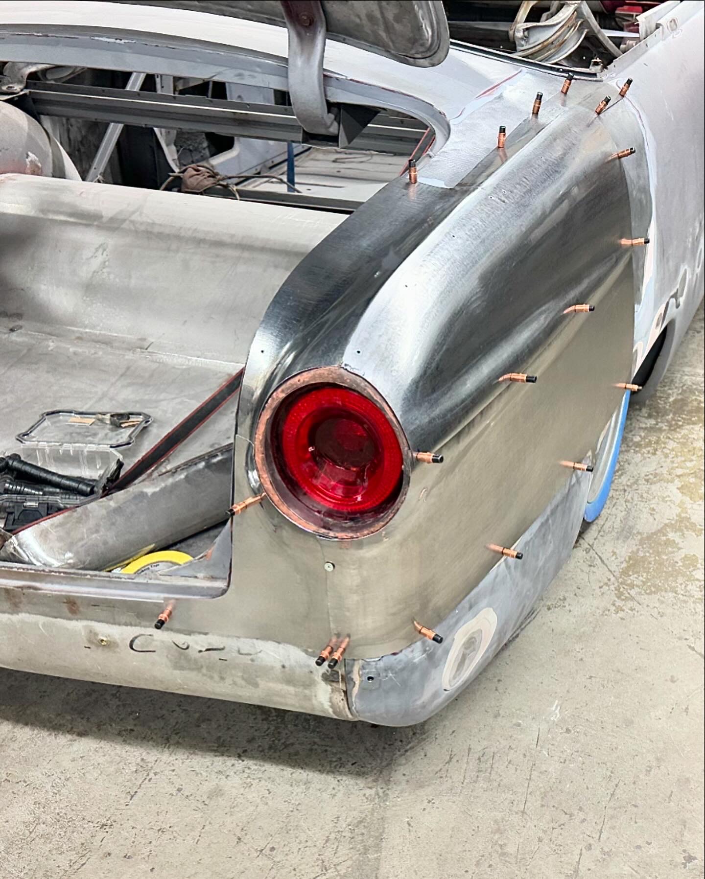

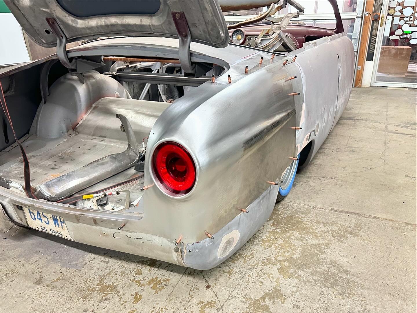

    Been working on a 51 convertible this week doing some new rear quarter panels and tail light mods 711540EB-A309-4A1E-AF5B-B1174AEF7AD7.jpeg 9A1B63FE-F4EF-4147-B489-F9BBDC488565.jpeg 58D56F46-57C6-4F18-ACEA-E7DD93675FFD.jpeg CF00D2D5-DAB5-4200-B0DB-A1BE5A393C28.jpeg 8DF5809C-2247-43C5-BB5A-E3FDC4692125.jpeg IMG_1570.jpeg C129AE2F-9C46-42D2-95C6-7D4E6669E241.jpeg 7A484DDB-638F-4DD4-8C55-5F3DE9B80A7C.jpeg 64712C10-6925-4DD2-BFFB-3DC31E5C9651.jpeg F1981574-E3C3-4C87-8669-30E861AF228F.jpeg

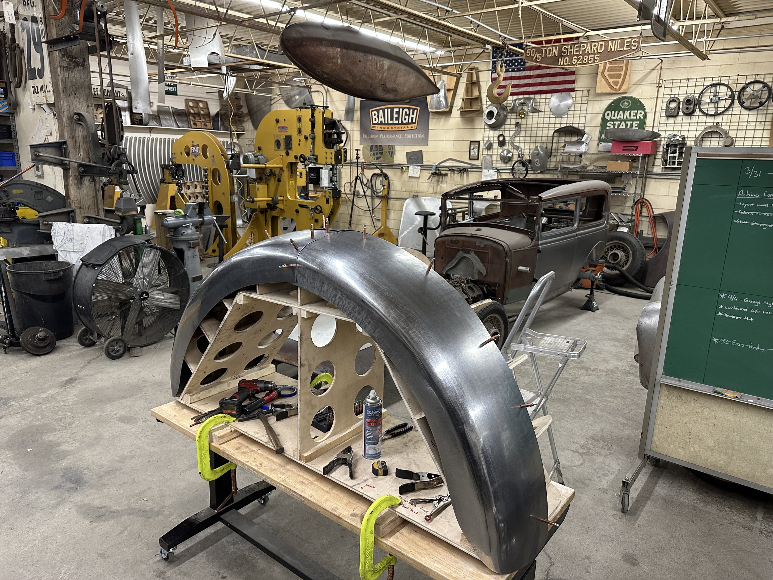

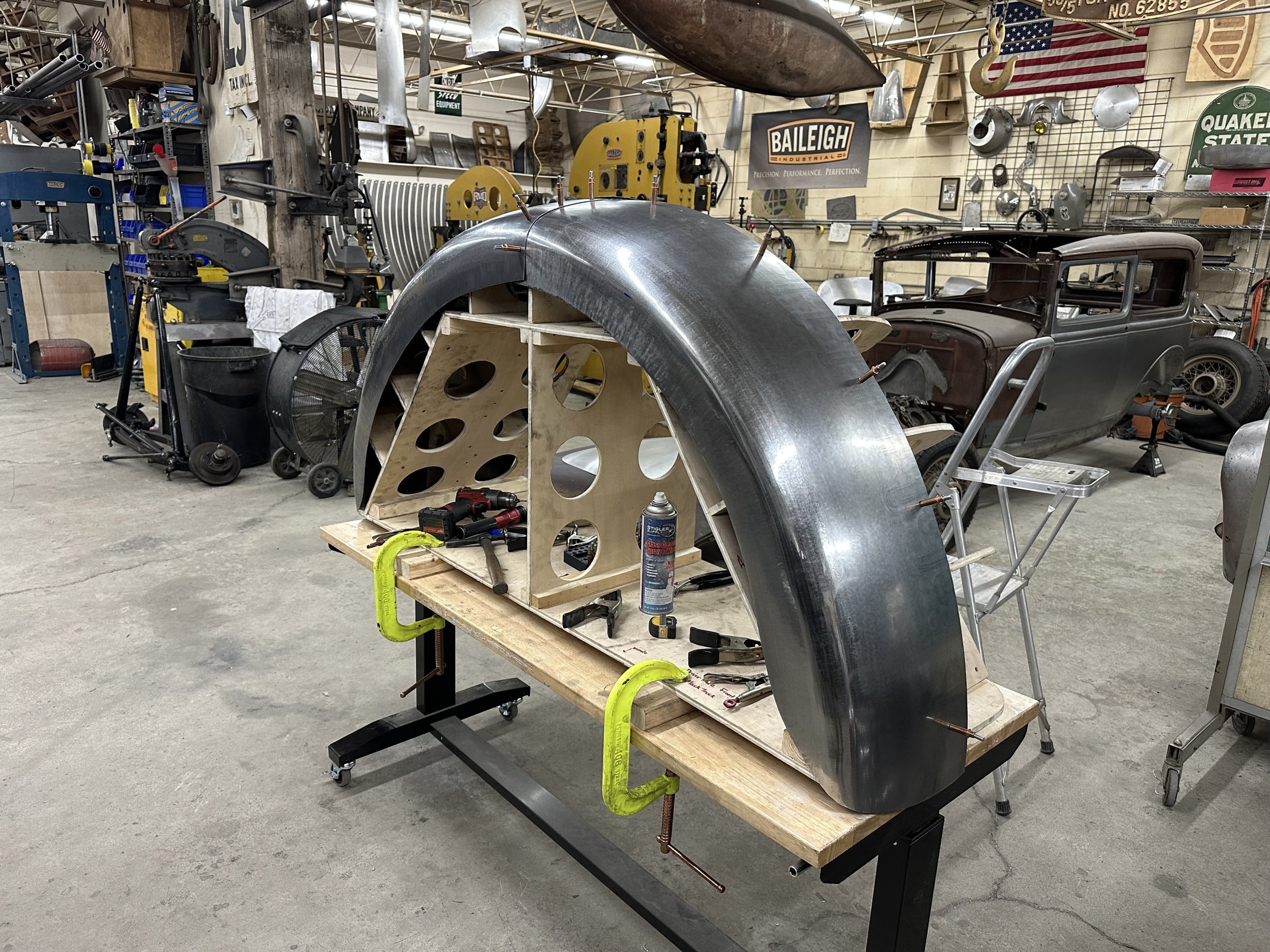

    Some Harley fenders I restored.

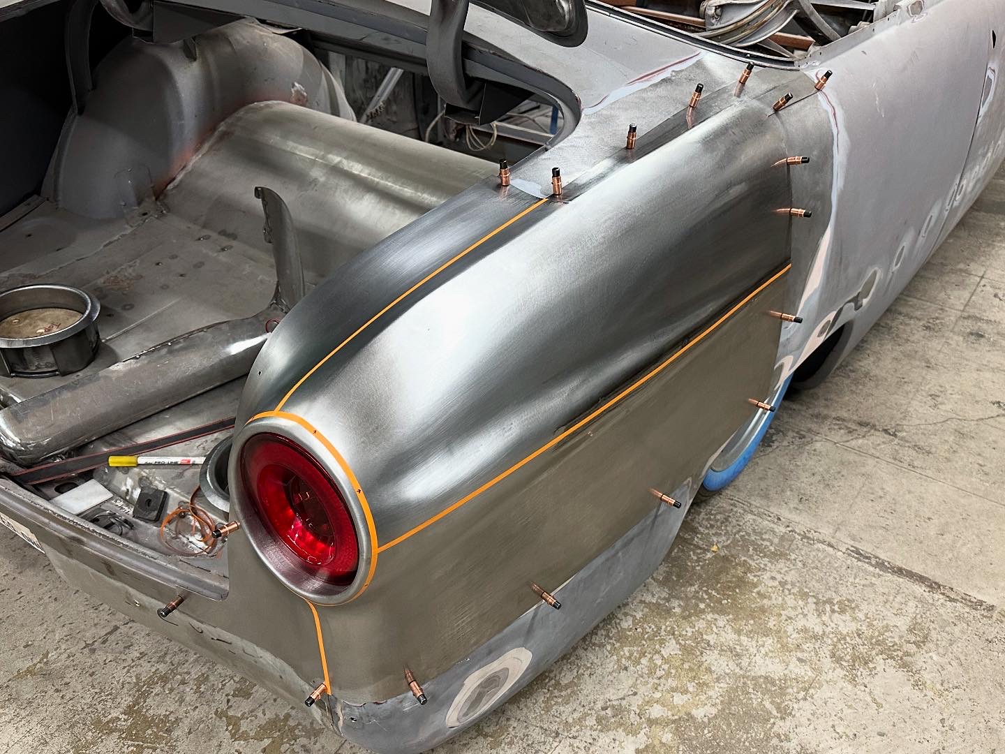

    07EDCAD5-A604-4797-BC55-176EC5B93DD4.jpeg E47DFB2F-8D17-4CF8-8231-AC46F6260251.jpeg E699849A-2DAB-4673-ABF2-45A891639B07.jpeg E1C2489E-9920-4A68-92CF-C67B9E371B4F.jpeg IMG_2750.jpeg 7F461FDA-56BF-490E-B428-5DE3DC7A135F.jpeg FD97B2B4-BABA-4B8E-9F15-95A26EFAABDC.jpeg IMG_3413.jpeg IMG_3410.jpeg Got the PS of the shoe box quarter all welded up and moved onto shaping the DS sections

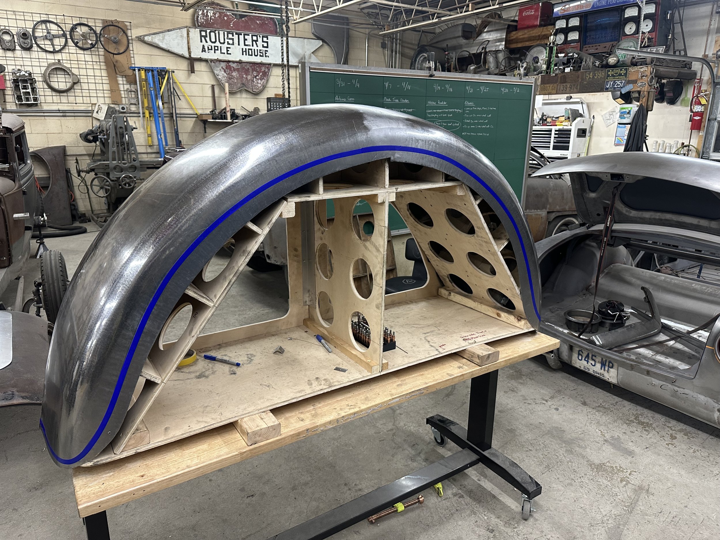

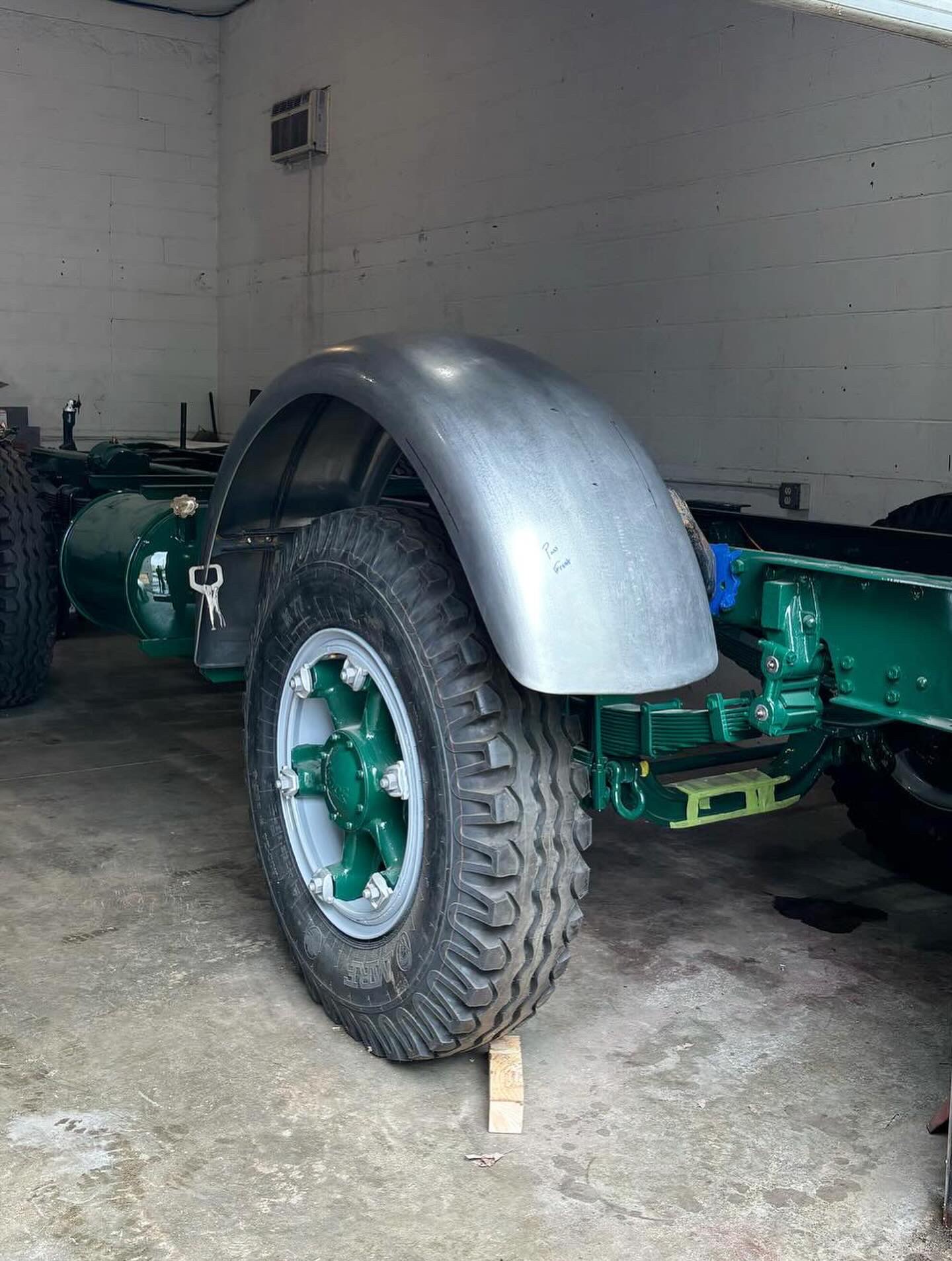

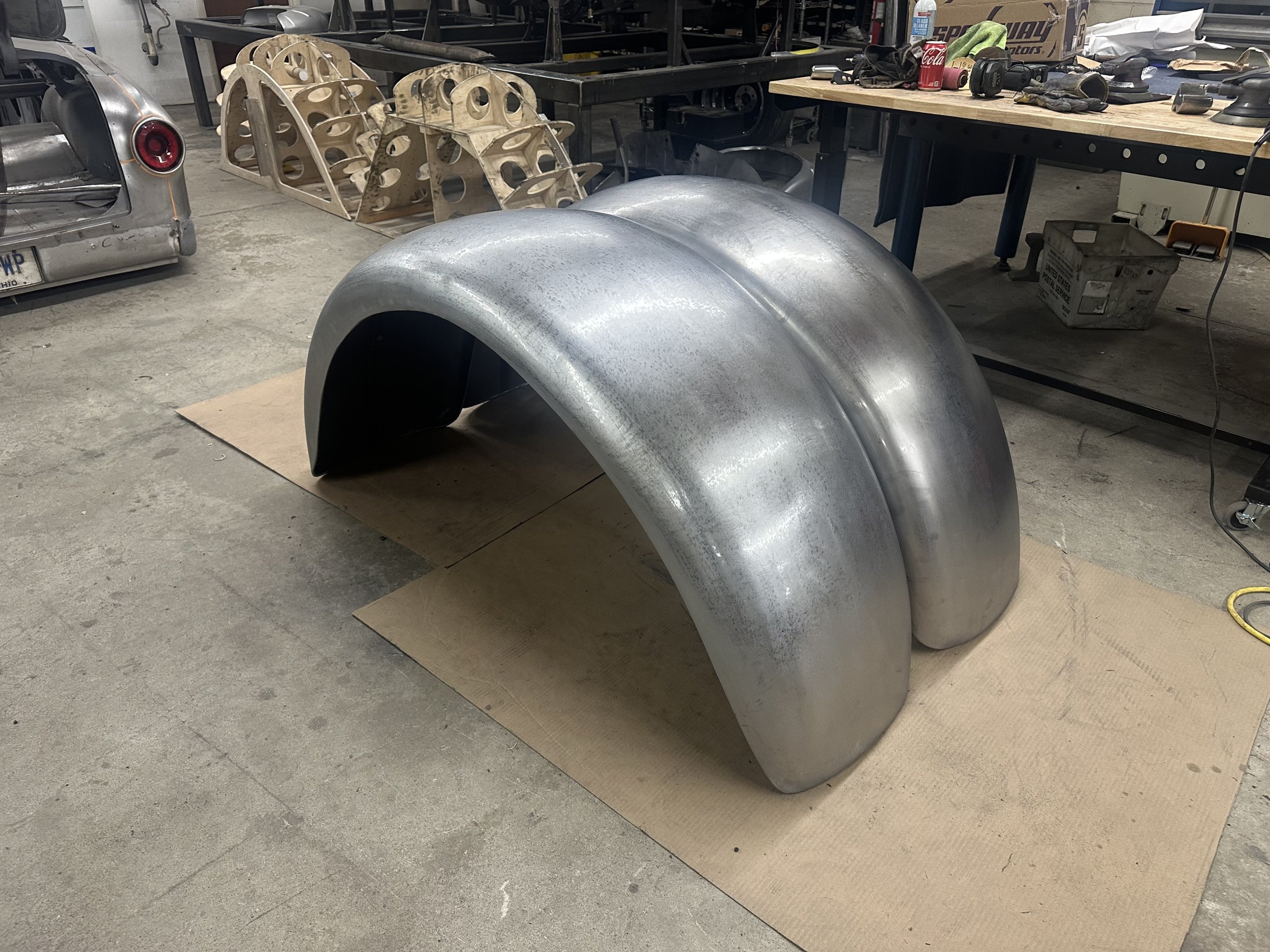

    1946 Mack truck semi truck fenders all wrapped up IMG_2871.jpeg IMG_2872.jpeg IMG_2876.jpeg IMG_2874.jpeg 264D1151-3CA4-445E-95C3-7255E6903182.jpeg IMG_2975.jpeg IMG_2979.jpeg 4314B131-C7E4-408D-91A0-805876AA000F.jpeg IMG_3043.jpeg IMG_3042.jpeg B1796FC7-F73C-48A4-9E5B-07B8F82EF218.jpeg

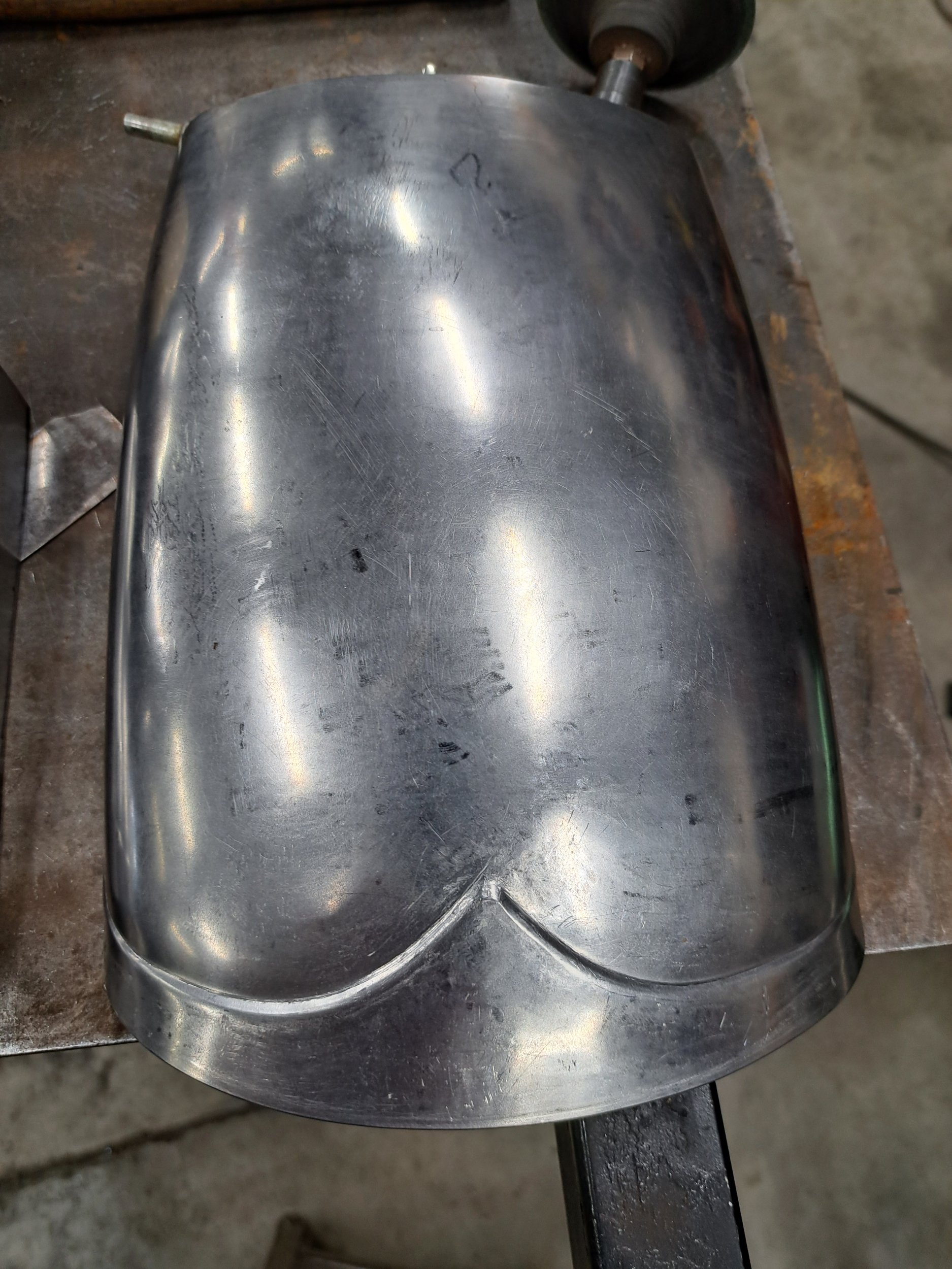

    I was at a local body shop to order some paint matching the state of Maryland's 1955 license plates for the one we're restoring for the wagon. The shop owner asked if I could make some patches for a step van that is in his shop for repairs.
    At some point in its life someone had made previous repairs, adding an aluminum cover to mask the rust beneath. He wanted some weld-in versions in steel.
    Some dies were made for the Lennox, using the same upper die but two different flavors for the bottom. One would have straight flanges top and bottom for the "rocker", and the other would have one 90* flange for a wheel arch and the outer door steps.
    Note in the above picture the lower die with flat flanges has the support wings cut about 3 degrees upward. With the forming that takes place a flat die would tend to have the flanges dropped slightly from a spring back effect. These upward supports help to counter any spring back effect and ensure the flanges are perfectly flat.. sample:
    Enough practice, here's a Video of the process:

    forgive my innocence--but when you run the curved pieces through the lennox to form that beautiful bead is there a tendency to shrink the o.d of the circle?-hope the ? makes sense...thanks
  20. MP&C
    Joined: Jan 11, 2008
    Posts: 2,574
    MP&C
    Yes, it does gather it up a bit and force the center of the opening upward. Kick shrinker to the rescue on the outer flange helps put it back where it belongs
