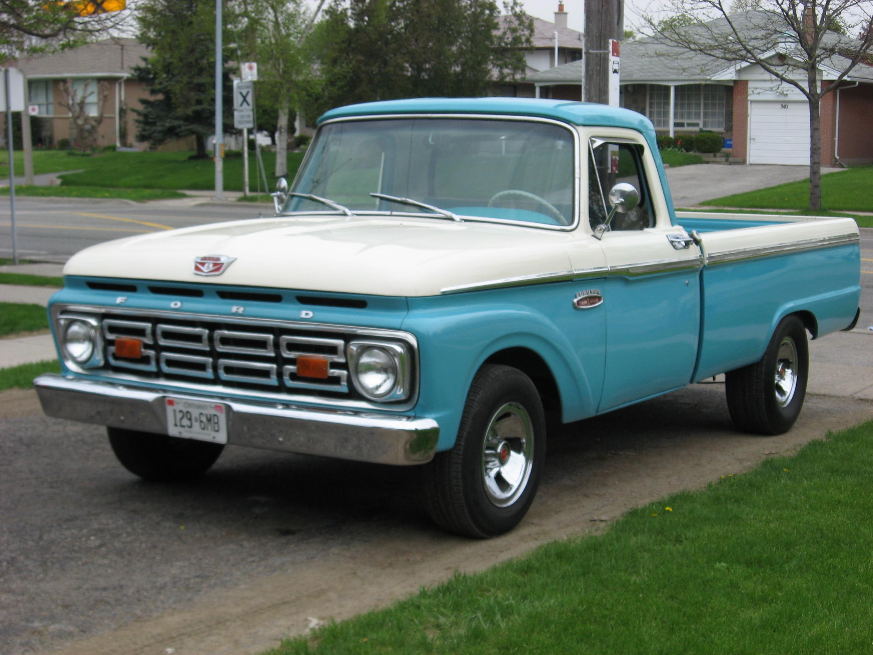

    My daily driver 63...

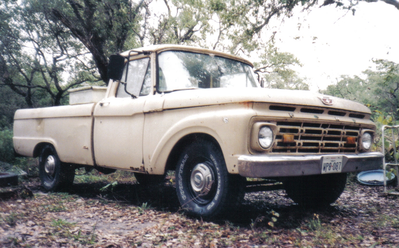

    A few pictures of my trusty F100. It served as a daily driver for over a year. I put on about 20,000 miles on it. It even started when it was 25 below although I had to keep the battery inside the house. Also for some weird reason the lights wouldn't come on until a few minutes after the truck was started when it was really cold. Driving home from work at 10 at night with 20-30 below temps outside for 20 miles was a very very cold ride. The heat didn't work worth a crap. I am repairing some of the issues before the snow flies, one of which is putting in a thermostat. My late model daily has been having transmission troubles so I want to make sure the ole beast is ready to go if need be.

    Oh Phil, How you pull at the heartstrings with that truck!
    I can't tell you how many camo'd Ford's of around that vintage used to run in this area.
    I see one occassionally now, but not nearly as much as I used to.
    Your heating probs could've been solved two ways...
    1) A hotter t'stat. Sometimes 5-10 degrees makes all the difference in the world.
    2) A "Winter Front". If you're unaware of that phrase it is the large vinyl "vest" seen covering the radiator on tractor-trailer rigs in the winter time.
    I have an import that had that problem, but I didn't have a hotter t'stat option, so I took some cardboard and cut it so it fit in front of the radiator (its a single core, so there's a little "ledge" for it to sit on), covering all but a couple of inches of the top (start off covering the bottom half of the radiator, and work with progressively larger pieces of cardboard until you get the desired effect. It may be that your truck only needs half the radiator covered).
    Worked like a champ. The temp gauge actually moved and I had enough heat (and defrost!) to make a difference. It came on much quicker, too.
    Truck never overheated because of it, either (at least during the winter months).
    I still have it sitting behind the back of the seat in that truck, just in case.
    Cover the cardboard with duct tape to keep the weather off it, otherwise it'll bend into a "U" shape and its effectiveness decreases greatly.

    Nice ride, Chickenwire. My favourite year. Camper Special?

    Thanks 6narow! It's just an all original Custom Cab, 292, 3 speed truck... I drive the crap outta her and it's just a great truck!

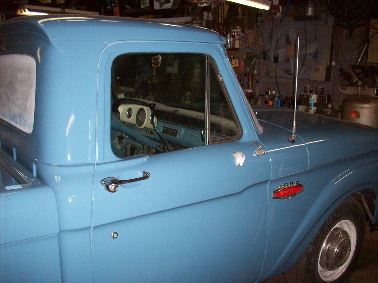

    Mine finally got paint last week.
