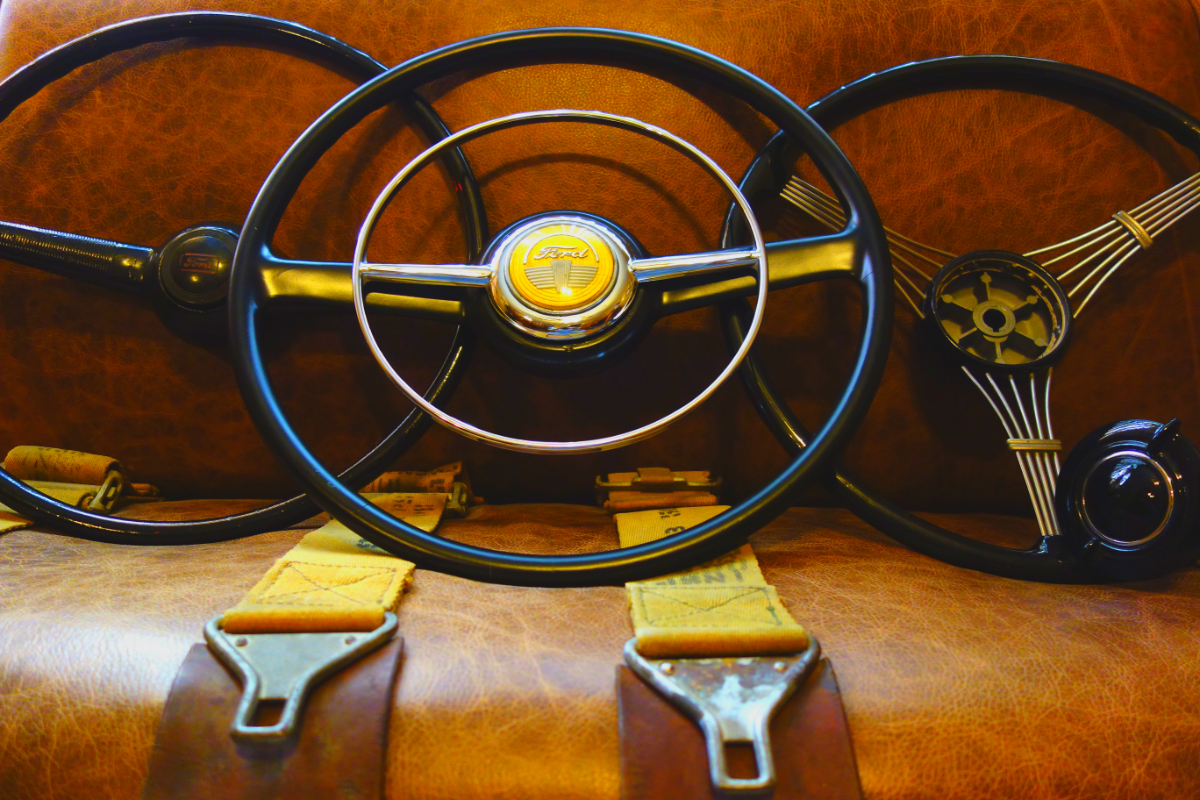

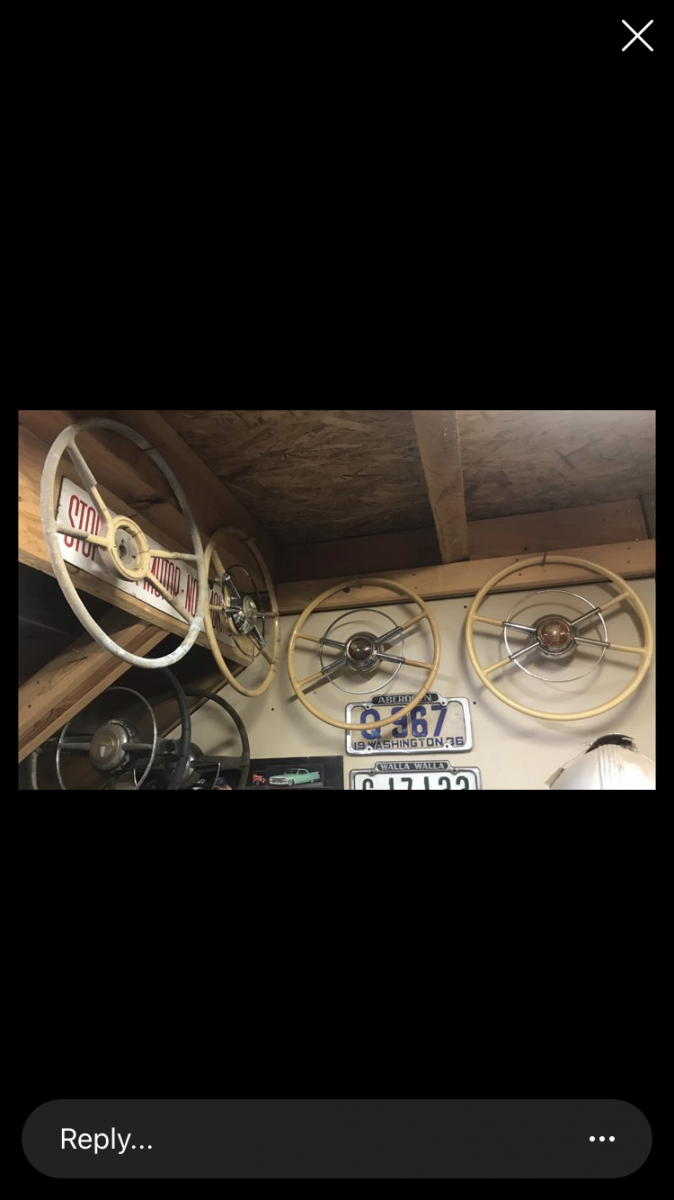

    Some of mine.

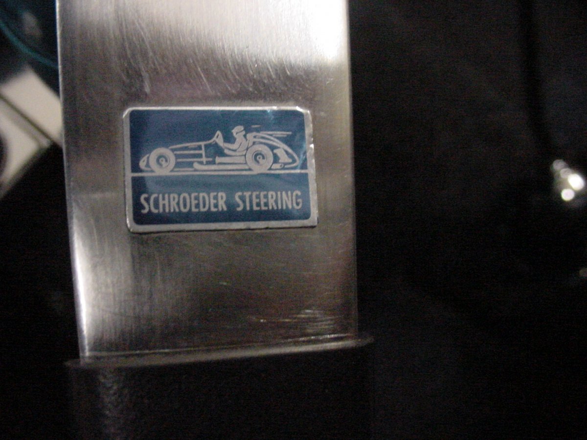

    Original Schroeder with tag DSC00785.JPG DSC00784.JPG !

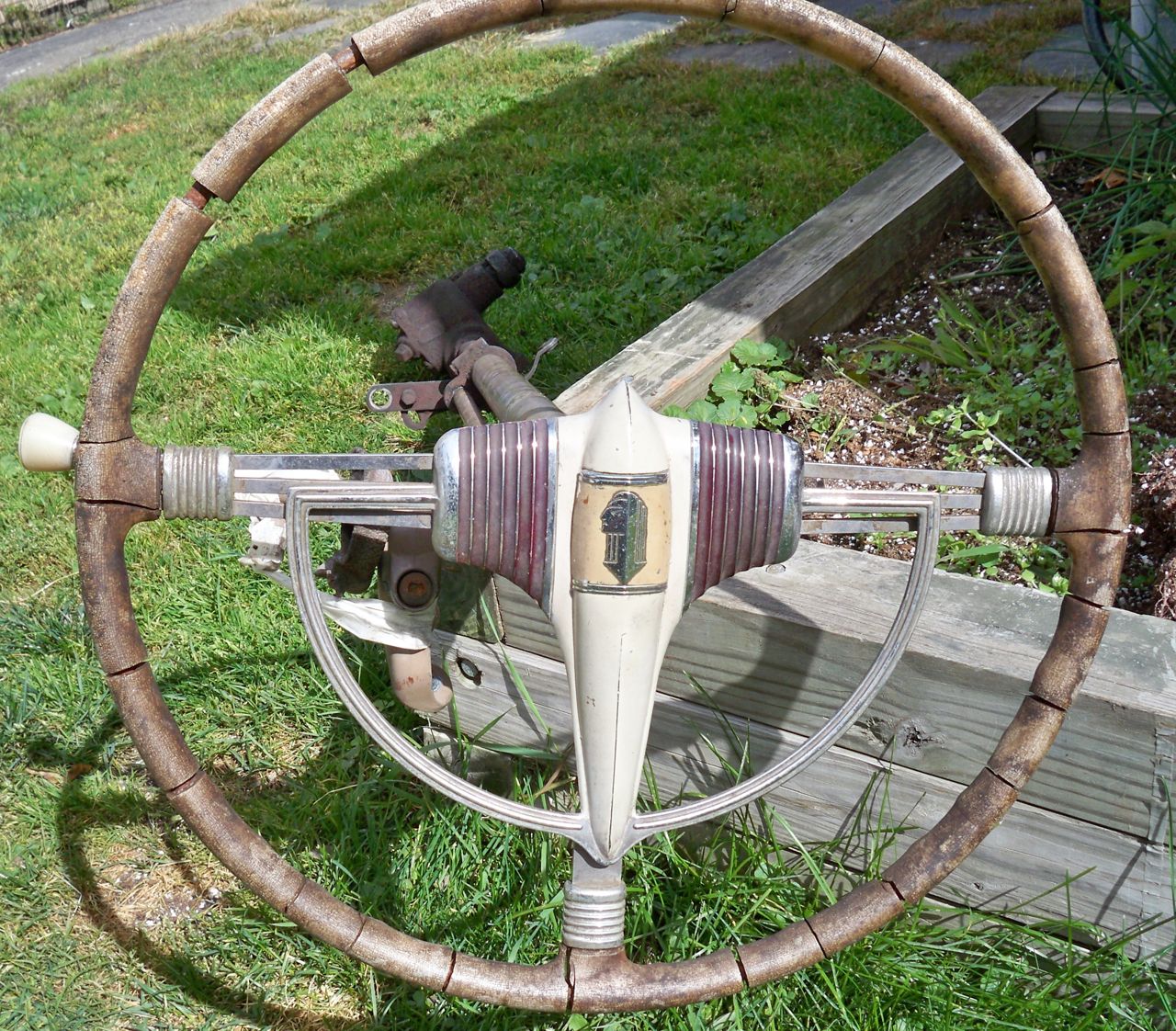

    IMG_5045.JPG Some files, sandpaper, JB Weld, and Rustoleum Appliance White and my best worst Merc wheel is almost ready to be installed !!!

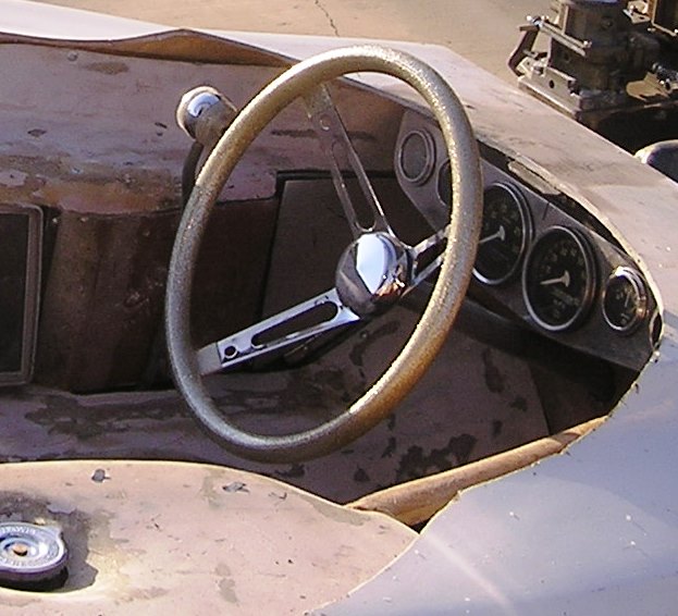

    I needed a vintage Cragar steering wheel for my Mysterion clone but they aren't made any longer and I have never seen one show up on ebaY. I solved the problem by getting a Moon 4-holer and cutting out the web between 3 holes with a slitting disk on my 4 1/2" grinder.
    Ed's wheel
    Cragar wheel next to mock up of Ed's wheel. Looked like it would work.
    Wheel ready to cut.
    Result.

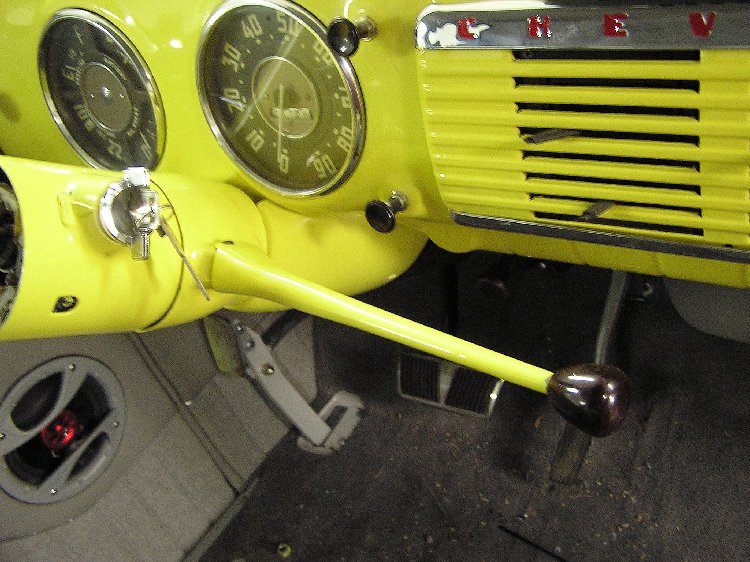

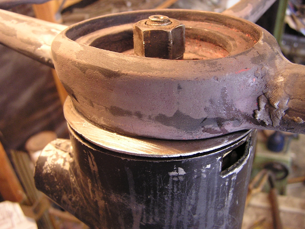

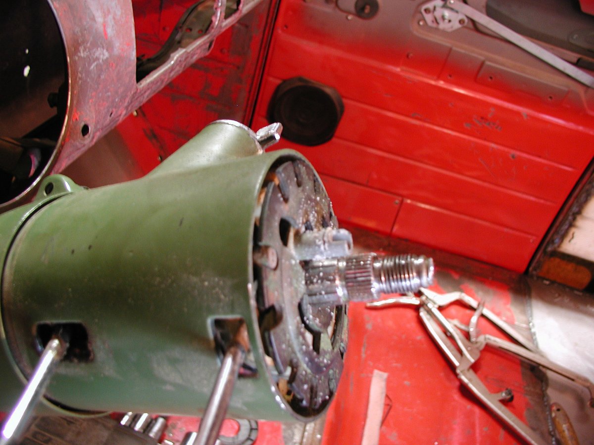

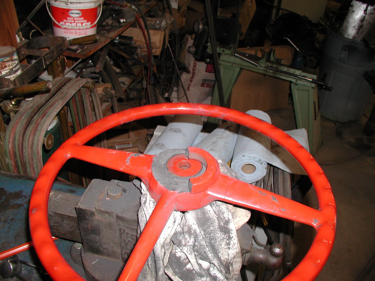

    Another oddball wheel problem I faced. I wanted a late model tilt steering column for my '53 Chevy truck build but since the theme was a 'factory stock' king cab I wanted the '53 wheel and 3-on-the-tree shifter. I discovered that the splines on the tilt shaft and in the old wheel were identical. All I had to do was cut off some of the bakelite on the old wheel, cut a sheet metal disk to bonso to the wheel to transition to the round shape of the new column and they matched up great. Horn ****on p***-through hole was even in the right place.
    For the shifter, I just cut off the late model knob, ground the shaft to a taper that slit up into the old shift handle and filed the tilt column rivet boss until the old shift handle rivet holes lined up. The slipped the handle over the shaft and install the rivet.

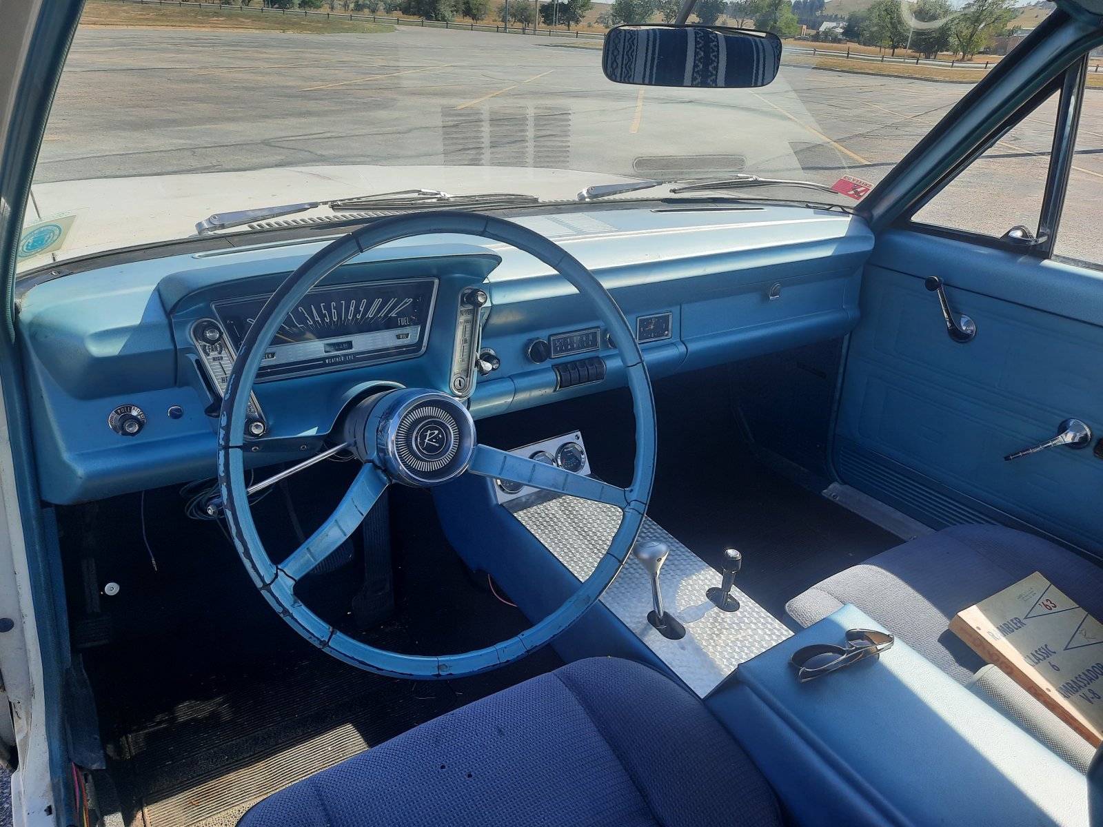

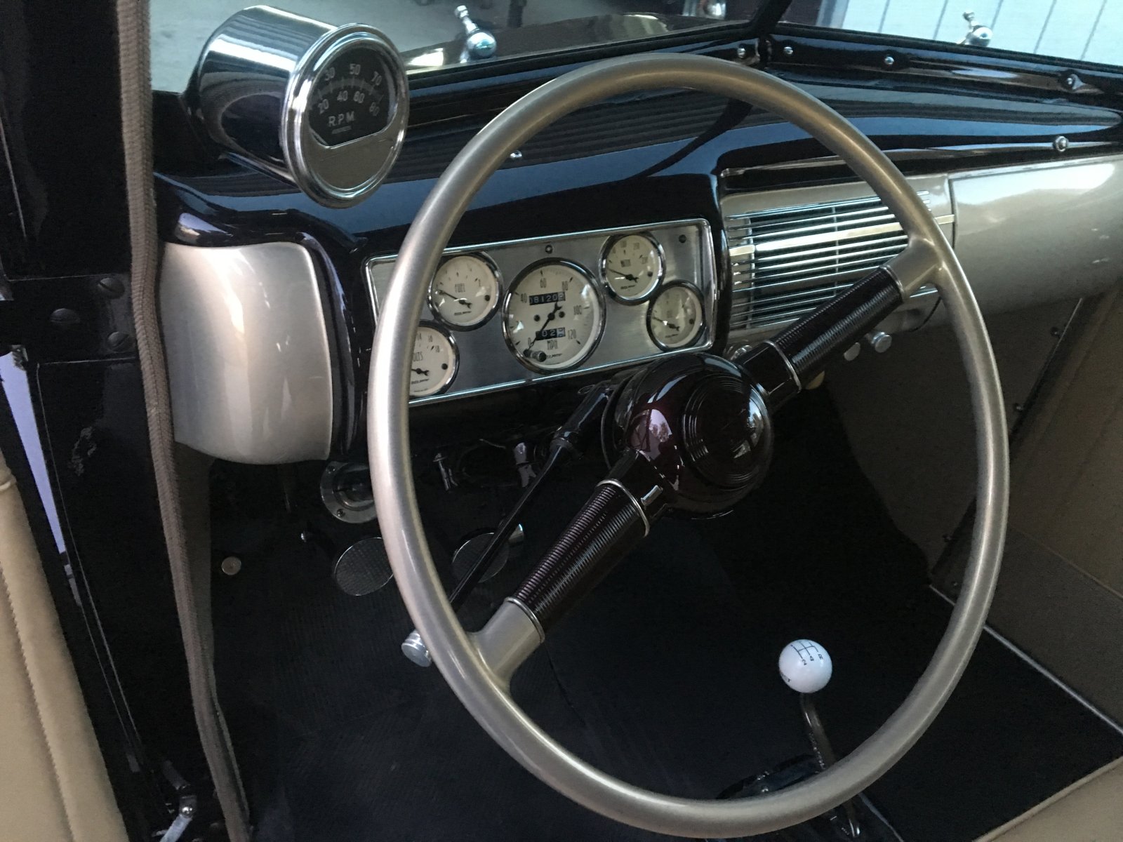

    There are only two traditional hot rod steering wheels for Fords in my opinion. The 40 deluxe wheel is in my 40. The 39 deluxe is in my roadster/avatar. IMG_3138.JPG IMG_3784.JPG
