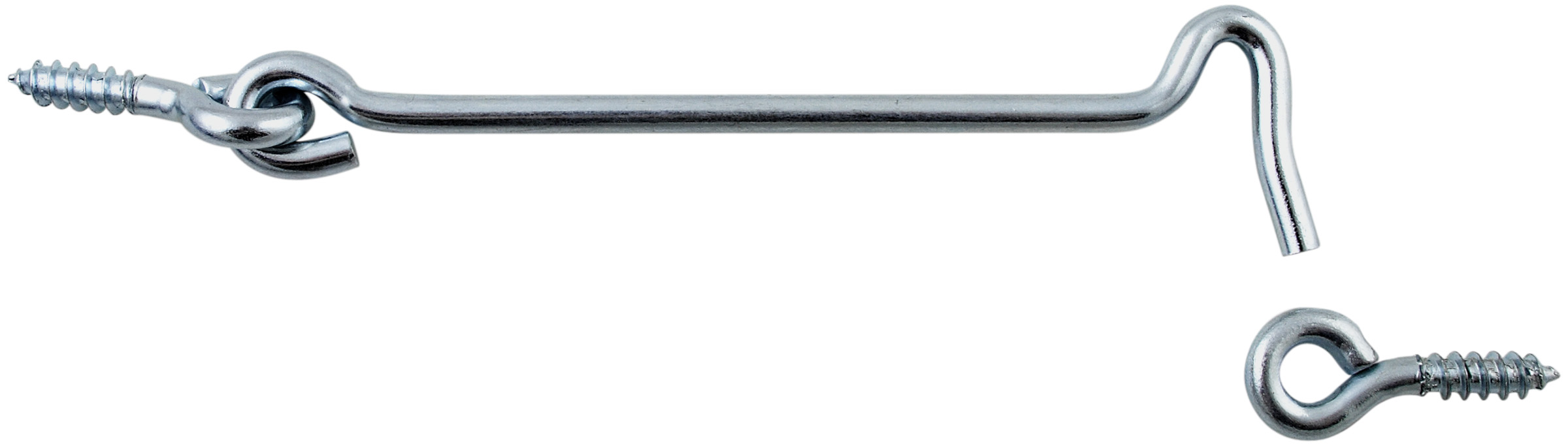

  2. Okay.
      150.3 KB
      417
    dan31 likes this.
