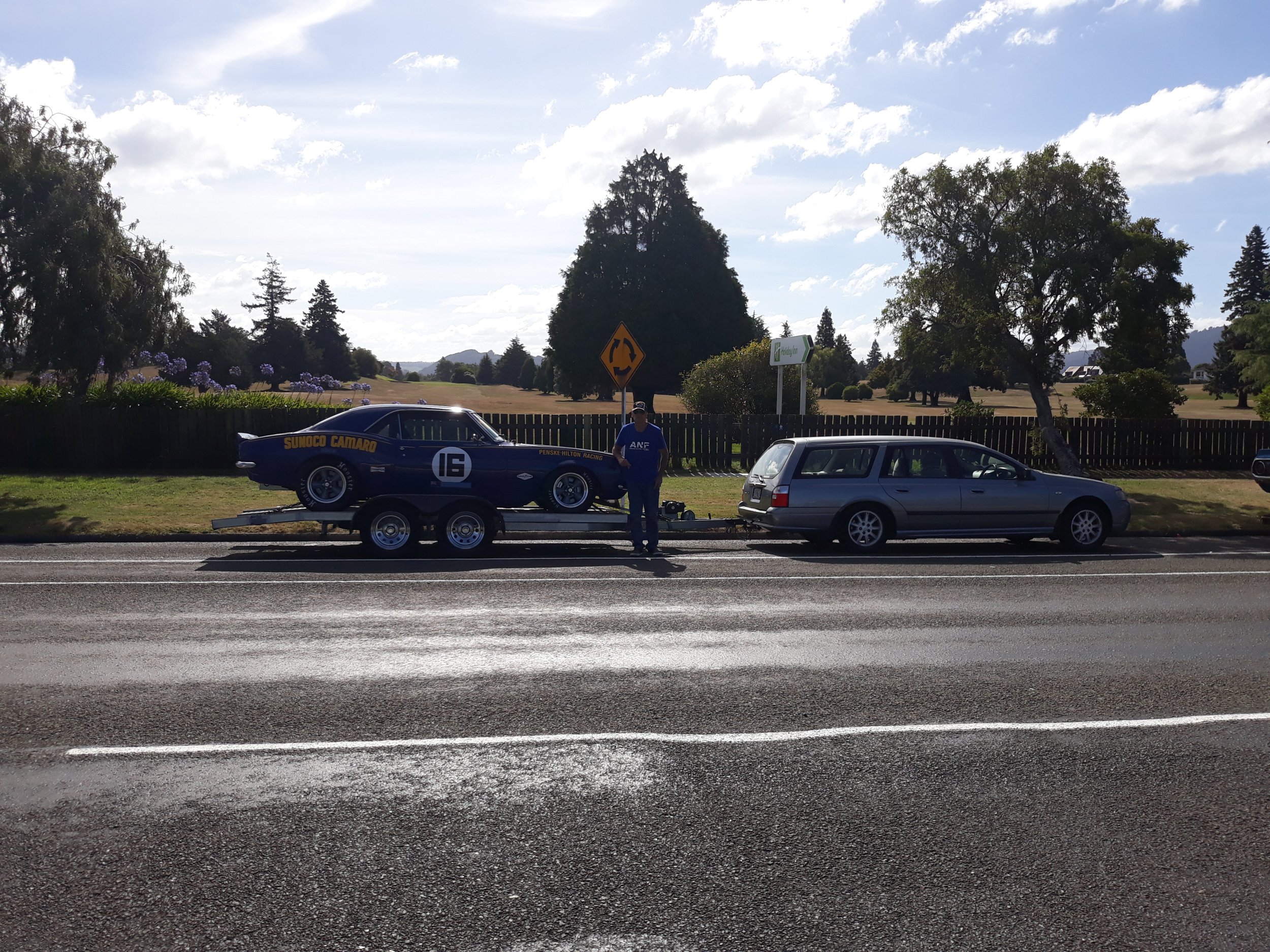

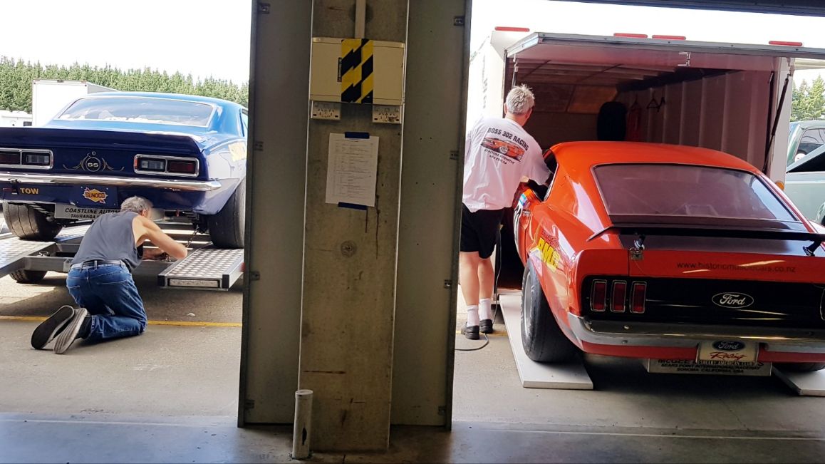

    WRONG!!!!! If you can legally drive it to the track , it is not a real race car
    Here is 2 bothers [the rich Ford guy with his enclosed trailer , and the poor broken ***ed Chevy guy with an open trailer]
    Unfortunately this trailer eventually got stolen and wrecked within 2 hours [the GPS found caught the thief red-handed chopping it up]
    Here is my high dollar tow rig [an Aussie Ford Falcon] I prefer SW's because I can leave my equipment locked inside when I am driving around "in-circles"
    The trailer only weighs 1430 lbs [650 kg] I can built full deck trailers that weigh less

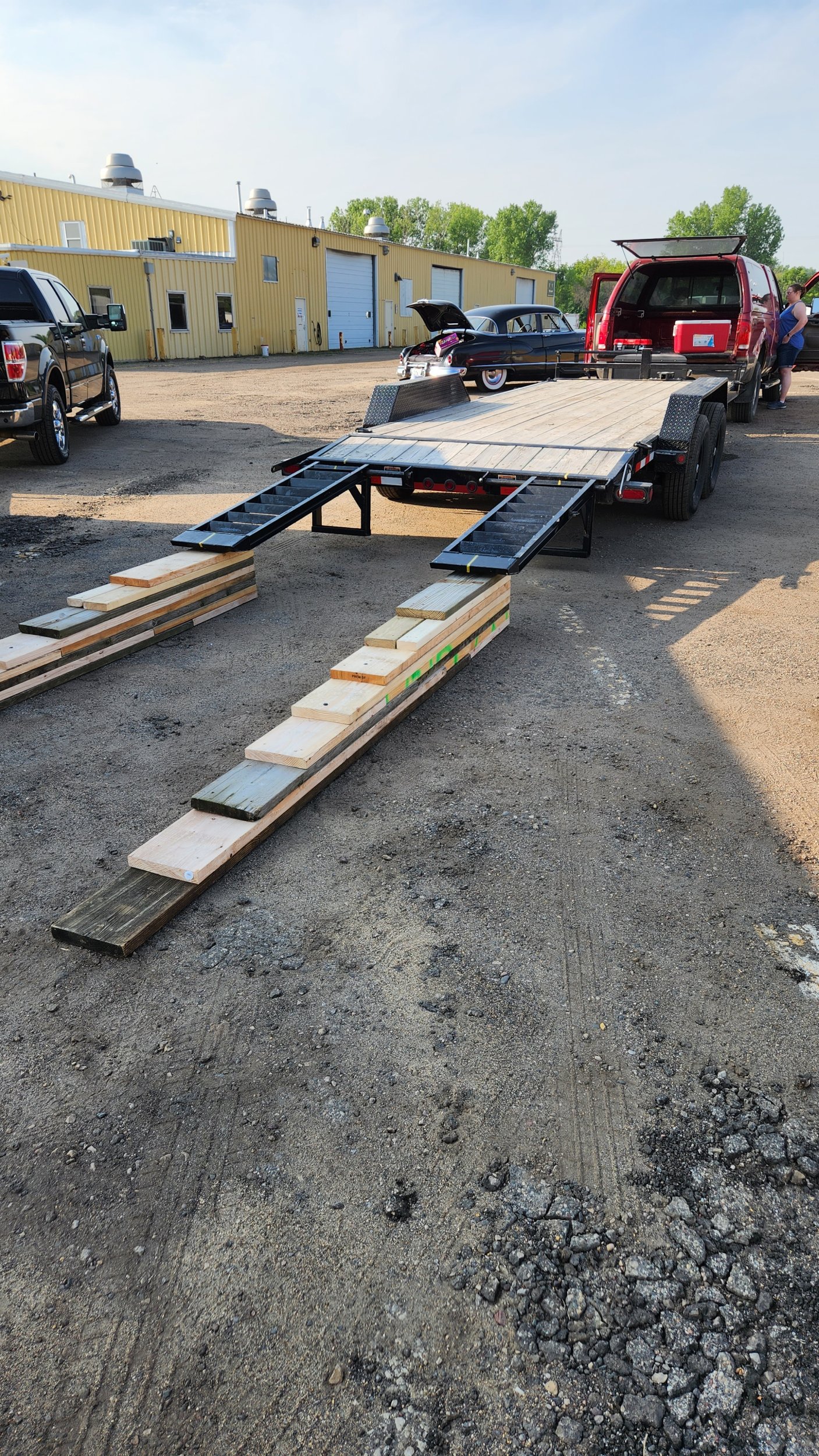

    I prefer to haul using this equipment trailer, eventually I'll make some longer ramps for it.

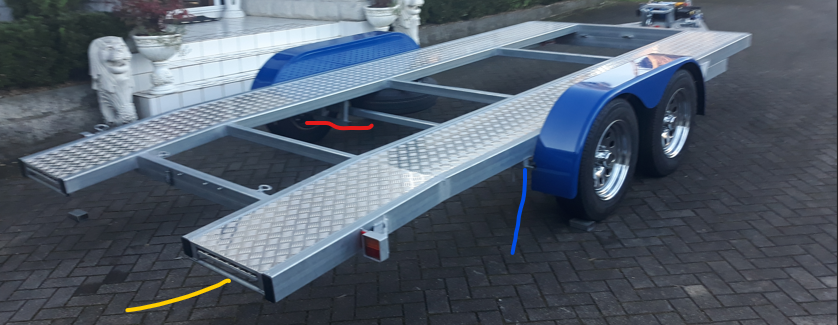

    What you described is a very simple solution to an issue .it is not that difficult to carry some blocks of wood around [I did that for years]
    Many years ago ,I was at a race meeting and a friend let his wife take his tow vehicle into town.
    When she returned they never hitched the trailer on properly [not even safety chains]
    When Peter drove his racecar onto the trailer [aggressively due to slippery ramps] his son was standing beside the hitch giving instructions.
    The coupler came flying up and smacked him in the jaw [breaking his jaw]
    If he had blocks of wood under the rear of his trailer this would have never happened
    I try to learn from other people's mistakes [and not make my own] so I have built slide out ramps with built in height limiters that do the same job as your wooden blocks.
    These slide in with the ramps and stop just shy of the axle beam [which protects them from road damage]
    The blue line is a "striker" to latch the ramps. they needed to be that long because the ramp slides behind the rear wheels
    You can see the height limiters below [red] and the striker is retained by a lateral springbolt [blue]
    The striker and the ramp straddle each side of a bar [yellow] this bar only supports the weight of the ramps when hanging. Any load bearing weight on the trailer is directly down on the top side of the ramp [to the ground]
    The ramps cannot be pulled out and lost. To remove them I have to slide them forward and out. [by unbolting the slide drawers]
    99% of loading issues or tiedown issue are always caused by "helpers" and "hanger-ons" so I made my trailers so I can load it in less than 1 minute by myself [I now only go to the track with my wife and she can relax, instead of being screamed at when things go wrong]
    All my tie-downs are pre cut for each specific vehicle [they are dirt cheap and I sew them myself]

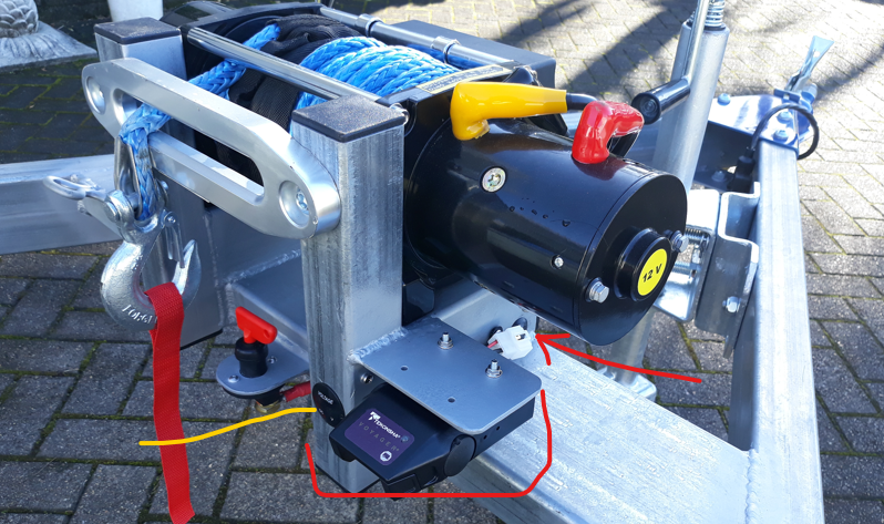

    @rod1
    Here is another trick [you cant do in the USA because of your tow vehicle turn signals]
    I was buying brake controllers from our local U-pull for $5 NZD [USD $3] so I pre-wired my trailer for an extra controller [if I swap tow vehicles]
    This is powered by the winch battery but requires the lights to be switched on so a relay activates the controller.
    Normally I never use this [I prefer the in-cab controller] so I unplug it and leave it in my toolbox.
    The yellow is a voltmeter beside the winch master on/off switch
    This winch was turned around 180° to pull off the top. [I wanted the low height, so the tongue can roll under the trailer in storage]

    some US vehicles have the separate brake light bulbs to make that work. The same thing can be done using 2 relays on the rest. Use one turn signal to trigger relay #1 and the power source comes from the trailer battery and the lead goes to the number 2 relay source. The other side turn signal can then trigger that relay sending power on to the brakes. Great in a pinch but just not the same as a real brake controller. I’ve done a lot of poor man work around a growing up. I just hope I’m done rigging brakes and strapping up flats.
    Edit: the brakes will pulse if one of the turn signals is on, but it still helps stop the trailer

    We have separate Amber turn signals to the stoplights on trailers AND tow vehicles
    So it is easier to wire in
    Our wiring is [This is universal outside North America ]
    Red = Stoplights
    Brown = Taillights
    Yellow = Left Turn
    Green = Right Turn
    White = Ground
    Blue = Electric Brakes
    Black = 12v Accessory
    All I do is splice a signal wire into the red stoplight wire [the turn signals don't pulse the brakes] And the relay signal to power the controller is spliced into the taillight wire.
    And Tee the controller brakes to the existing electric brake wire
