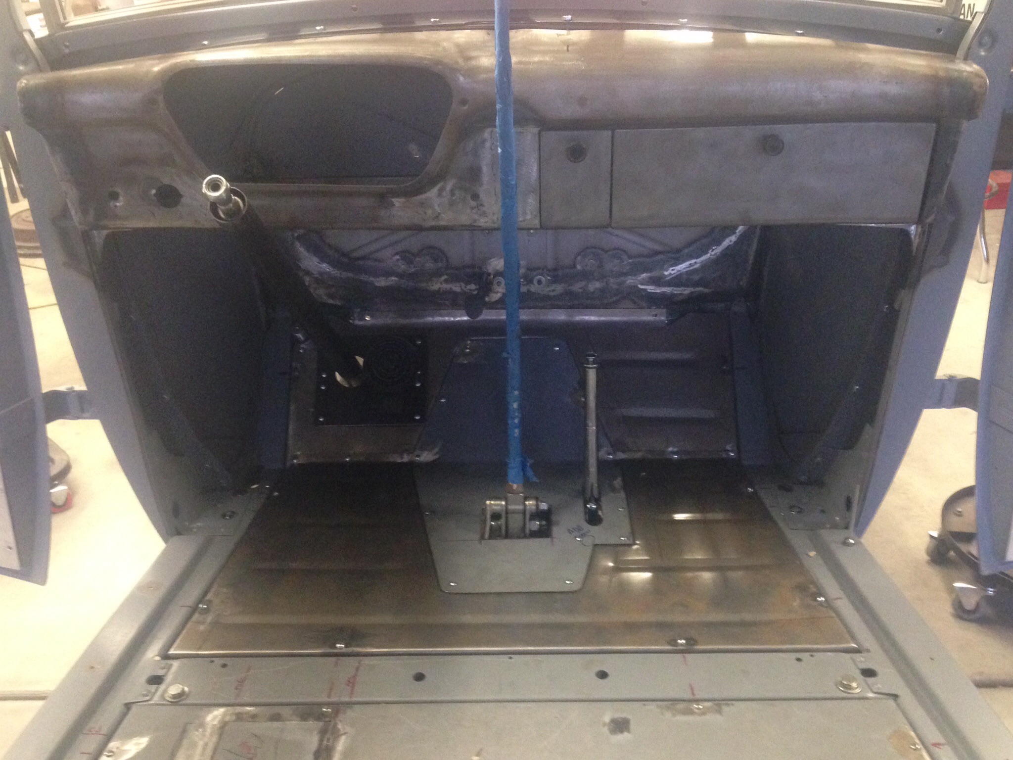

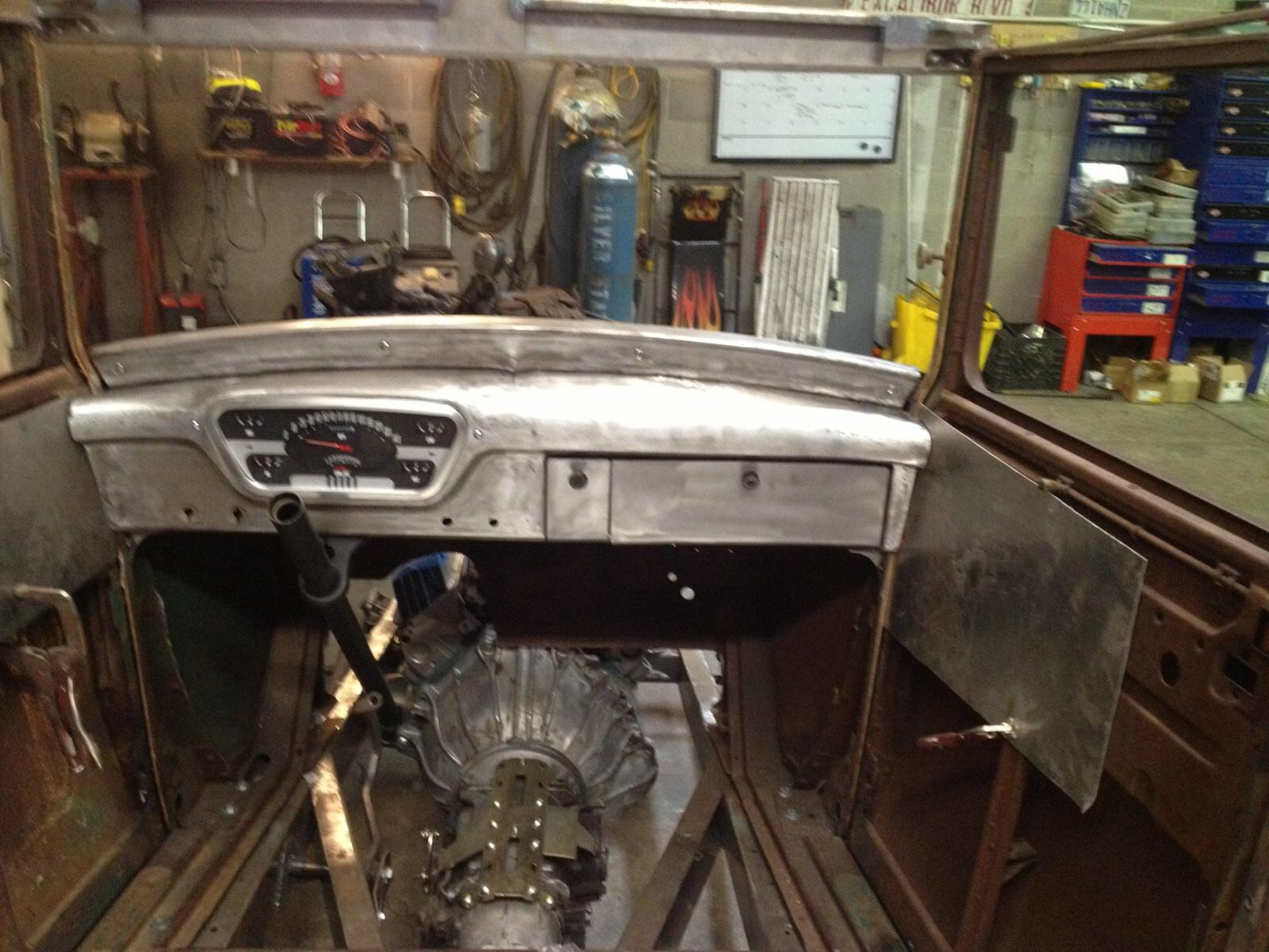

    Here are some from a '28 truck I'm building for a customer. I'm not sure if this dash will make in into the final product, but I'm kinda liking it. It started out as a '41 ford dash. And before yall start yelling I didn't pick the wheel, column or the steer clear unit. This is a customer cars not mine!! the glove box is shortened about one inch and the majority was sectioned from the center. The ashtray is still stock size but welded shut to be used as a mount for the HVAC controls. Keith
