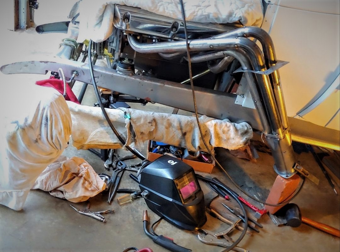

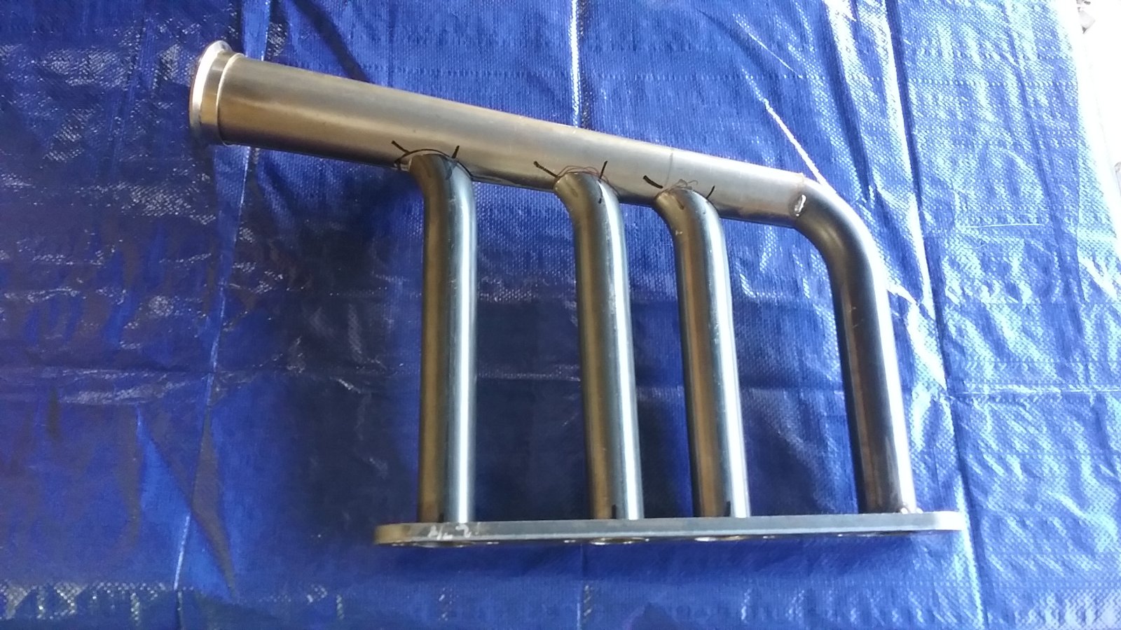

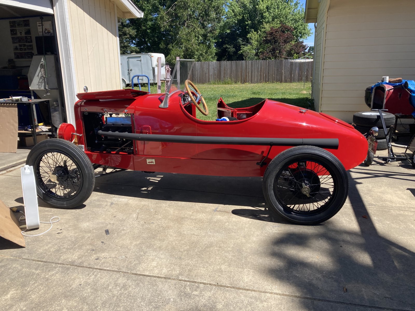

    314299C8-9B58-4F24-AF53-EE743D1B4C06.jpeg EAA2BA55-84E2-4D2D-A380-E5B57507B97F.jpeg B1961621-5B39-432C-8D7E-C08EE1C8FC95.jpeg 314299C8-9B58-4F24-AF53-EE743D1B4C06.jpeg EAA2BA55-84E2-4D2D-A380-E5B57507B97F.jpeg B1961621-5B39-432C-8D7E-C08EE1C8FC95.jpeg Here is what I made for my Mercury Speedster
    andy

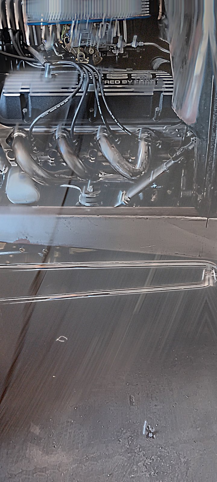

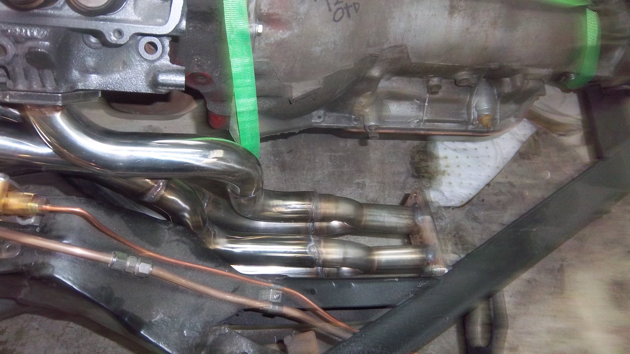

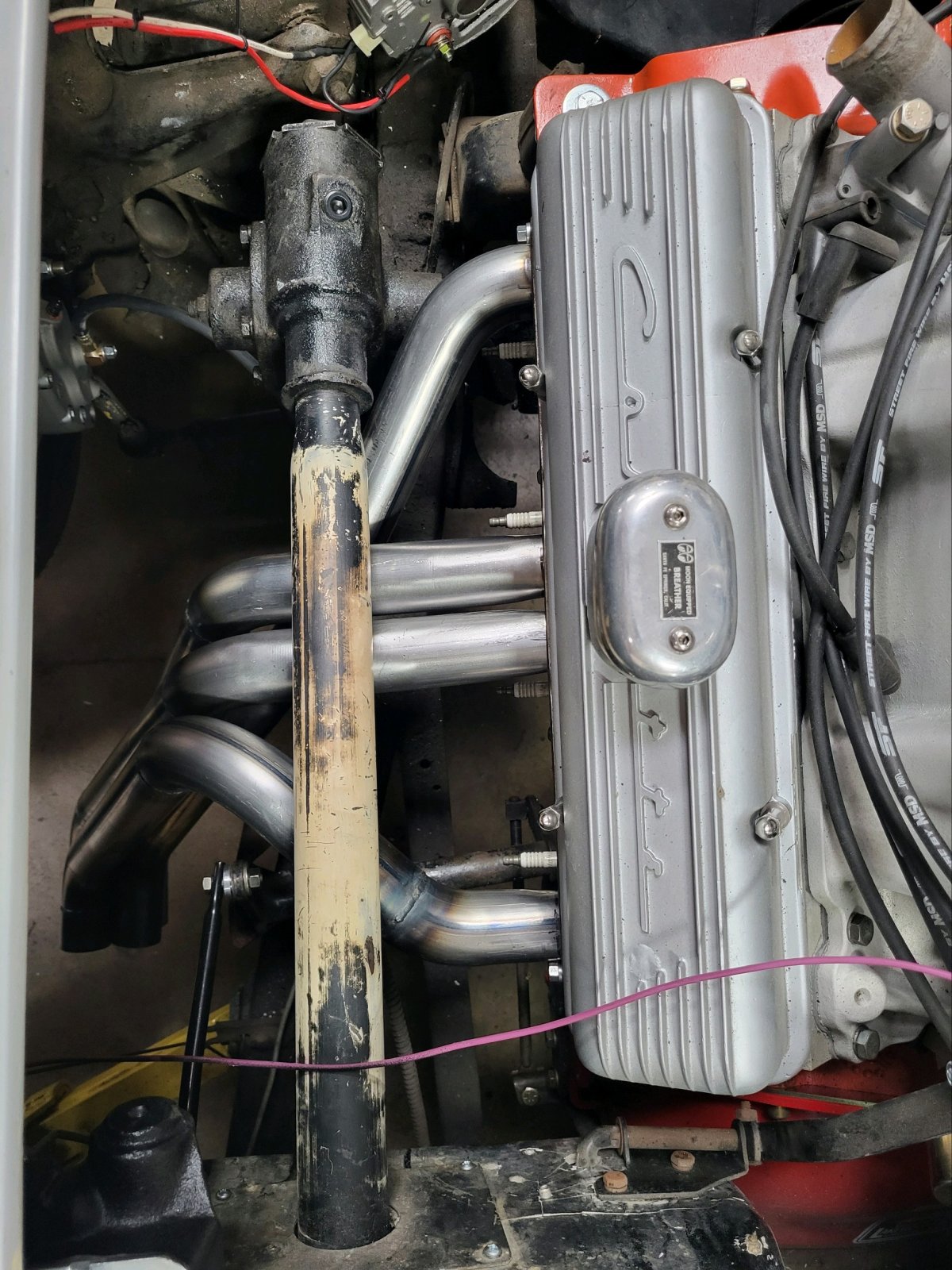

    20231130_084822.jpg 20231130_084833.jpg 20240722_120320.jpg 20240722_120340.jpg Small block Ford in a model A

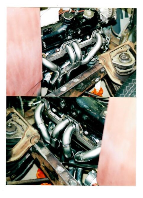

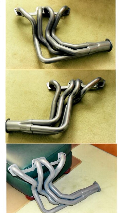

    Pictures of pictures so the picture quality and clarity are not great. These were my first headers made for a 37' Dodge pickup with 340. What a blast to fabricate but the best part for me was having Russ Meeks (very kindly) tell me they were the best fabricated headers he had ever seen from a someone not tied to the business.
    First 2 pictures are during fabrication. The last are of completed headers and one with coating.
    Thanks for your help Russ!

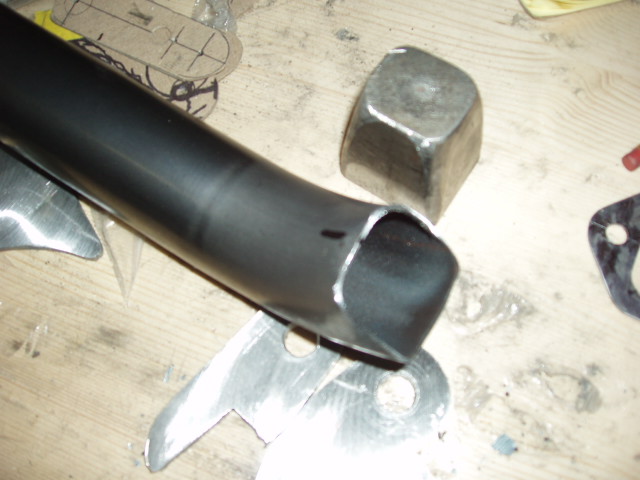

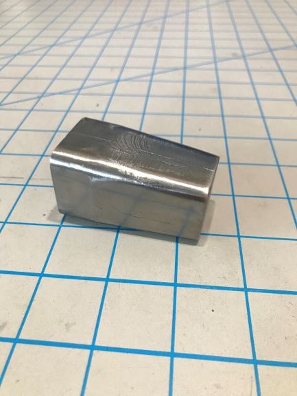

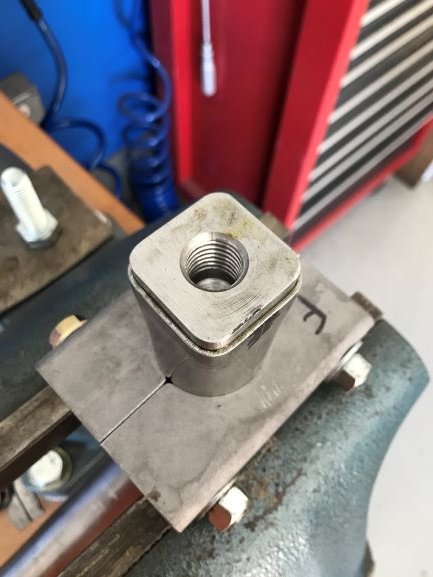

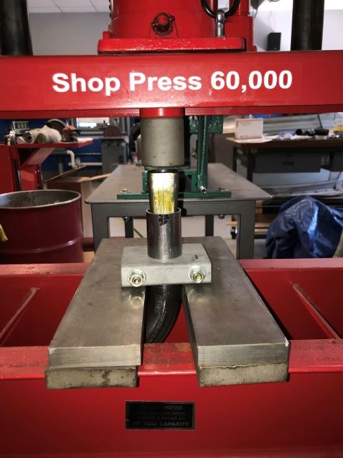

    The wedge I used about 50 years ago. I just drove it into 18 gauge tubing with a B F H. I did not use a wedge on the 16 gauge tubing I am using on the 365 Cadillac engine. I just hammered the ends 2024-07-24 10.07.49.jpg square. I did not want to enlarge the end.

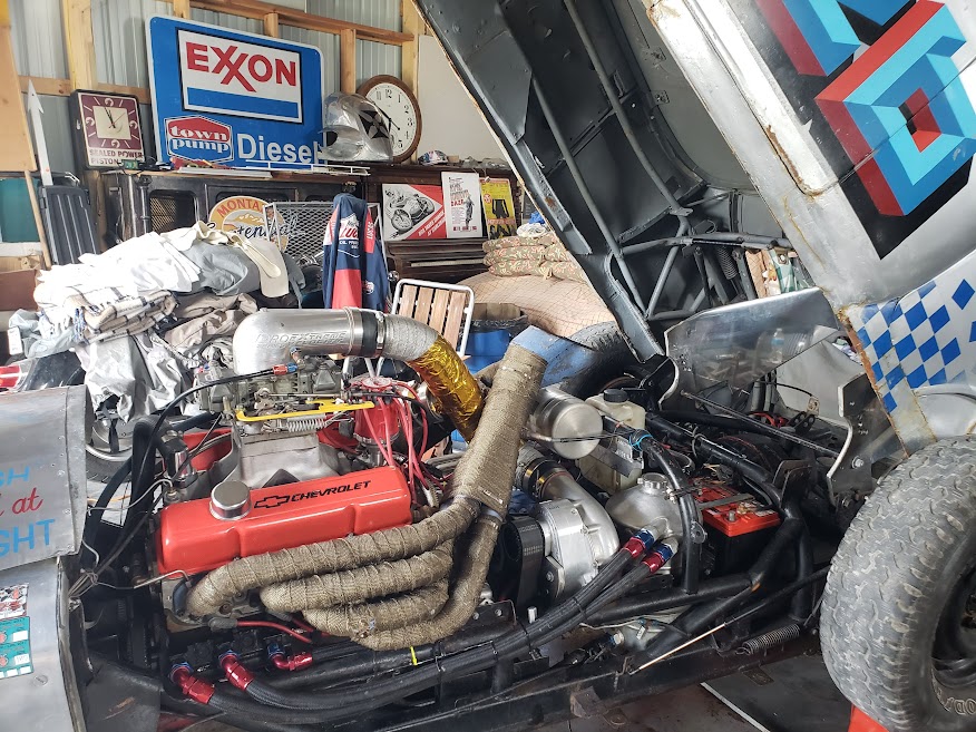

    304.jpg Left side in our D/BGRMR Bonneville car. 350 sbc bored .020 over and destroked to 304 (to be under 305.9 D cl***)

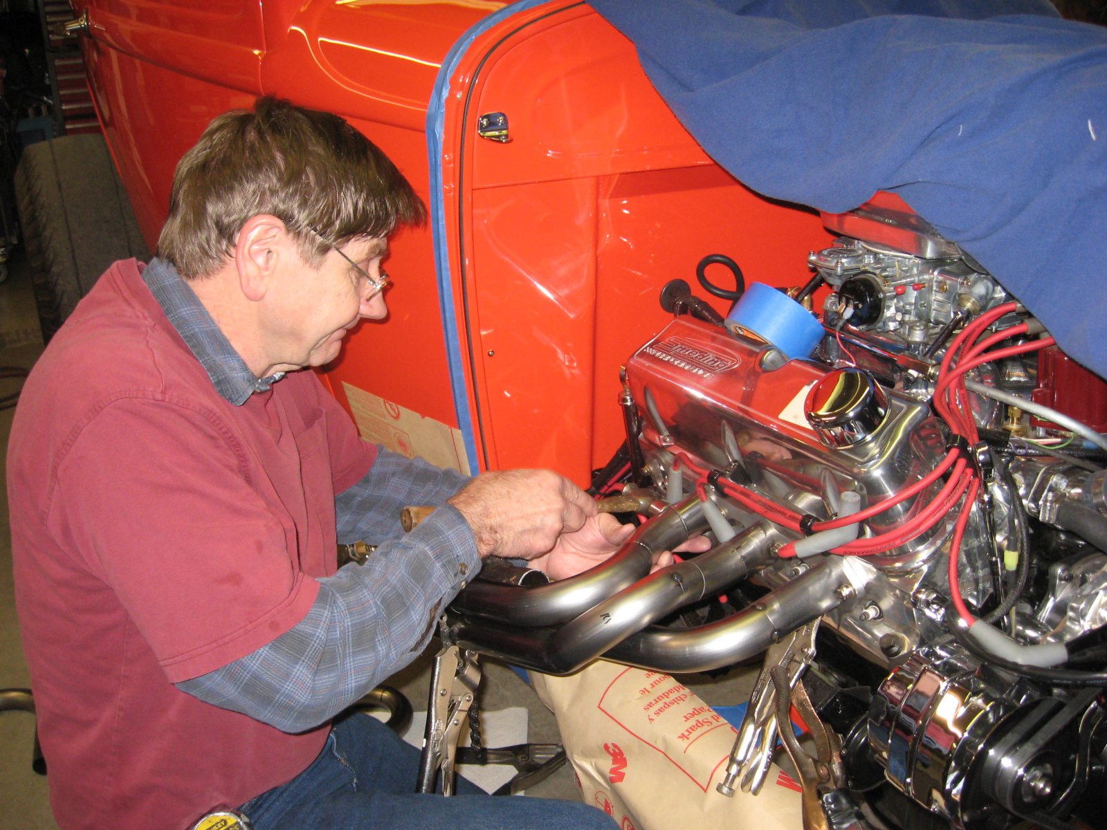

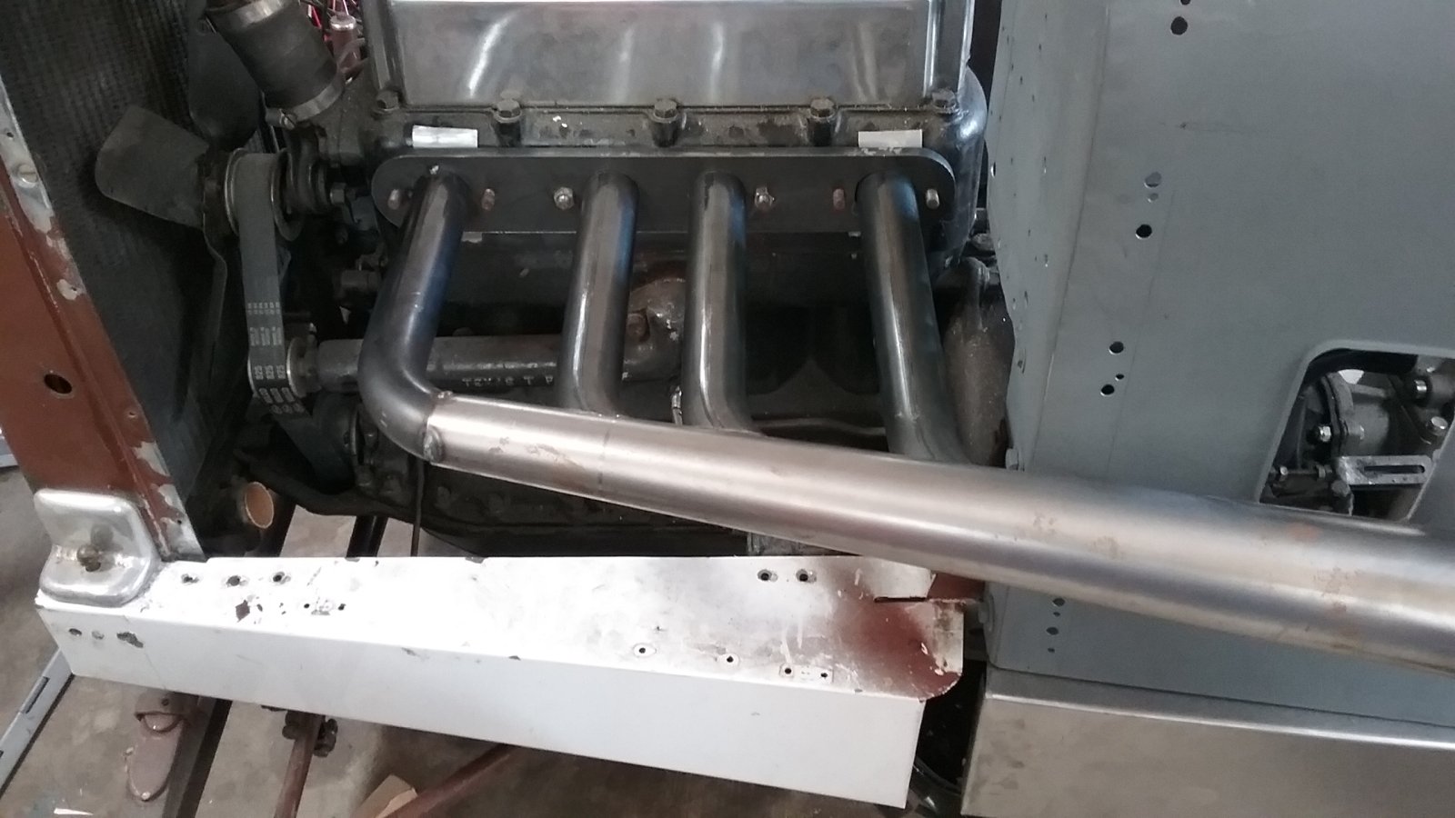

    I built this first set for a buddy Jimmy's 32 sedan, 392" Windsor. Then I built a set of outside ones for a Model A with a Hemi. Well, Jimmy just had to have a set like that, so I built these. IMG_0856.JPG IMG_0860.JPG IMG_2820.JPG IMG_2821.JPG IMG_2826.JPG IMG_2844.JPG IMG_3285.JPG

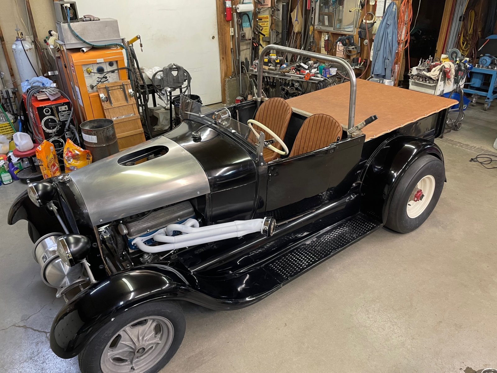

    Picked up some flanges and bends at Headers by Ed's shop along with 4" truck stack parts and built some pipes for a T bucket I built a while back. Later my son acquired them from a later owner and used them on his T bucket with different mufflers.

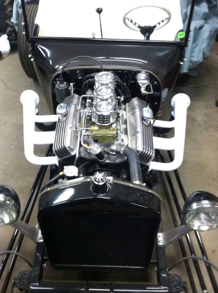

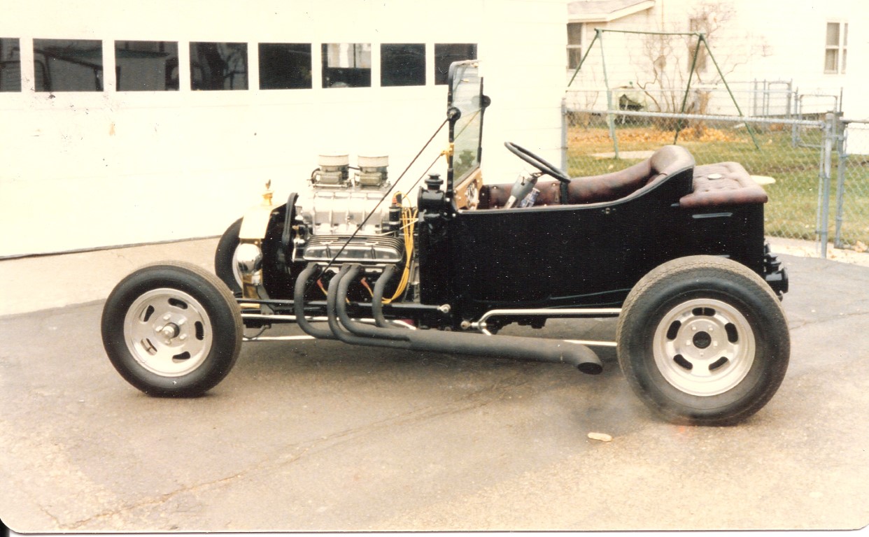

    Made a set of lake style headers using flanges and cones from Speedway for another T-bucket I had.

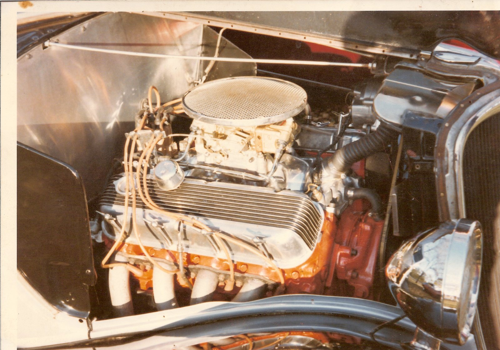

    I almost forgot to add the headers I built for the 396 in my friend's '29 cabriolet; lon long ago. More Headers by Ed's parts.

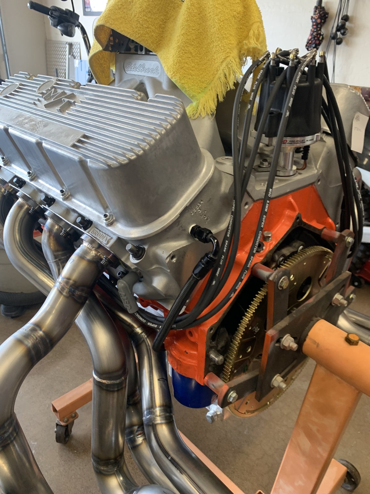

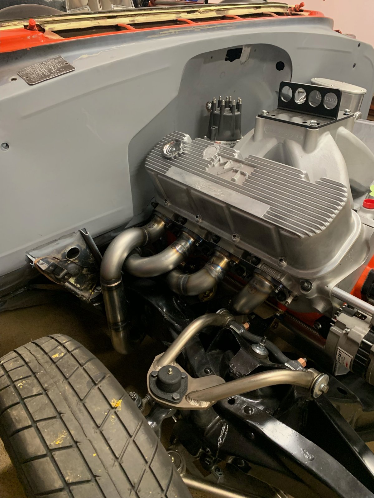

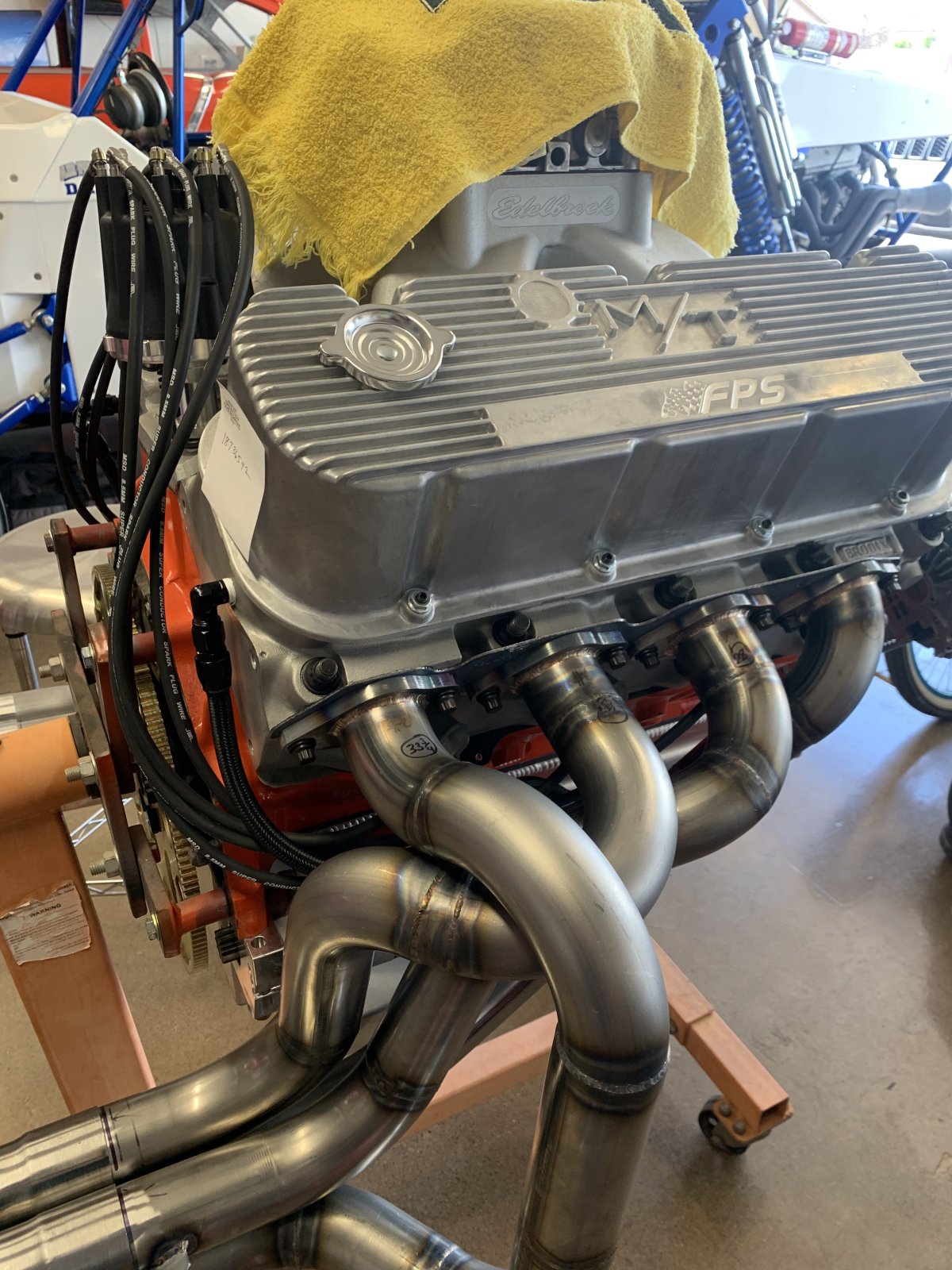

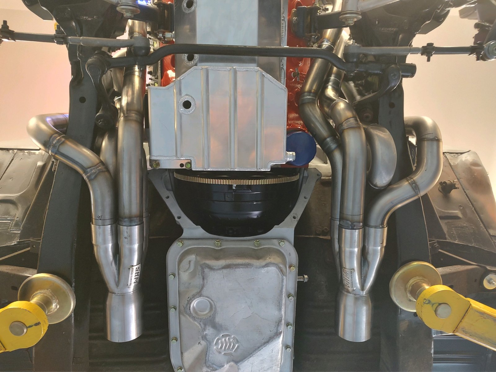

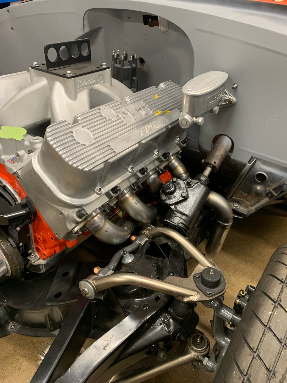

  21. @RatPwrd built these for my buddy’s 56 Sedan, BBC with raised exhaust port heads. 2-1/8” stepped to 2-1/4” primaries. Steering box was angle milled for more clearance but #5 had to be m***aged to fit and #7 & #8 had to snake over the outside of the frame rails to fit under the inner fenders. Everything ended up under the car and above the bottom of the frame. He said they were one of the hardest set of headers he ever built. Absolute works of metal art!
    6B854948-FB4A-4FE3-A6DA-AD180F4706FB.jpeg A306C9CD-07E4-423D-8F1D-643C382D2F78.jpeg 76D51E87-3CF0-42E3-BCC7-300BFE6B6939.jpeg 52FC2D0D-D6B3-432E-A59E-497B75053A5D.jpeg 75EA05DA-3434-44FE-8B5E-D9FB1A641213.jpeg
    Now they’re getting coated, almost a shame to cover up all those beautiful welds!

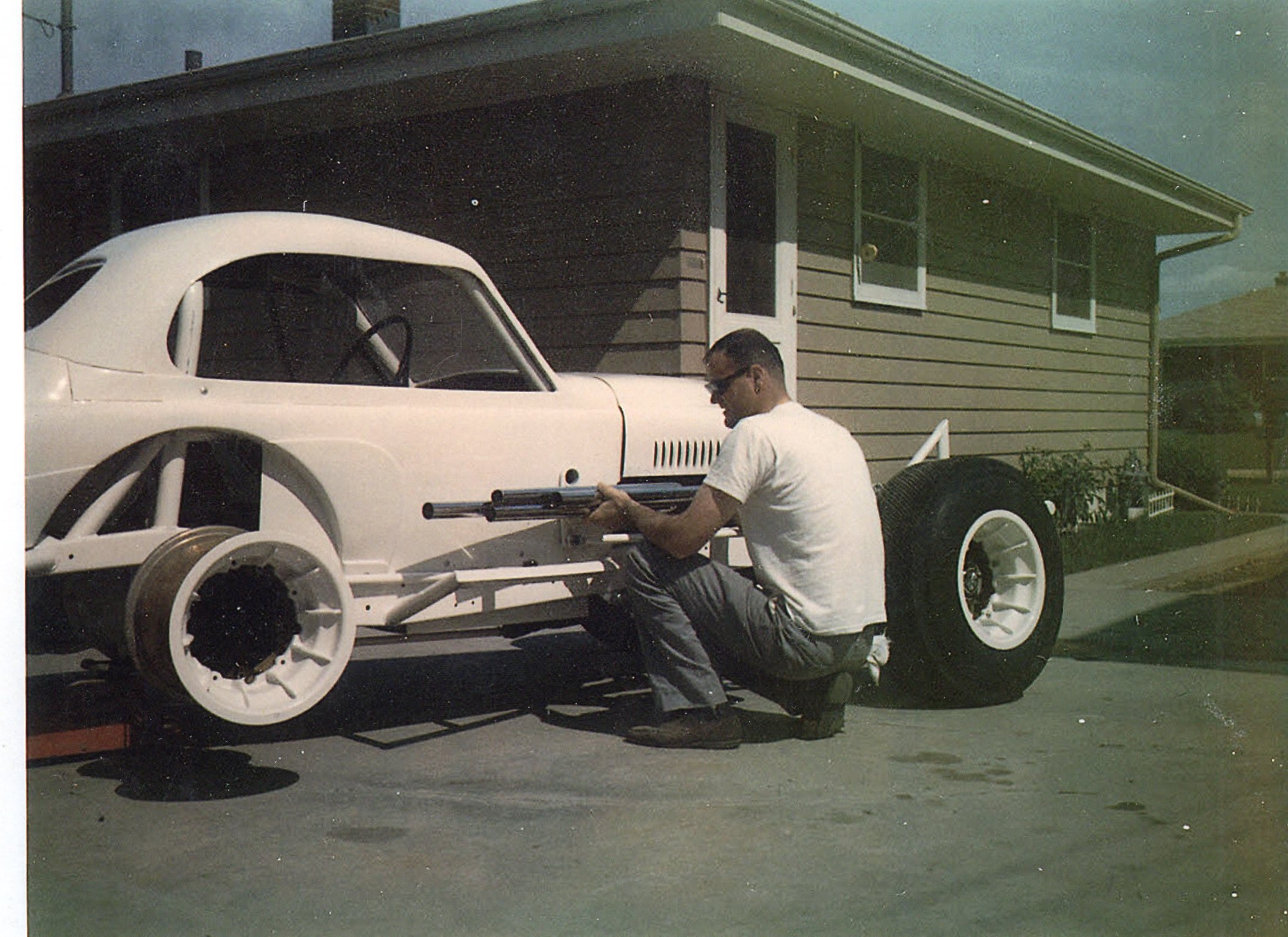

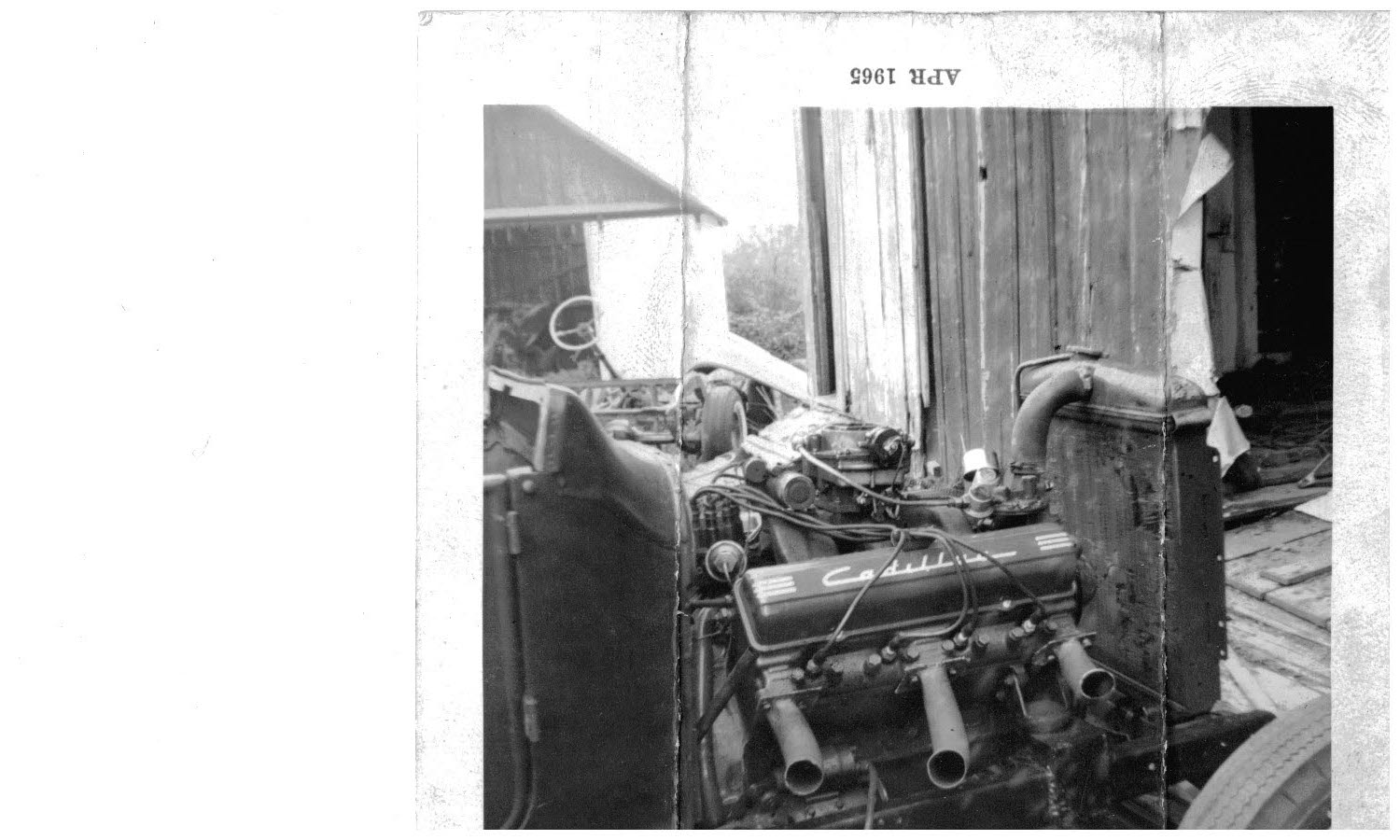

    My first set of headers. 1963. E W R A rules. No engines later than 1952. Don't remember how I got 4 pipes on 3 port 52 Olds heads. img077.jpg .

    They look chrome plated !

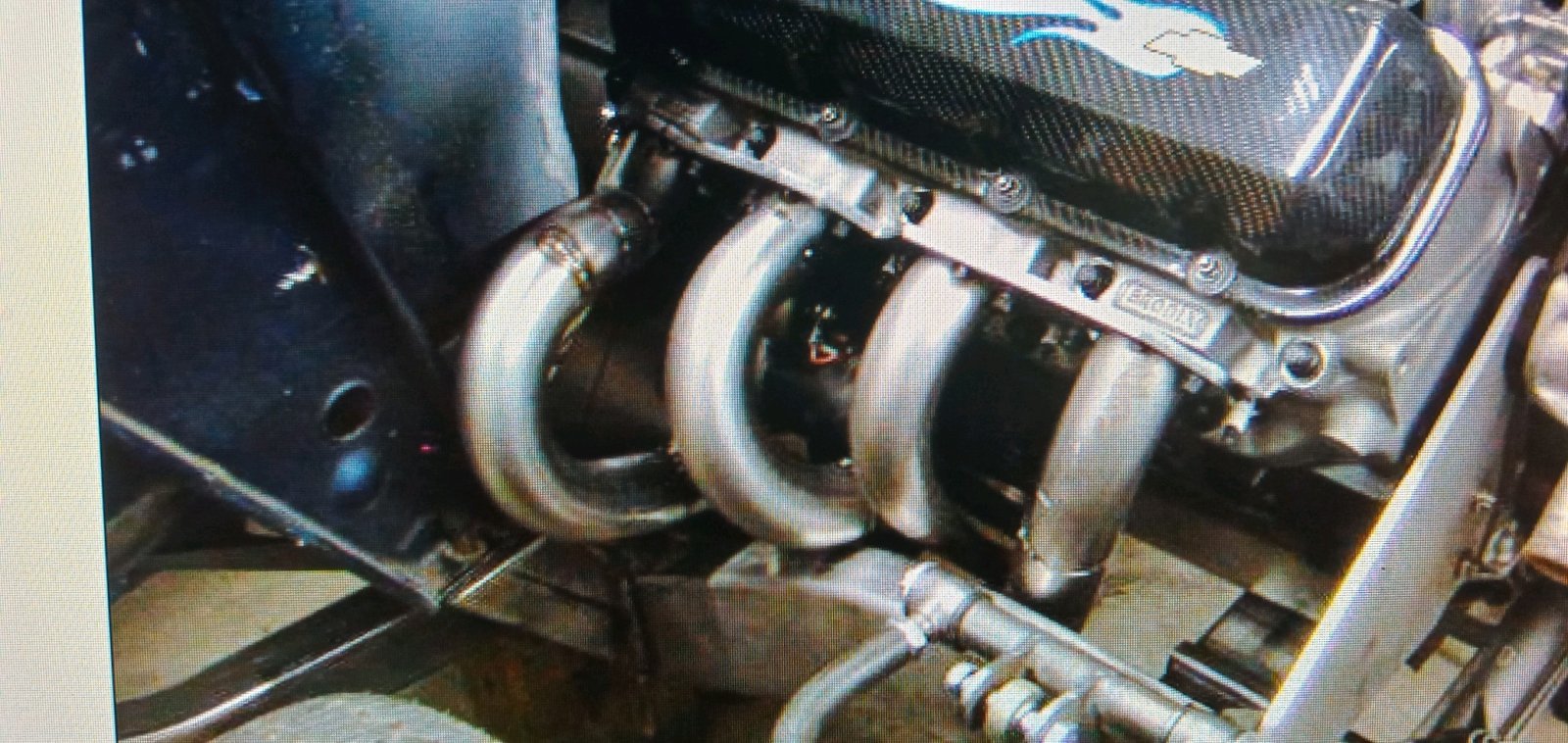

    Nothing fancy compared to some of these beauties, but 2" primaries on my 552".

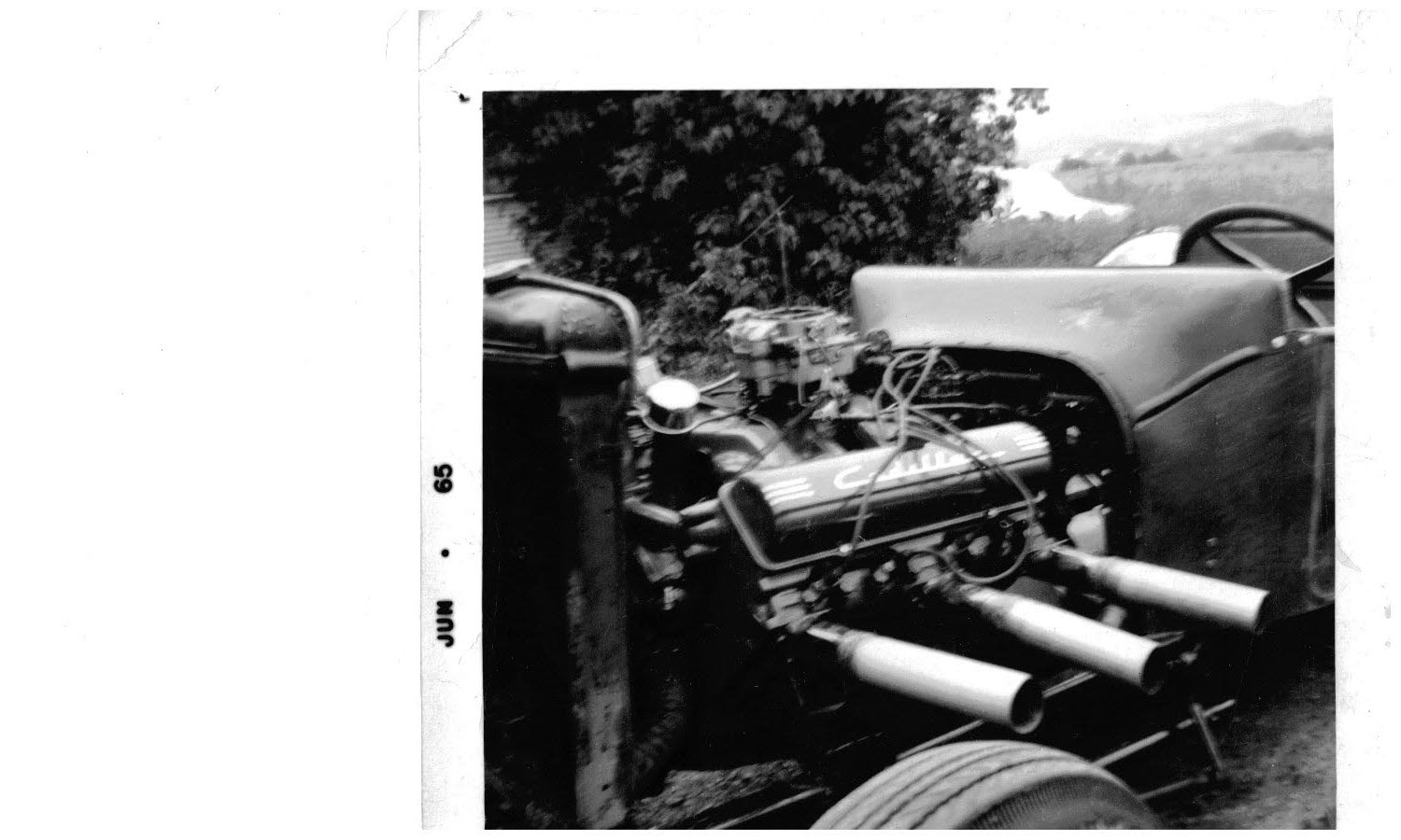

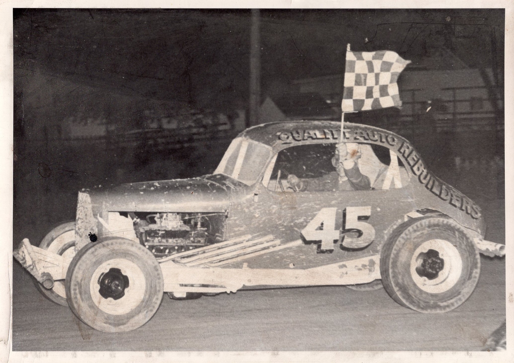

    1963. Living in Fond du Lac, Wisconsin. Don't believe there was a chrome plating shop., but it looks like I had the headers chrome plated. 1965. Moved to Milwaukee. Everyone ran zoomies. I got away from that. Saved the drivers hearing a little bit. img023.jpg

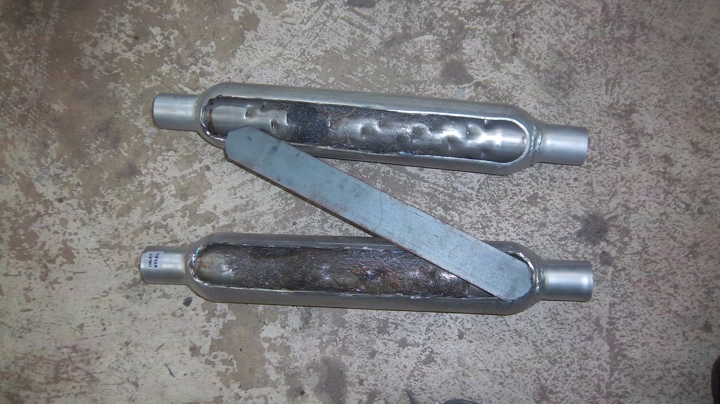

    Not entirely from scratch. Some Ebay stainless headers for a 455, going in my 56 Olds. Cut them apart, so the farthest from each other, firing cylinders were paired up. 2 into 1 collectors. So 4 pipes. Cut apart 4 Brockman Mellowtones, so the tubes were closer together, welded in 198.JPG 205.JPG 208.JPG 216.JPG 218.JPG separator plates, with flanges to make installation easier. 2 pipes into 2 mufflers, on each side. Then 4 tailpipes. It was an experiment that took a long time to do, but it does sound amazing!
