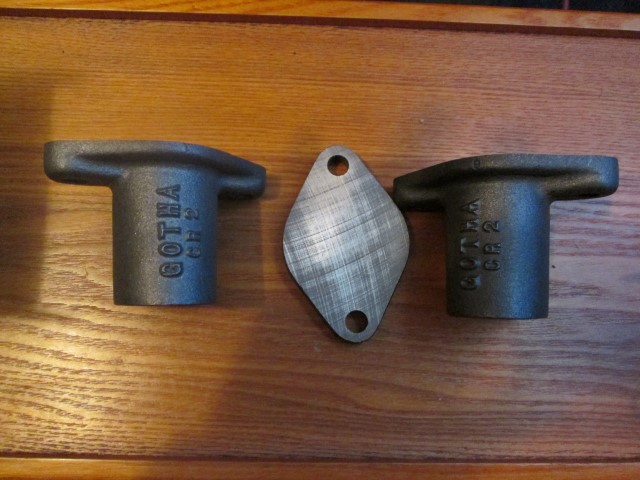

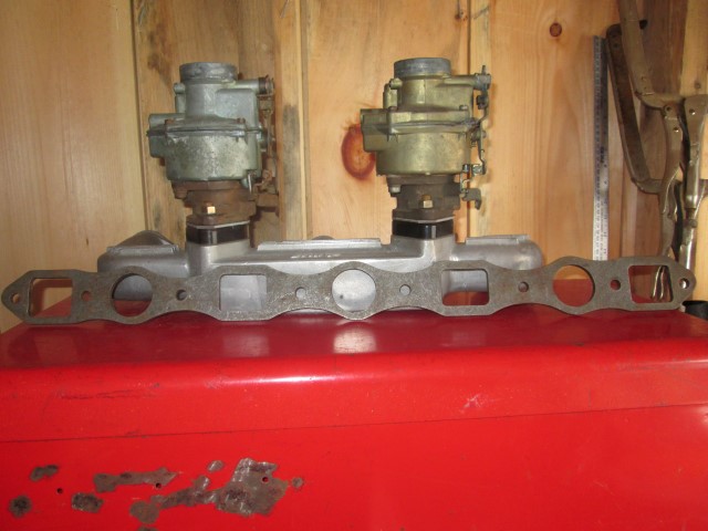

    This is a Gotha kit to make a stock 6 cly. Chevrolet intake into a 2 x 1 bbl (N.O.S)

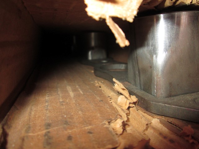

  8. N.O.S. Douglas header flange for blueflame Chevrolet 6 IMG_0500 (Small).JPG IMG_0501 (Small).JPG IMG_0493 (Small).JPG IMG_0498 (Small).JPG

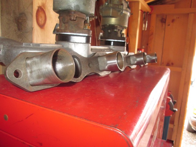

  10. Inline Buick 8 intake/header I saw at the Return to the milltown show GEDC0652 (Small).JPG

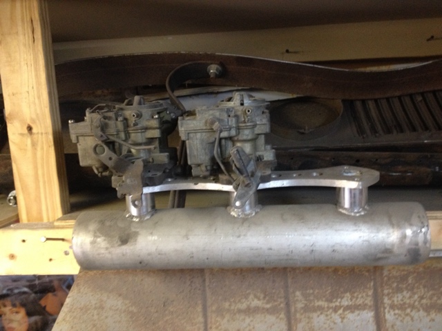

    A 3 carb set up for a flat head six I made. Never finished. I found out The running when parked motor was completely destroyed. So now it's a wall hanger.

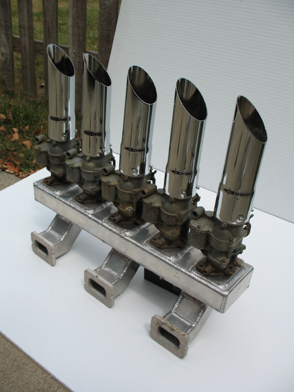

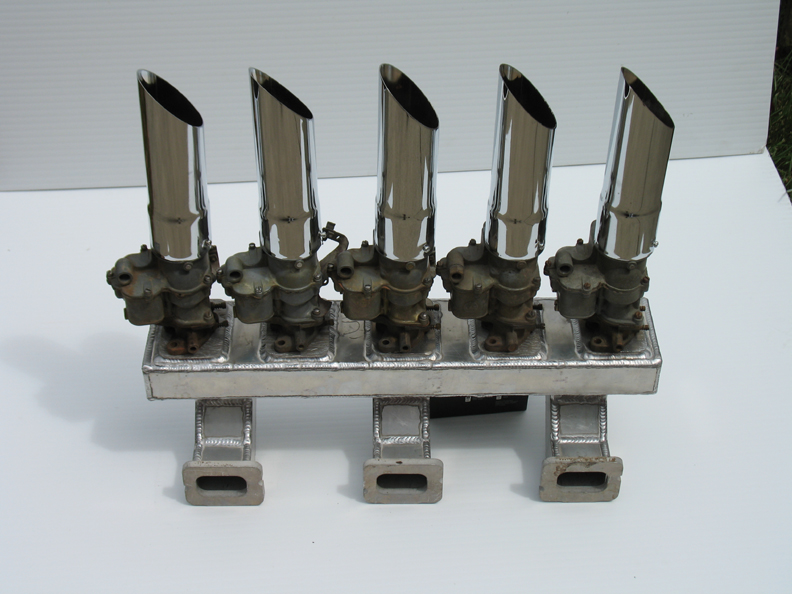

    Bare Intake Side.jpg IntakeCarbs Closeup.jpg IntakeCarbs Front.jpg IntakeCarbs Side 1.jpg th_FinalManifold3.jpg Several years ago, I wanted a unique vintage looking intake for my 292 inline 6. I already had the Offy 3x1 with adapters for a true 3x2 with Holley/Webers on it. It drives really nice.
    So I took an intake gasket, measured it 3 times, and started modeling a new intake on the computer. Sounds a little odd modeling a vintage type intake on the computer. I wanted it to look "home made" so all of the panels for the intake were individuals and tig welded together. I could have had some of the parts bent to reduce some of the welding but I did not go that route. I purchased 7 to mke 5- 84 Strombergs and some cool ram tubes off Ebay.
    After checking for hood clearance (dumb ass me) I would have to cut an opening in my cherry hood or get an extra one. After purchasing a spare hood, one of buddies came over after hearing what I was attempting to do. He talked me out of it and bought the 5 carb intake off of me for his racing altered.

    Dang thats pretty slick. Looks like you could have or are working for Hogan.

    saltflats,
    Thanks but I do not know who Hogan is. It was a work of love and the welding turned out really too nice to grind down. If one wanted to, they could block of two carbs and run three only for the street.

    Hogan is the ones that make those sheet metal intakes for lots of race teams.
    Beautiful work man. When I grow up I would like to weld like that.

    Thanks saltflats. I, as usual, made it to last. All T-6 Aluminum and 3/16" thick. The carb plates & mounting flanges were .25".
    I thought it was a bit overkill but it won't warp!
  17. Wow! raprap you do beautiful work!

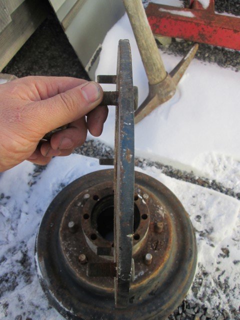

  20. More vintage stock car parts 3/4 ton 8 lug to wide 5 IMG_0531 (Small).JPG IMG_0533 (Small).JPG IMG_0535 (Small).JPG IMG_0533 (Small).JPG IMG_0536 (Small).JPG

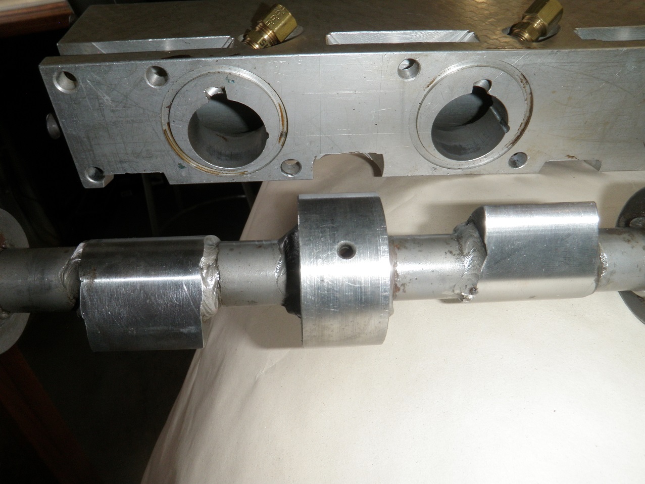

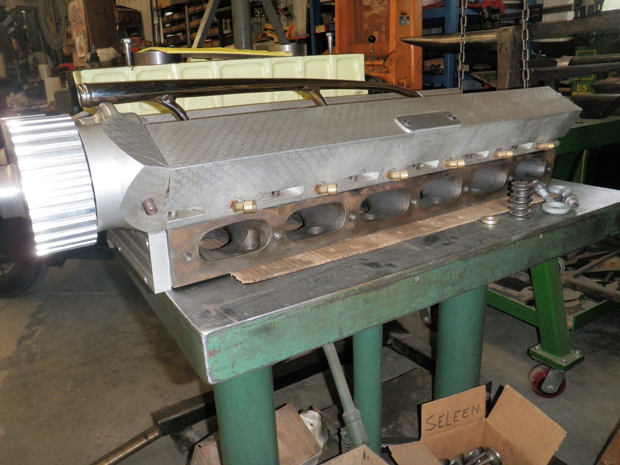

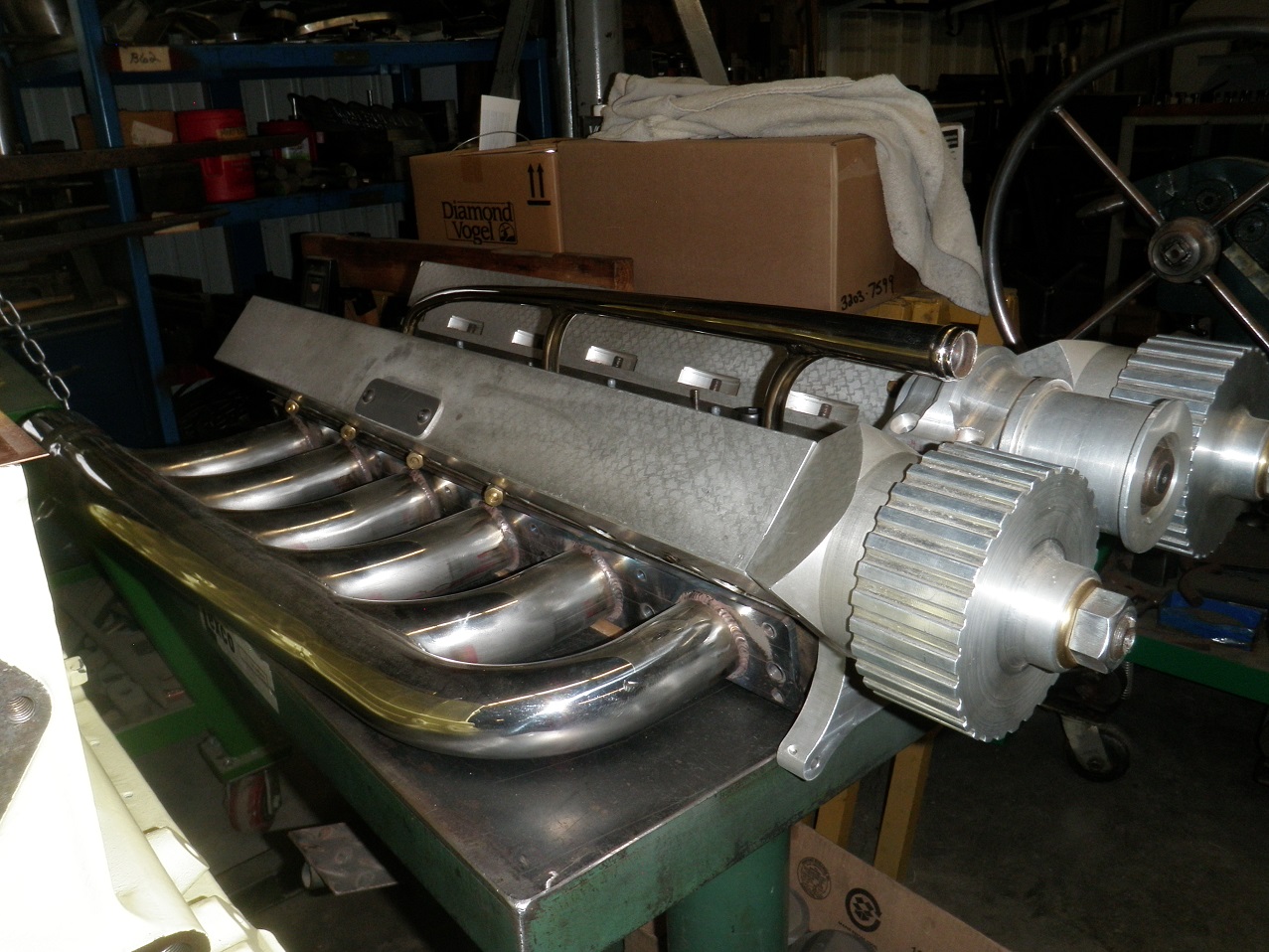

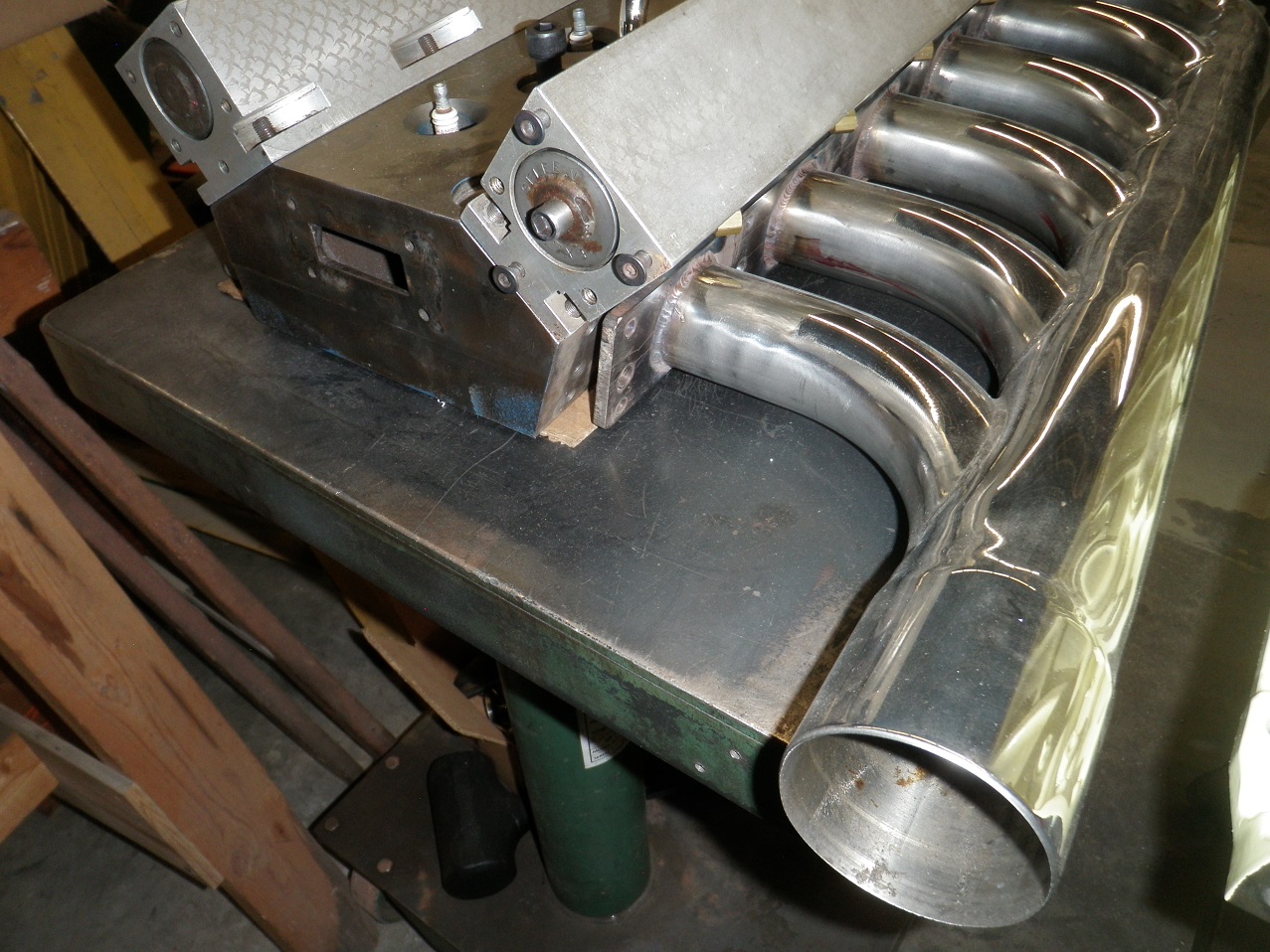

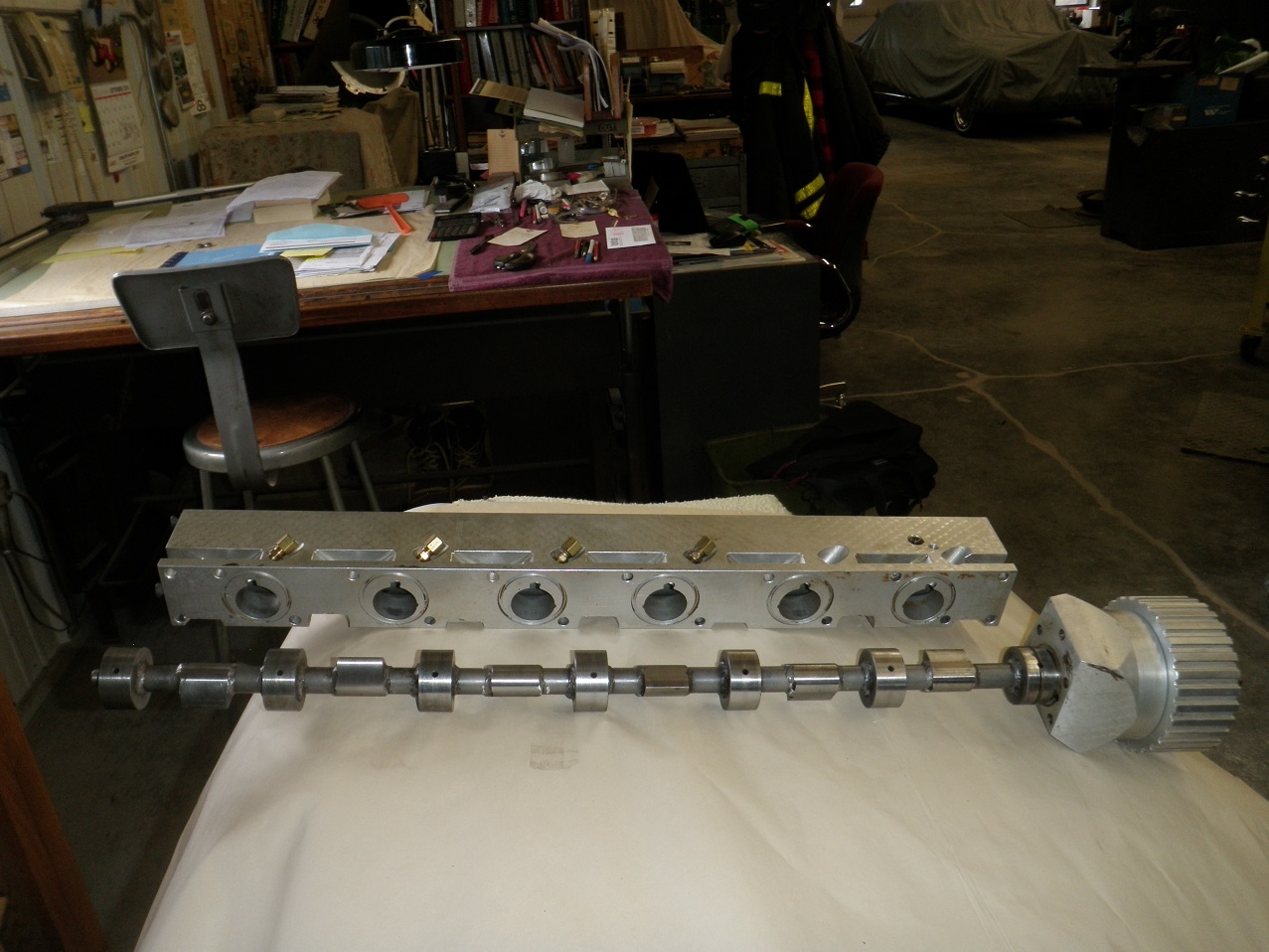

    This may be the pushing the envelope a bit but "home made in the shop" for a 261 Chevy in 1960 (by the resurrector and fabricator of my avatar).
    Not run for 51 years. Presently being rebuilt by him. Cast iron head casting, fabricated cams, cam boxes, manifolds.
    Six Ball, brEad, ekimneirbo and 16 others like this.

    Oh, my!

    Holy cow, that's Cool !

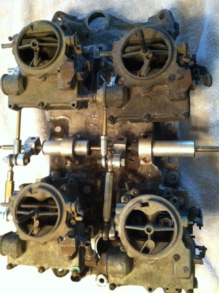

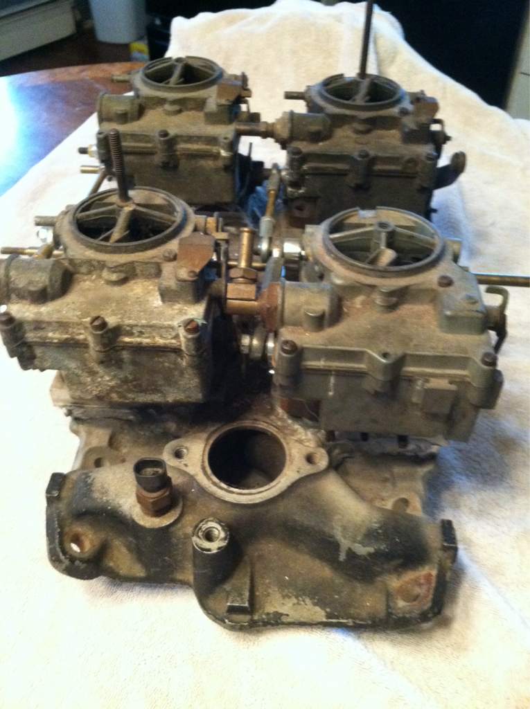

    ImageUploadedByH.A.M.B.1421551044.260967.jpg ImageUploadedByH.A.M.B.1421551075.979042.jpg
    After the dual cam 261 above, this is almost embarrassing, but.....
    Here is my four- twos intake. Intake base is a TBI intake, I milled the top plane off welded a plate on top then made carb risers. The linkage is all home built. Saving money to buy carb kits, then to figure where to start with jetting. It's not a isolated runner intake so I just can't jet like a Man-A-Fre set up. If anybody has an idea where to start hit me up.

    Hand made DOHC head......WINNER!......totally awesome!

  29. Hey it's still cool!

    Thanks bud, I've been working here and there for ever. I made my own extended throttle shafts. And all the linkage. Carb kits next. Hopefully this summer it will make smoke!
