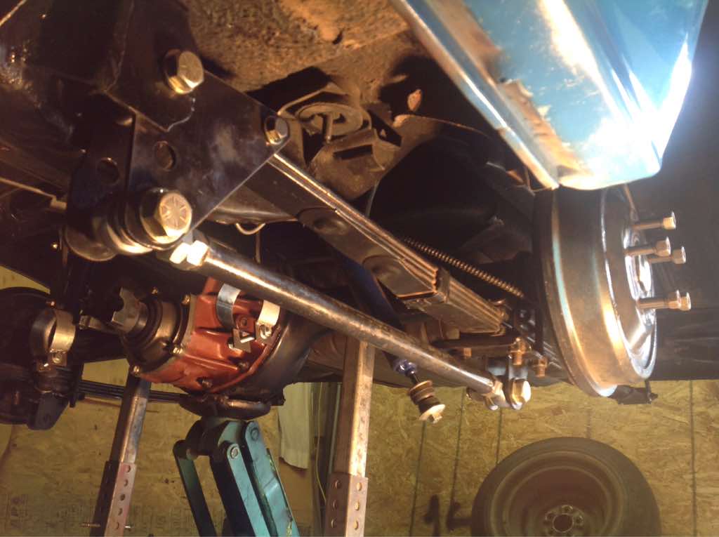

    Homemade caltracs. Don't know whether I would do it again with the cost of quality rod ends, DOM tube, grade 8 bolts, etc...
    At $350 there not a bad deal, I've a couple hundred into my homemades. ImageUploadedByH.A.M.B.1422146999.905867.jpg

  10. Very nice I am going to build some for my 53 Chevrolet, using tie rod ends. Going for an old school look.
    When I (with help from my dad) changed it to open drive I put a mount on the spring pad. IMG_0404 (Small).JPG

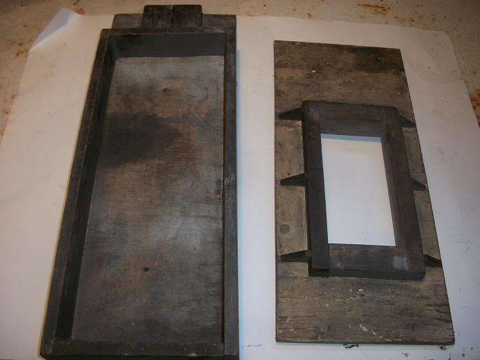

    These are patterns for a flathead 4-71 blower manifold. At least 1 manifold was cast and run on the Banister Brothers dragster in the '50's

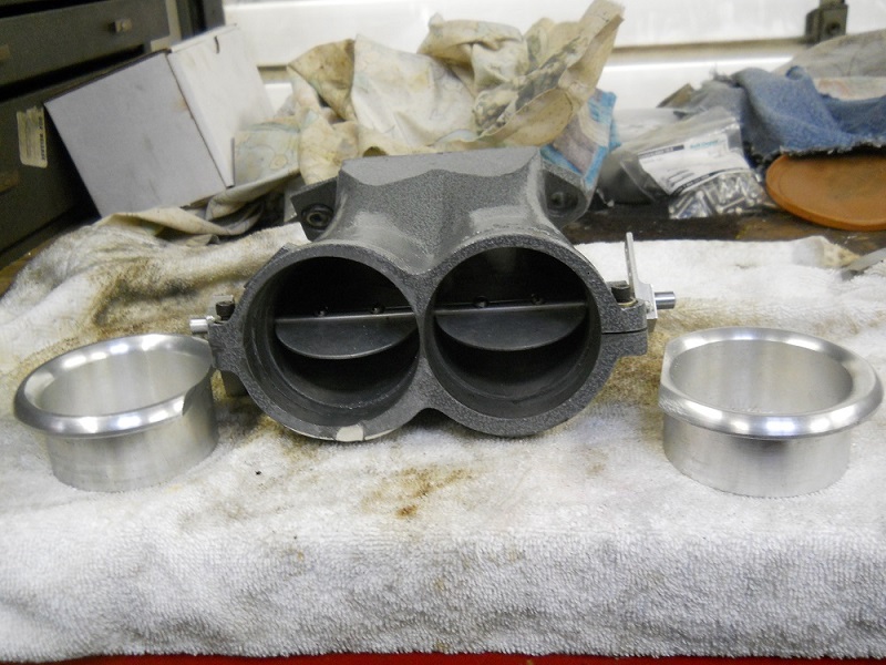

    i was going to just bolt these injectors on and run them. But peer pressure caused me to make these bells for the inlet. These are for my 26 Dodge Bros banger

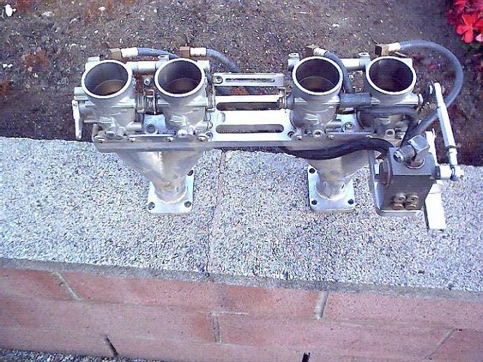

    As long as i am doing injector stuff. Here is an injector manifold I made for a '32 Plymouth 4 banger using Suzuki 750 throttle bodies modified for Hilborn nozzles.
