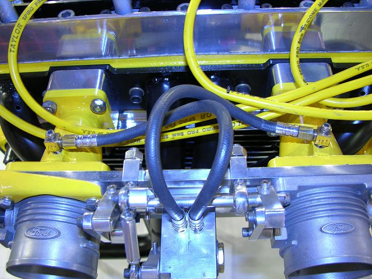

    And here is the 32 plymouth showing another intake i made using 4.6 Ford throttle bodies. Also the home made twin plug head, finned side cover, and duel distributor drive.

    The flathead Plymouth banger went 113.7 both with Suzuki and Ford throttle bodies.At El Mirage and Bonneville both. I guess 113 was it's number. With the Y block head it went 135

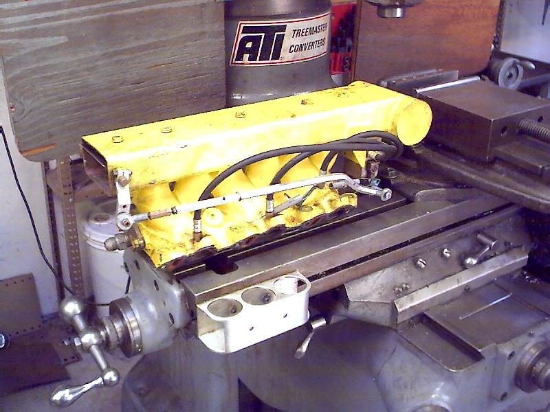

    This baby bug catcher that I made from the bottom half of a Nissan Maxama 3 liter V6 SOHC EFI intake. Again I used Hilborn parts It went 231 in F/FS in 2000.

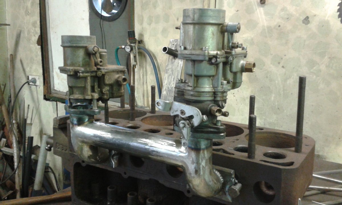

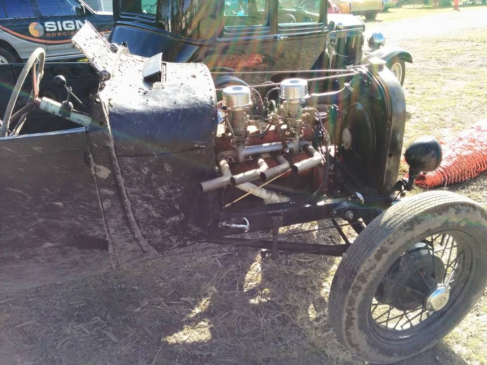

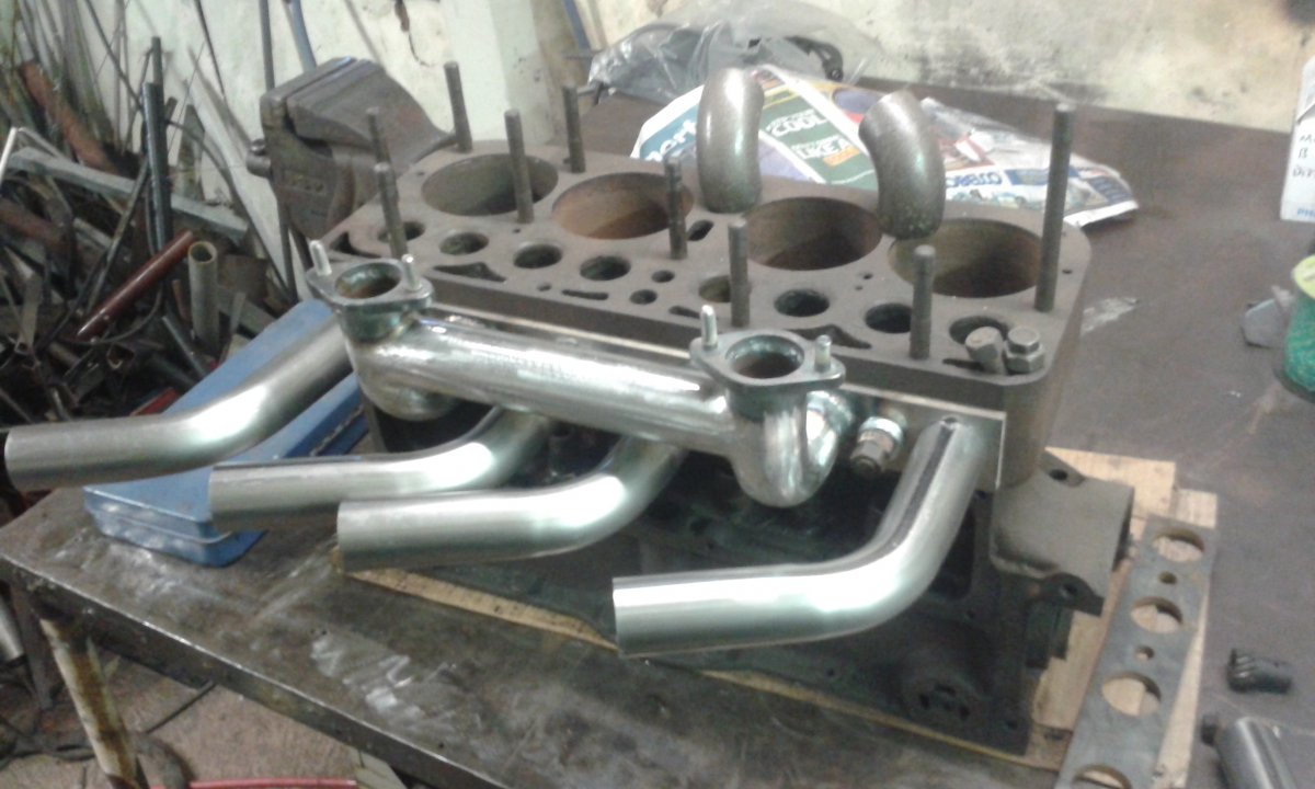

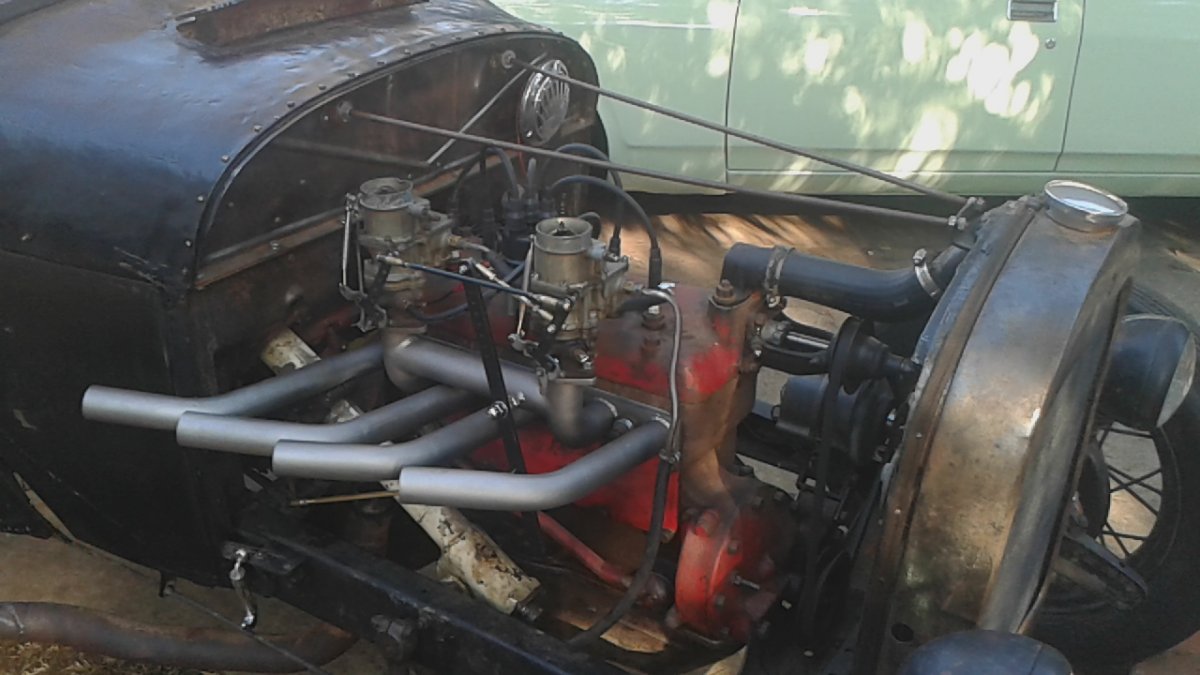

    11695909_10153559324280676_8019447617791421092_n.jpg Header and intake combo on my banger. It sounds great and looks good at night. What else do you need! 20150403_130510.jpg 20150406_162847.jpg 20150616_142126.jpg 20150628_140719.jpg

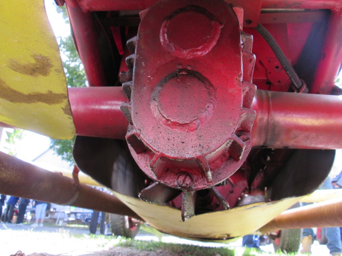

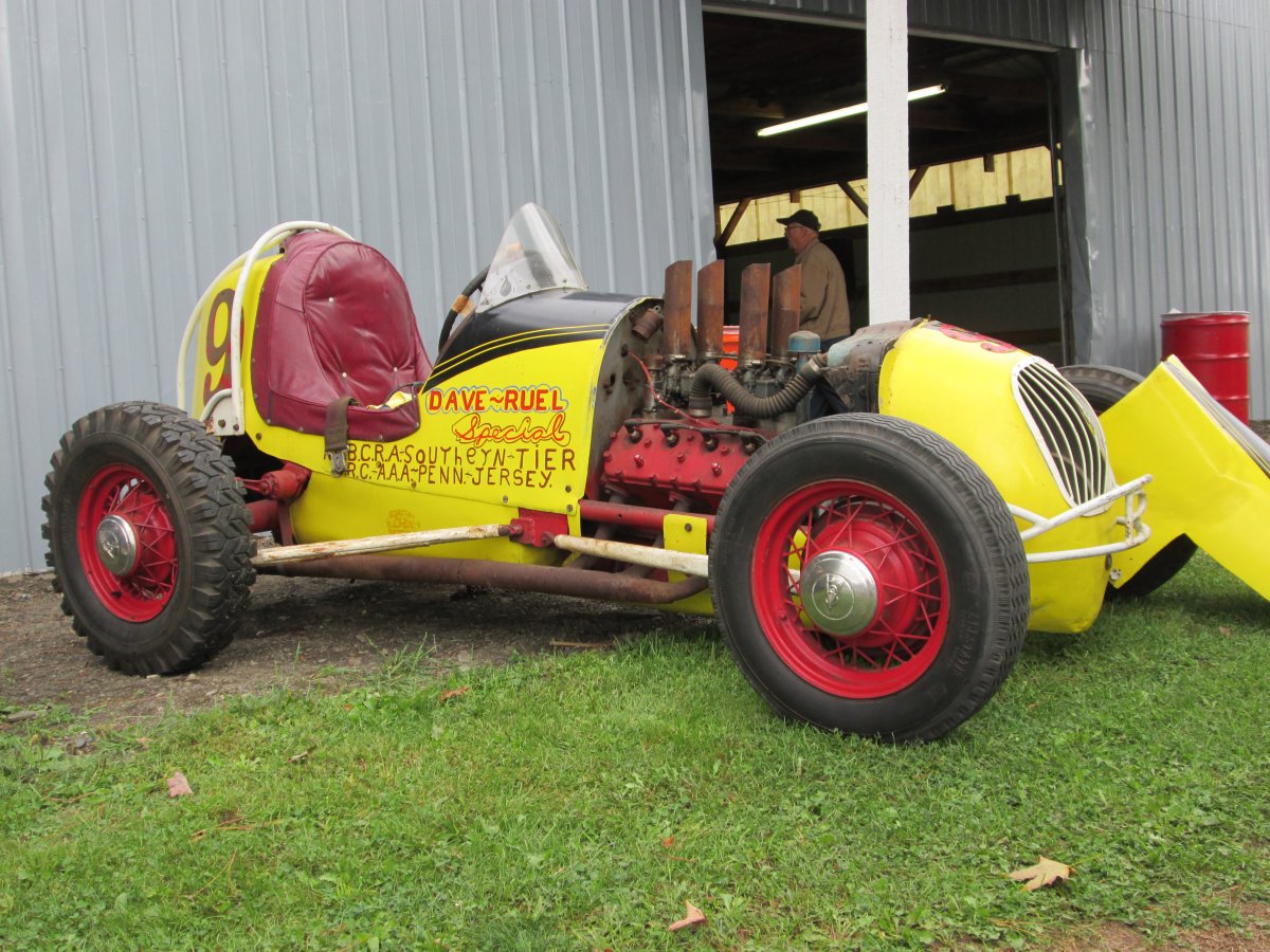

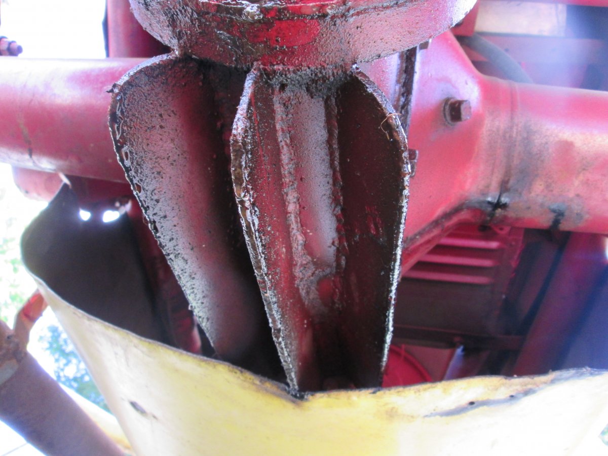

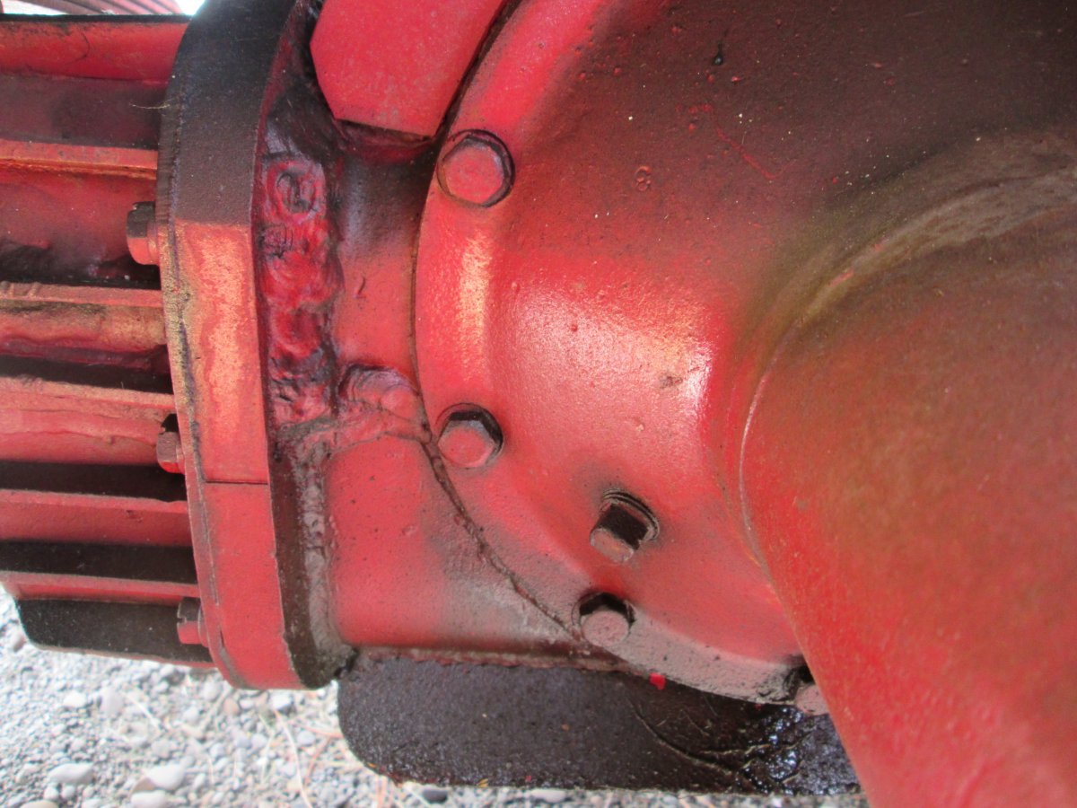

    This is a homemade quick change and in-out box in a homemade big car owned by **** and Jeff Ackerman

    I need that recipe. Do you have build photos? That is so great, I was talking with a friend when we were at the dirt drags at Chopped last weekend and to be able to change out the diff gears would be unreal. We don't have the coin for a quick change but do have a metal shop.

  20. I do not have a photo, I will check with the Ackermans.
    The car is a barn find built just after the war.

    The exhaust and intake are on the same manifold plate and there are no sealing issues. The carbs are Bendix Strombergs from EJ Holdens from '63. I run a single Bendix carb and a quiet exhaust on the street and the performance enhancement when the header manifold combo is bolted on is dramatic. Next project is to make similar intake manifold and extractors, but might use some 94's instead.

    Thanks joelorocknrollo! Great looking and I'm pleased it performs well. I'm building a banger rpu right now and I may have to 'borrow' the look!!

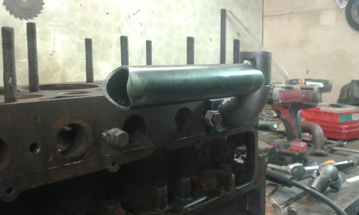

    Tripple '81 manifold work in progress. Run one, two or all three! IMG_0360.JPG IMG_0361.JPG IMG_0362.JPG

    It is starting to take shape. But need to find another good '94 or rebuild all the '81s. IMG_0370.JPG IMG_0372.JPG IMG_0373.JPG
