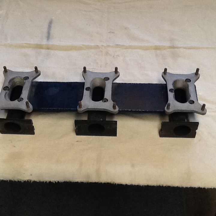

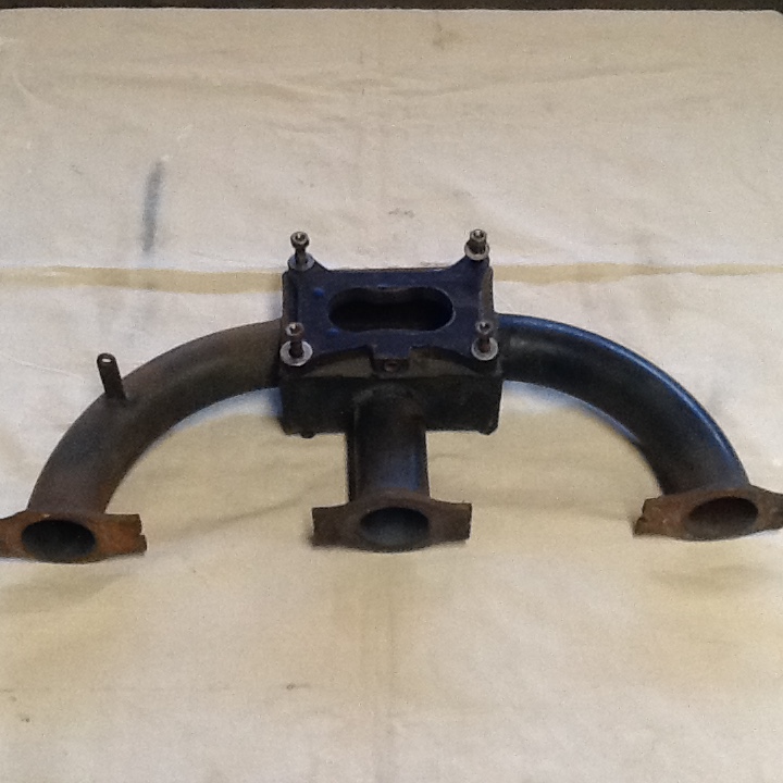

    Here are 3 GMC 270/302 intakes. The 3-2's were for 97's which I converted to Holley bases. Was made to clear Nicson cast iron headers. The single 2 barrel was found a a swap meet for $10.00 with a Brazwell 2barrel Holley it ran 163 @ Muroc in 1997. The last is an injection unit I got from the Burce Johnson estate after his p***ing. It was for alcohol as I see the nozzle ports and I don't think it was ever finished.

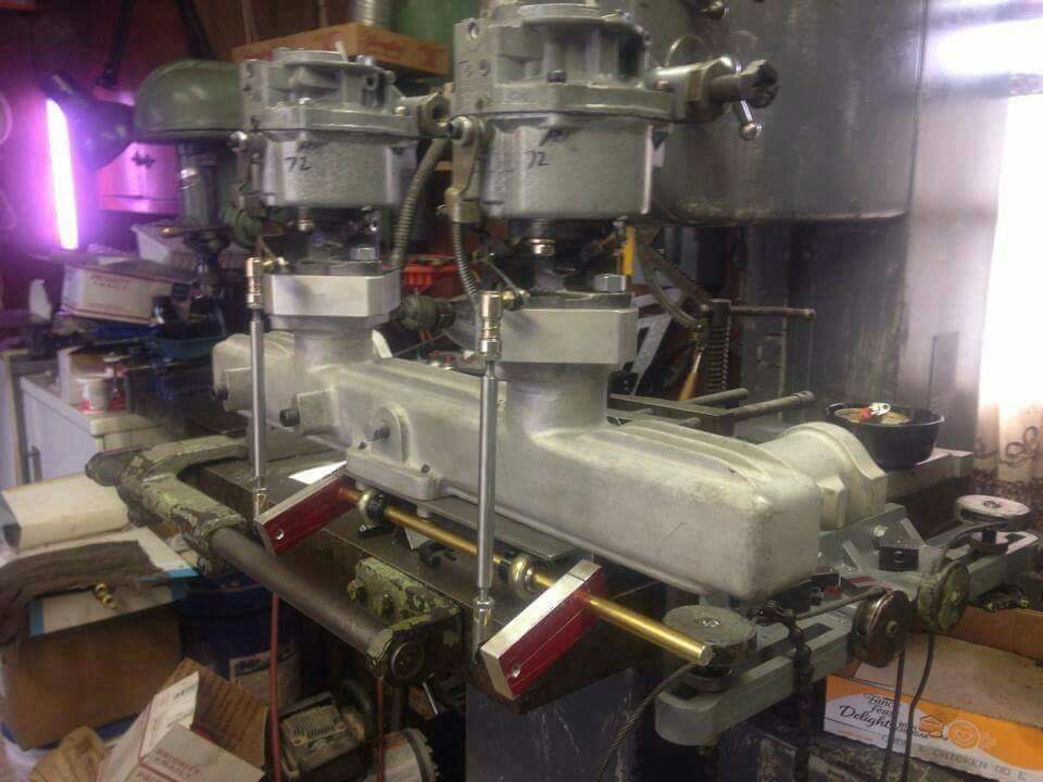

    My buddy Frank made the linkage and fuel block in his home workshop. Also adapter plate motor plate and stuff to numerous to mention.

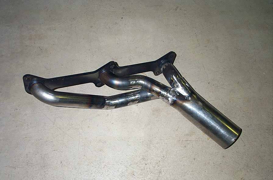

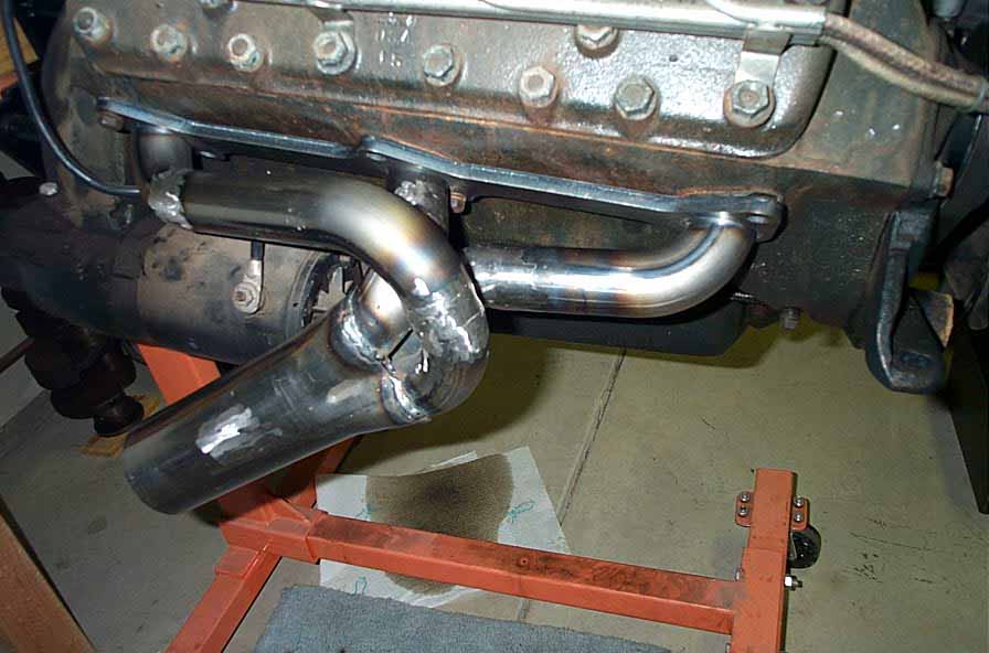

    Almost everything I have is homemade.............and is designed with mechanic in mind
    ] tubes2.jpg headers2.jpg headers3.jpg headerscomp.jpg headersr1.jpg headersr2.jpg

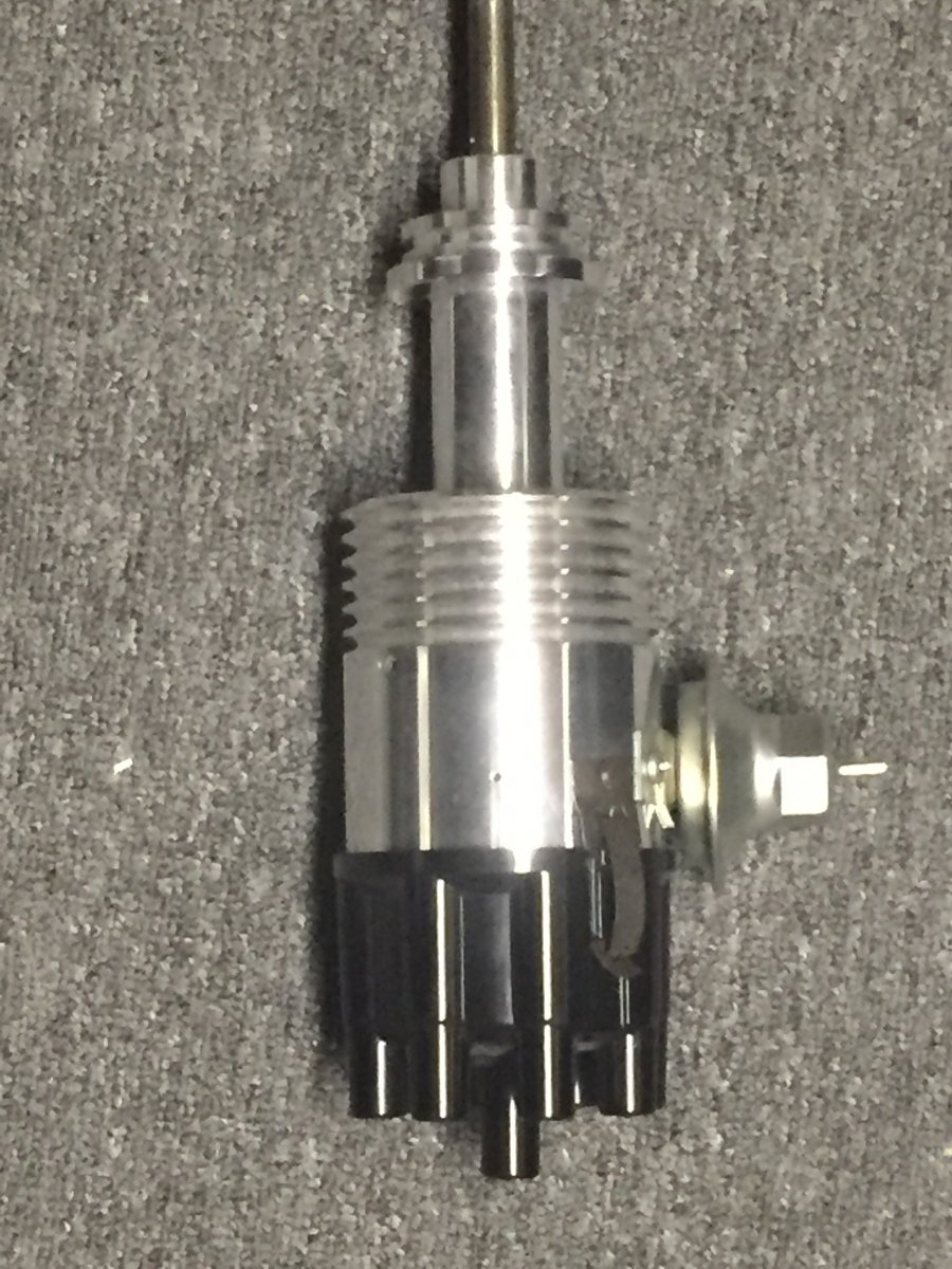

    Here's a couple I've whittled out. The distributor is for a 392 HEMI- it's been on here somewhere in the past. The 4 port fuel injector is currently underway and has a build thread I've been updating. Both have been super fun projects! It will have some of the sharp corners smoothed over before I call it done.
