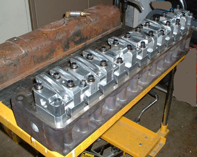

    DADD6391-5D5B-418A-A0E1-4FA30FCA6FE4.jpeg DE31589F-C6F4-44ED-8EFB-5D44788CF42E.jpeg
    for my Daimler Hemi

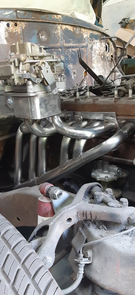

    I recently put truck heads on my long bell housing 331 hemi. Engine is bored 1/8" to 354. Big ports in these heads allowed me to make 2" fender dump headers I always wanted for my g***er cartoon car. Equivalent of a 20" gl*** pack muffler is built into the colletors.

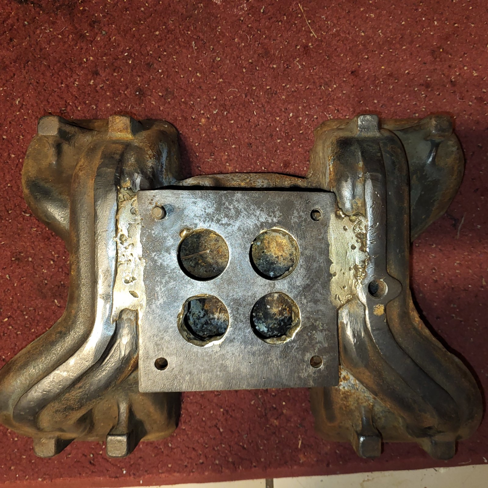

  18. I've seen a bunch of welded up cast iron manifolds in this thread, what is the best way to weld the cast? Braze, nickel rod arc weld, I have heard flux core wire feed works any truth to that? I'm in the beginning stages of building an old school two carb intake out of a stock cast iron flathead manifold. Plan is to weld two sets of pipe to the manifold that go up to some steel plates to mount the carbs, just like the J.C. Whitney kits. So I will be welding steel pipe to the cast manifold, thinking brazing would be best but would like some input from those that have done it.

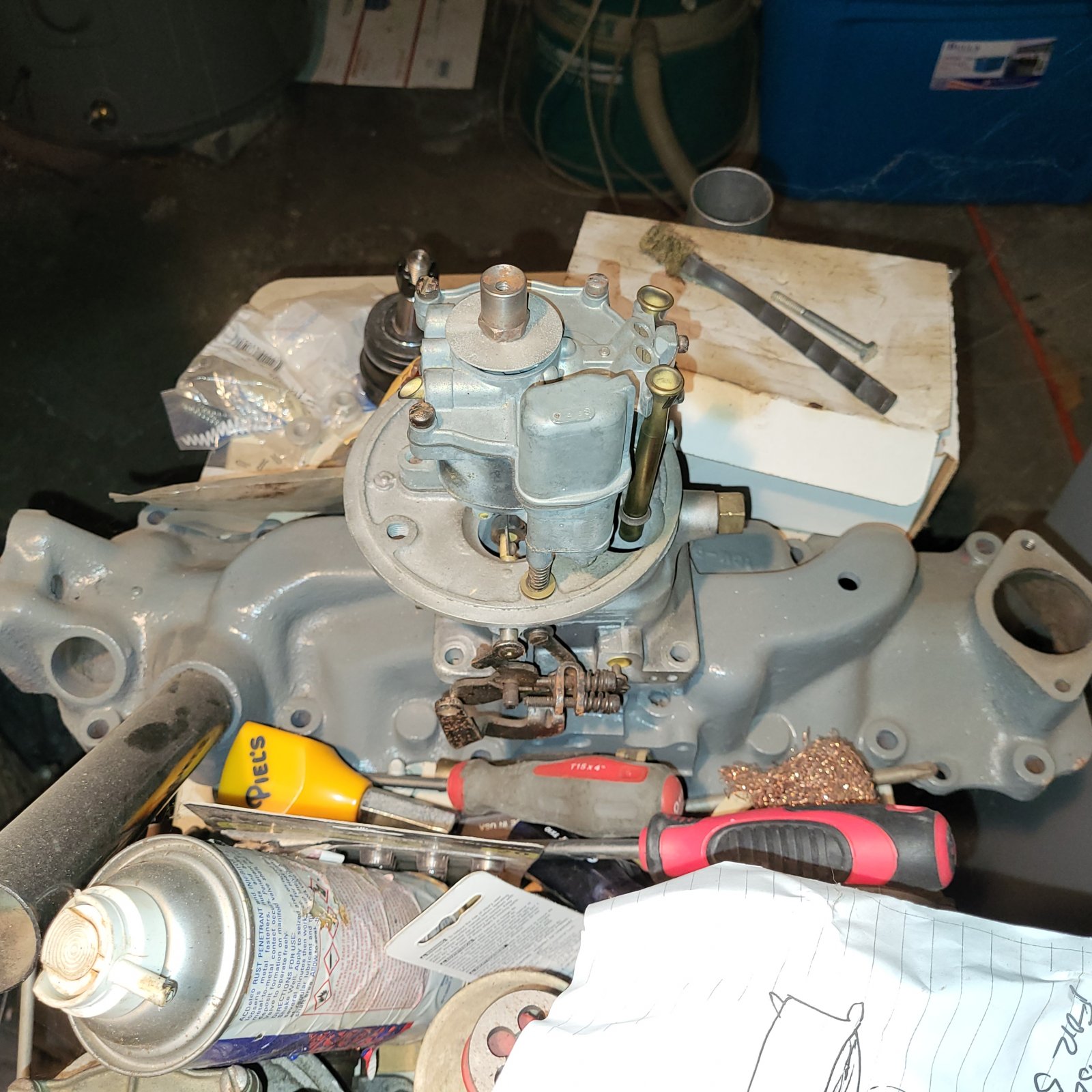

    '49-'51 MERCURY intake manifold modified for an early four barrel. 20220925_161931.jpg
  20. I have built a could of BlueFlame split manifolds by brazing them and had good results.
    I have welded cast iron before and never had any trouble, but it can be a **** shoot.
  21. Thanks, I think I may try brazing also.
