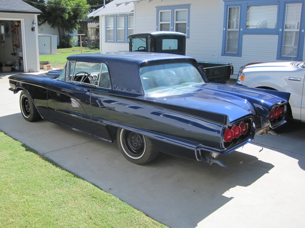

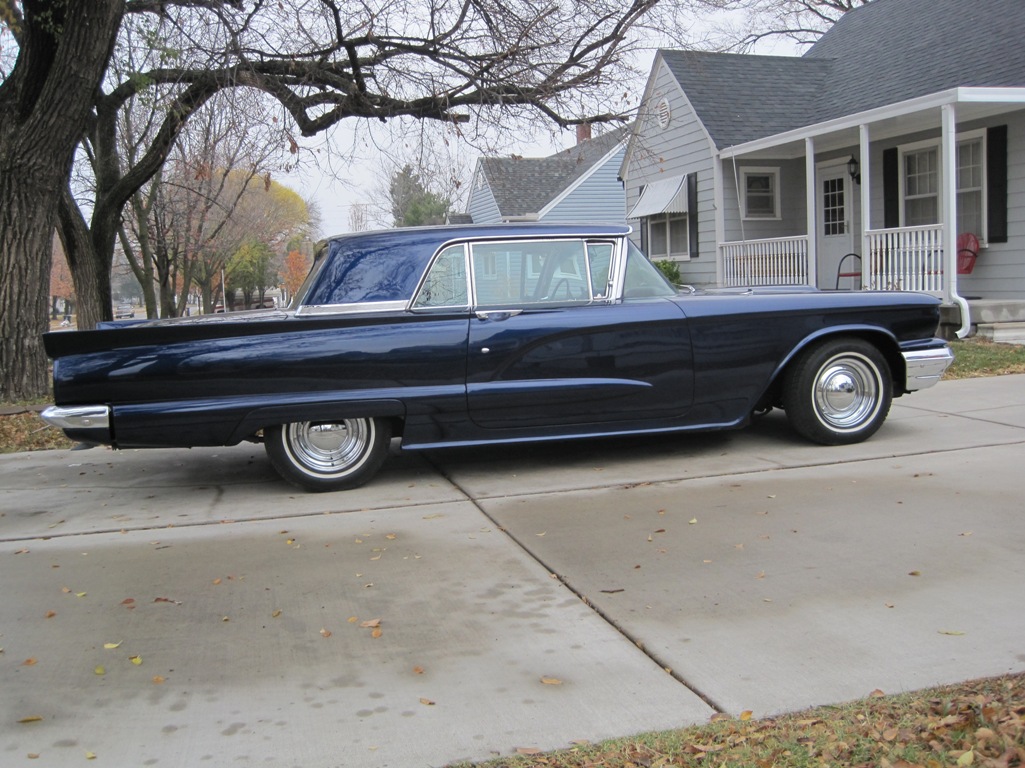

    I paint in my garage, clean the crap out of the floor, tarp off the back two stalls, furnace filters in the windows and a box fan for exhaust. I painted my 60 T-Bird 9-21-2011, and still got dust in the paint, had to color sand and buff it. The important thing is to get everything as clean as possible.

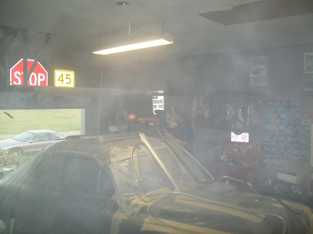

    This worked well enough for a one shot deal on my off-topic project.
    Fan in one window facing out, A/C filters over the other two. On actual paint days I rolled the toolboxes outside and wet the floor down with a garden sprayer.
    Later I added lights on all the walls, the ventilation didn't really work that well and it would fog up pretty quickly.

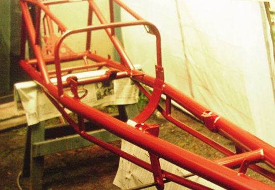

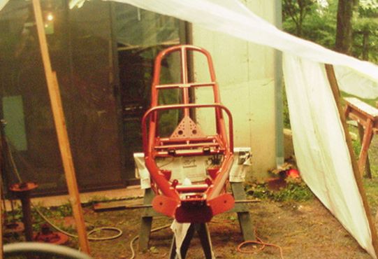

    Back yard, wet down the gravel, made wooden frames with plastic stapled to it to keep bird shit and leaves off the paint. Looked at the date on the back June 1991, I've got to finish this project some day.
