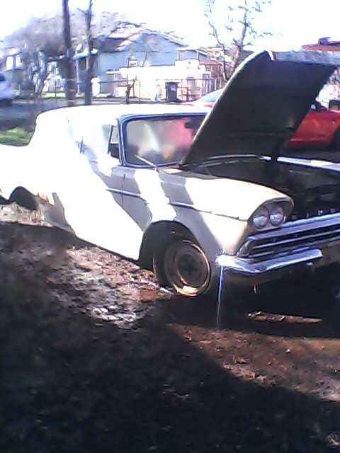

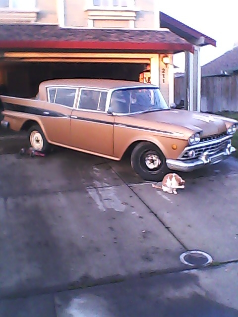

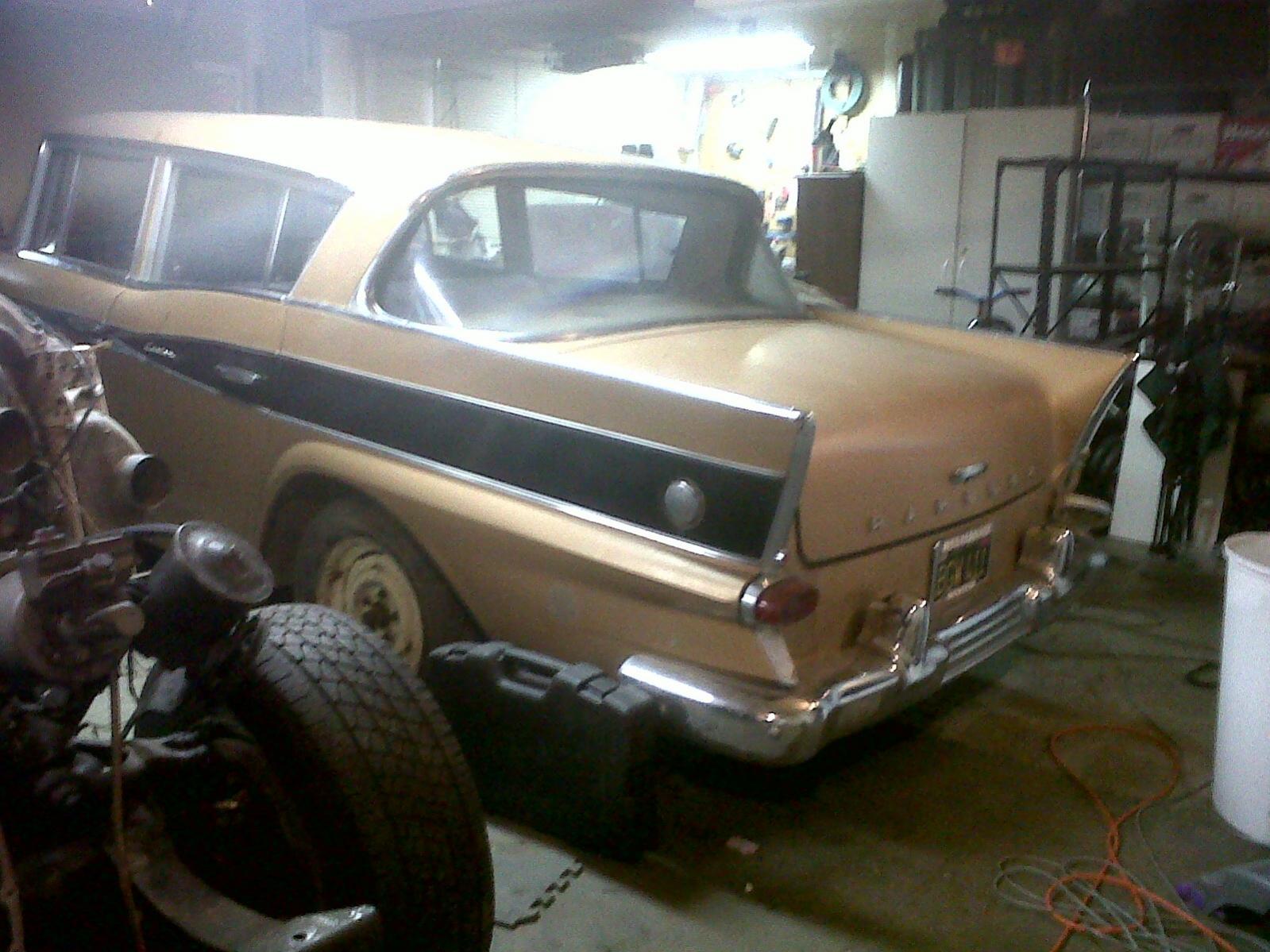

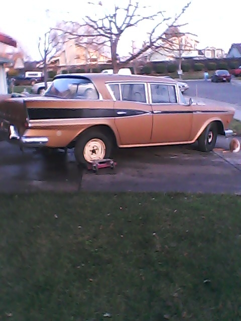

    heres my old lady's 59 rambler custom. found it in a field!!

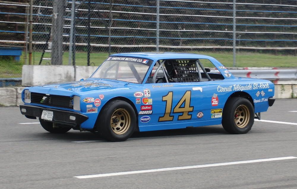

    Here is a friends of mine.
