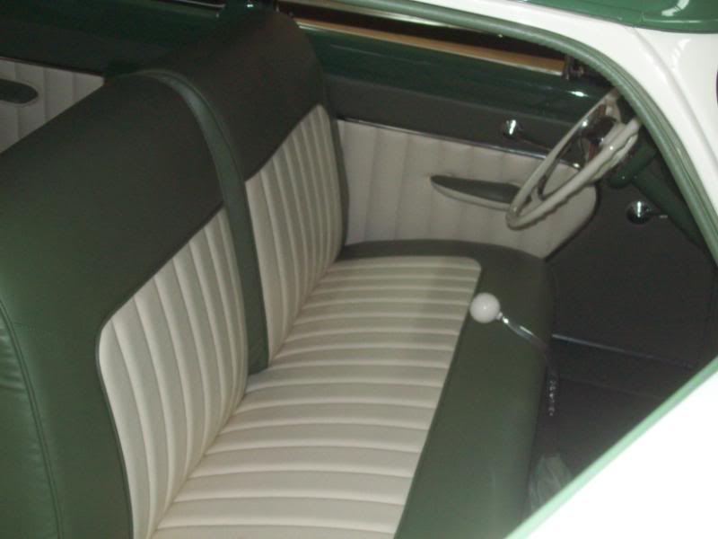

  4. Here is a pic of mine in my 51 chevy truck (no knob yet). I created a short throw and made my own spacer out of a hard rubber/plastic cutting board. It was exactly 1/2 inch thick so I doubled it and used transmission rtv between the two. Not saying that's the way to go - that's just what I did.

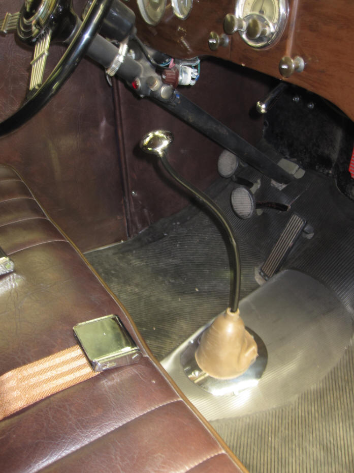

    I wanted the 3-speed look in my 36 Ford. Chopped off the T5 shifter, bored a 1" deep hole in the nub, and then welded on a cut off Ford shifter with the end turned to fit the bore. Shifter.jpg ShifterInstalled.jpg

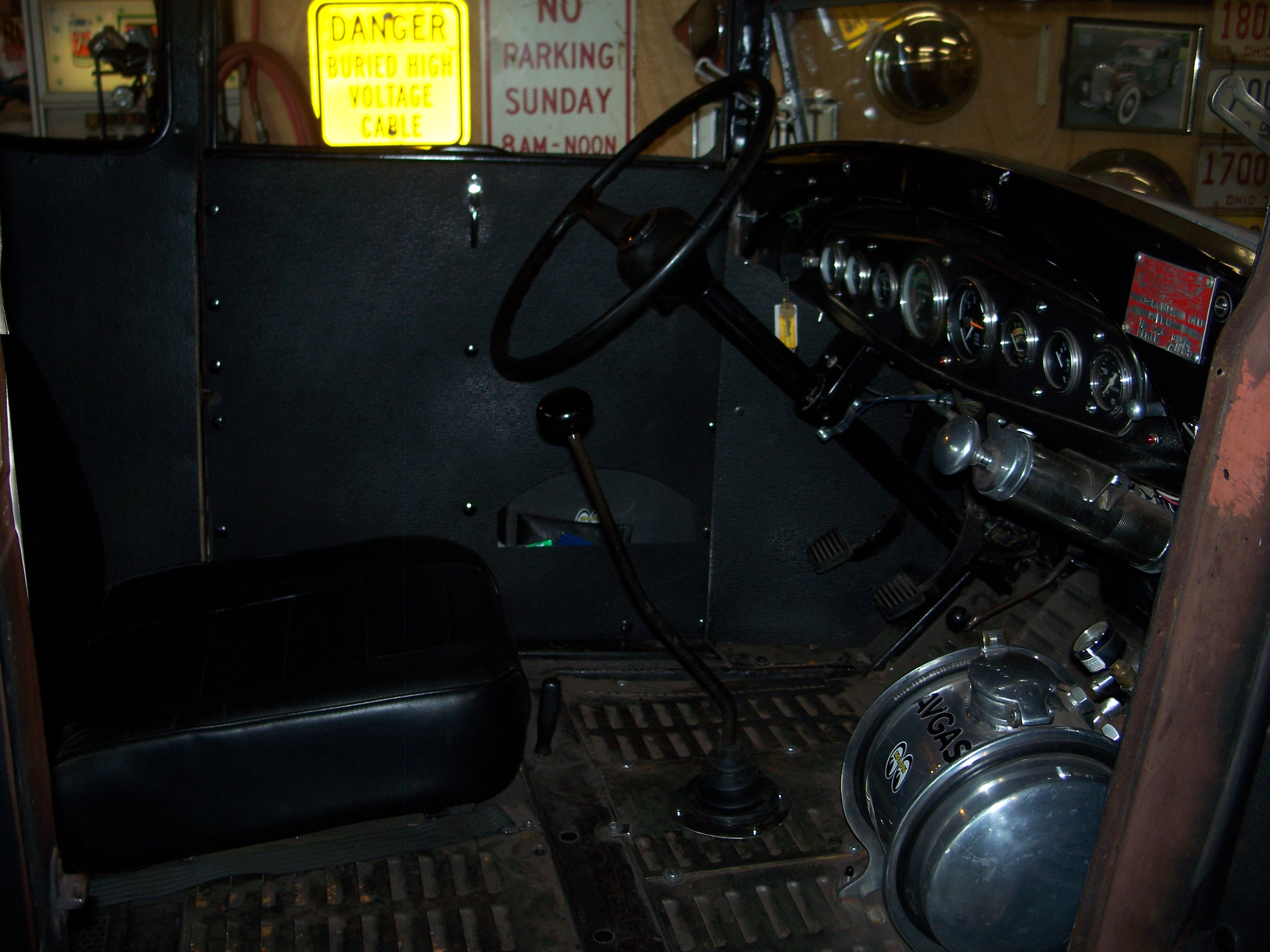

  10. When I was in the building stages of the wagon I made a shifter from a piece of 3/4" round stock and heated and shaped it to contour with the seat when it was in 2nd,4th and reverse but after the seat runners were repositioned I was able to do away with the belly in the shifter. HRP
