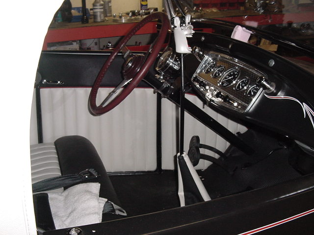

    Unfortunatly you can't see where the new handle shifter meets the old stub. We machined a little bigger tube and threaded it to screw onto the old stub then welded a rod to the new machined piece and bent to fit. Gary
