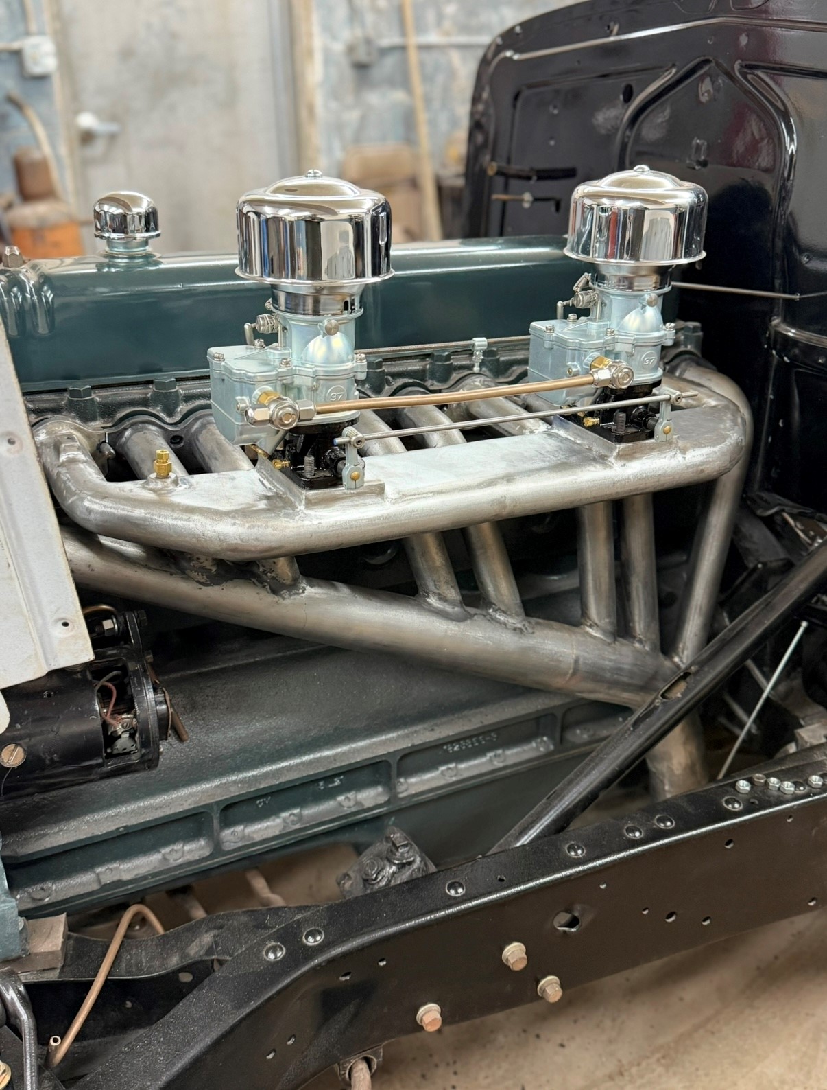

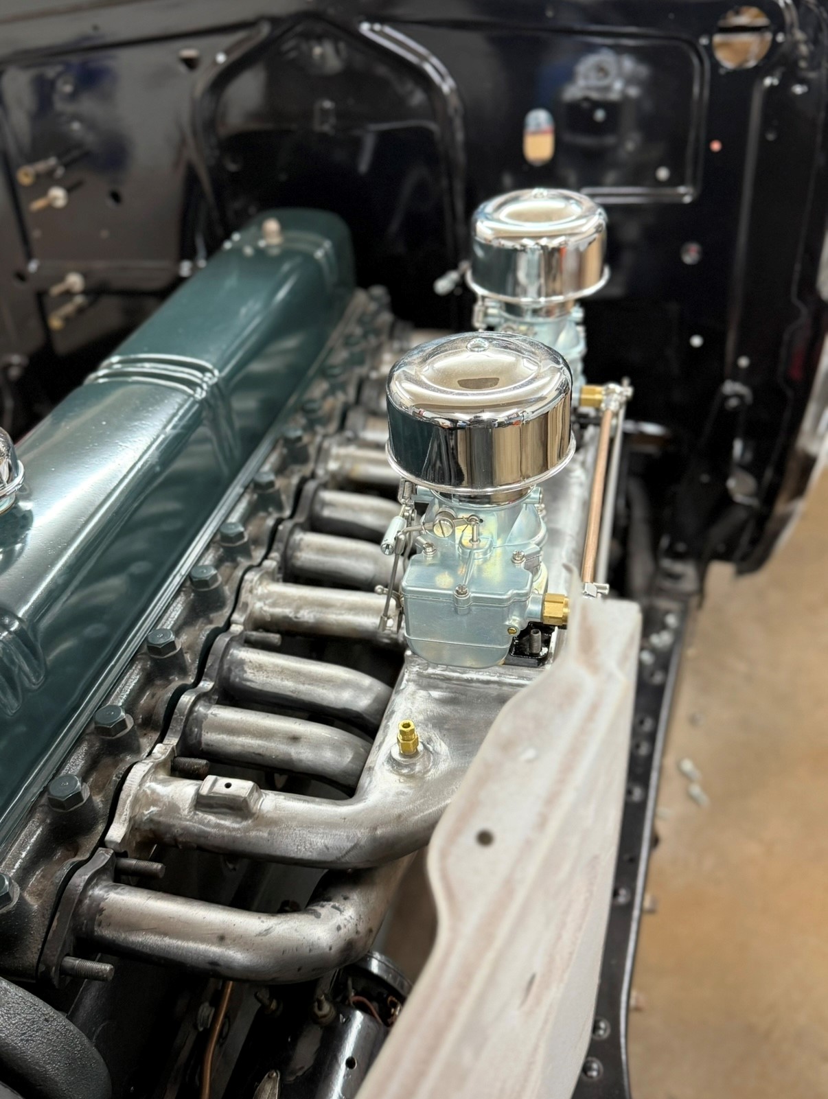

    Dont forget Expensive! I had the 320 (1947 engine) for my '37 coupe rebuilt a year ago and it was about $9k, but i also had the babbit rods converted to insert bearings. Factory changed to insert bearings around 48 or 49, so he might be good to go in that respect.
    When i got my car, it had no engine or trans, and i kind of decided i would go with whatever i found first with the choices being nailhead and muncie or straight 8, and i found the correct displacement, slightly newer engine a few towns over, so i went that route. Im glad i did, its something different than what im used to being around, but they are cool looking and honestly, just the size of this thing is funny enough. May not be a big crazy powerhouse, but im getting antsy inching closer to being able to start it and hear my engine run in the car.
    I have a few of the smaller engine dual carburetor intakes, i think one is cracked though and the carburetors need to be gone through.
    i am building my own intake and exhaust for my 320, maaaybe sort of regret it where its added a bunch of time, effort and money to this project, but a boy needs a hobby, and seeing 12 tubes all lined up in a row is kind of cool! Im finishing this up in the next week or so and getting it cerakoted, just getting it all cleaned up and making sure i dont need any more provisions for things
    (the exhaust was painted black but i sanded it off so it looks a little grimey) 3201.jpg 3202.jpg
