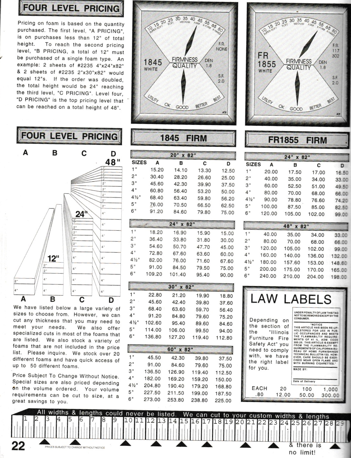

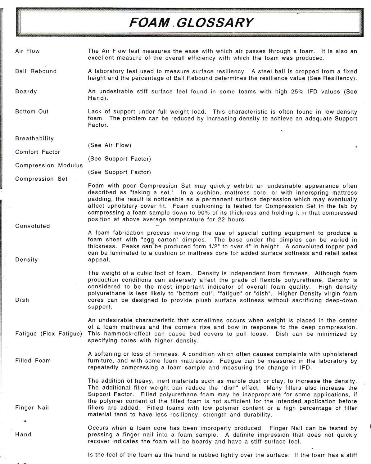

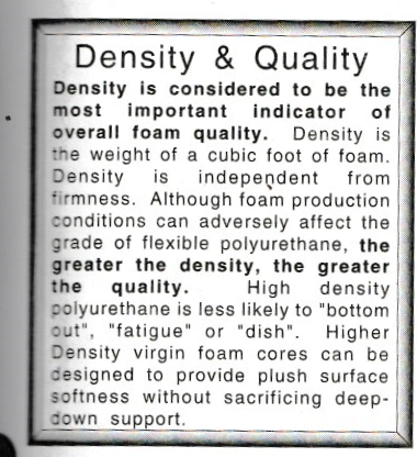

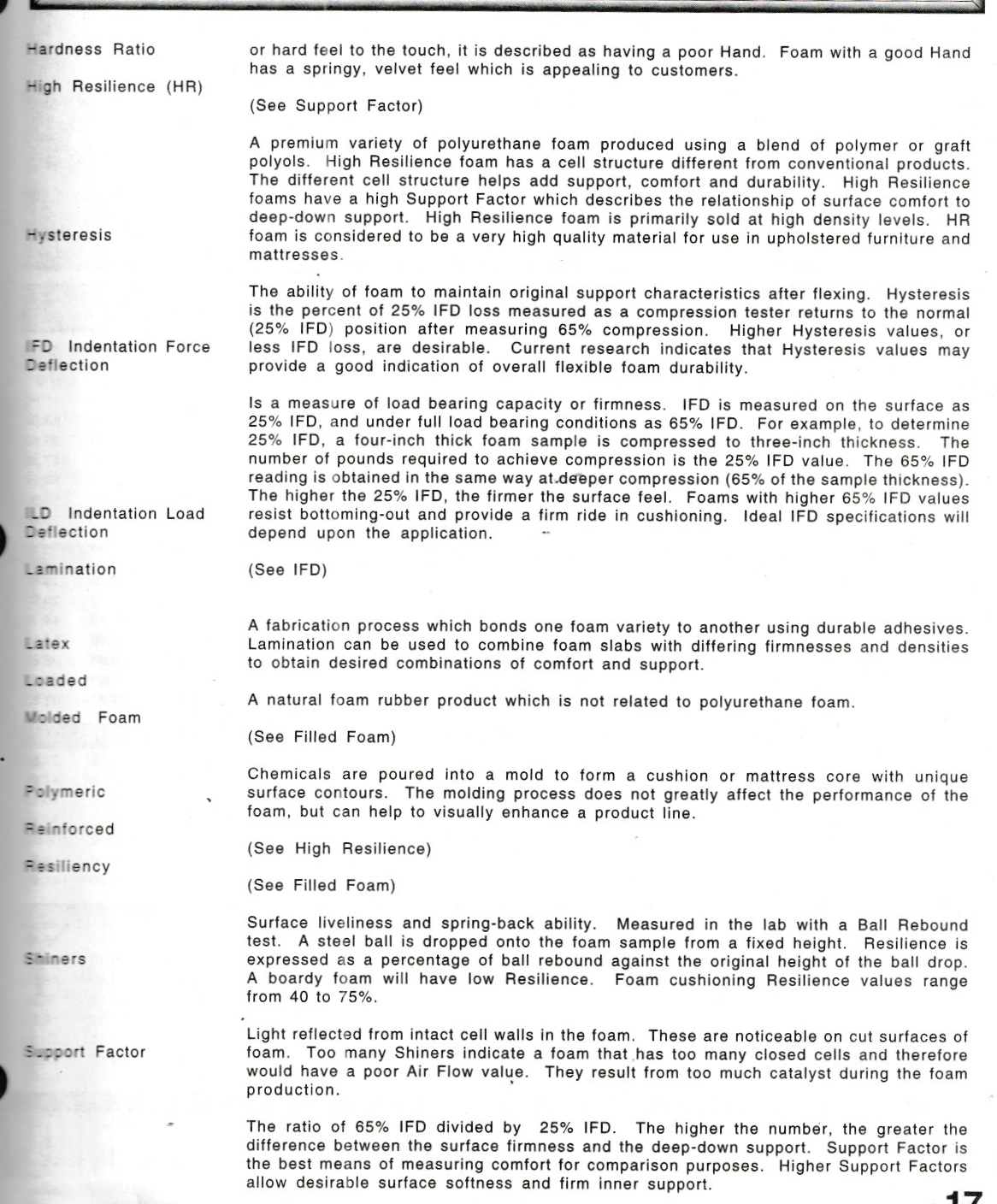

    This is out of a company in Chicago I used to buy from. Study this. Scan_20230103 (2).png Scan_20230311 (2).png Scan_20230311 (3).png Scan_20230311 (4).png Scan_20230311.png

    What I do. I go by what engineers have spent years researching and designing the shape of foam seats for automobiles for years. So I use what they know and get foam from used seats. If they have 100 thousand miles on them and are not destroyed. It must be good foam. A little repair might be needed to make the seats as good as new. Use the p***enger side foam for the drivers side. If possible. When looking at a new piece of new foam, (compared to wood) can you tell if it`s a piece of Walnut, of if it`s a piece of Pine. How long is it gonna last ?

    This explains it much better. But to get this info on foam you are buying is the tricky part. The support factor, firmness and the density are what you want to know for good long lasting comfortable foam. And always buy the best. Don`t buy foam at fabric stores. Scan_20230311 (5).png
