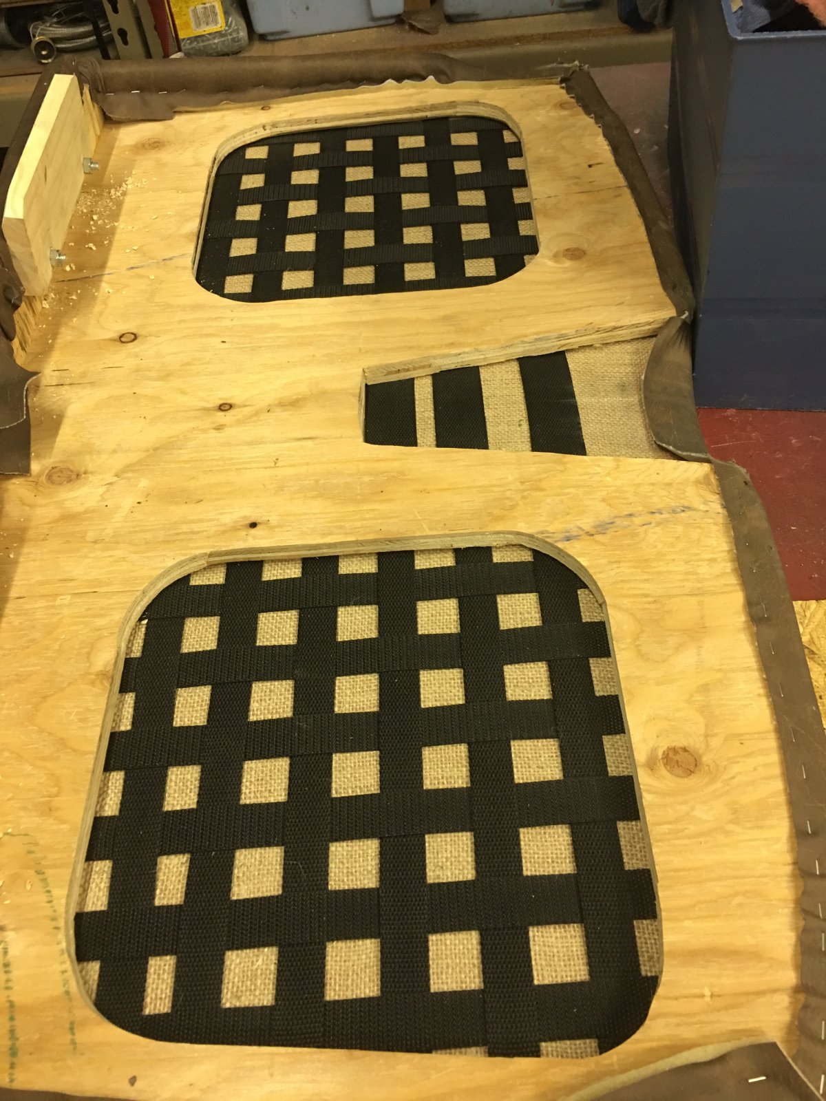

    3B9EBBC3-56E2-475A-887D-7F721EBF40A8.jpeg This is how my mg seats were done for my model a

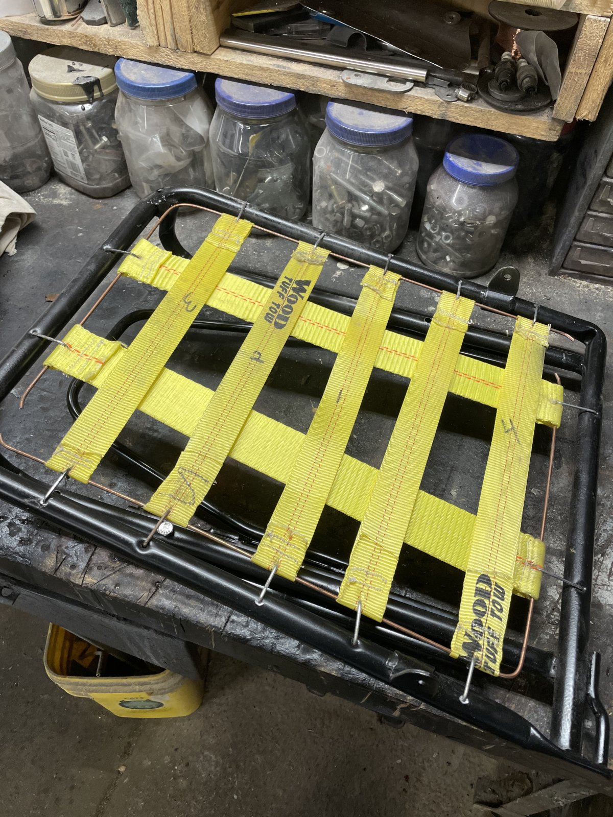

    I agree, a suspension base is best. That flat strap looks great. I recently bought some heavy duty lawn chair webbing and special screws. I need to re-do the seat bottom in my coupe. I don’t think it was engineered to carry the load of my fat ***.

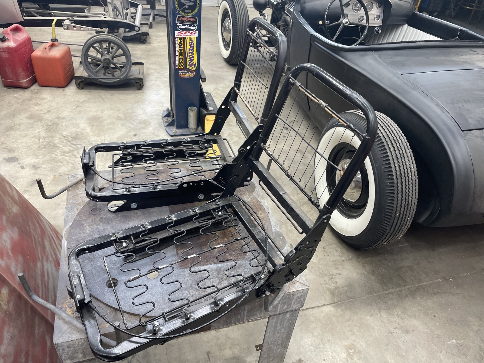

    I've seen bench seats out of vans on Craigslist for free occasionally, how about picking up something like that and take em apart to use the materials?

    A lot of the mini van bench seats have the fabric glued onto the foam and it is almost impossible to get it off without destroying the foam.

    They are good for the frames. It's what I used in my truck. They are simple and easy to modify.
