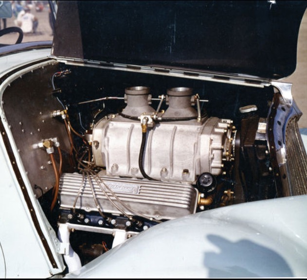

    IMG_7271.jpg The first engine in Ohio George's 33 Willys was a Caddy....

    Interview with Ohio George. Small bit about the Caddy.
    ET: We know your ’33 Willys g***er started out with a Cadillac engine and won A/G at the ’59 NHRA Nationals (Detroit) and ’60 and ’61 at Indy. Was there much potential in this engine, and what was its greatest weakness?
    OG: I didn’t really ever have any problems with the Cadillac. It made more horse-power than we could use due to the rock-hard drag slicks and dusty track surfaces. So my Caddy was very reliable. It was a 390 that we bored and stroked to 414 cubes.
    ET: After the Cadillac, you switched to a Chevy small-block. Why did the smaller Chevy seem like a better idea?
    OG: The reason I went to the small-block Chevy in 1963 was because of a change in the NHRA rule book. A modification in the weight break (pounds required per cubic inch) made it so the large Caddy 414 made me carry more vehicle weight. And knowing I had too much power as it was, the switch to the smaller-displacement Chevy small-block—still supercharged—helped keep the car compe***ive. As I recall, it was a 327 we bored and stroked to 375 cubic inches—39 cubes less than the Caddy. But the new rule was the main reason I yanked the Caddy.

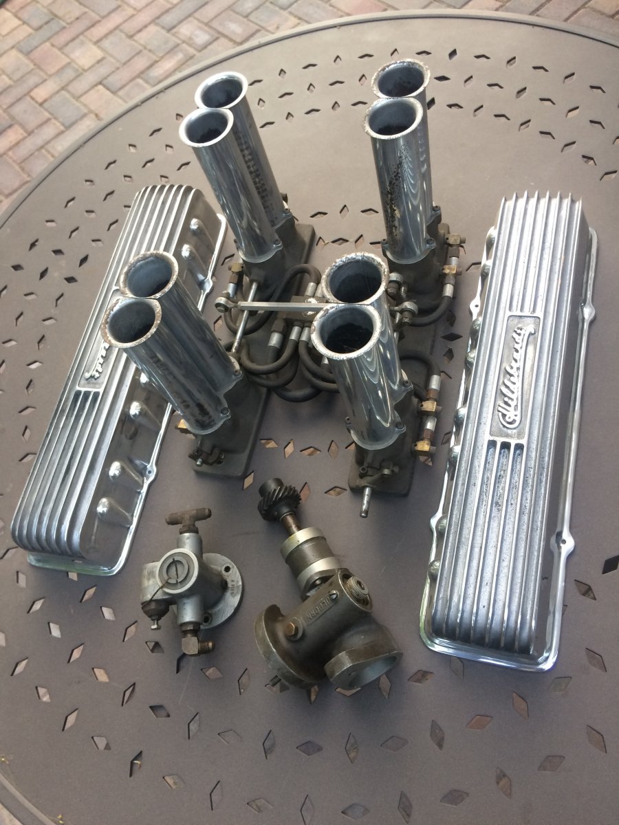

    Here is the setup I'm going to use on it. This is the hard to find Cadillac Hilborn setup with the original magneto fuel pump drive and pump. It was made in 1958 and sold to Moon for a 365 Caddy

    Von Hartman, very nice!! Have you been able to find anyone that has good info for speed parts?

    I've got a set of those injectors, but not all the other stuff! Hilborn has great records and the staff are very friendly.
