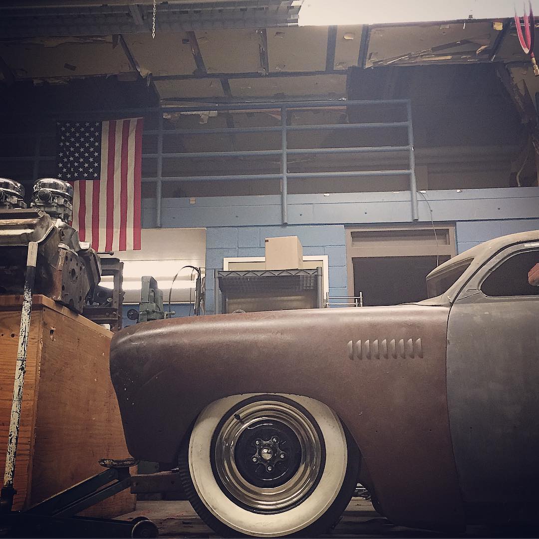

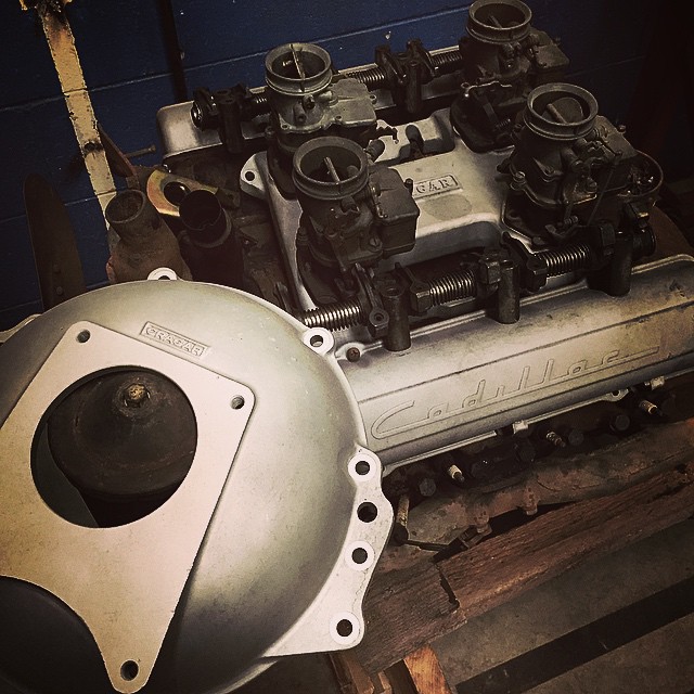

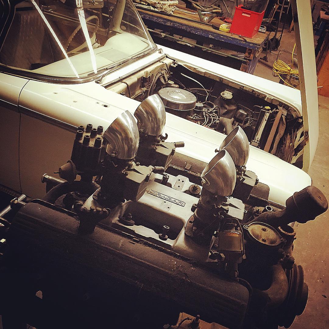

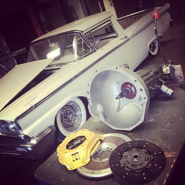

    390 Cad motors are awesome.
    I have a 429 in my 66 convert (related family) that I bought when I was 16.... having that car at 16 I put that engine through the ringer... ended up cracking a piston from over revving, second motor is still running like a top. Even in that cadillac and its weight disadvantage I drag raced and won plenty of back country road 1/4 mile races manually going through the gears with the auto- :) :) most of the time to other peoples astonishment- (mine too :p )
    This is turning out to be a cool thread. Watching and reading with interest because I'm in the same mode...
    I found a greasy running 62 390 I plan to clean up and put in the Ranchero.
    Actually I got crazy and bought 3 of them... two of them are 59's I think... so if you need any parts @Roothawg PM me- I have a 4x2 Cragar and cragar adatper to ford stick. I found a B&W R-11 O/D to run behind it- these transmissions are the strongest overdrive they made- same one they put behind the supercharged stude's. It was the predesessor to the T-10, same case. I really want to run a column shift but I think I'll put the hurst yo-yo in and run bucket seats. I found a Scheifer Flywheel and clutch ***embly and a hurst conversion kit for the shifter. I just need to take out the plug in the crank and cut a pilot bush for it and rebuild the carbs and then I can look at doing the swap-
    ImageUploadedByH.A.M.B.1439400504.695683.jpg 15275485_370289929987500_5127083094674767872_n.jpg
    I've been collecting parts for a 331 too that I plan to drop in my first car (bought it when I was 15) shoebox kustom, half of this thing burned but I've been collecting parts to resurrect it- 4-2 cragar to cragar bell to 57 ford trans and '57 9" rear. I found stude lifters for this one. I actually got an extra pair of 390 heads too... I was going to do a headswap and build this one to be hot. This shoebox is the one I z'd the frame on back when I had the old shop.

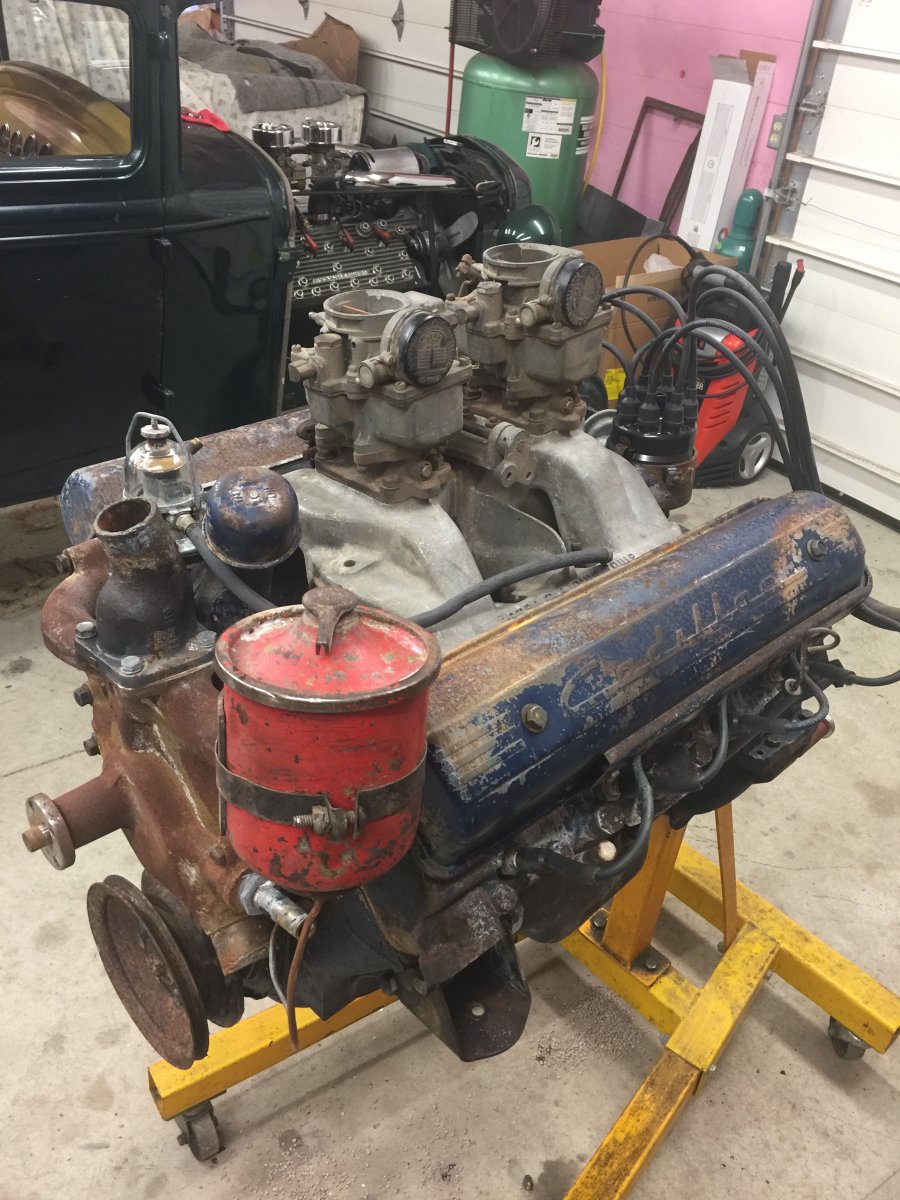

  11. image.jpeg My other thought/concern is only having earlier motors and the partial flow oil filtration.
    Every early cad I have pulled the valley cover off has been full of sludge,probably though just from lack of oil change and breathing problems.
    I keep looking waiting for a 60-62 390 to come up but not a lot on the ground down here.
    Some say to byp*** the filter completely and change the oil often but that may be okay for a car pulled out of the shed occasionally but I plan an every dayer.
    I have 4 cad motors,1 x early 49,2 x 365s and a 59 390.
    I have built 1 of the 365s using 390 heads and have it dressed up for a night out.
    Probably just go with a beehive filter but am looking at trying to work out a full flow setup,we'll see.
